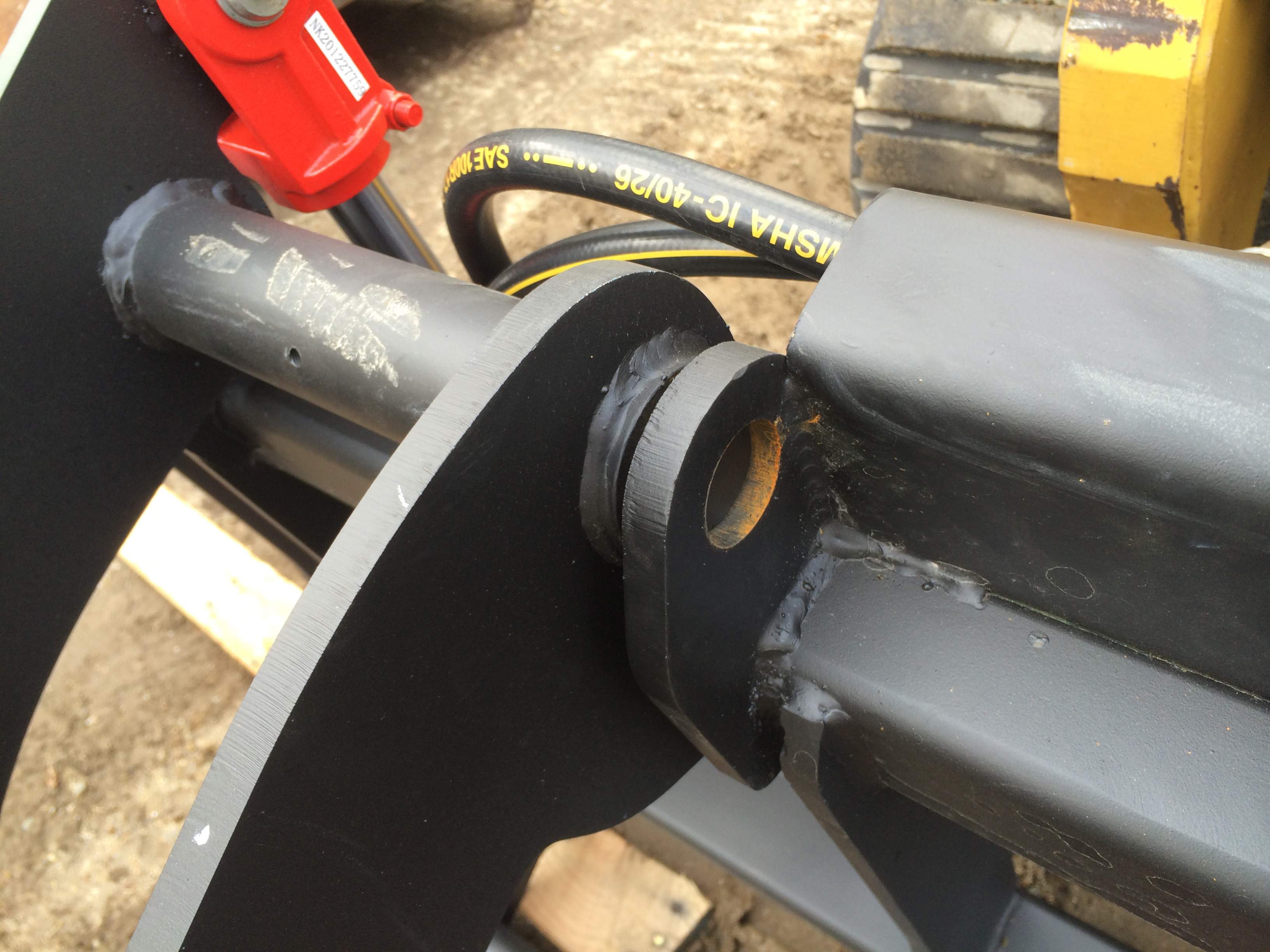

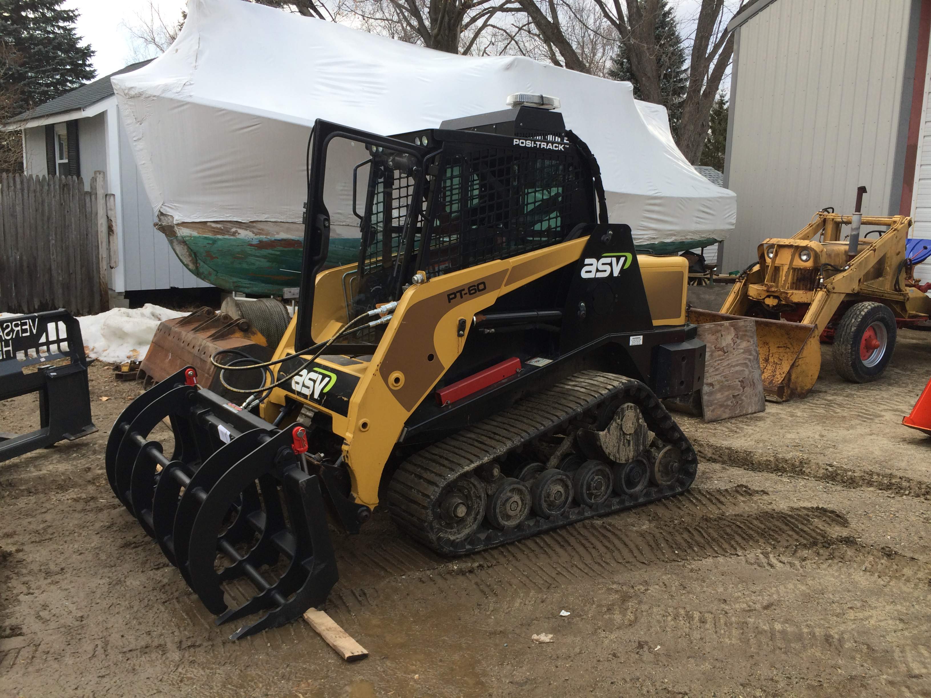

Ok guys, here we go!

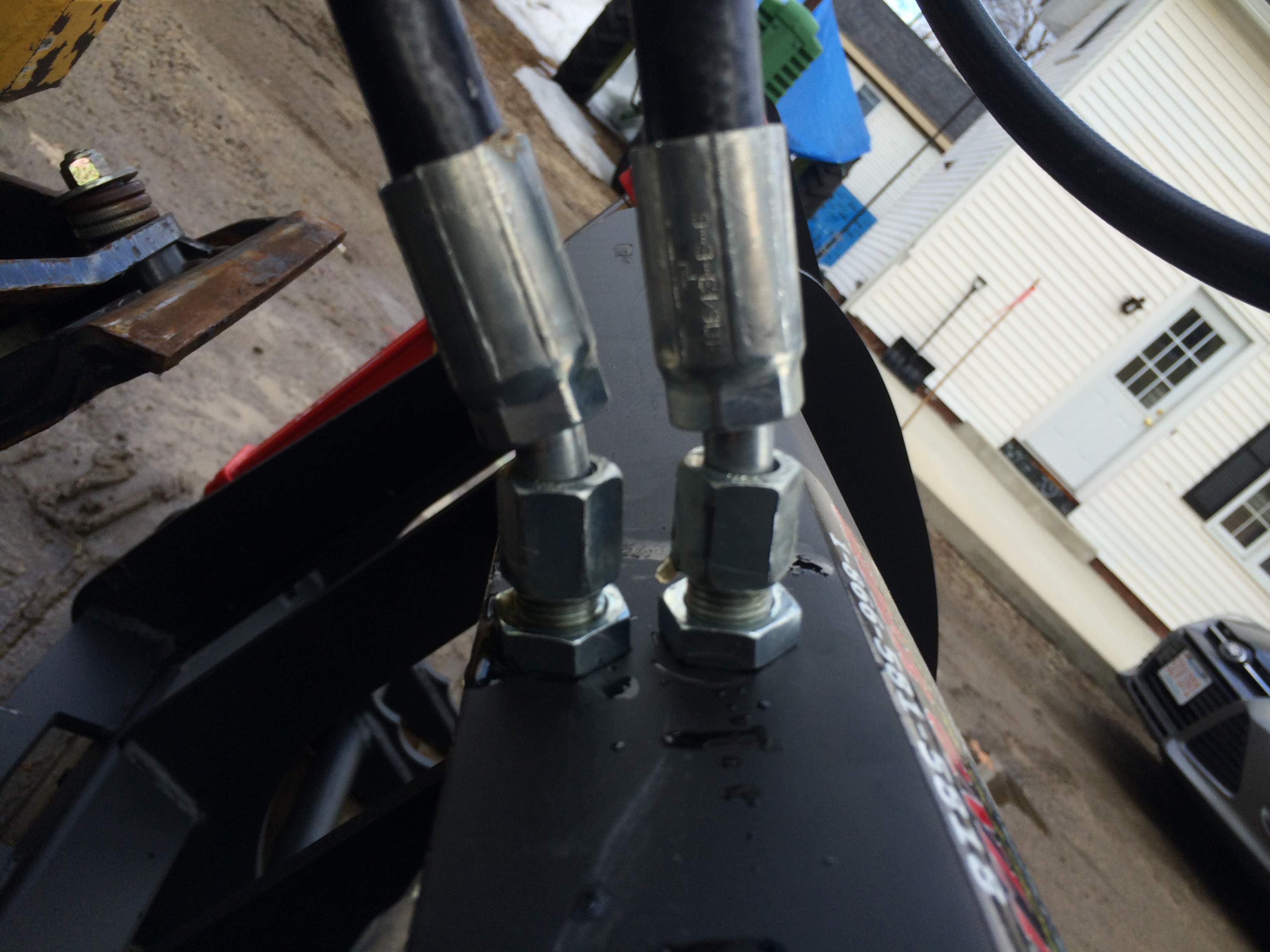

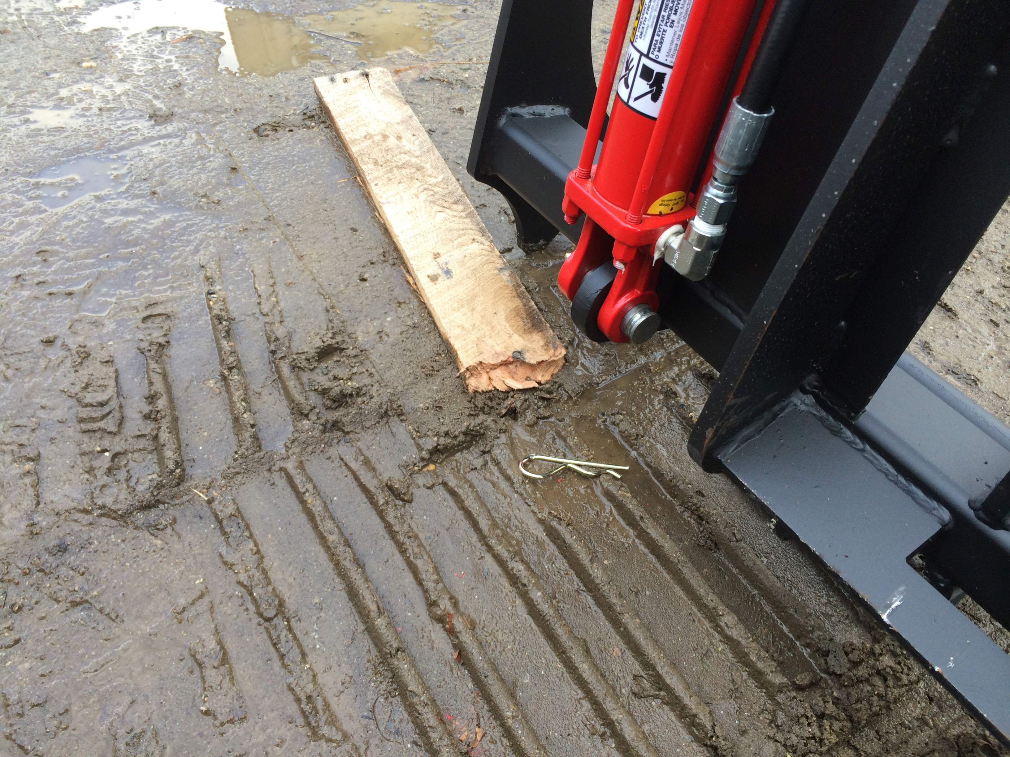

On 02/27/2014 I placed an order with Everything Attachments for the 72 inch "Everything Attachments Tractor Loader Root Rake Grapple" Part number-ETA-CMP-RRG-72 with the flat face connectors. Total for grapple was $2,295 plus $75 for the couplers.

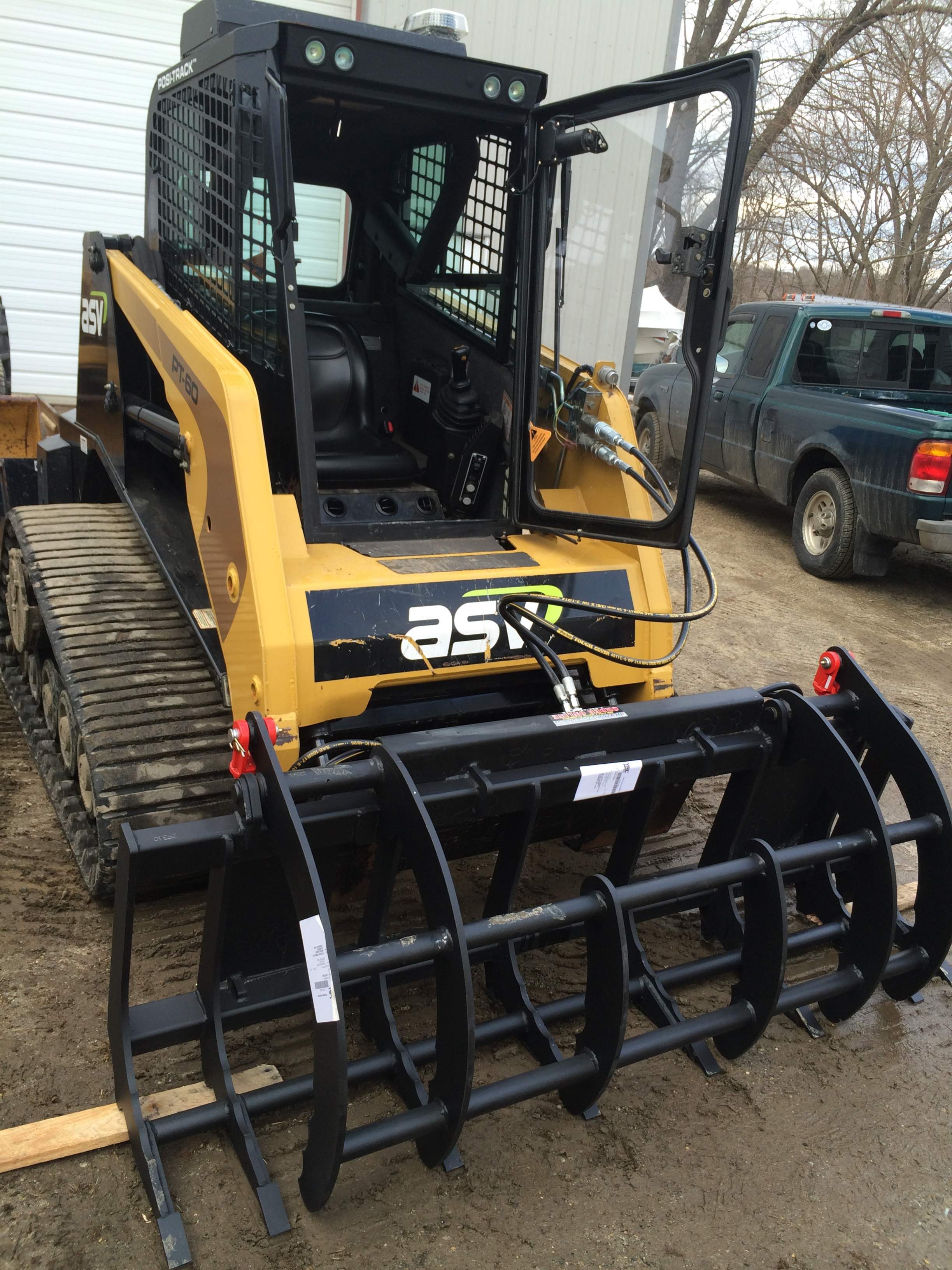

Today is March 21st 2014 and my grapple arrived at the Boston Yellow Freight terminal, so I picked it up after work and brought is straight home to check it out. I will tell you this, it looked great when I picked it up. the metal cutting and welding looked very nice. So I backed into the yard and fired up the ASV while I went inside to get tin snips for the metal banding that was wrapped around the grapple and the undersized pallet that was quite broken. I guess the pallet wasn't an issue as it just needed to sit on a truck, but on with the story... I removed the grapple from my truck, set it down and un-banded the grapple. All smooth so far..but here we go.

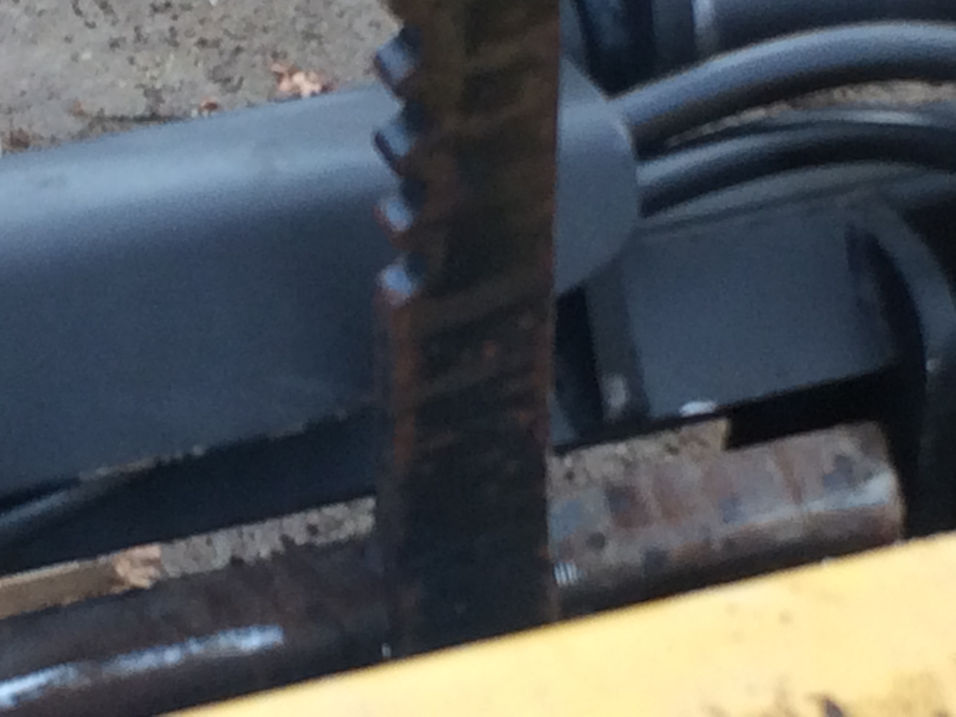

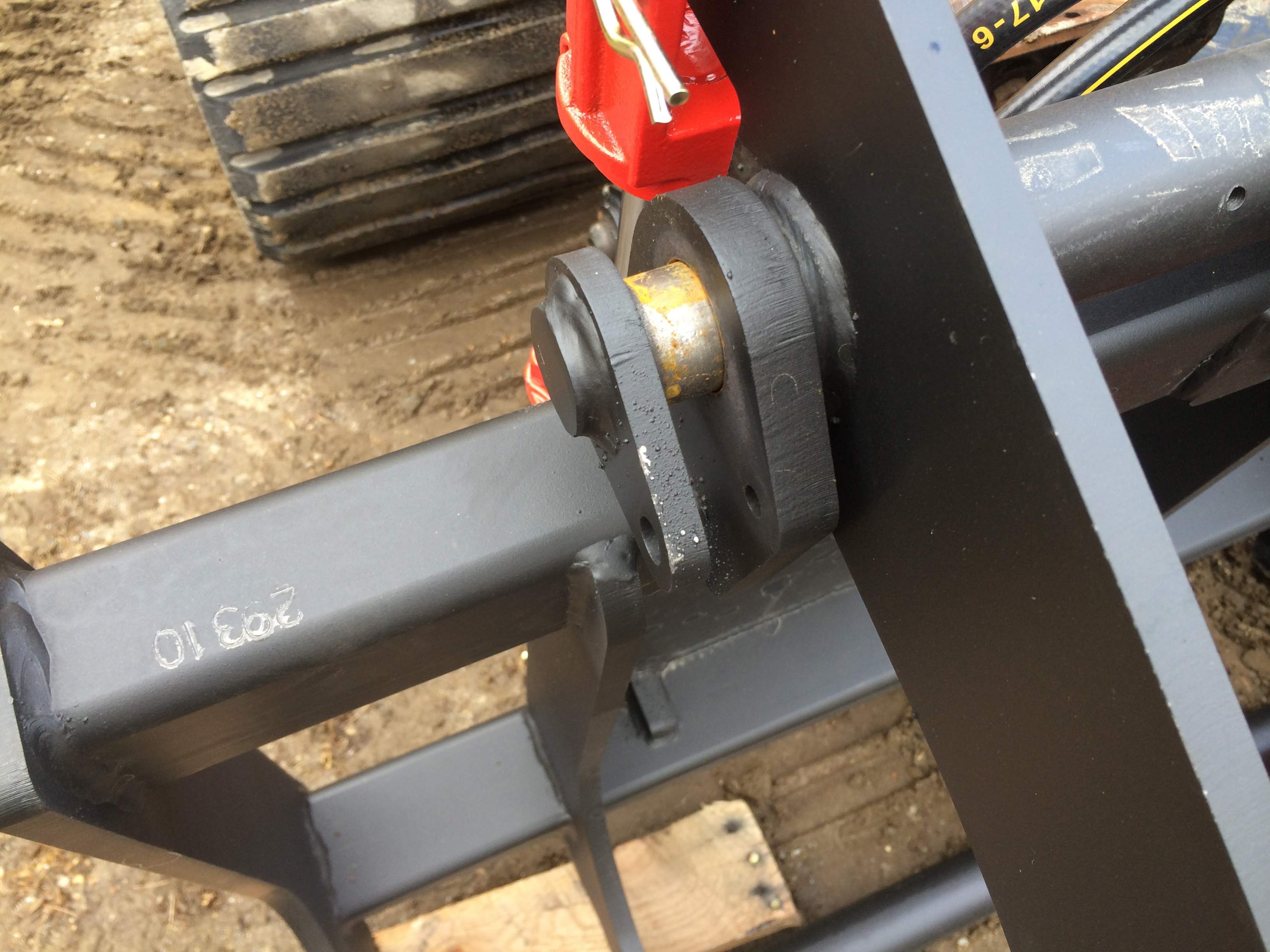

Im going to start with a design flaw that renders the grapple unusable in its current form. My skid steer is an ASV PT-60 with a manual quick attach. The problem lies with the hose guard on the top of the grapple. Its a metal cover designed to protect the hoses, but in this case the cover contacts the pin levers and will not allow the grapple to mount under the top mounting surface. I tried everything and its just not going to fit in its current form. This was a huge fail right off the pallet, brand new and unusable!

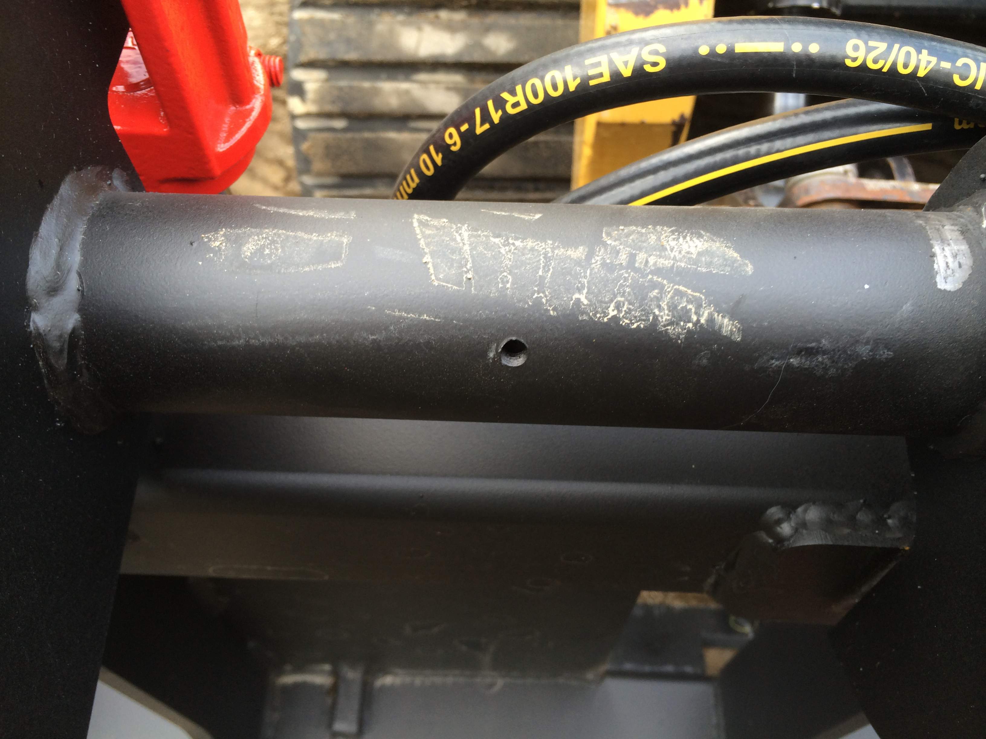

So i decided to plug the hoses in to the machine and open the grapple as part of my attempts to attach it to the skid. Plugged them in and opened the grapple. Everything looked good from inside the cab. Got out to take a look at things and found a big puddle of hydraulic fluid from the uppermost fittings that were not even finger tight. then as I looked around I found more problems. The fittings look bent, the grapple pins were falling out because hardware to hold them in wasn't there at all, the grease fittings for the grapple pins were never installed, and the cylinder safety clip fell out onto the ground.
Now most of this is small stuff, but I come from a manufacturing background and I can tell you this- A FINAL PRE-SHIPPING INSPECTION WAS NEVER DONE!! I don't understand how this could have left the shop in this state, its basic manufacturing, you build, you inspect, you test and you ship. Its simple!
I wasn't able to speak with anyone at EA as they were closed at the time of my discoveries, but i will tomorrow and I will post the progress.

This morning I received a call from Everything Attachments regarding the issues with the grapple. I was very pleased to receive a call from them even before I placed a call to them..(Now thats customer service.) We went over the quality control issues with the grapple and EA just asked what needed to be done to make it right.
So as of this morning I'm a very happy consumer. My plan going forward is to fix the issues myself and stay in contact with EA. I may offer a couple of ideas to make the grapple more "universal" and of course I will keep everyone updated right here.
