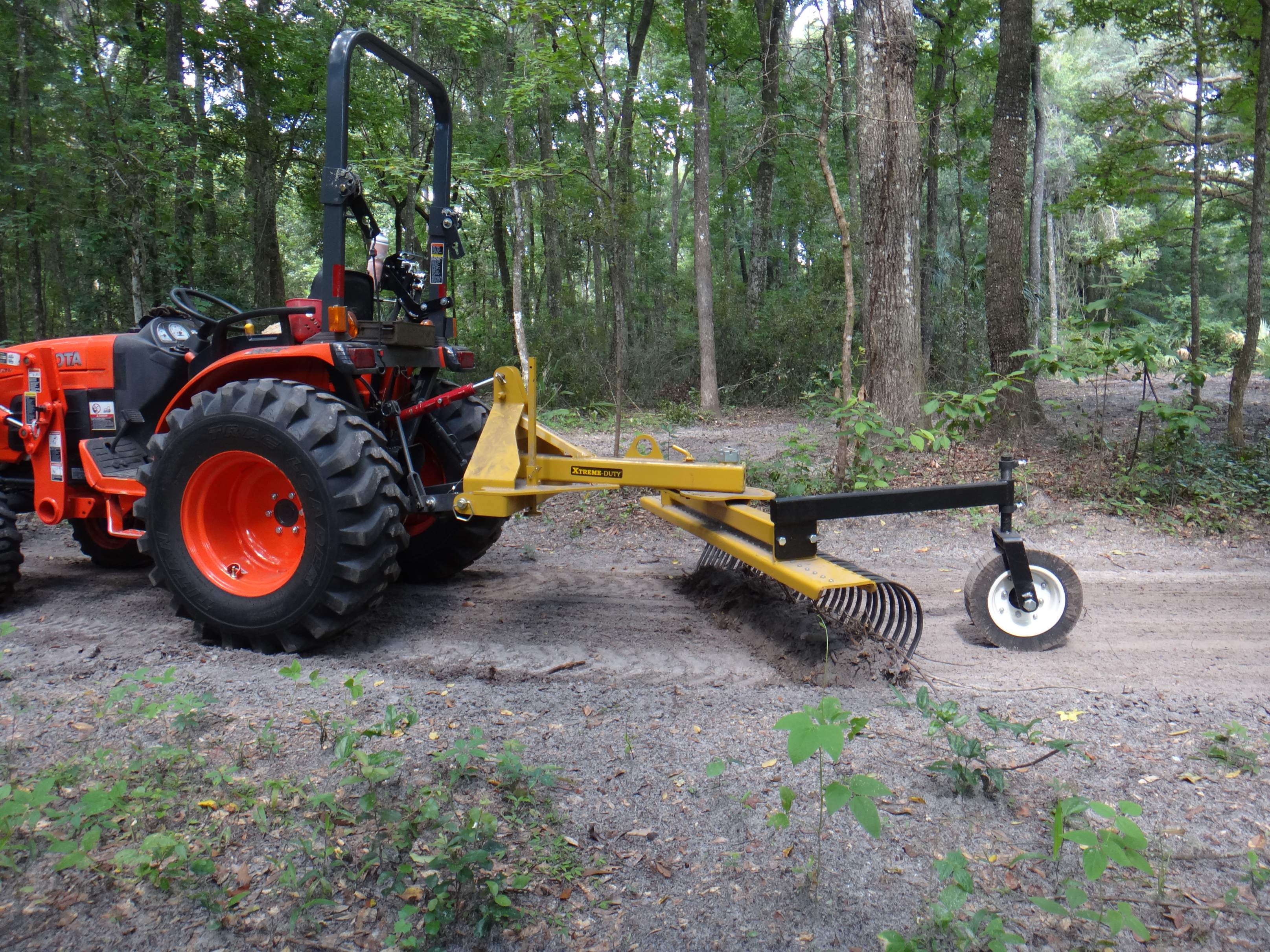

It is a HydrauLink. There are a ton of posts on HydrauLink available through the SEARCH function here on T-B-N.
I give it a limited endorsement. It is quite helpful when using a box blade. Useless when using a rotary harrow, because it is too long. Minimally useful on first day with landscape rake. ( Rake tines act as shock absorbers. )
HydrauLinks cost about $250. For not much more $$ you can get hydraulic TnT, which is easier to adjust and provides adjustment in two axes.....if you have hydraulic remotes at the rear of your tractor.
The piston-arm length adjustment via manually opened/closed valve works well.....except gravity orients the valve down, in which position the valve is not accessible from tractor seat. The valve NOT maintaining UP position is a major design or manufacturing shortcoming.
HydrauLink's greatest benefit, to my way of thinking, is that it acts as a big shock absorber between the tractor and implement. I am always alert for ways to reduce strain on my relatively light tractor and I think a HydrauLink reduces wear and tear day in and day out.

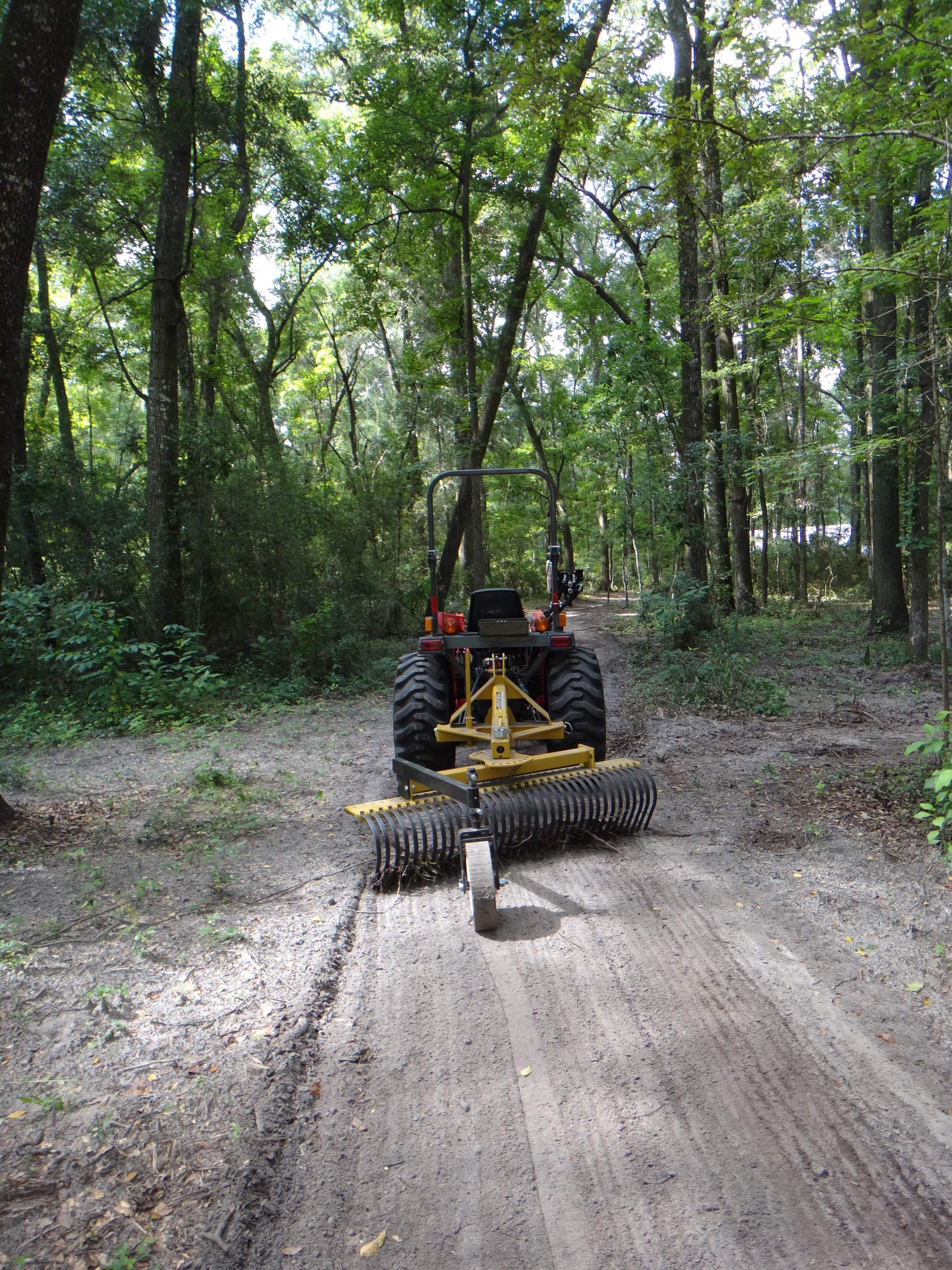

How is the height of the wheels adjusted?
There are a pair of collars, with a hex head set bolt + lock nut on each collar, which secure height of each column.
Here is a photo of the right gauge wheel assembly, showing the two collars:

"The piston-arm length adjustment via manually opened/closed valve works well.....except gravity orients the valve down, in which position the valve is not accessible from tractor seat. The valve NOT maintaining UP position is a major design or manufacturing shortcoming."
I'm trying to understand what is meant by "except gravity orients the valve down".
   / ETA Landscape Rake: Delivery + Setup // PHOTOS
#16
Instead of the length-controlling valve remaining "up" where it is accessible from the tractor seat, gravity and vibration allow the body of the HydrauLink to turn 180 degrees so the valve is oriented down toward the ground and is NOT accessible from the seat. The valve and its protecting frame are surprisingly heavy.
There is a large lock-nut on the unit, perhaps 1-1/4", but it would require an appropriately large wrench to tighten. I have not found snugging the body lock-nut a practical proposition in the field.
My HydrauLink was manufactured in China. Execution is a little on the crude side.

It is working now.
