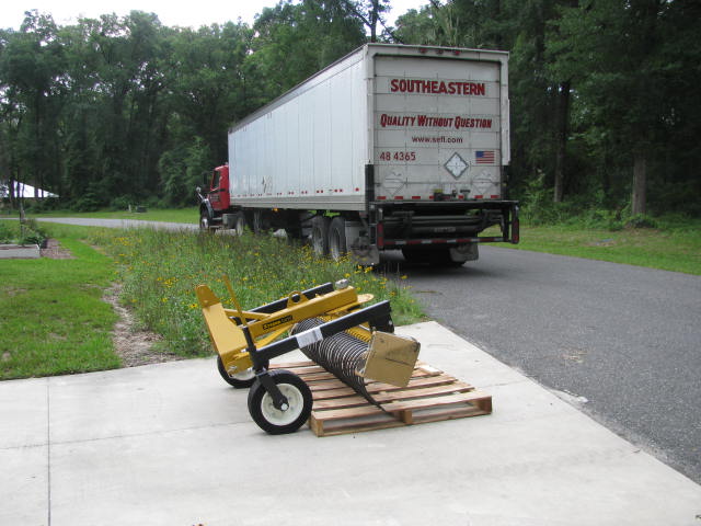

Photo #1 Truck departing, rake on pallet, doubled for shipping. What's next?

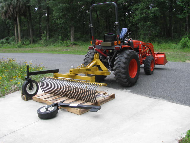

Photo #2 One gauge wheel has to be removed using two 15/16" wrenches, two nuts + bolts per side, in order to pivot mast. I will add washers under bolt heads.

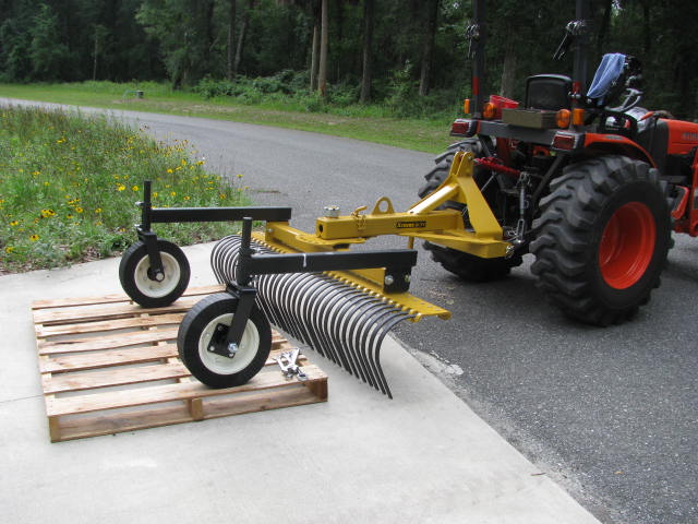

Photo #3 Mast pivoted. Ready to load into 3-Pt. hitch.

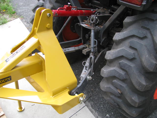

Photo #4 Aftermarket Stabilworks pin-adjustable rigid stabilizers/check chains, make lining up 3-Pt. lower link "eyes" with rake double clevis easy.

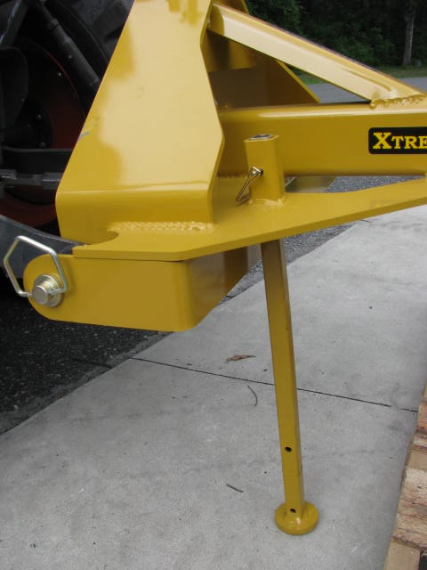

Photo #5 Rake is prevented from toppling forward by foot.

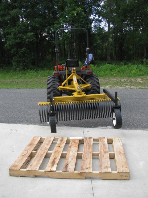

Photo #7 Rake is off the pallet and ready to work.
Note: Rake arrived well padded, without scratches. Paint still a little soft.
Southeastern Freight Lines Bill of Lading lists shipping weight of 525 pounds, which included a 45" X 62" virgin pallet. Customer service at SEFL is excellent. Superior to multiple competitors that have delivered to me. Delivered during the hour promised.

That's a very stout frame, complete with clevis-style draft link hookup, for a rake. The welds look real good too. Plus the lifting hook on the main beam is a nice touch. Real nice looking setup.

Those look like some serious gauge wheels. The wheels on my older York rake are about half that size or less. They tend to build up with wet soil also and I need to attach some scrapers to prevent that. Your gauge wheel tires look similar to those normally use on "bush hogs". Is there an advantage to that laminated type construction other than no flats?
/ ETA Landscape Rake: Delivery + Setup // PHOTOS
Thank you, npalen, for your input when I was researching disc harrows.
No advantage that I know of beyond no flats.
During initial use yesterday I conjectured that low pressure tires could be an interesting alternative to laminated wheels. Possibly one low pressure tire on a swinging beam would provide enough support? It would be an advantage when maneuvering to have just one fat wheel, inboard, rather than the pair, outboard, in the way.

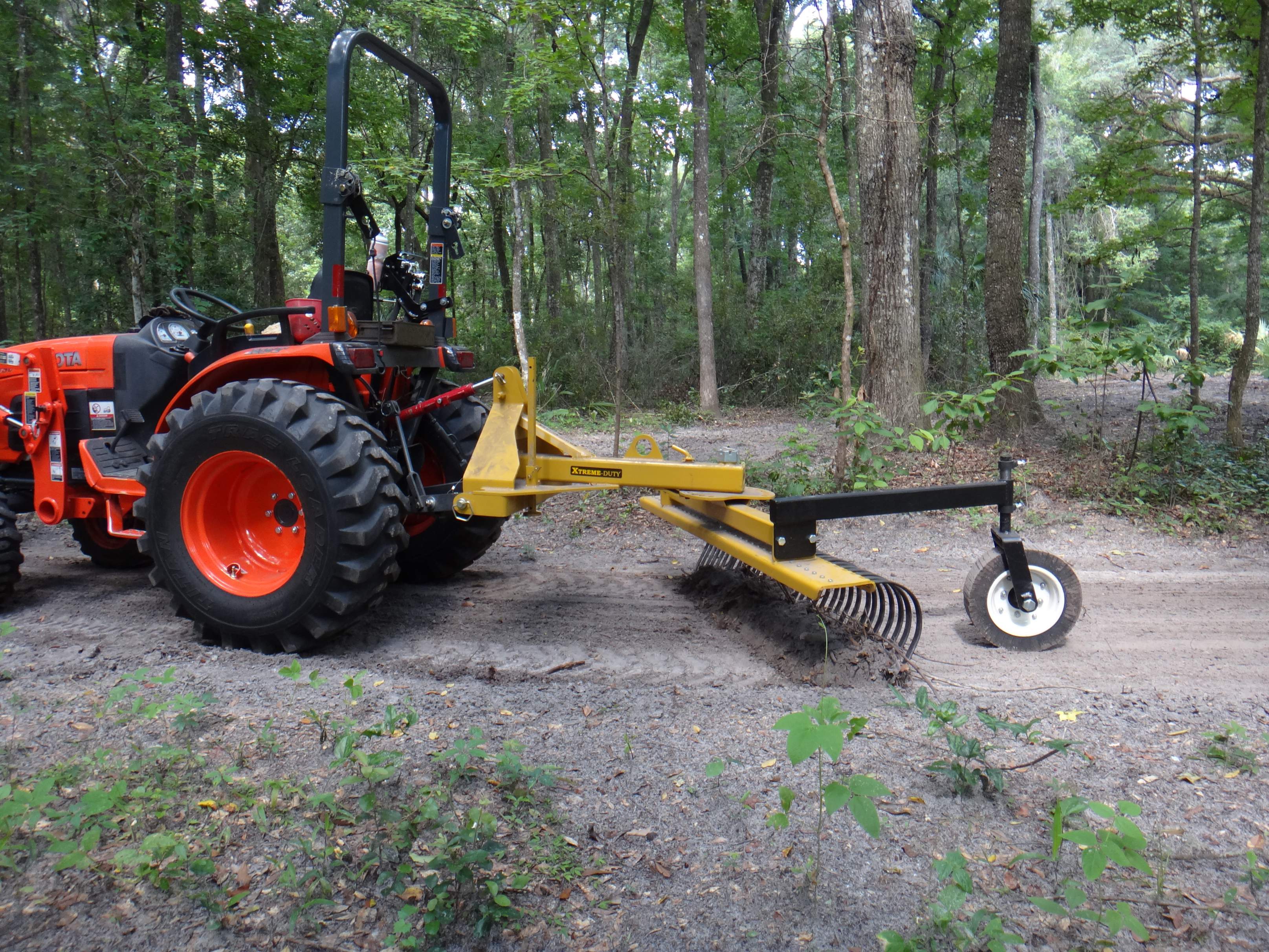

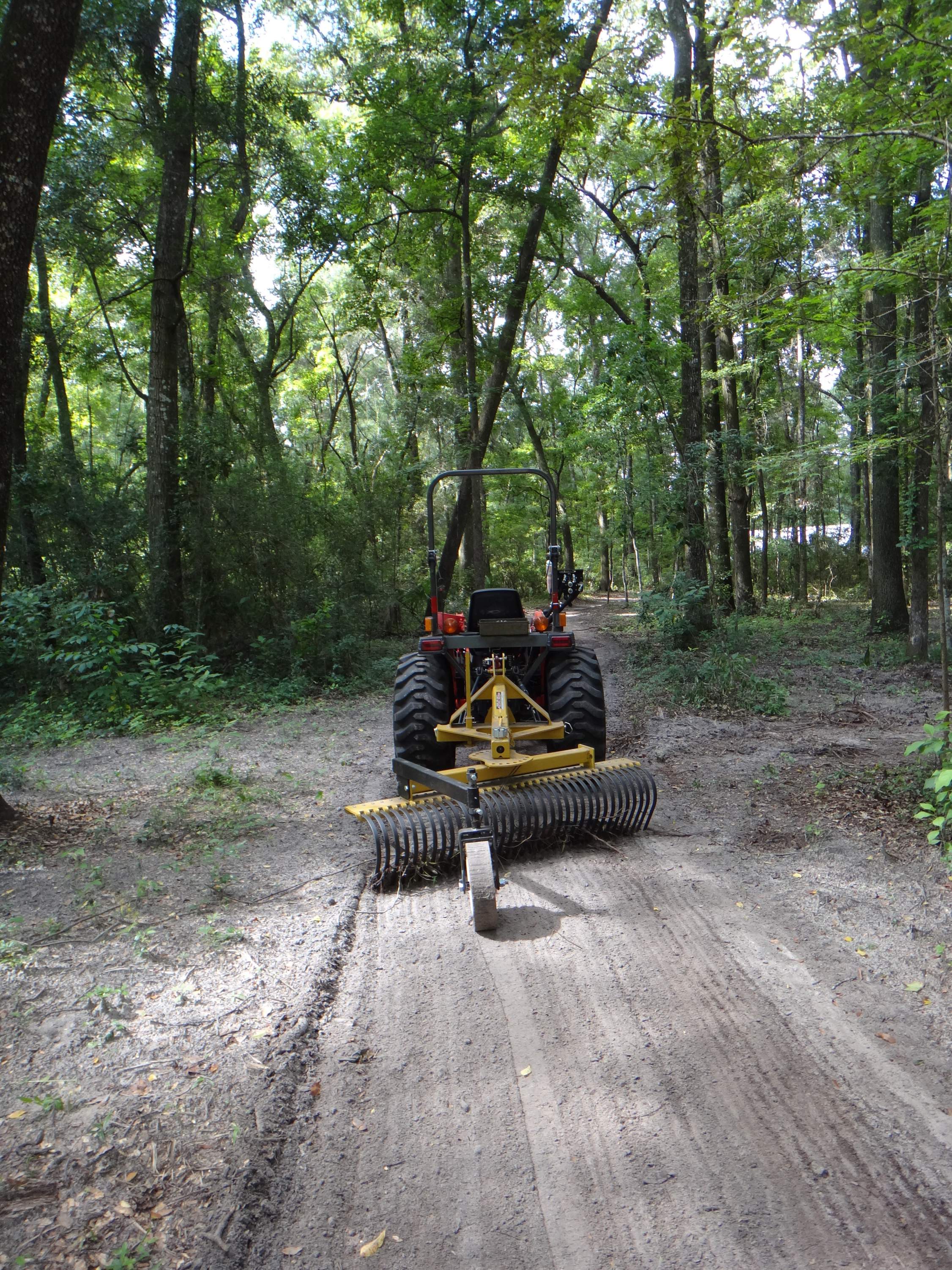

It is working now.
