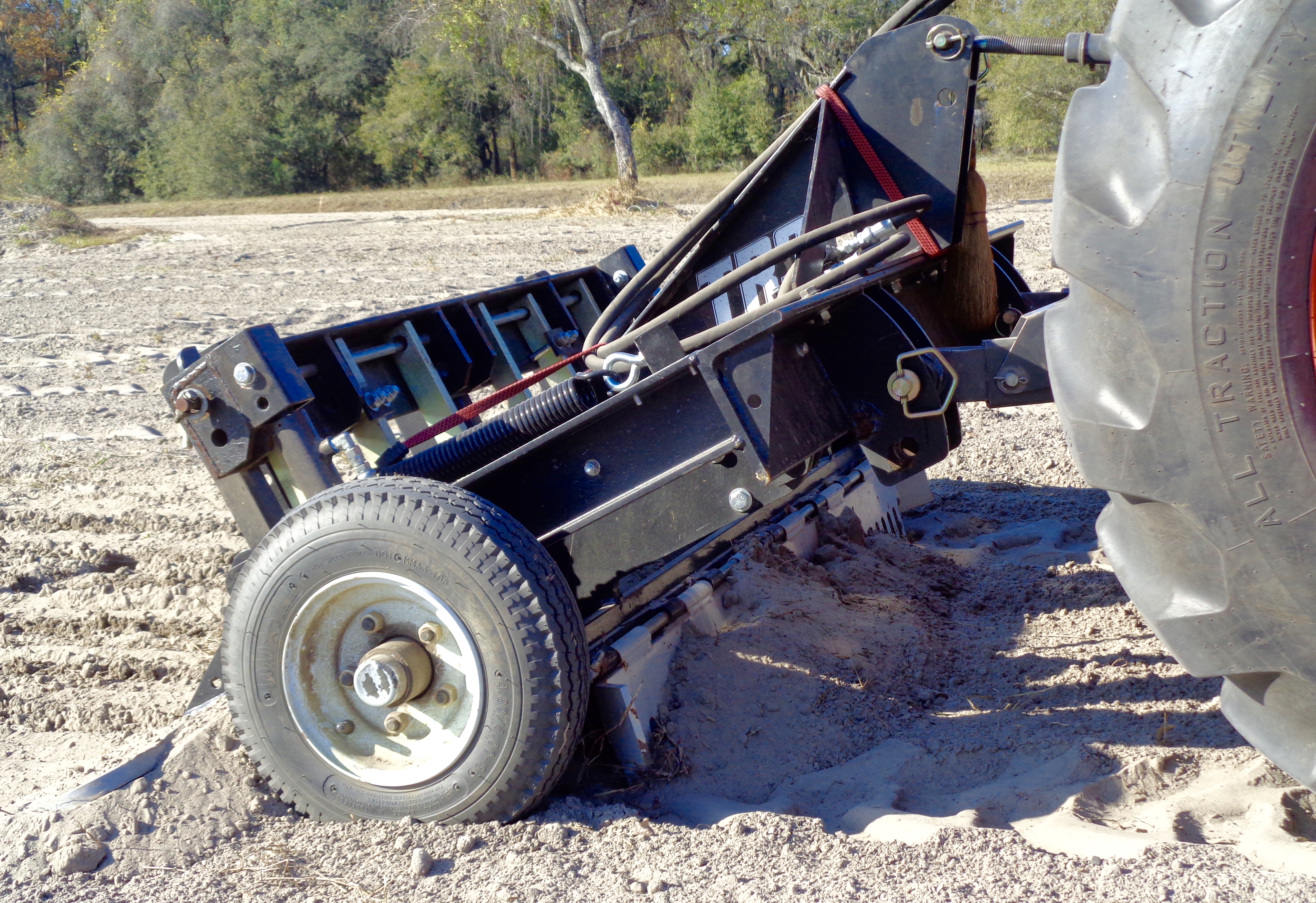

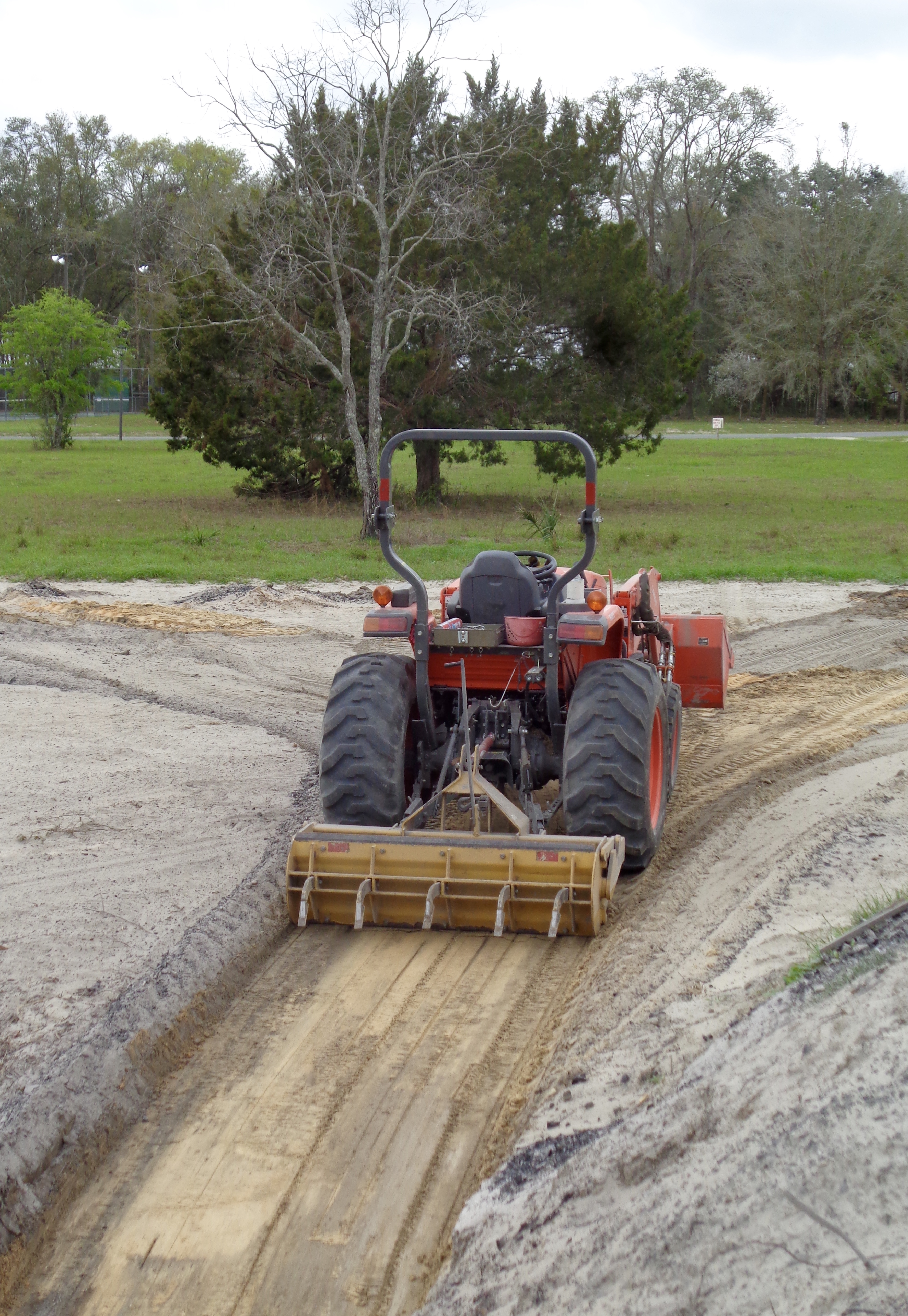

I received this previously owned ABI TR3~6.5~Command~Rake December 18, 2017. Photo #1.
TR3 "Command Series" is ABI's commercial model TR3 rake, with six hydraulically operated scarifiers plus tooth sections fixed on the leveling bar.
While the Command Series is focused on the pro Landscaping market, more broadly ABI markets its various iterations of the TR3 to horse arena owners.
Why? Because this is a costly implement. Original owner, a builder in Clinton, New York, paid ABI $5,790, plus freight, in April 2015. I purchased the TR3 from the original owner for $3,000 plus shipping via eBay. I shipped NY to FL via uShip.
"uShip, Inc. is an Austin, Texas-based Internet company that operates uShip.com, an online marketplace for shipping services." The telephone quote I received from FedEx ground was $1,100. I shipped with Roadrunner Transportation for $260.53, including uShip's commission. TR3 took eight days to arrive in Florida in undamaged condition I will use U-ship again; entirely satisfactory.
LINK
: uShip | The Online Shipping Marketplace
TR3 Rake weighs about 800 pounds, stabilized by a pair of foam filled gauge tires, with four closely spaced wheel height options. TR3 width is 78".
My 37-horsepower, heavy chassis, kubota L3560, 4-WD, R4 tires, with HST/PLUS transmission pulls the TR3 in HST High/low or HST Medium/high easily. Tire spread is 60".
My soil is Florida sandy-loam.

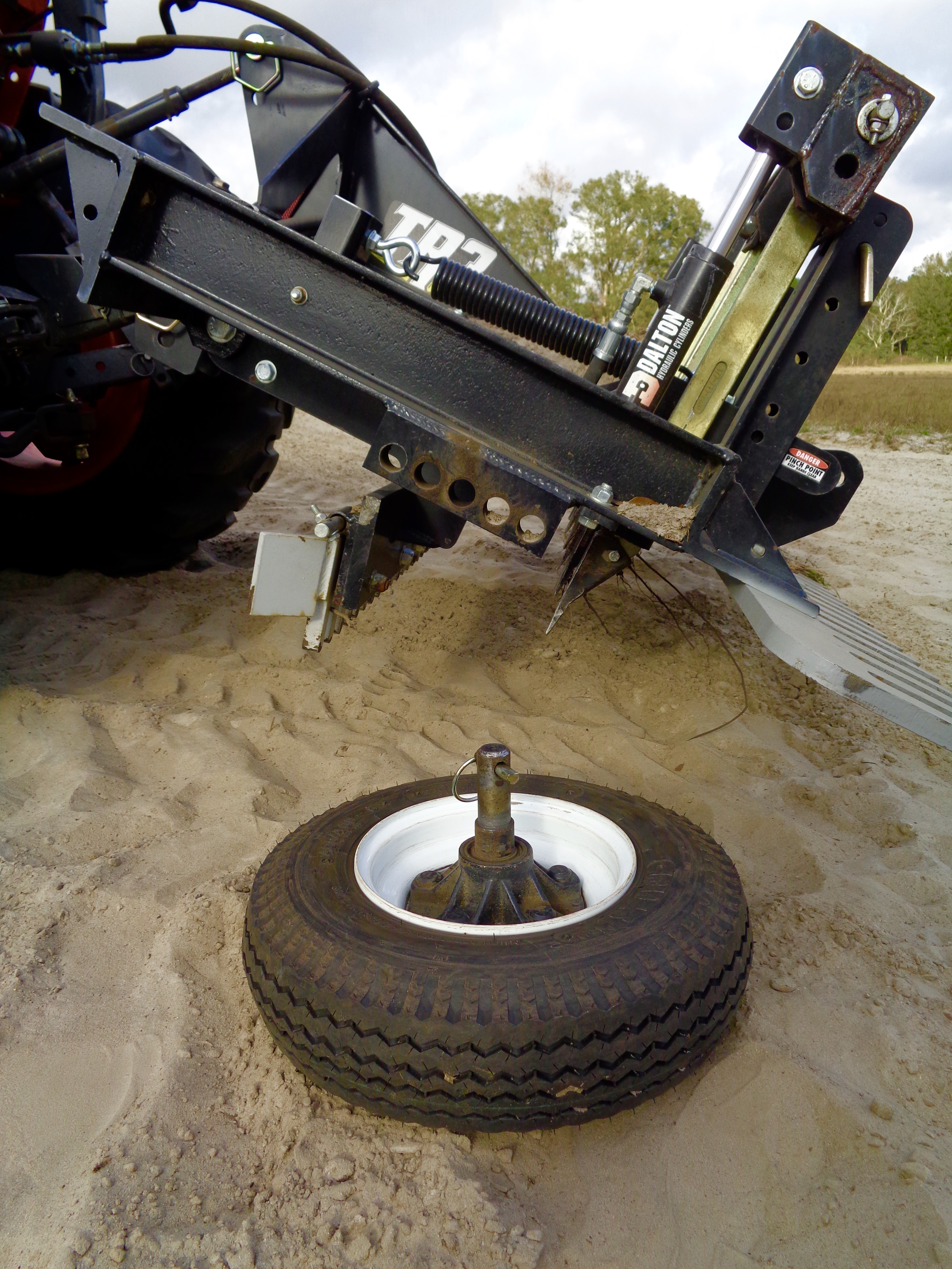

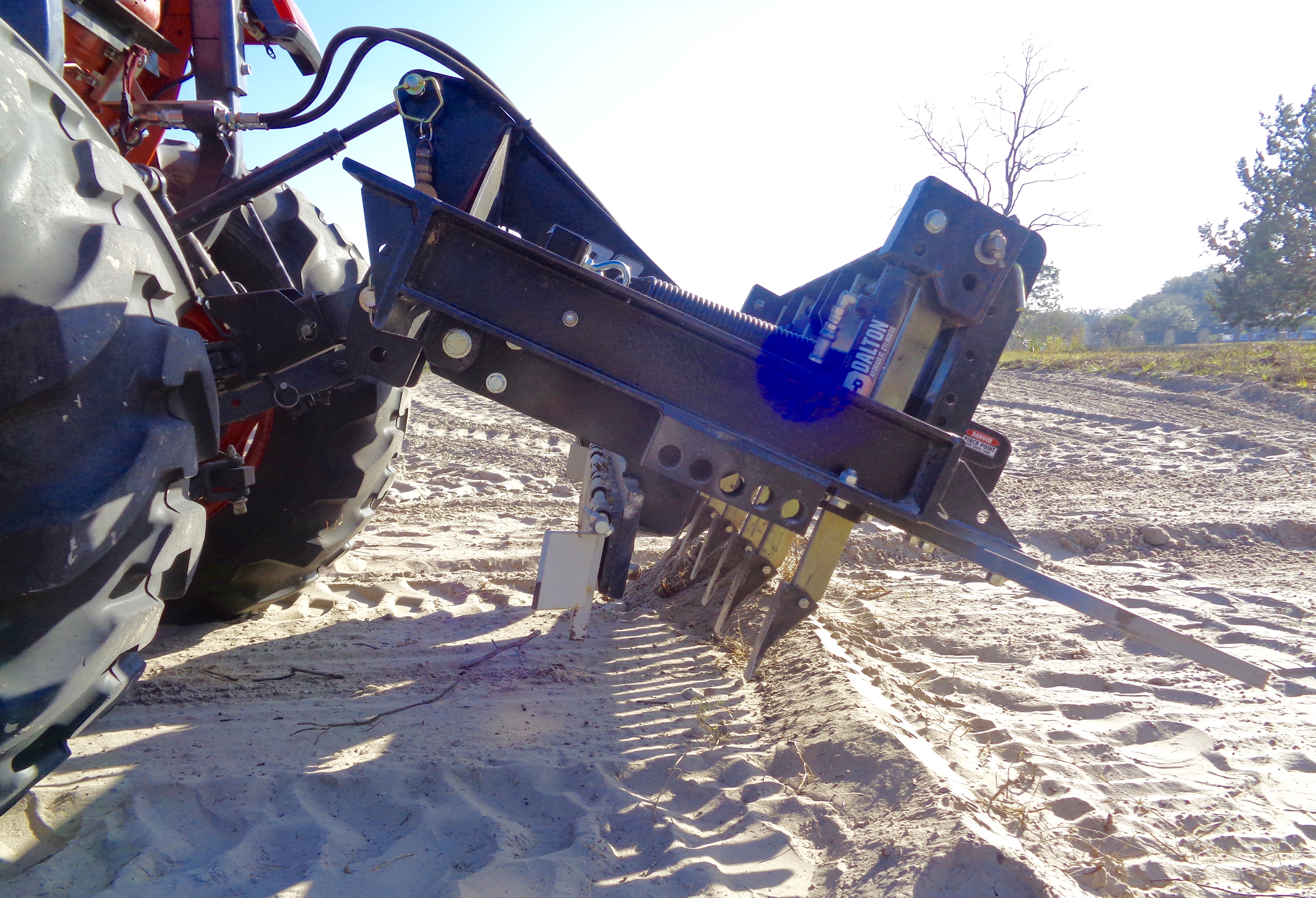

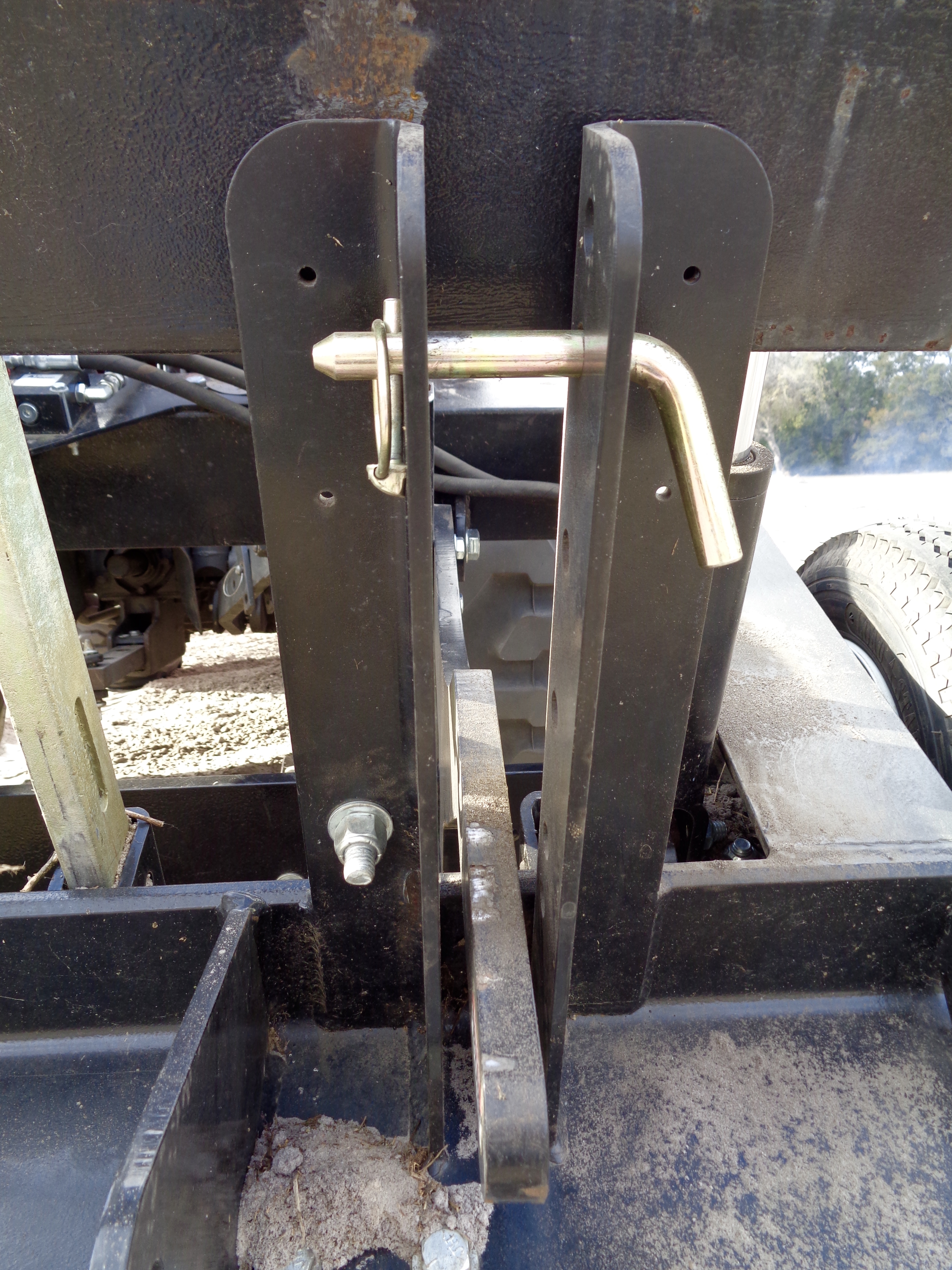

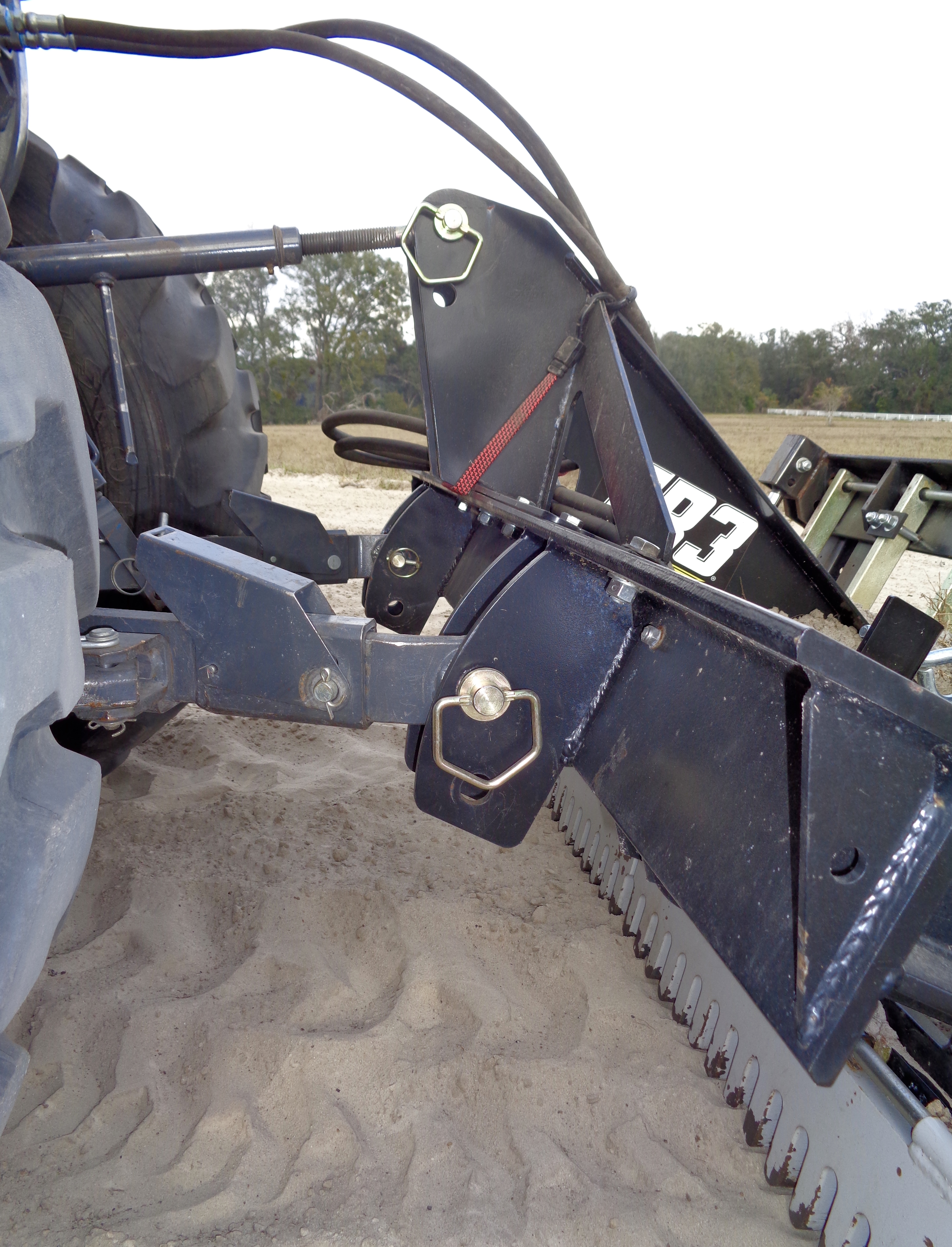

Like other implements, the TR3 is adjusted via Three Point Hitch: BITE/SCIVE fine adjustment with Three Point Hitch Top Link, LEVEL with the Three Point Hitch Right Lifting Rod and TILT, for producing a road crown, by moving pin in stacked pin holes on the Three Point Hitch Lower Links.
The TR3 Rake has several adjustments on the rake itself.
Photo #1 Rake has upper and lower pin positions for Top Link pin and Lower Link pins. ABI recommends initially positioning pins in the lower holes for both Top Link pin and Lower Link pins. As you see in Photo #1 I conformed but in ABI's videos the tractor/rake connections vary by user. (I believe in reading instructions.)
Photo #2 Gauge wheels/rake center pivot point. Wheels pull off after removing a standard lynch-pin retainer. There are five frame hole choices, through which the wheel axle fits, offering five increments of implement float. ABI suggests starting with the wheel axle in the center hole. The lowest hole, on the right, offers the most rake support, therefore the least sciving effect. The topmost hole, on the left, maintains the wheel above earth contact most of the time, therefore the most sciving/dirt movement occurs.
Photo #3 Wheel removed to show six scarifies extended. Scarifiers: 9" length standard, cuts to 7" depth; 12" length optional.
Photo #4 From this balance point FINE scive adjustments are made with the Three Point Hitch Top Link. Shortening the Top Link raises the rear finishing rake and lowers the course cutting leveling bar, which has 2" teeth on ground contact edge. Lengthening the Top Link lowers the rear finishing rake and raises the leveling bar. A long Top Link deploys only the rear rake in ground contact, for final smoothing. For most work, both the floating leveling bar and the rear rake should be in ground contact. A 1/2 turn of the Top Link makes fine adjustments between the two ground contact points.

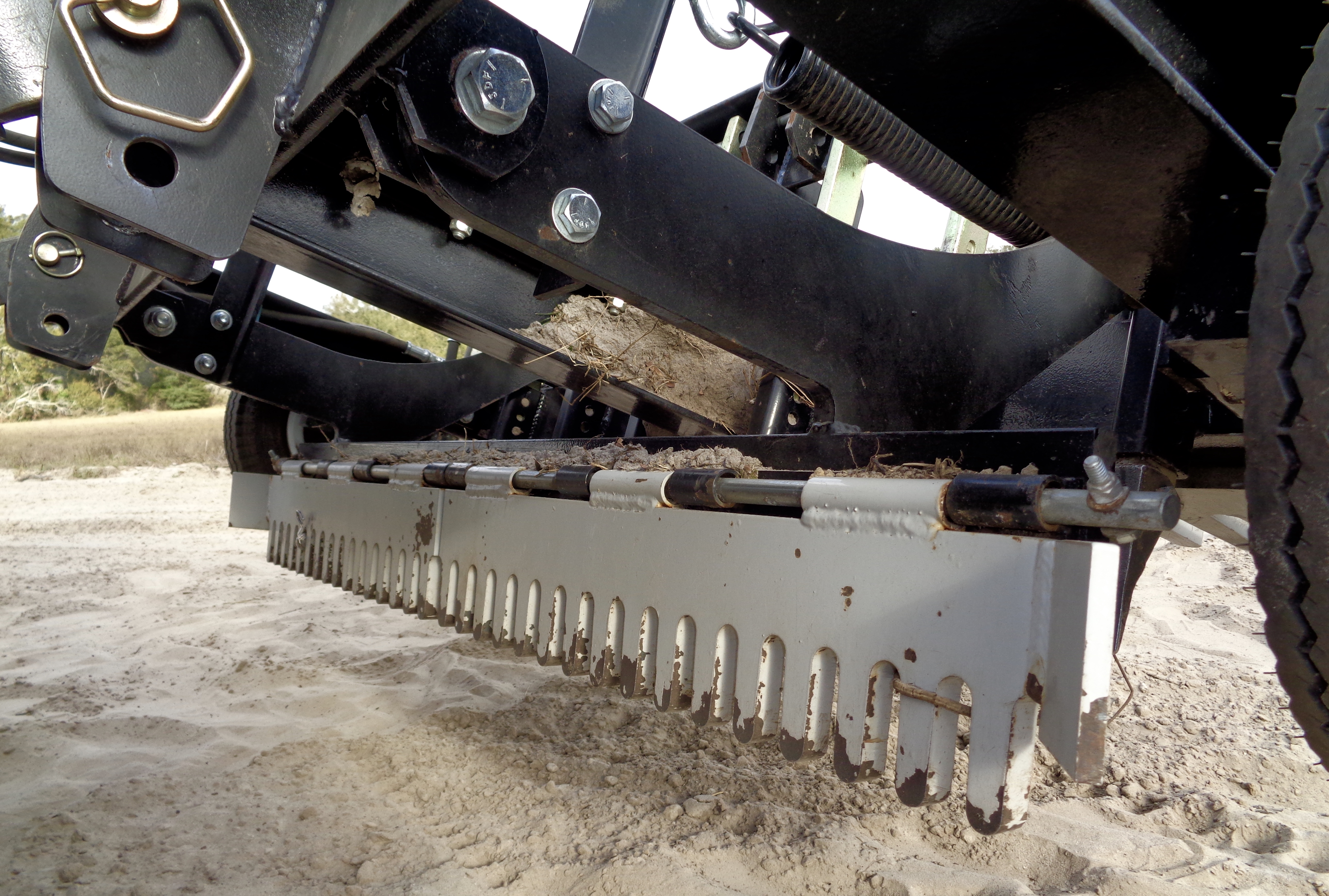

The heavy leveling bar is tensioned with big springs. When leveling bar encounters a mound it scives the mound, pulling dirt along in front of the leveling bar as a reservoir to fill low spots. Leveling bar movement can be limited through pin adjustments. Photo #5.
As leveling bar passes over a low spot, carried dirt drops in, filling low spot.
Locked down, the heavy leveling bar functions as a heavy, low capacity Box Blade; low capacity because drag bar is only 6-1/2" high. Drag bar on my model TR3~6.5 is 78" wide, including forward angle skirts. Photo #3.
Heavy leveling bar routinely takes out packed mounds. Remarkably hard mounds may require lowering hydraulically operated scarifiers.

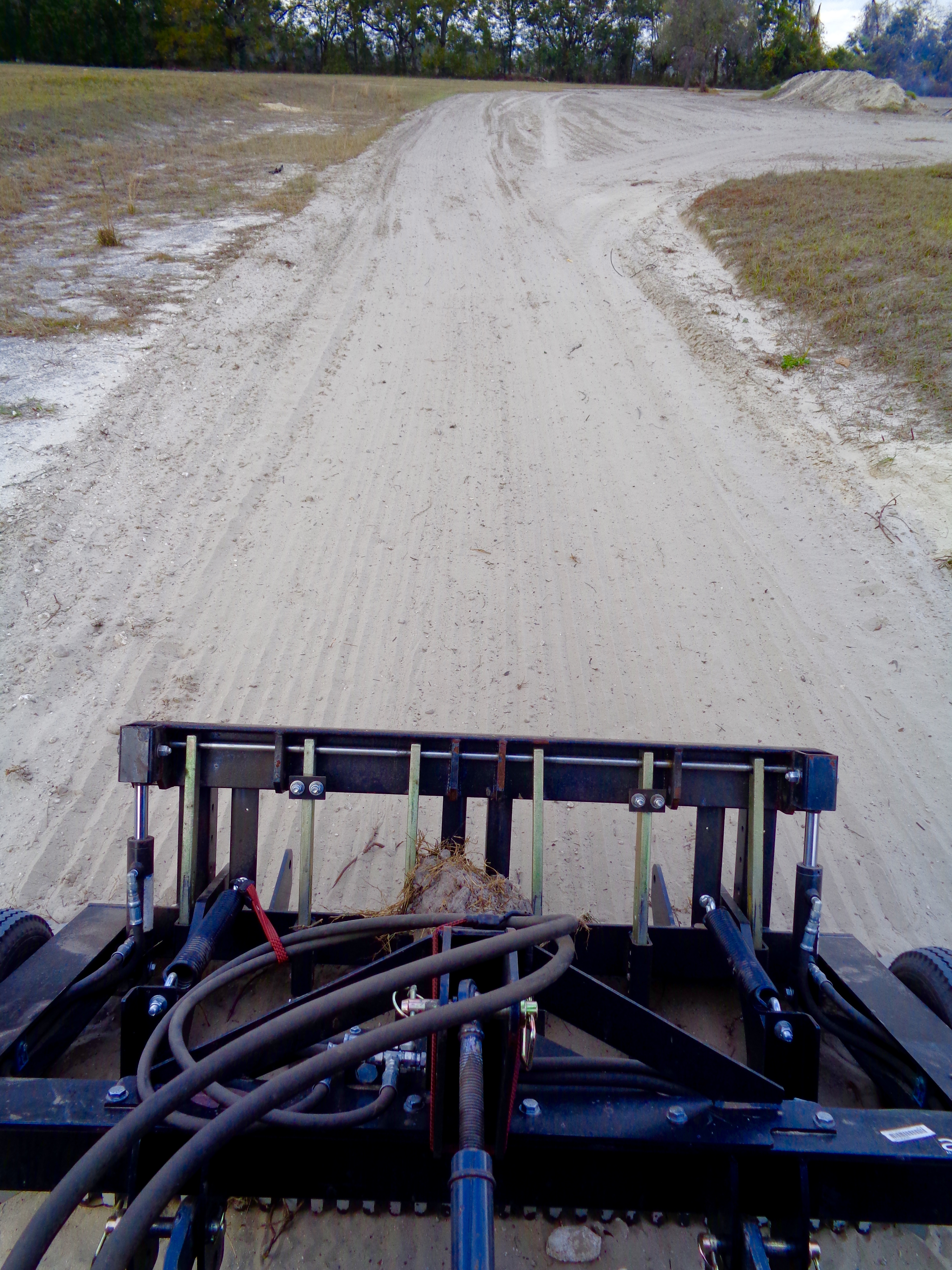

TR3 MODUS OPERANDI
With the TR3 and Tractor on a hard flat surface, and the scarifiers lifted out of play, adjust the TR3 using the Top Link so the Leveling Blade/Floating Drag Bar and the Finish Rake contact earth at the same time.
Once the Leveling Blade and Finish Rake touch at the same time; lift the TR3 and set it back down. This will ensure everything is properly adjusted. The Top Link may need to be adjusted multiple times before TR3 is level. Raise and lower the TR3 after each adjustment.
Use the TR3 with a small reserve of soil in front of the Leveling Blade and a second small reserve of soil in front of the finish rake. See Photo. Reserves fill small holes with each pass, Finish Rake flattens output.
On soft ground, pull the TR3 a few feet to create reserves. On hard ground, lower the scarifiers half way, 3", which causes the TR3 to squat, engaging Leveling Blade and Finish Rake firmly with the soil. Pull the TR3 a few feet to create soil reserves, retract scarifiers to eliminate scarifier draft force resisting tractor forward motion.
Extend scarifiers to loosen notably hard ground.
Use hydraulic Three Point Hitch control to feather-drop residual reserve soil by lifting implement.
