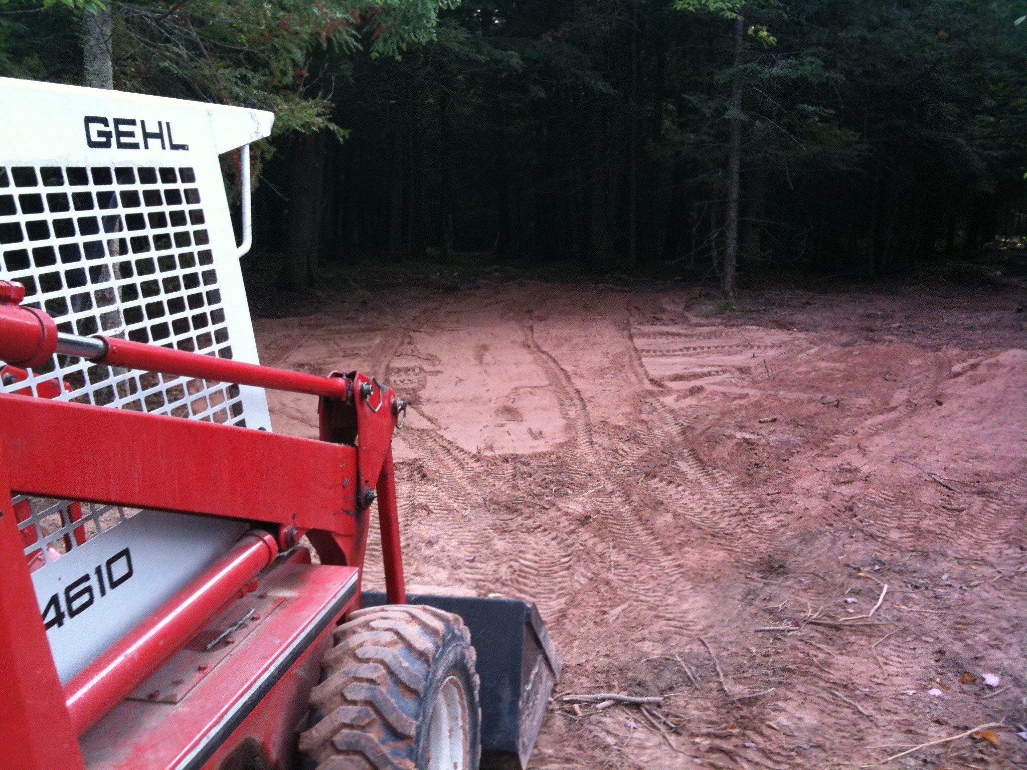

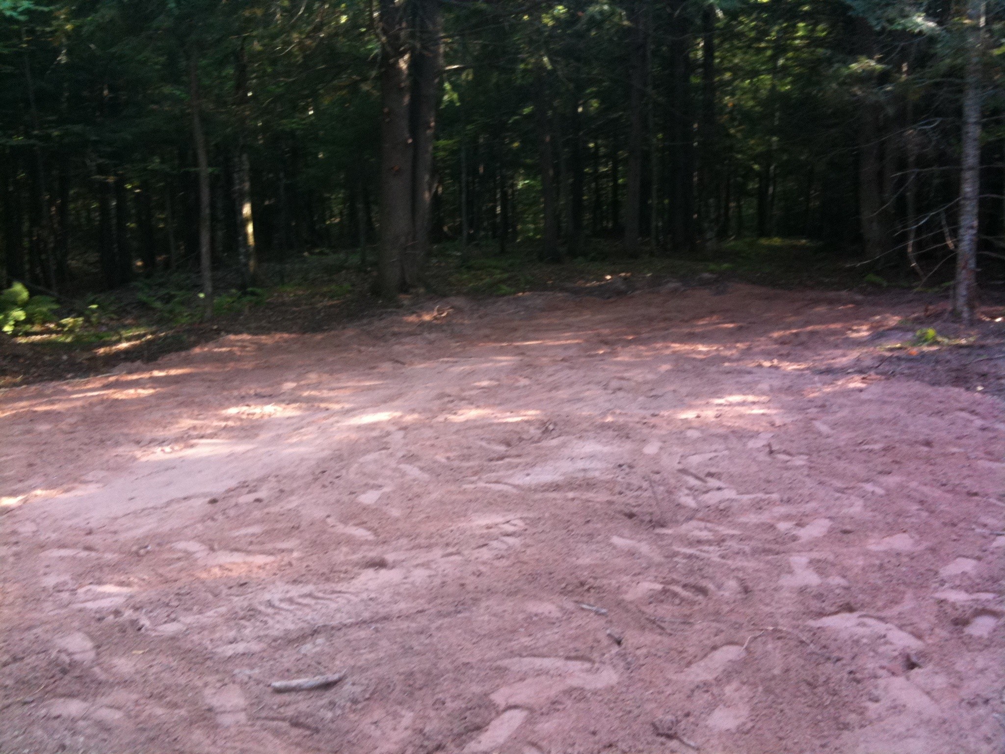

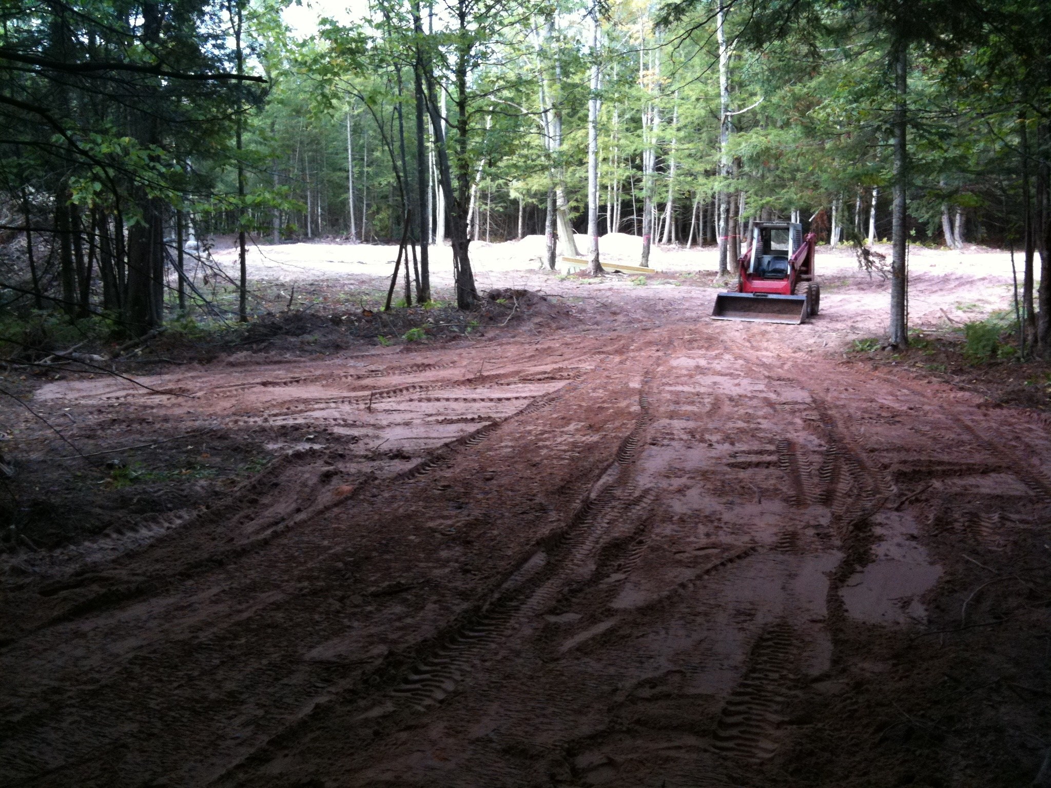

I'm starting a few small projects on a recently purchased property. I'm new to this kind of work, so I need some good advice.
I graded a small area (30' x 30') yesterday, to build an equipment shed. I used 2 trucks of clay/sand mix to fill a big hole in the graded area and to give me something to work with. There is a ravine nearby, just off camera to the left in the first picture. The idea was to create a gentle slope, right to left in the first picture... maybe a 1 foot drop over the 30 feet of grade. The shed will be dirt floor. Do I need a substantial pad?
How do you guys determine when to stop for a small project like this? Is there a book or internet reference for grading?I found myself going over the area again and again, seeing tiny little things that I wanted to fix each time. I spent about an hour spreading dirt, and then 2 more hours touching up with the skid steer and spreading the dirt around with my boots when the skidsteer became too unwieldy for the really fine work. Am I just ****?
The last picure is the finished? product. I may go back with a garden rake and clean it up some more.
Is a skid steer an appropriate tool to use for a small grading project? If I use a tractor, what attachments should I use? I'd like to do my own grading for a garage next spring, and I've got some roads/trails to maintain. But I'm struggling with the basics.

I don't know much either.
But, if you filled in a hole by dumping a foot or 2 of dirt on it & spreading it around, don't expect it to be level a year from now. Such things settle over time. Probably be ok for a dirt floor you can level out again later, but you would _not_ wantt o pour concrete over something prepared that way.
Good fill needs to be tamped down with a vibrating plate every 6 inches or so to make it nice and solid like the surrounding dirt.

David welcome to the forum. Looks to me like you did a fine job for a first time. As others said you will get some settling over time so don't get too **** now, you will be doing finish grading again anyway.
Are you planning on a pole building or one built on concrete footings? I am also a fan of placing the building on a raised pad when possible. Water just don't run up hill.
For an area like you are working I would rather have the skid steer than a tractor in there any day. It can be done with a tractor but the skid steer excels in maneuverability in smaller areas.

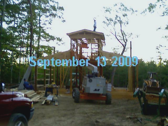

When I built my pole garage I needed to build a pad. I used a laser transit and my tractor with a box blade. I have a hydraulic top and side link so that helped a bunch. When do you stop? Who knows, whenever you are satisfied I guess!
If this helps, here is what I was able to do with my 24hp tractor and box blade. The first pic is what I started with.
