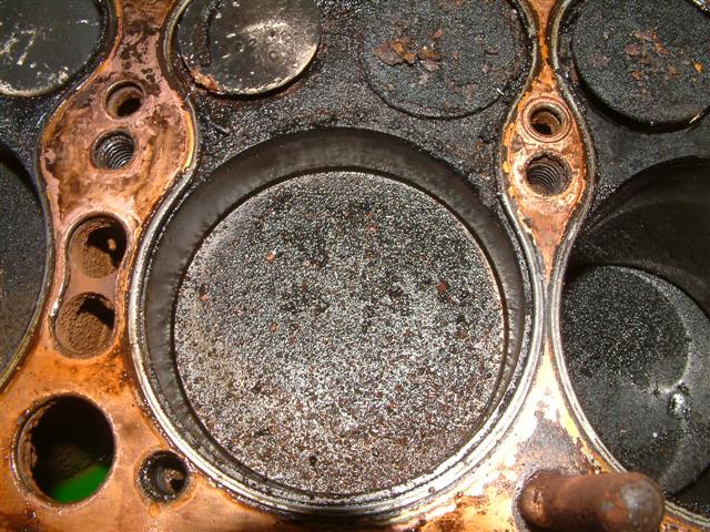

After removing the rocker arm and decompression assembly, I removed the fuel injectors. They had crud built up on them. I saw oil inside the intake manifold where it had been sucking the excessive blow by and the exhaust manifold had a lot of carbon build up in it. Shees, what a moron I am, looks like I won't be re-routing that breather tube anymore!
After removing the head, I saw carbon build up there and also on the top of the pistons.
You can see the head gasket is still on the head in the second photo below. I had no head gasket leaks of any kind. Once the bores were exposed, I saw a pretty good indentation where the rings had worn into the liners. Of course I will be cleaning everything before I re-assemble.

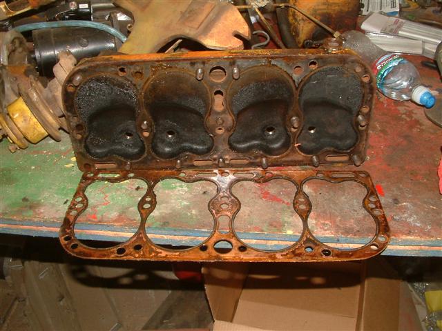

Rob: Interesting project. Looking at these photos, I'm reminded of what my 1951 Minneapolis Moline BF engine (a Hercules 4-cyl gas flathead, 27 hp or so) looked like when I pulled the head a few months ago

No compression on 3 of the cylinders, 30 psi on the 4th. So I hauled the engine to the machine shop for a complete overhaul (cyl sleeves bored 020, new exhaust valves, new valve seats for unleaded fuel, crankshaft ground 010 under, head milled flat, flywheel milled flat, new exhaust valves/guides, new bearings all around).

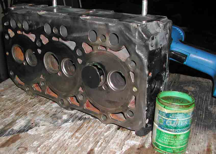

I have found that using a cordless drill on the end of the handle and alternating directions every 5-10 seconds or so is much faster than spinning by hand and does a good job.
That's almost how I do it, too. I thought, "there has to be a better way", once when I did my first 32-valve engine. First coarse compound, then
fine.
You can barely see my drill in this photo. I chuck it up around the valve
stem, instead of using the wooden rod with suction cup.

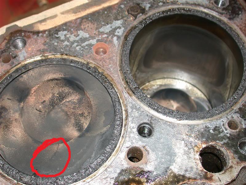

Is that piston cracked?
You know I haven't check it close enough.
Good eye! But that is also the piston with the that broken ring and the first ring groove has doubled in width. So I ordered a new one and it will be replaced anyway. I'll take some photos of the new components later today and any progress I make.
