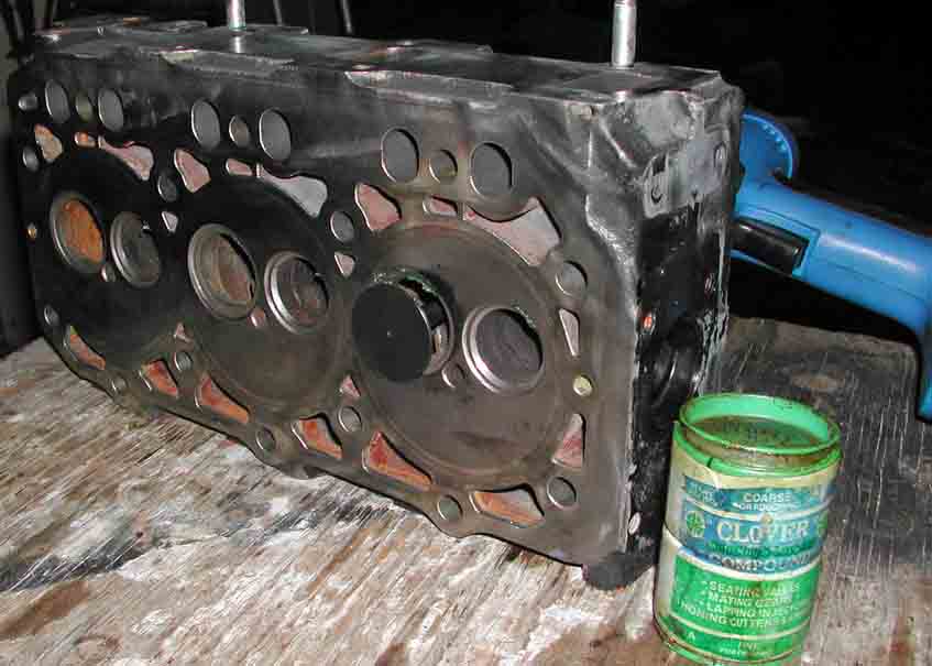

My new gasket is the same as the old one.
It has steel crush rings that seal onto the liners. There is also one small copper liner on one corner of the gasket. The rest is a fibrous gasket material?
-In the first photo you can see the new gasket on the right side of my desk. (Zoom in maybe?)
-Second photo is of the engine block where you can see impressions of the old gasket before I cleaned it.
-Third photo is of the head before cleaning. It still has the old head gasket on it. Parts of it had to be scraped off, but it did come off mostly in one piece.
Maybe you can tell me from those photos below?

OK, the liner is held in the counterbore with the built in crushable alloy fire ring (correct term) on the head gasket which is indexed on each liner by the liner's projection above the deck. It appears that your gasket is not the laminated type but a rigid composite type similar to "Victacore". The copper eyelet is the larger main coolant passage at the rear of the block to assist in more even flow at the rear which is furthest away from the jacket water pump.
The surfaces on the new gasket will require some type of wetting or bonding agent because they are not coated or "filmed". The spray-on type sealer will work (not the HY-Tack adhesive type), or the brushable Indian Head gasket shellac will work too.

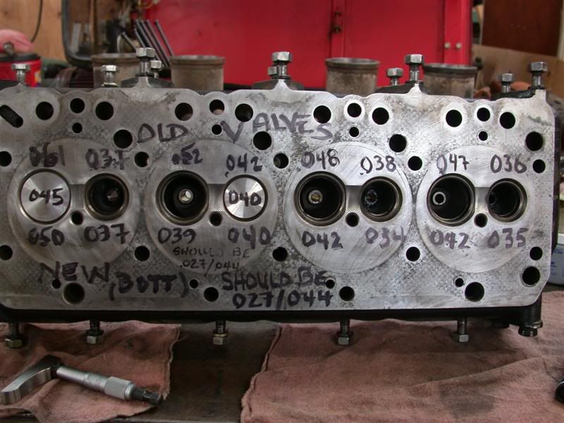

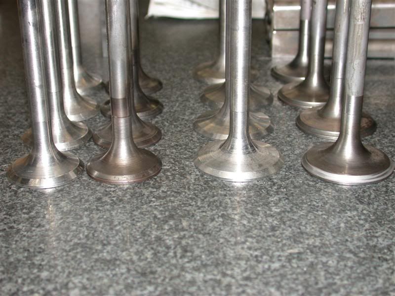

Wish i saw this topic earlier to answer a few questions about the valve measurements.
One thing a lot of guys do not think about when checking valve installed specs is what is called the installed spring height. When a valve pounds into the seat the stem comes out the other side farther. Geometry is not as much of a concern as the spring installed height is because grinding the tip of the valve will not change the installed spring height. Checking installed spring height is done by installing the valve and spring retainer without the spring and measuring the distance from the bottom of the retainer to the head surface to get what the spring length would be when the valve is closed. This is important because the longer that measurement is the lower your spring pressure will be at closed position, keeping in mind the spring pressure is not linear and the closed valve position is the lowest and not too far longer it drops off fast. The adjustment is easy, you add shims between the spring and head, or in worst case, you have new seats installed and start over. But when installing new seats and grinding the angles, the amount you grind down is to get the installed spring height set. once spring height is set the other two angles are put in to get the seat width and position on the valve set but the installed height will no longer change once the main contact angle is cut.
Like I said, spring height is often ignored but very much a starting point for a proper valve job.
The measurement they were giving you was not so much for installed height as it was for piston to valve clearence. Kind of odd they had you check that though, i wouldnt think this would be that close of a clearence engine to worry about that. Did they give an installed height dimension?
That is very true. It's been a long time since I've done any valve work on small engines and it completly slipped my mind. I always started with .030" spring shims. And technically, you should also check the valve springs for correct height and resiliency with a torque wrench and spring test stand.
This is why, with all of the different qualifiers involved, it is worth my time to just take the head to a good machine shop and let them do their job too and leave me to do all of the R&R work (which can be just as technical and critical).
