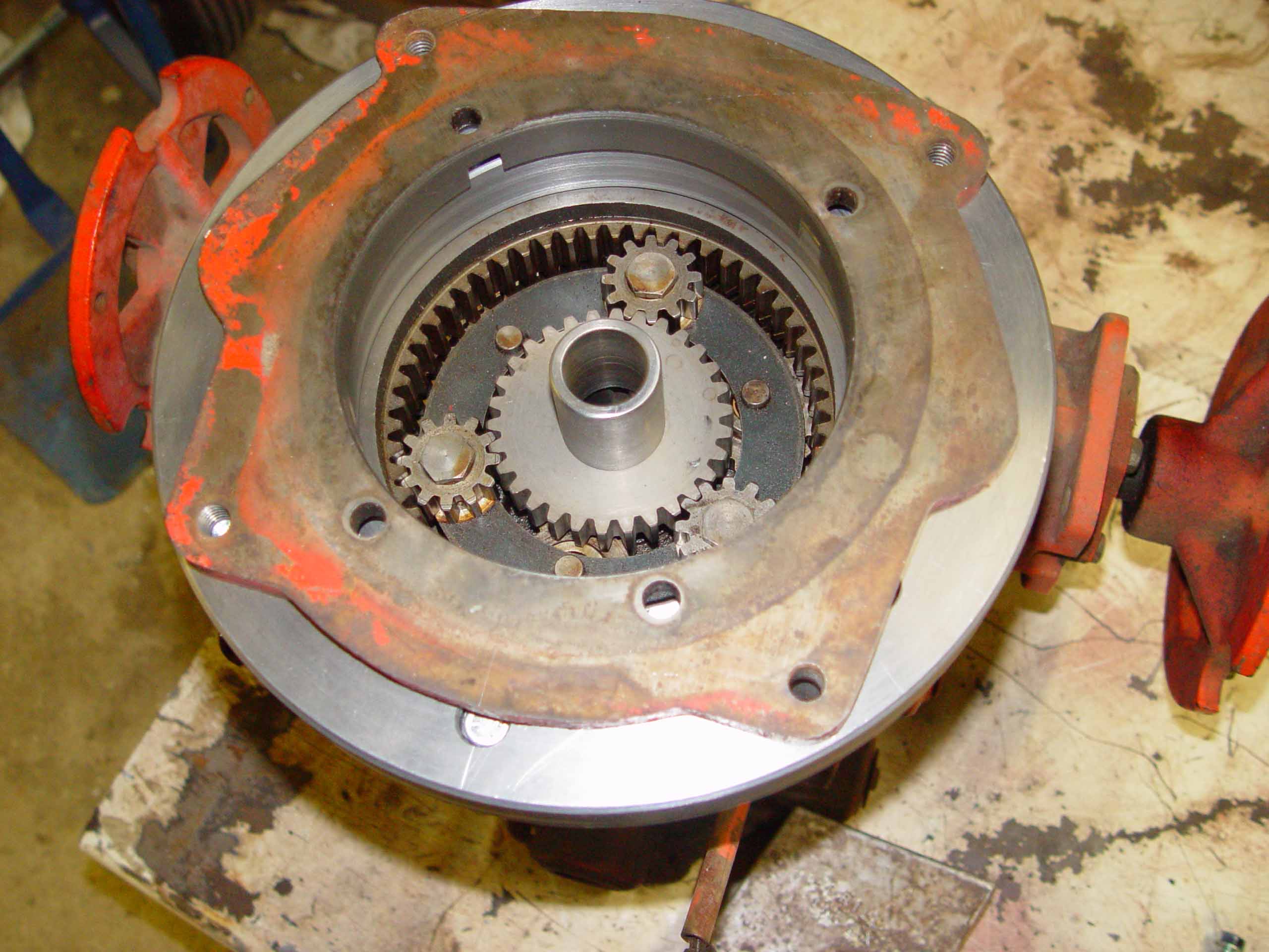

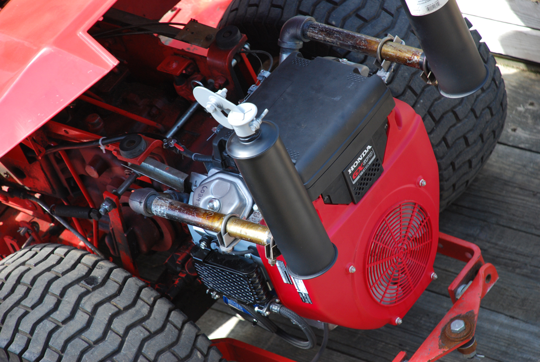

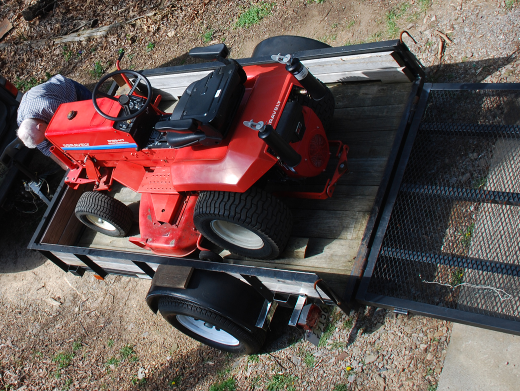

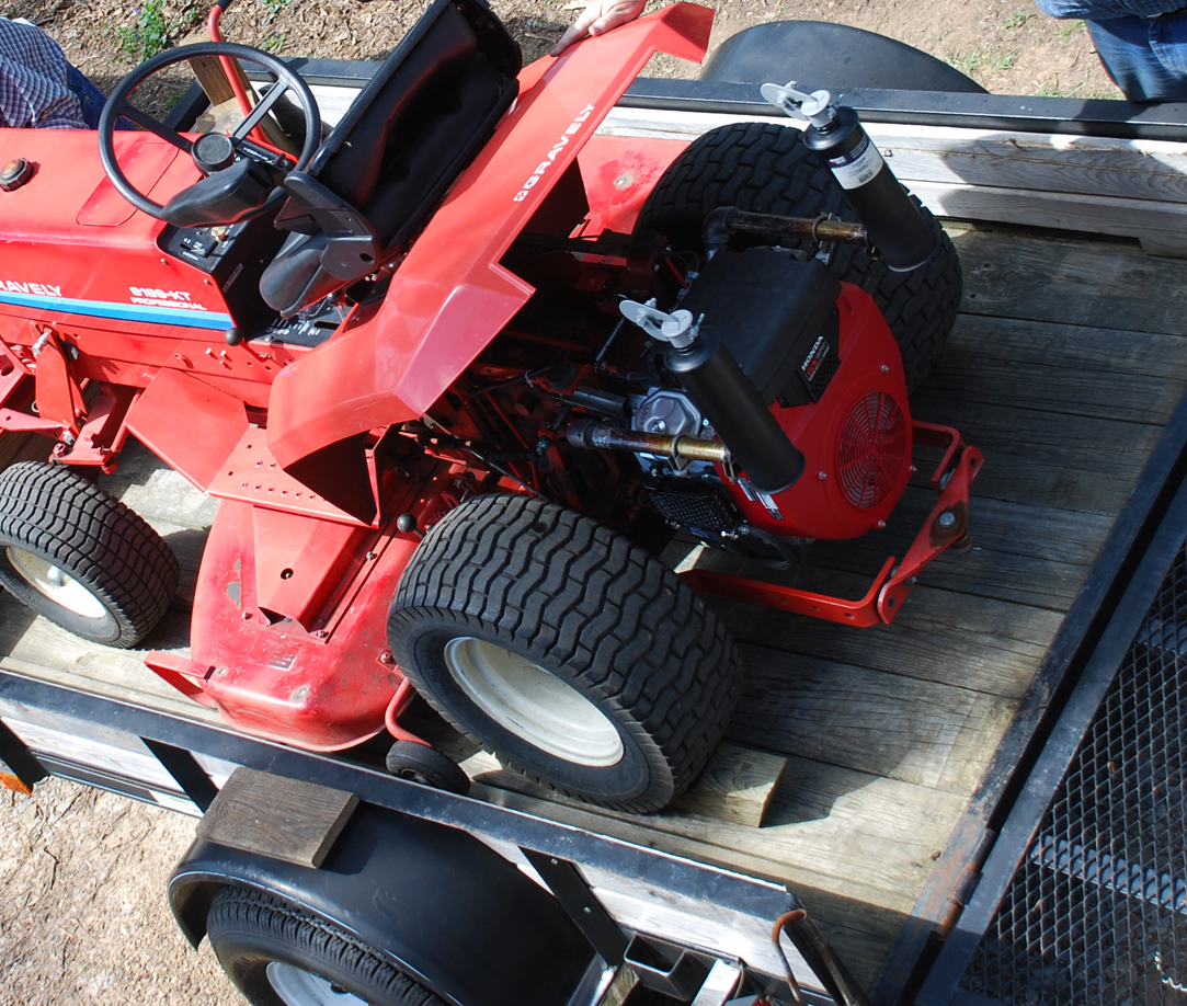

Off subject but here is what I have been doing in my spare time .
part of Monday and part of Tuesday.
Going from 19 series II Kohler to a 24 Hp Honda:thumbsup:

/ Engine ideas #344
Is that yours or are your doing this for someone? By the way it looks very professional!

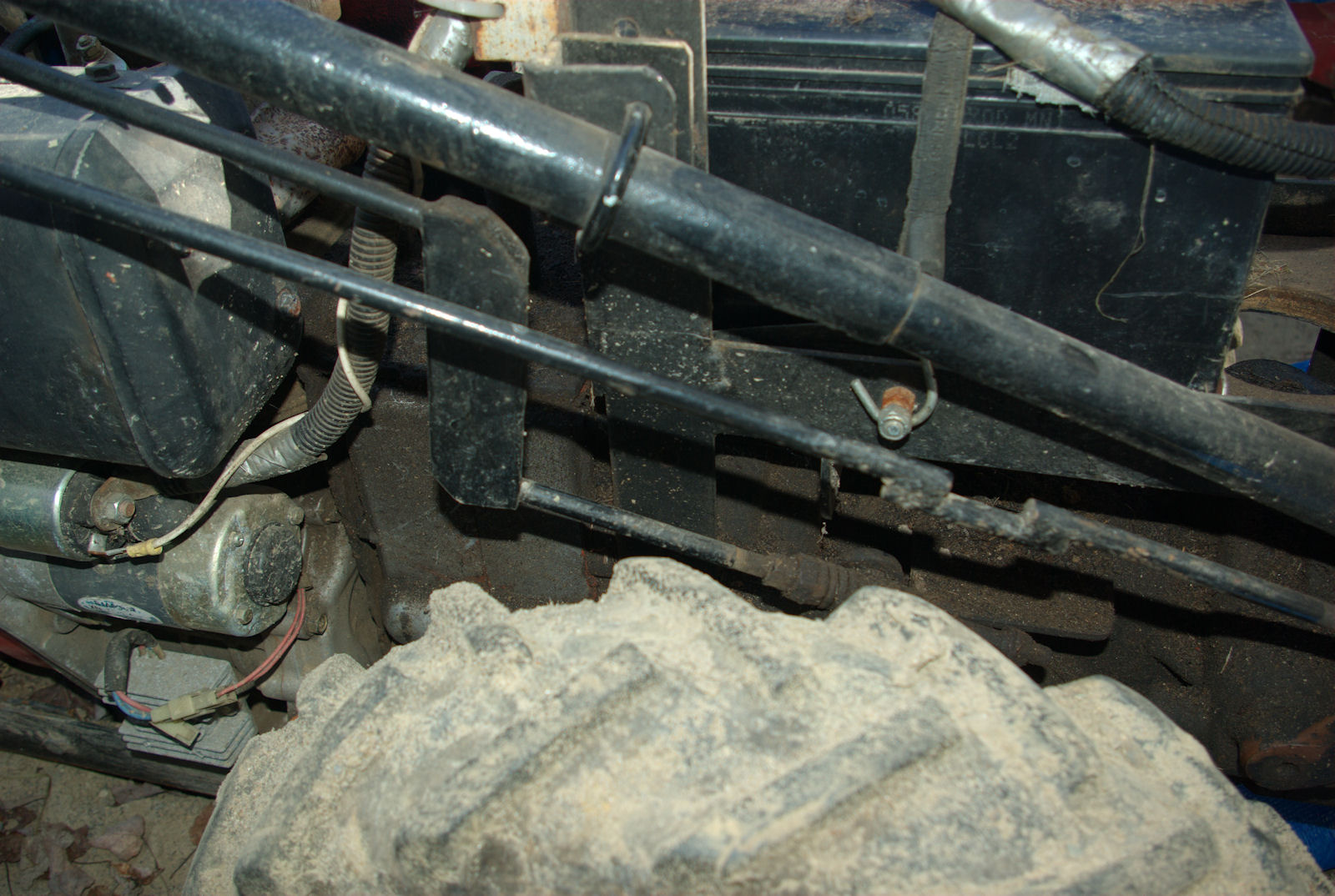

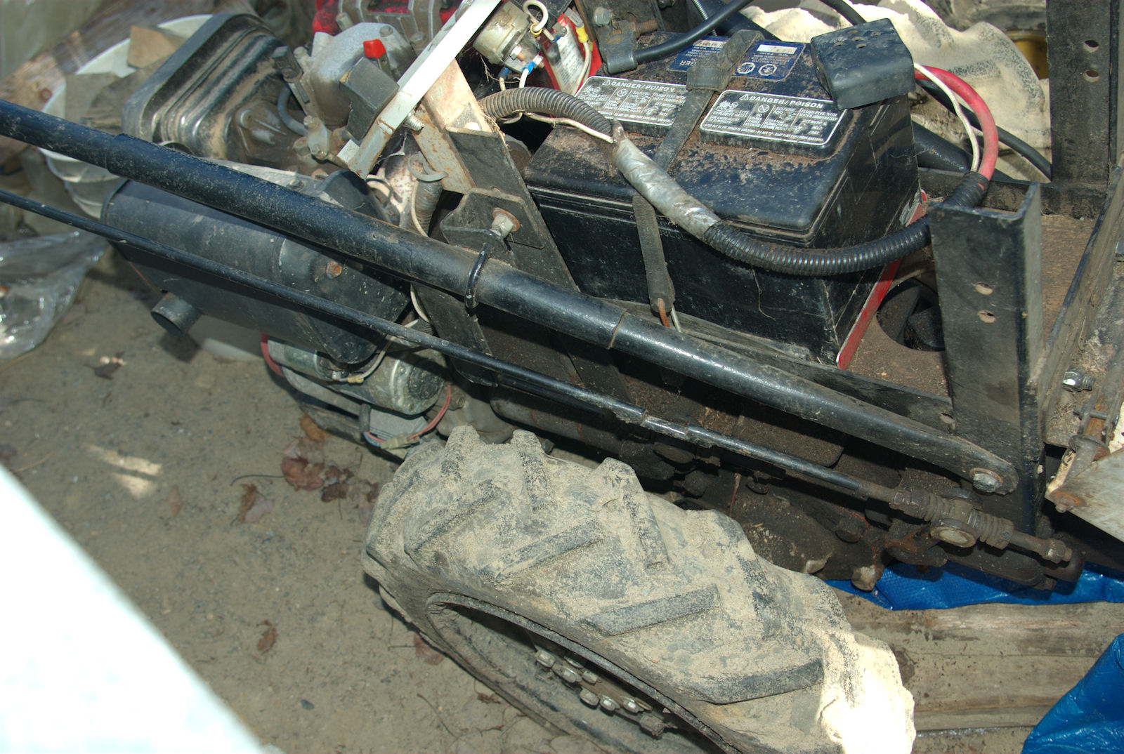

Hi! You make always very good job! For my Gravely diesel. I make a special frame for put battery and fix handlebars. The ends are 4.5 in. more high and I add a tube ( In middle) over for renforcement. I make one offset 4.5 in on one rod shifter for muffler. The Gravely diesel with reduction wheels make about 500 lbs. Very powerful tractor. I add picts . Good luck! Oldmech

Hi Oldmech
You made a good repower.:thumbsup:
We have talked a lot about repower of the L for a long time.
I plan to get back to the L tomorrow .:D
I like your reinforcement of the Handle bars.
I plan to split a 1 pipe for reinforcement
I have decided to put bolts through the handle bars.
Also plan to put a rod between them
I'll use a solid round and tap the ends
I repowered a C10 with the Gear and it runs our Good.
I set the gov where the engine top speed is 2600 Rpm.

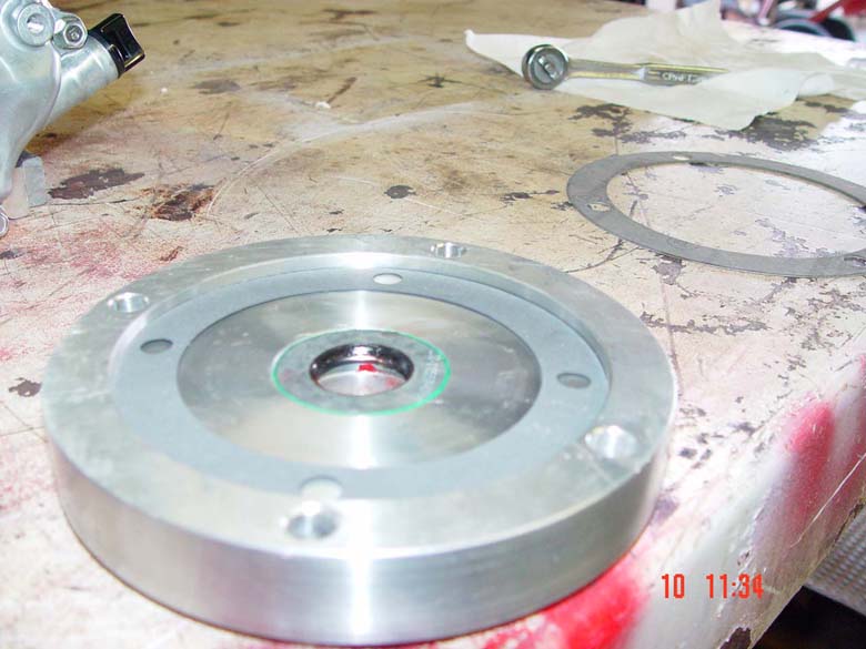

So I got everything done on the adapter end on the LI.
Now got to set up the handle bars and the pto lever.

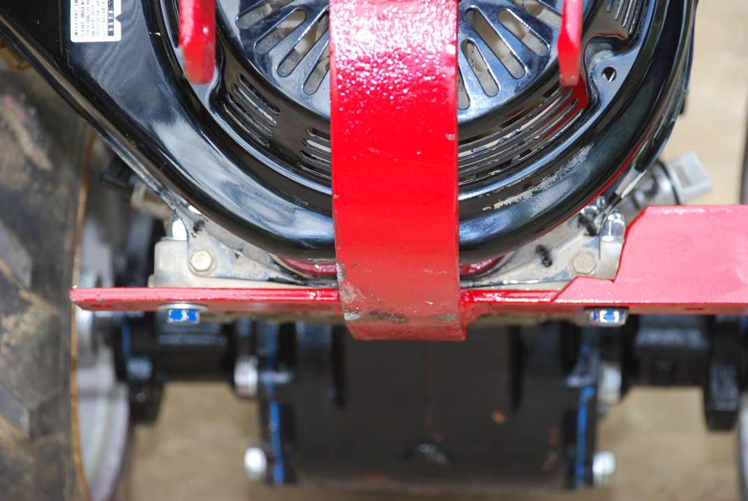

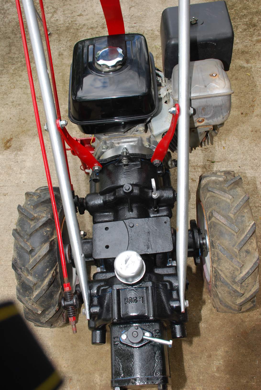

/ Engine ideas #349
Got everything together :thumbsup:
put the oil in it and had a oil leak wheel seal !!!!:mad:
Maybe I can get back to the LI Monday ? :thumbsup:
Thanks Bruce g
/ Engine ideas #350
Thanks Bruce g

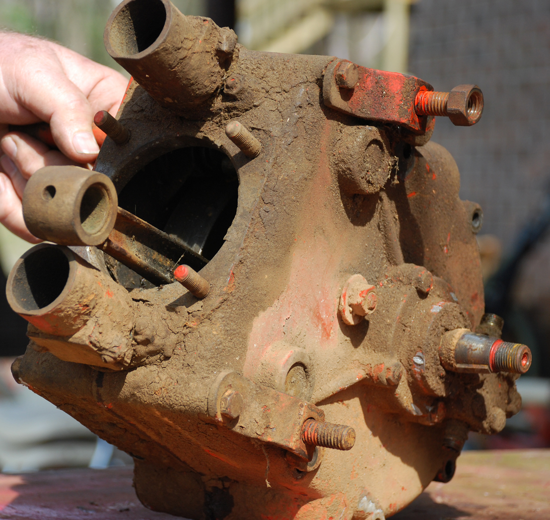

Hi One
I changed out the seals in my Repowered LI
It is not a easy job unless your hubs are loose.
The hubs can be a pain.
I used a 3 legged car wheel puller put 3 bolts with Large washer
thru the hubs at the slots.
I dogged it down petty tight
Held a hammer under the hub under the taper.
and smacked it hard on both sides
tightened a little more and smacked the end of the puller.
it popped loose.
I left nut loose but not off enough to hit the end of the puller.
I had about 1/8 of play.
The reason for that is when they do pop they can jump across the room.
So now all i have to do is take the 4 bolts out.
Best drain oil first.
the cap can be tight so you have to wake it up a little.
The seals are in the cap.
There about 3 different seals styles and different OD sizes.
I had a set of seals for a C10 but the LI is different then the C10.
I went to Applied industrial but they did not have a seal like was in it.
But they had two seals the right ID and OD. so I got them and put them in.
I used Blue glue (RTV) on the out side and grease on the inside .
Both seals are for 1.00 shafts but the OD is different.
If the hubs are loose and the cap is not tight it would be easy.

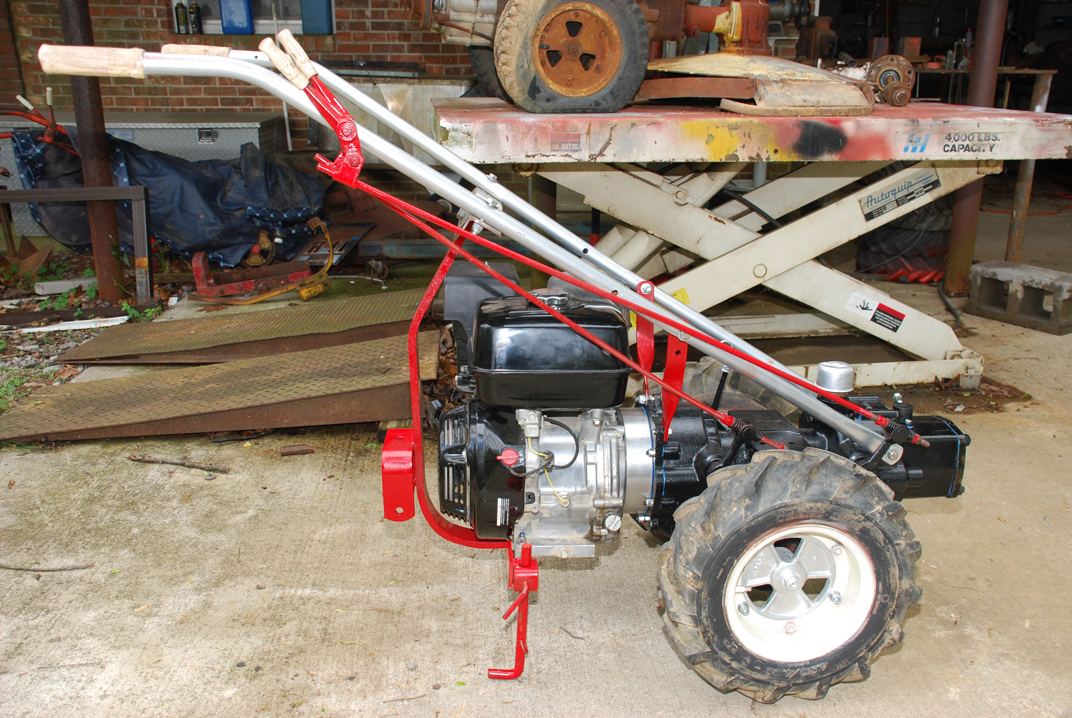

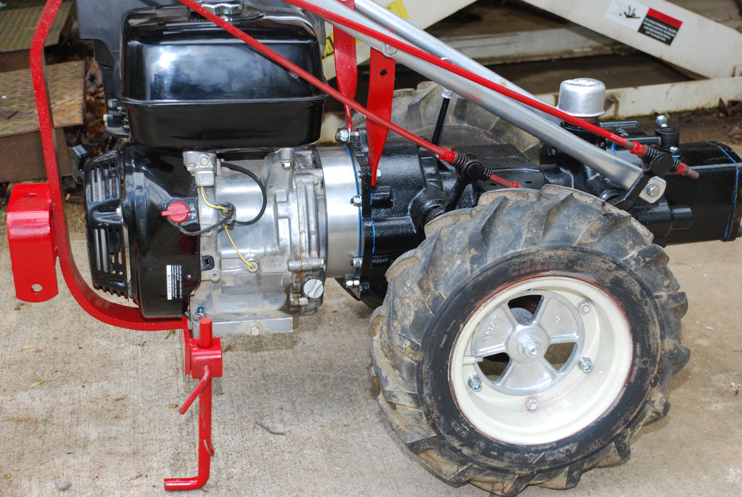

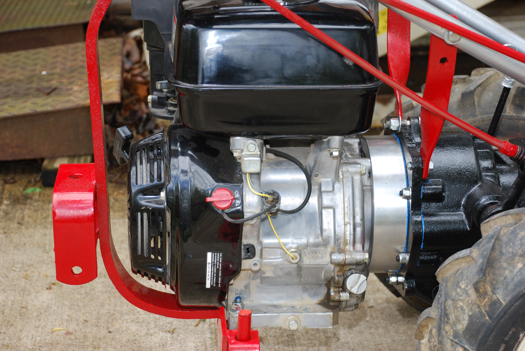

BTW here some pictures of my First L Repower ready for work.
I got a lot work to get a mowing deck ready.
Thanks Bruce g

/ Engine ideas #352
Silver and black paint to match the new motor. Some Gravely purists would be saying things, but I guess they'd gripe about the new motor, too.
/ Engine ideas
#354
Hey real nice looking L you have there Bruce,,, great job man!
/ Engine ideas #355
I like the color scheme too. Very clean job! I like the bolt used to engage the PTO. That's what I have on my tractor. In my view the remote PTO engagement system that came on the Ls is the weakest part of the design. I feel like Gravely could have done better on this. Everything else on the tractor is bullet proof. Cant wait to see your machine in action.

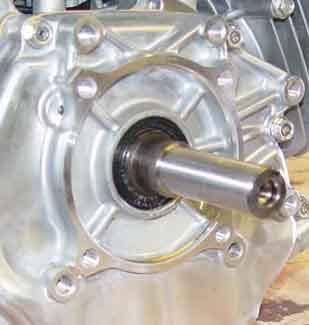

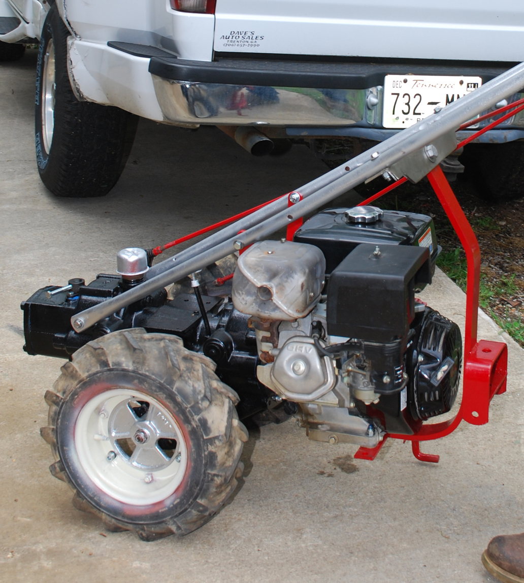

You know if you plan to repower the old L s all you use is really the transmission and the handle bars
A Kohler adapter plate for 10-16 hp
There are a lot of 8 speeds with out engines or don't run.
The one I just did had dropped a rod.
Another thing is to watch for spray washers with the pumps bad or frozen up over the winter
But the engines are still good.
