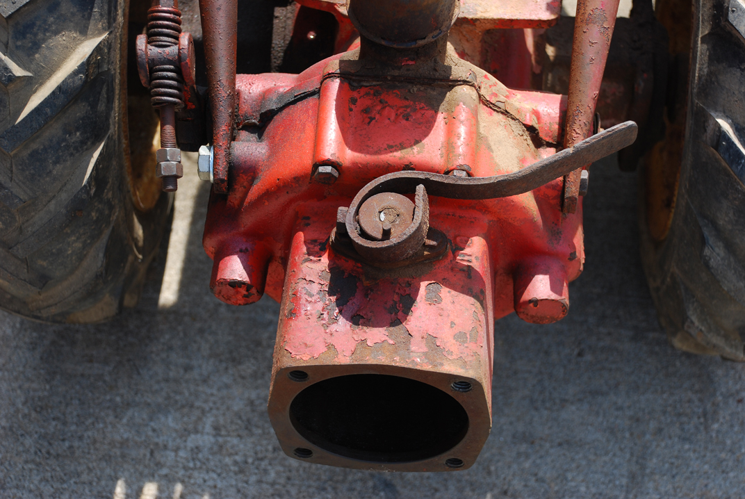

/ Engine ideas #332
Having never seen the output I did not know what those pictures show. Now I see the "duct" and holes for lubrication. Your right, he did a great job. Thanks again for your input, One.

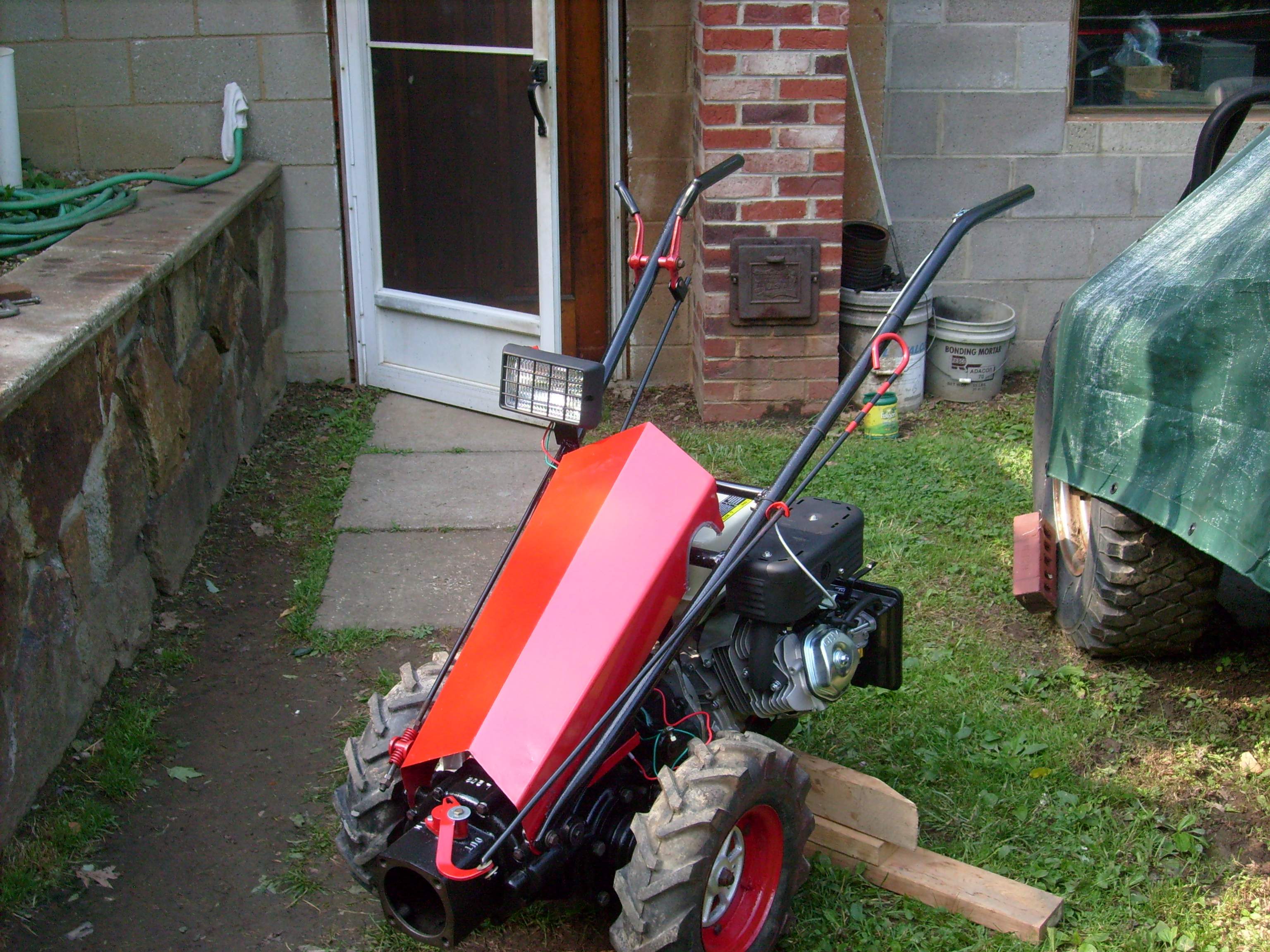

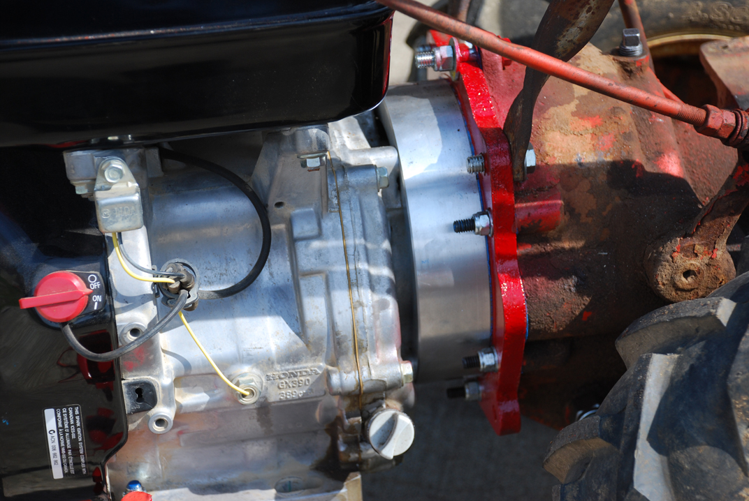

Hi! All Thanks Oneaxepony ! Your infos are right. I use the original input planetary shaft. I dont cut ! I dismantle it from the Gravely crankshaft. The end is taper with a flat nut also a keyway.
I take the Shaft with gear, the brass bushing and a L100 5/8 flex joint bushing and go to machine shop I ask him for fit . The Young machinist make a very good job in his spare time and charge me only $80. Machine shop work are very expensive here . As $70. hour. note the flat nut is inside the flex joint bushing . I joint picts. Good luck! Oldmech

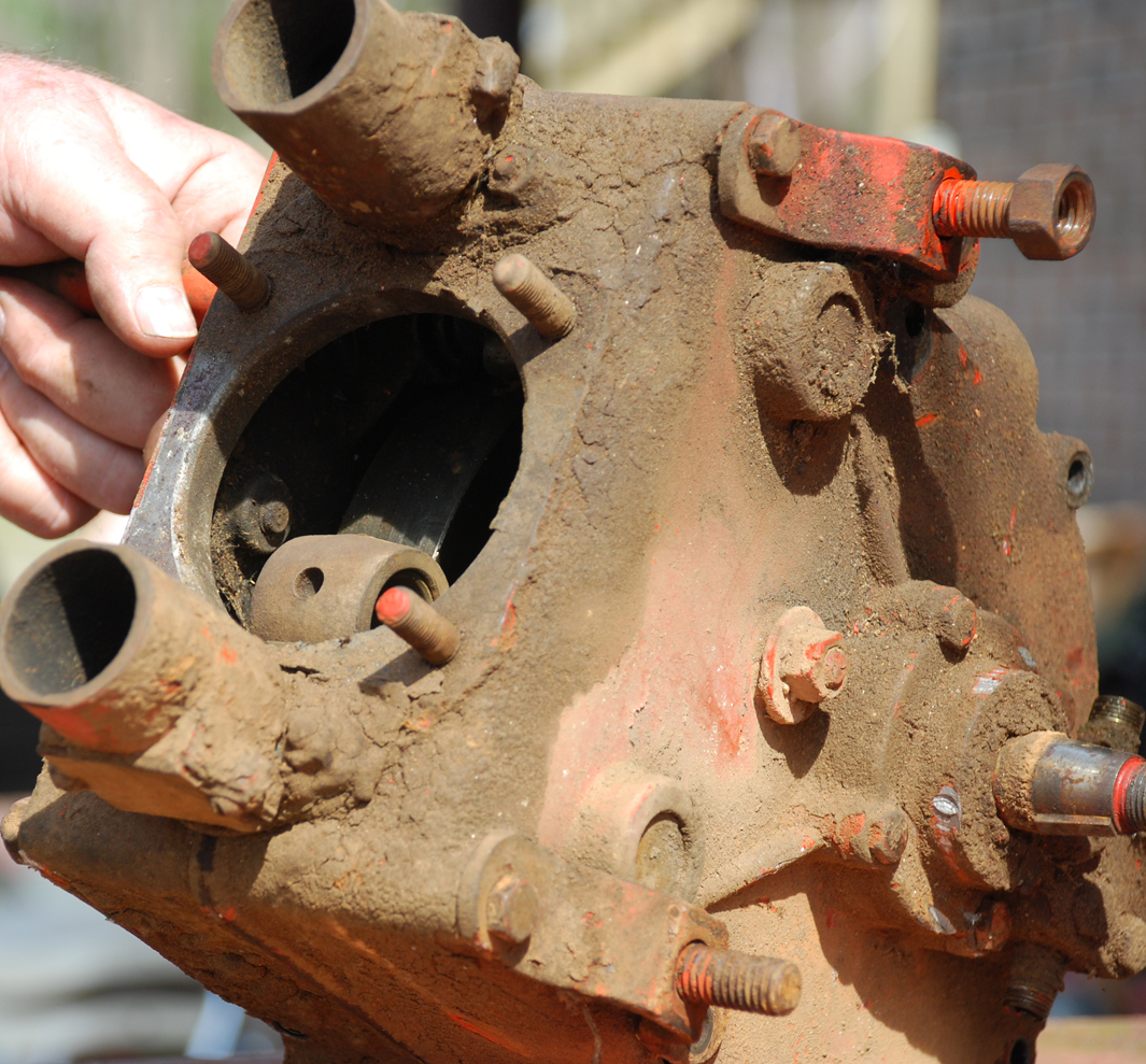

Well got the sun gears today for L ,C8 C10 models
They look good. :thumbsup:
They are high I will have to sell the gear for 150. and the top hat 20.
I had planed to sell them both for 150. but he went up 25.
I have to have a thick adapter plate yet for the L and C8.
The C10 are a different depth into the trans.
The C10 spacer is 1.590 thick I have to use a 2 inch thick material.
The L and C8 are 2.130 so I can't make from a 2 inch thick piece?????
still trying to see what can come up with.
The C10A ,500, 5000 and later are 1.115 Thick
I make those from 1.500 material
The Briggs and all the 3.00 long cranks are 3/4 in shorter.
The Honda And the Clones are 3 3/4 long
I hope this info helps
when you decide to re power.
Thanks Bruce g
423 716 4611
Well I guess I am human
I made a mistake on the Thickness of the L model and C8 instead of 2.130
They are 1.700 So I get out of 1 piece of material.:thumbsup:
It worked out for the good.

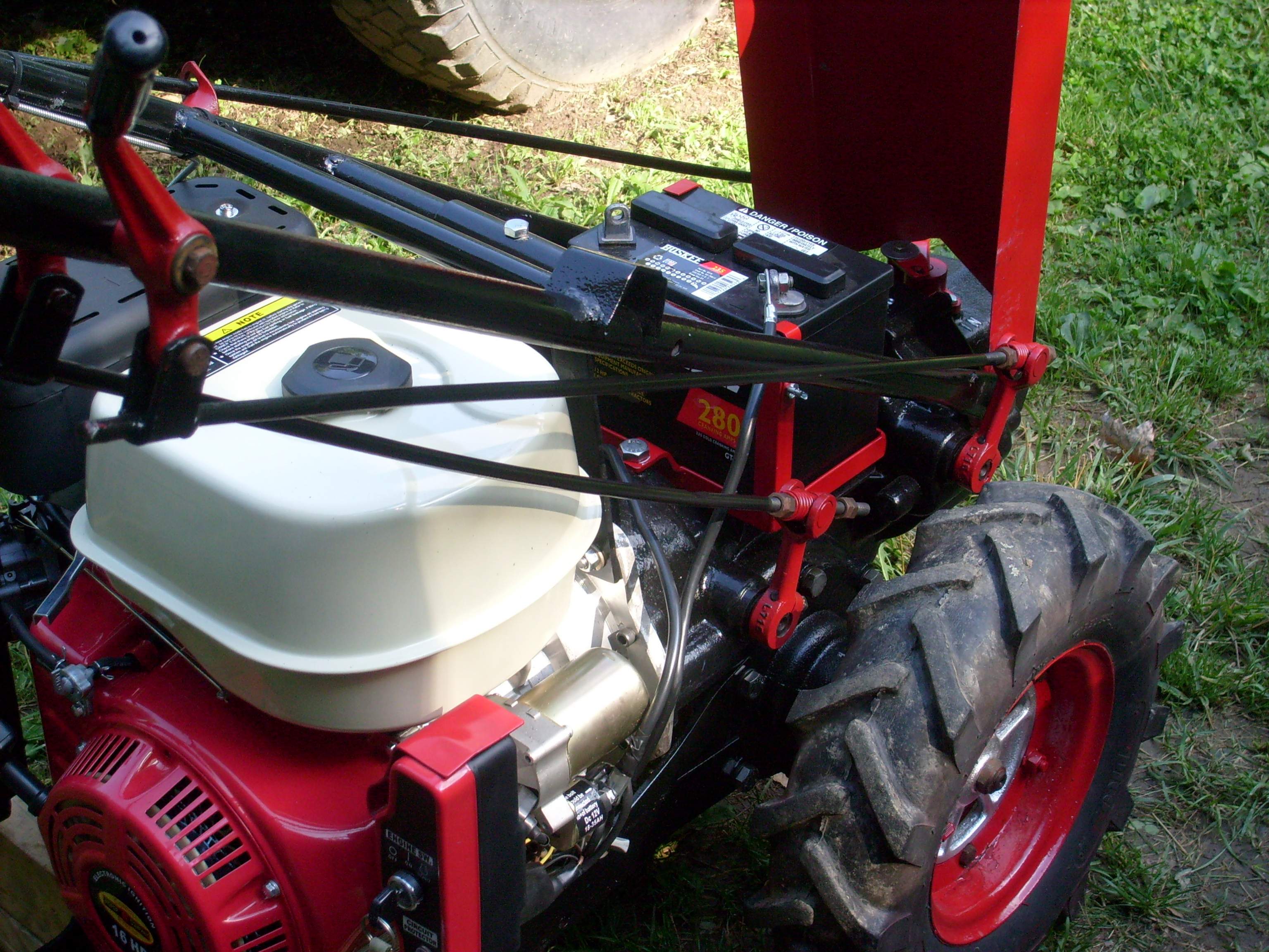

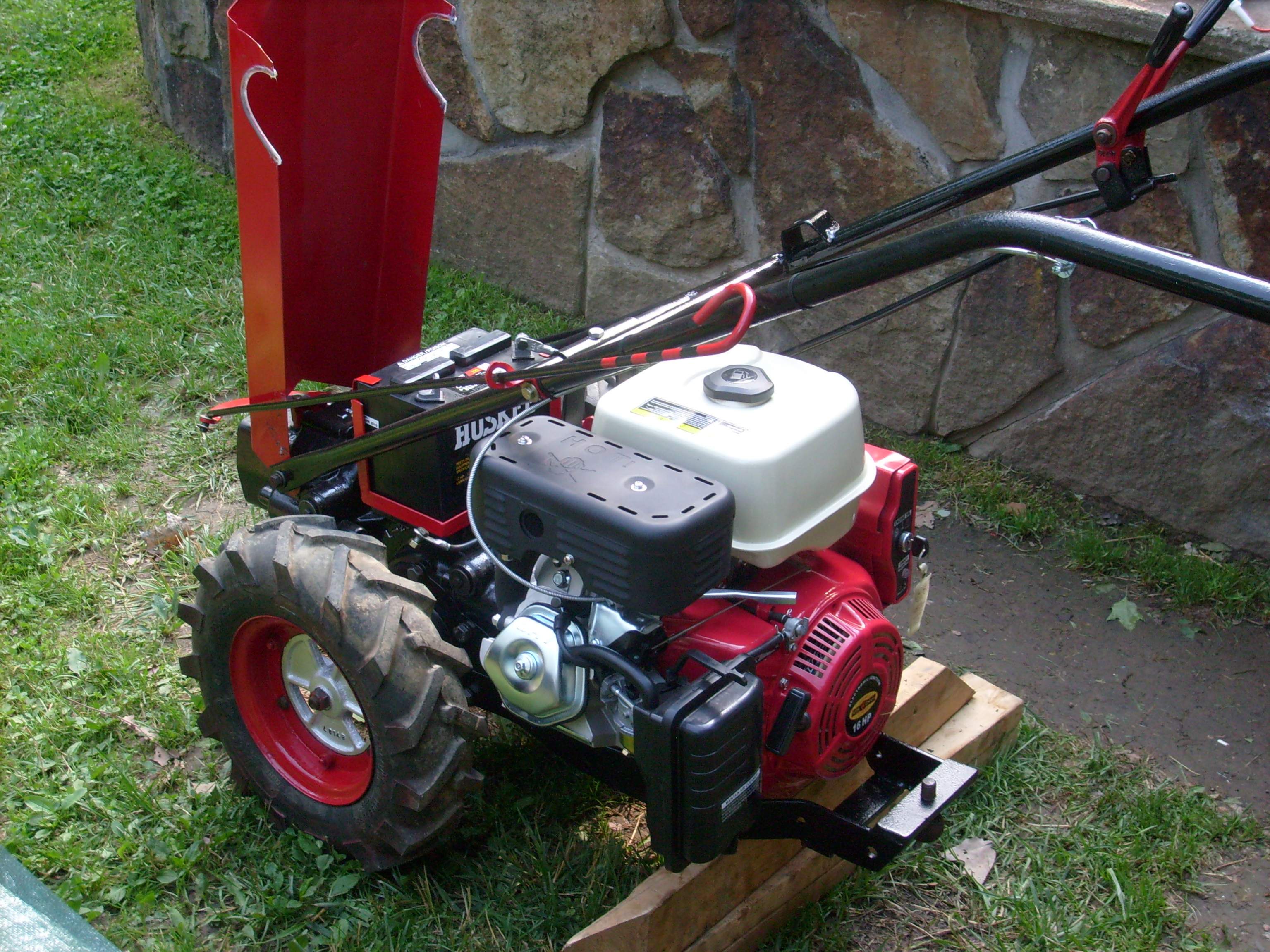

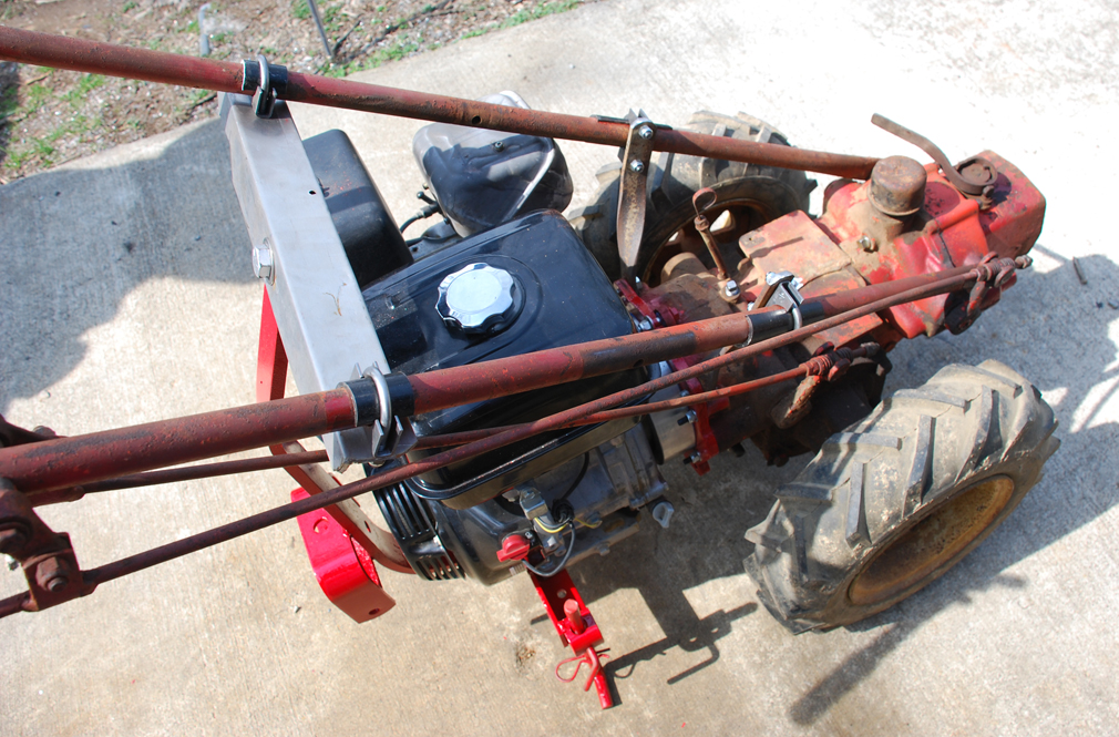

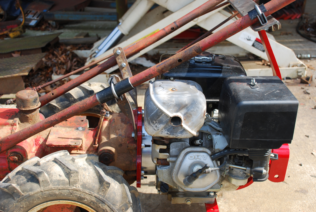

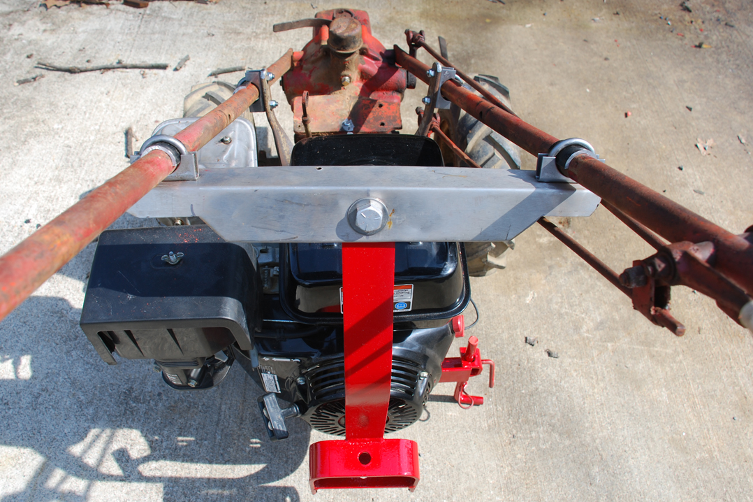

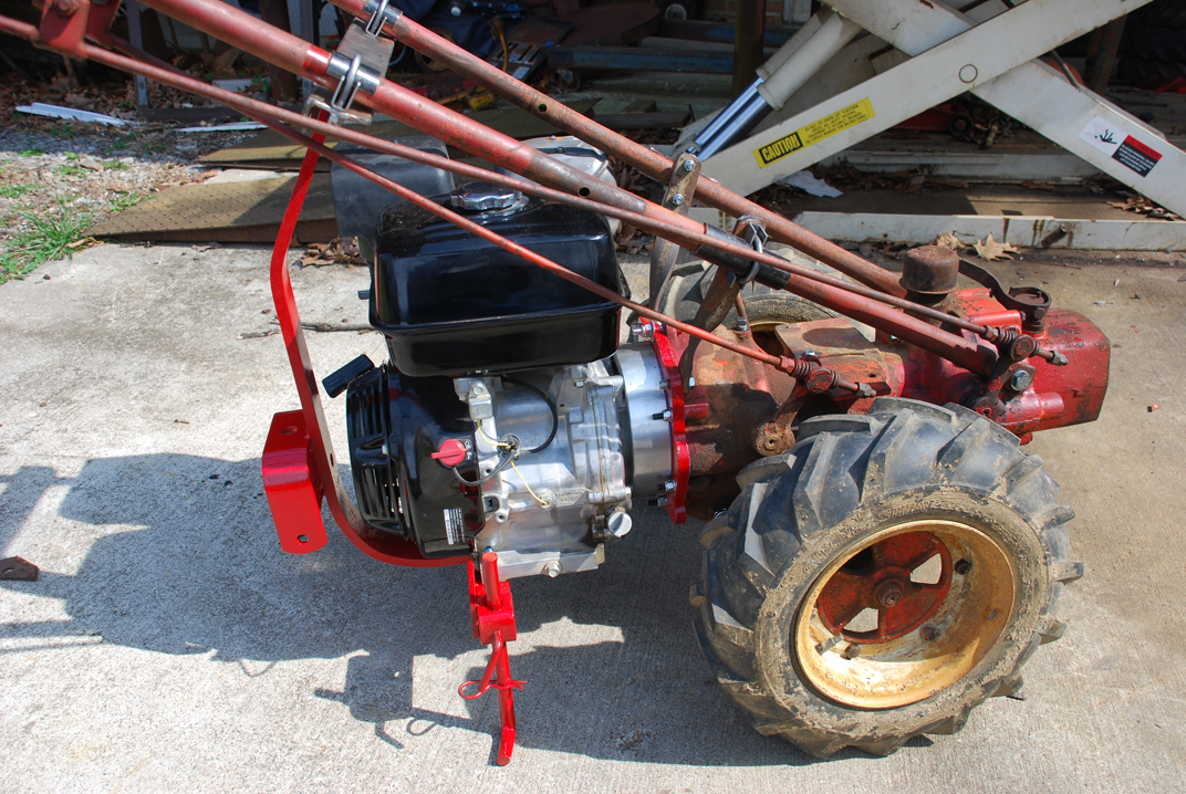

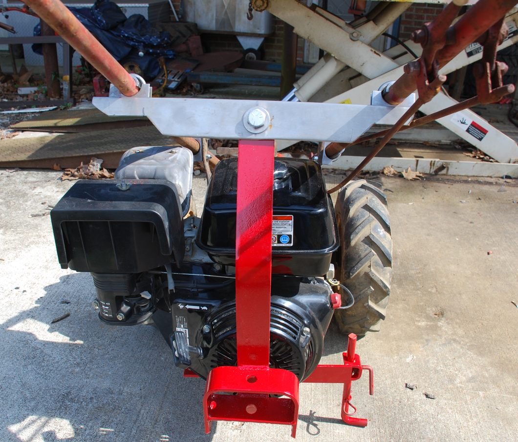

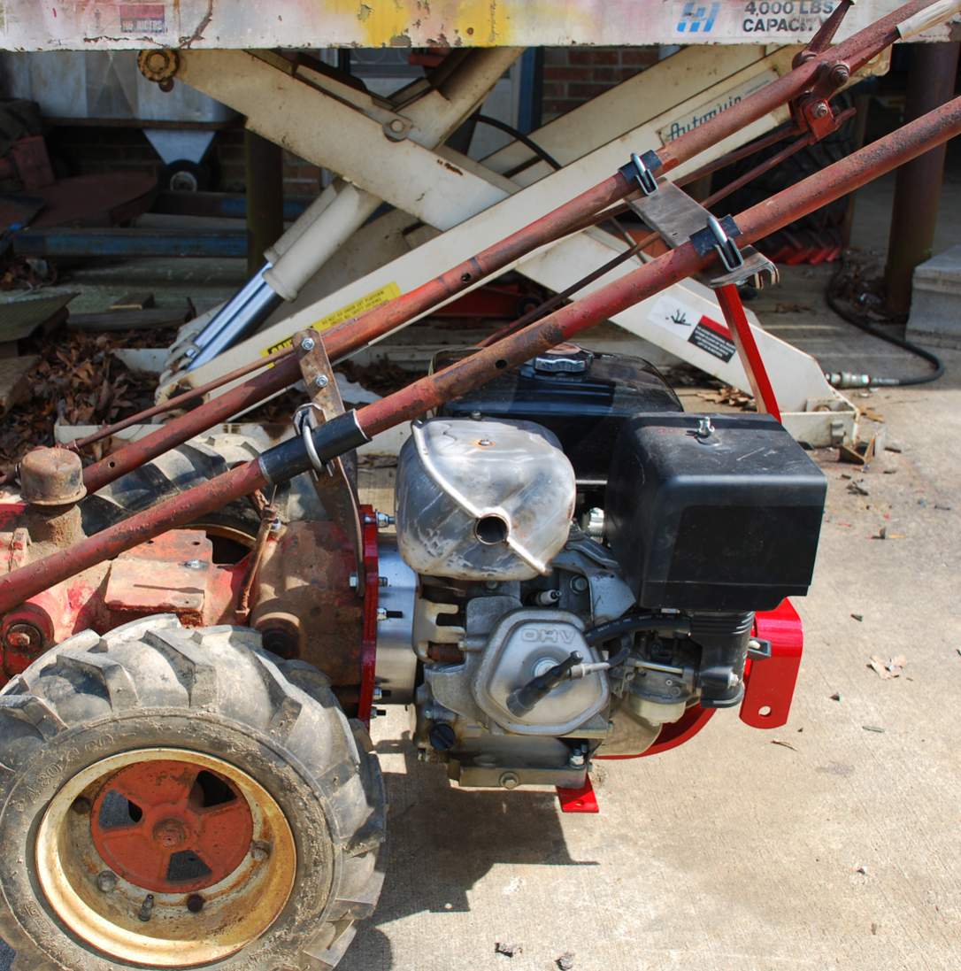

Also here are some pictures of my first a temp at repowering a model L
The old tractor needs a lot work but I though I would see what people Though about my set up on the handle bars and adapter plate.

/ Engine ideas #335
Well I though about the muffler clamps .
They just don't look like they belong there.
I think will just drill holes use a split pipe around
the handle bar for more support.
Like I said that was my 1 st stab at it.
What do you guys think? :confused2:

Very cool, Bruce. Did you start it up? How does the gear with the top hat work? There are lots of ways to support the handle bars. What you did looks perfectly fine. Not sure what muffler clamps are???

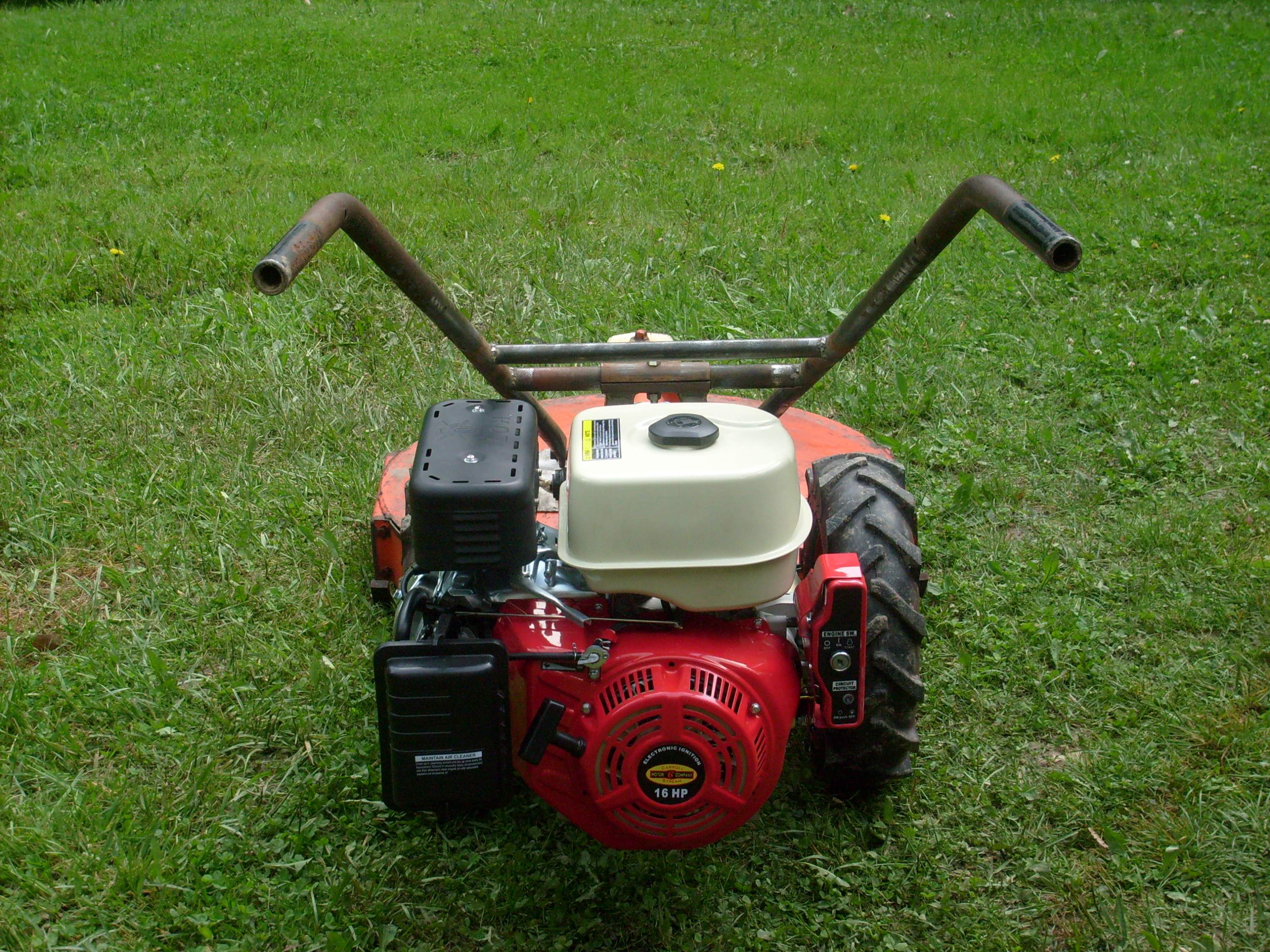

The new engine looks huge compared to the old Gravely engine on L models.
But I'm all for seeing these older units get repowered as these tractors still have years of use left in them if we could solve the engine problem.
If the whole tractor were painted, I think the new engine would blend nicely.

I just mostly trying out how i want to latch everything down.
I have a lot of work to do to this tractor before I run it.

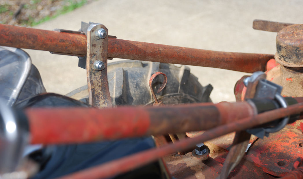

/ Engine ideas #339
I have the gear and top hat running in a C10 sound feels good.
So I put 1 in this one but have not started it until I clean it out and put oil in it

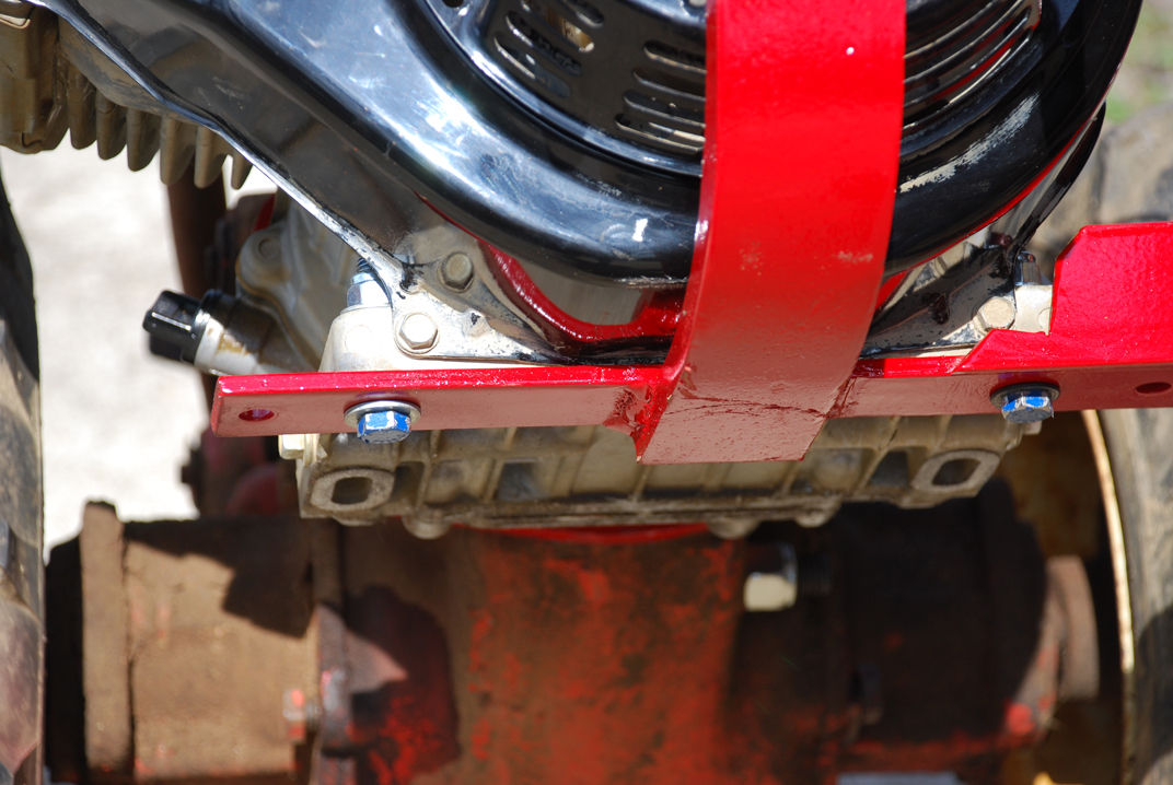

The muffler clamps are Just clamps for 1 1/4 dia pipe.
Here is a closer look at a clamp
Also the old rod had broken into and locked down.
I am trying to make up my mind if a bolt through or the clamp is stronger.:confused2:

/ Engine ideas #340
Now I get it - the clamps are for car mufflers. You are right, they look a little like they dont belong but they do the job. If you drill holes thru the handle bars you weaken them - so putting split pipe around the holes is probably needed. As you get further along you'll have to figure a way to attach a hood. (Gravely L hoods usually rest on part of the fan housing). Nice work so far. Keep us posted!
