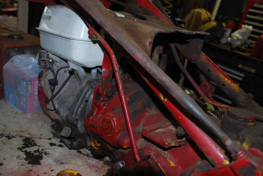

Hi One
Well the C10 is done as for as the conversion to Honda 11 hp
Set the gov at 2700 rpm.
Runs out Good
We didn't clean it up and or paint this one.
He is going to run it a while to see how it checks over a time. :thumbsup:
Thanks Bruce g

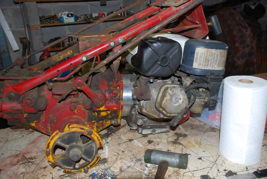

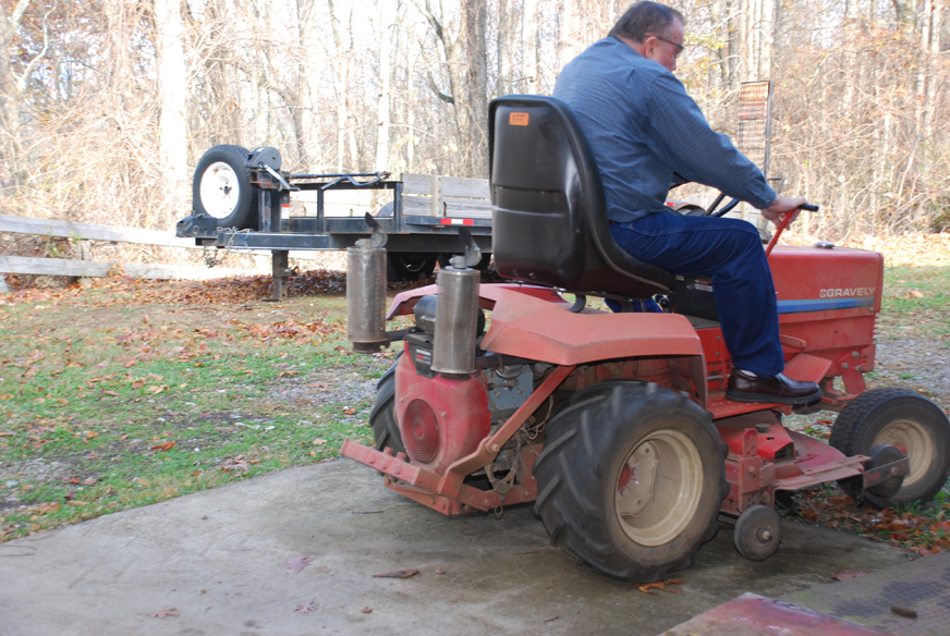

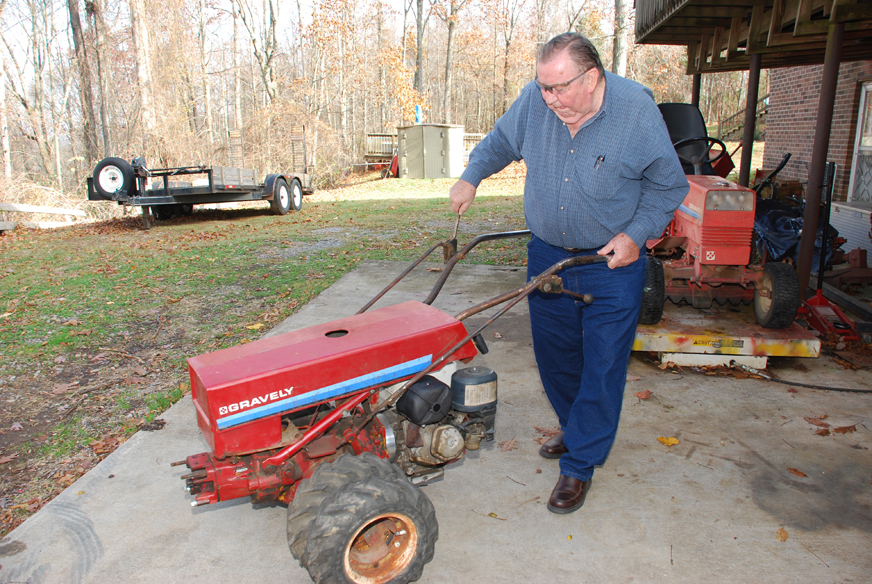

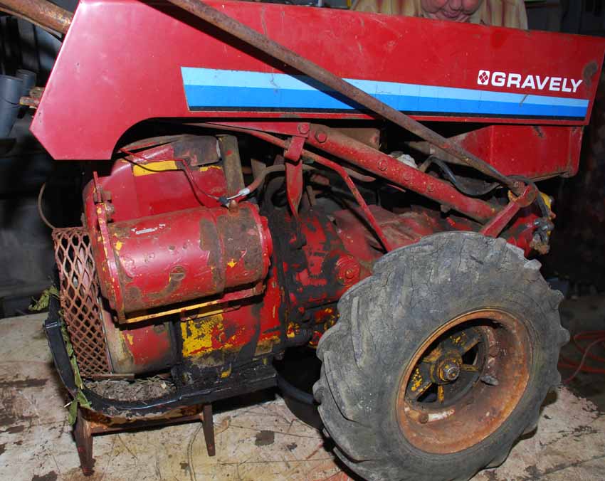

Here is a picture of the C10 with new adapter :thumbsup:
we didn't clean it up.
Also here is a pic of my Tractor
from 8123 to 8243 Honda powered

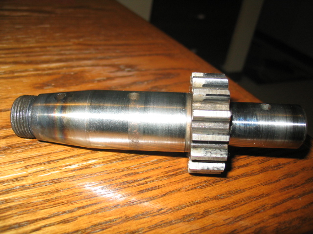

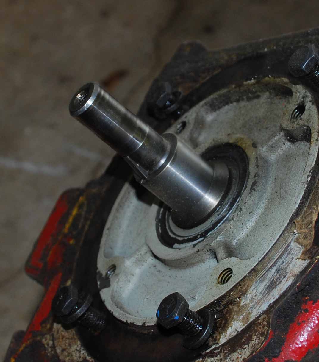

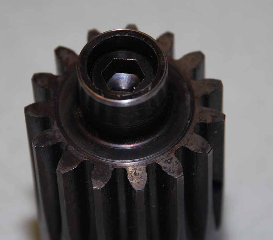

Here are some picture of the new gear
to be used on L, C8, & C10 Gravely Tractor
For re powering with a 1 inch crank shaft

You put a frowny face next to using two spacers. I see absolutely nothing wrong with this. Yeah, one piece would be better but so what if its two? It'll work just fine.
Are you going to make the top hat for the L any longer than the one in the picture? Based on my experience I think longer is better because the load of the planetary is spread over a larger area. Of course I've been wrong many times before!
/ Engine ideas #294
They are the same size as the one
Gravely made for the late models except the large dia.
These are .100 smaller.
I could make it longer but it is in almost 3/4 inch.

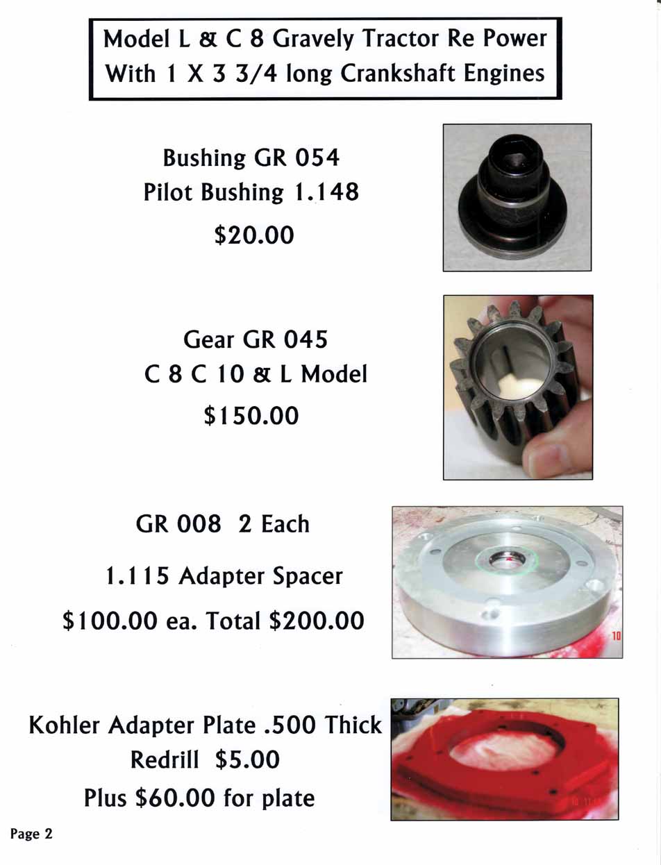

Well it came down to this.
I made a Catalog of information.
I hope this helps to see the difference
Between repowering Gravely tractors
There maybe some things wrong ???
This is a list as best I know it as of right now 11 Dec 2010
Thanks a lot for Ideas and help.
Bruce G

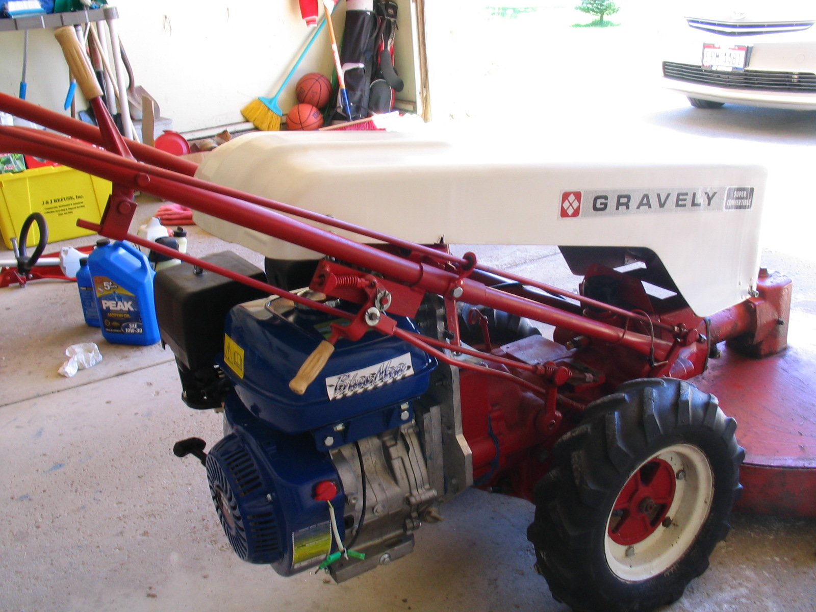

What seems like only a few months ago I posted a picture of my C8 re-power as taken from my garage (1st picture below). The next two pictures show the scene outside my garage this evening. There's about 16" of snow on the ground give or take a few. My son is using my 1976 MTD snow blower to clear the driveway. I bought this from a widow a few years back for $150. It has an 8 HP winterized B&S engine which still runs strong, as does the original 120V Bendix starter. I'm thinking if the engine ever dies I just might try to make it into a Gravely attachment...

I like the looks of your tractor it look great:thumbsup::thumbsup:
Makes me feel good to have a very small part in some thing good.:D

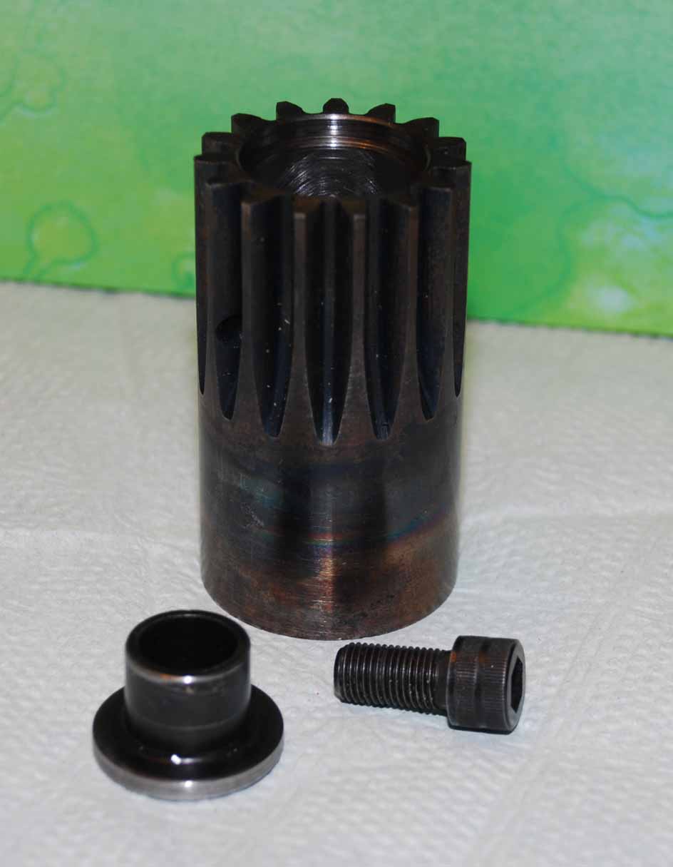

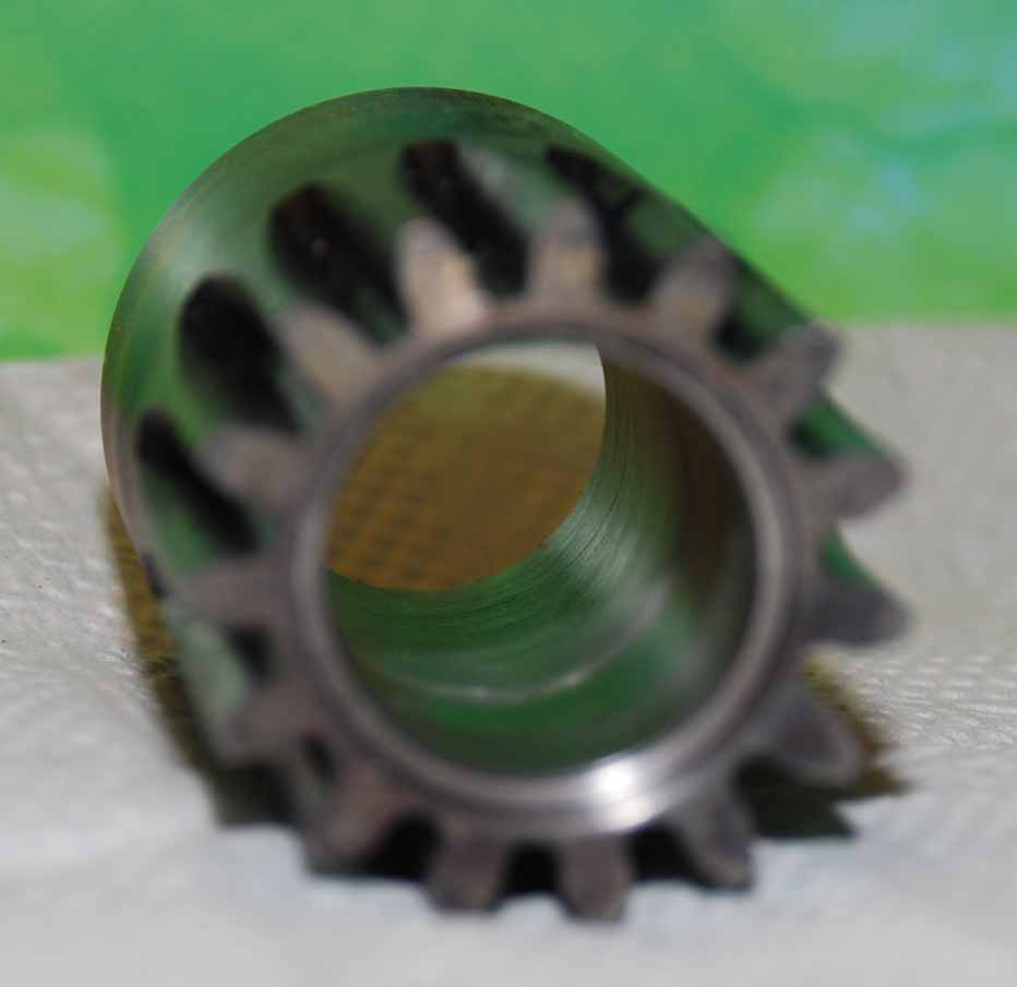

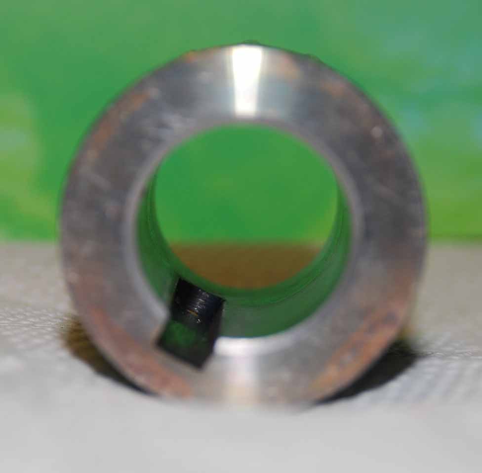

I got some more pictures of the L model, C8 & C10 Gear .
I also sanded the out side a little to make look better.
That snow blower would work good at least you would have more power if it would be strong enough to handle
The gravely.

Hi Oldmech
I was wondering what your thoughts are on the sun gear?
I know they are high but I had to get them made at a machine shop.
i like your snow blower :thumbsup:
