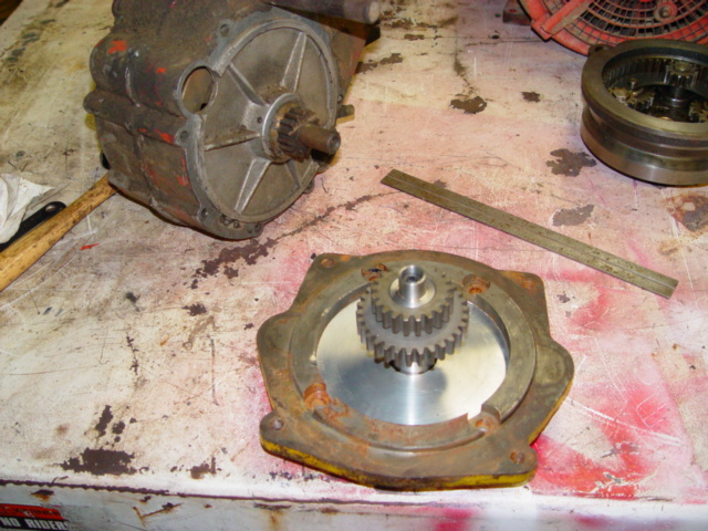

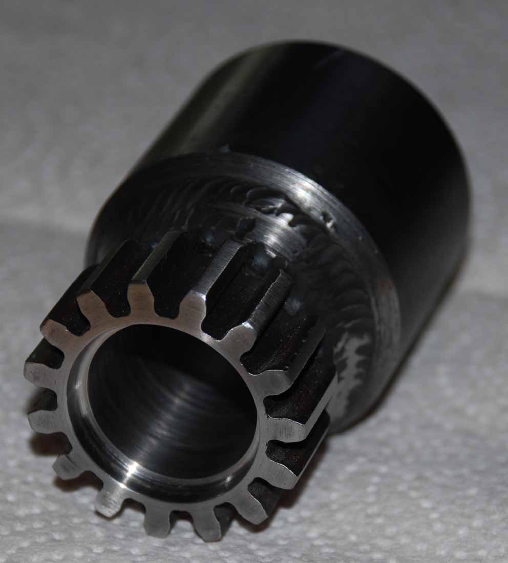

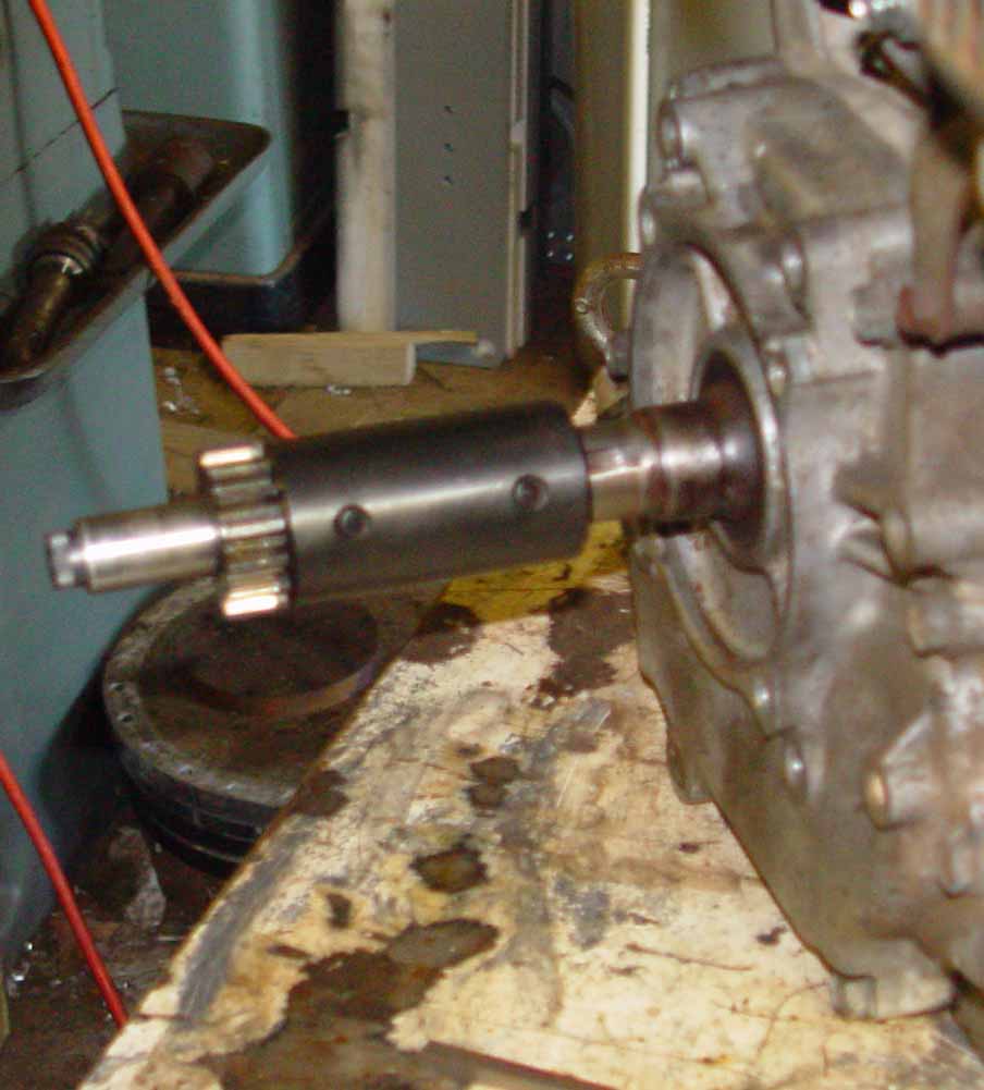

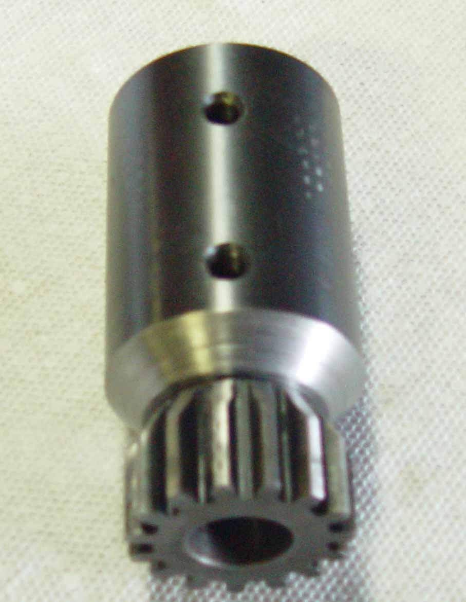

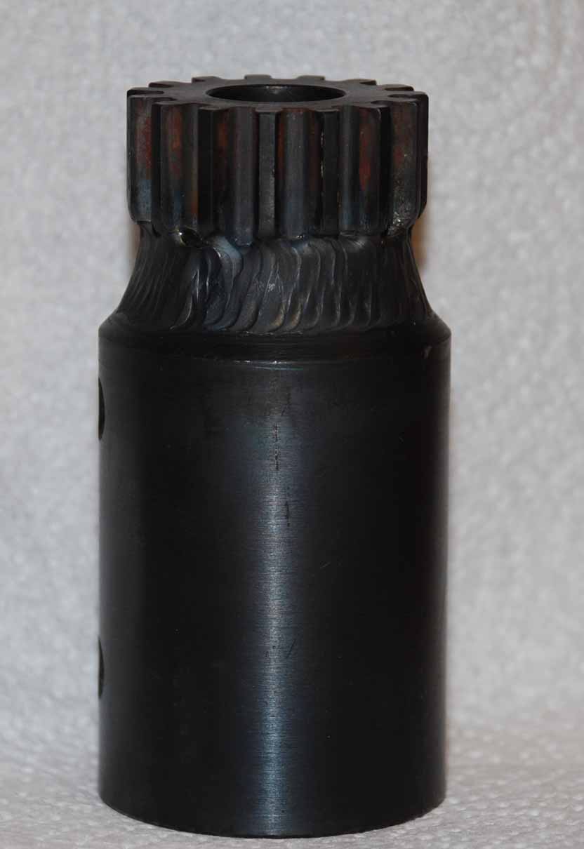

Hi Guys
I finally got a gear done for the L model that I think will work.
I will use a top hat or bushing on the end like Gravely uses
on the late model.
I took a gear Martin S1015
and a 1 inch coupling bored the coupling out left about .002 small.
Pressed the gear hub into the coupling with a key all ready in coupling .
Welded them together.
Bored the gear end out so engine crank shaft can go all way through.
Also machined a pocket in the gear end for the top hat to fit.
Machined off to fit on the engine shaft length.
Now all I like is having it harden.
and make the top hat and have it harden. :thumbsup:

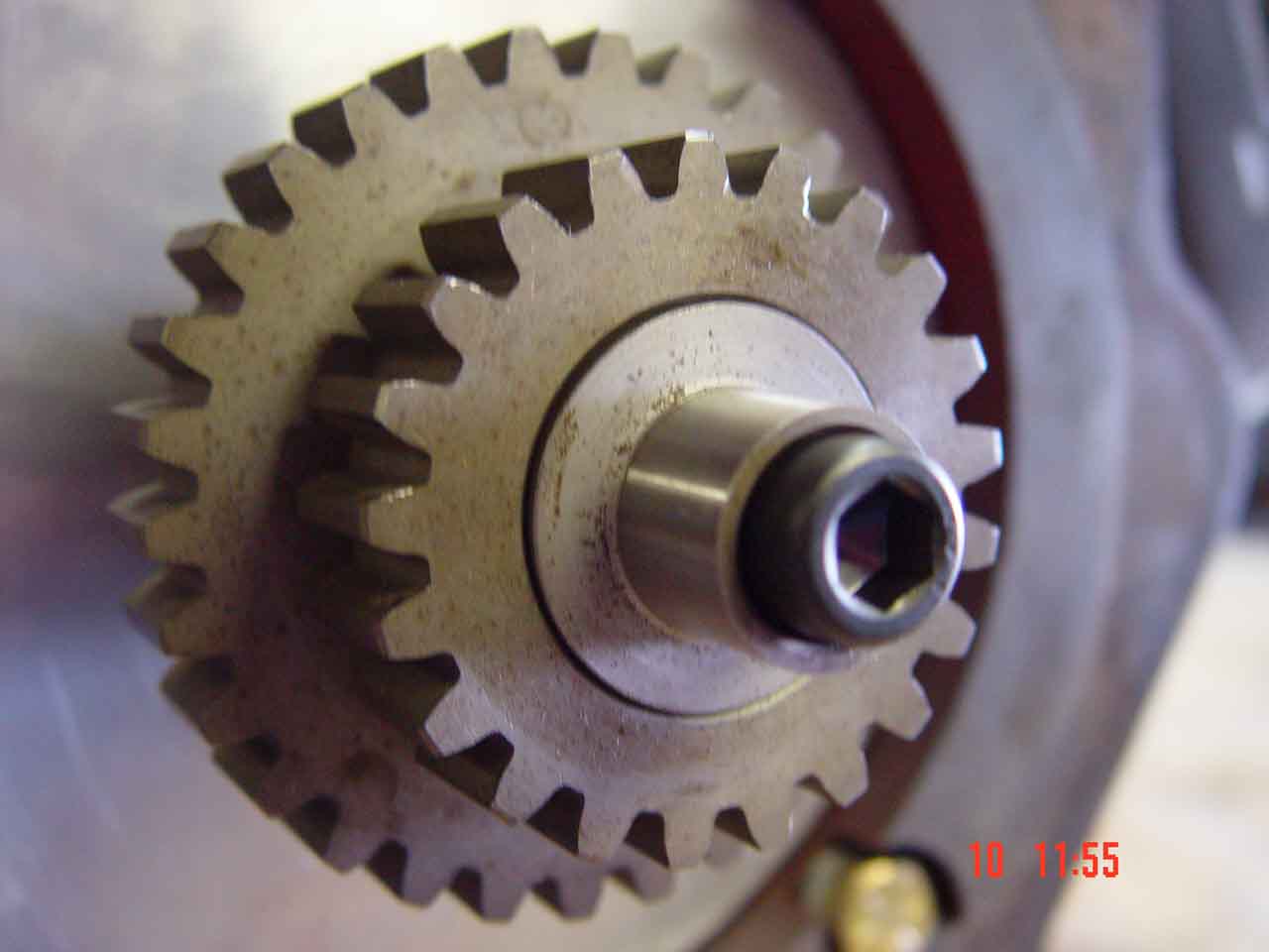

/ Engine ideas #244
This also shortened the length that the crank holds the gear out from the engine about 1 1/2 inches.
now I will only need 1 spacer adapter
More pictures :thumbsup::thumbsup:

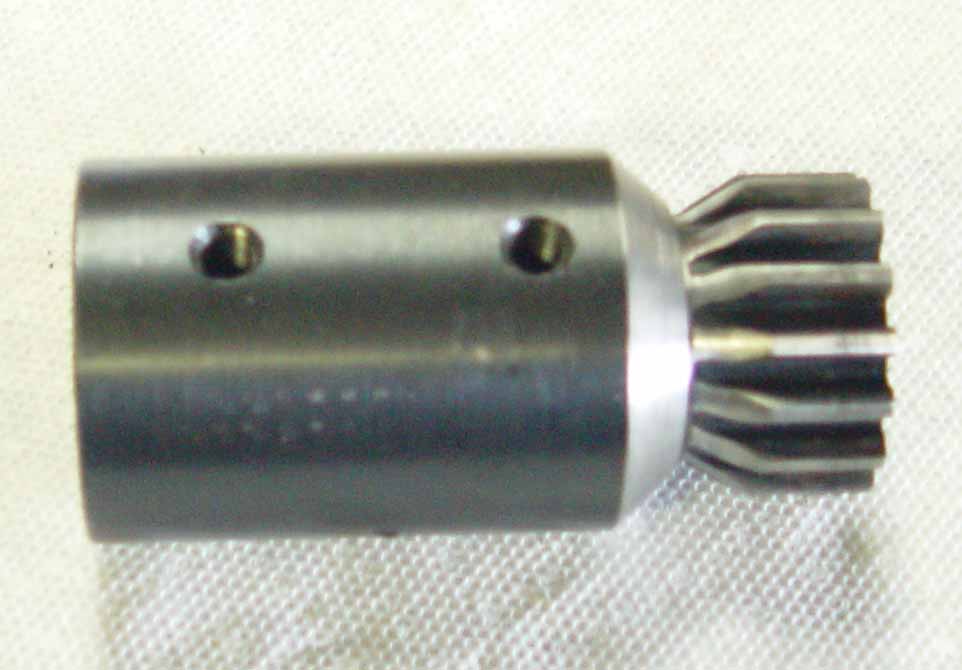

I plan to make a top hat like the pilot bushing gravely makes for the late model gear.
As a matter fact the only difference will be the Outside dia.
of the large dia :thumbsup:
Also here is the other mod.
I had talked about before .

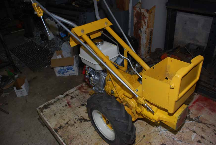

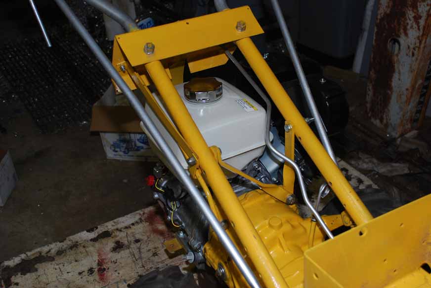

I second that. This is good stuff - very creative! I'll be interested in seeing how a clone type engine fits on an L using this gear and adapter. As the space between the engine and tranny decreases, parts of the engine may start running into the handle bars. The muffler will hit first followed by the the gas tank. So some work arounds may be needed for these - but I'm sure Bruce will solve them.
/ Engine ideas #250
I've not put one on a L yet but the bolts and handle bars hook at the same place up front.
So I think I can make it nearly like a 10 and later models.

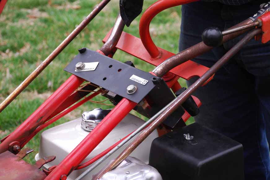

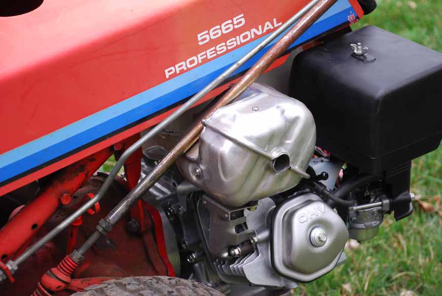

Looked at my L again and determined that if I moved the engine up closer, the muffler would hit the left handle bar first followed by the gas tank which would hit the hi/lo and swiftamatic rods, not the right handle bar. These rods could be bent out the way without too much difficulty. Would love to see pics when you do an L.
