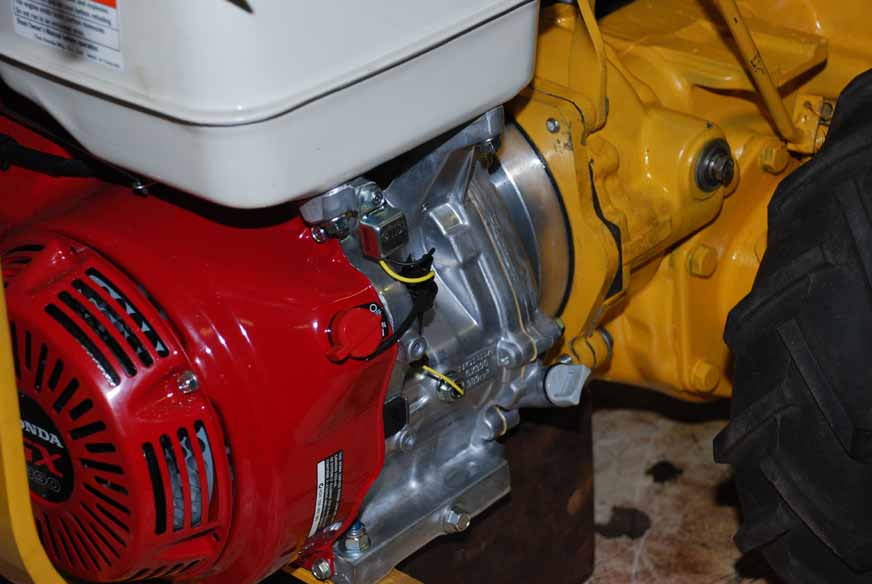

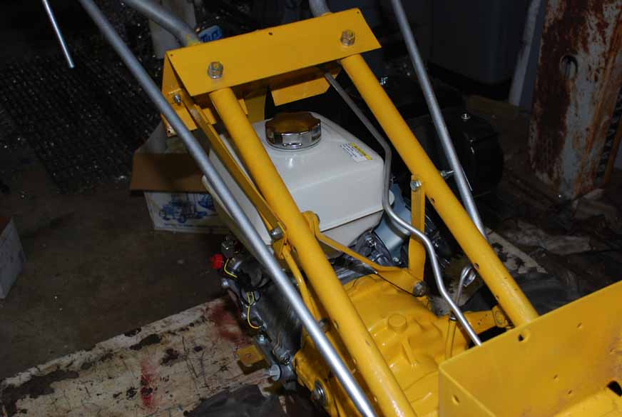

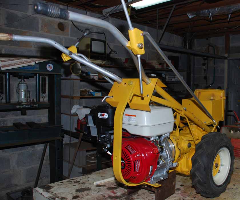

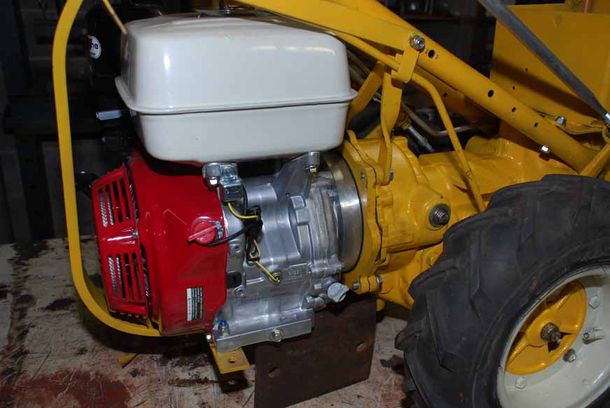

Well I finally got the clutch in?? from Gravely
It took 2 months.
So here is a C10A with a Honda.

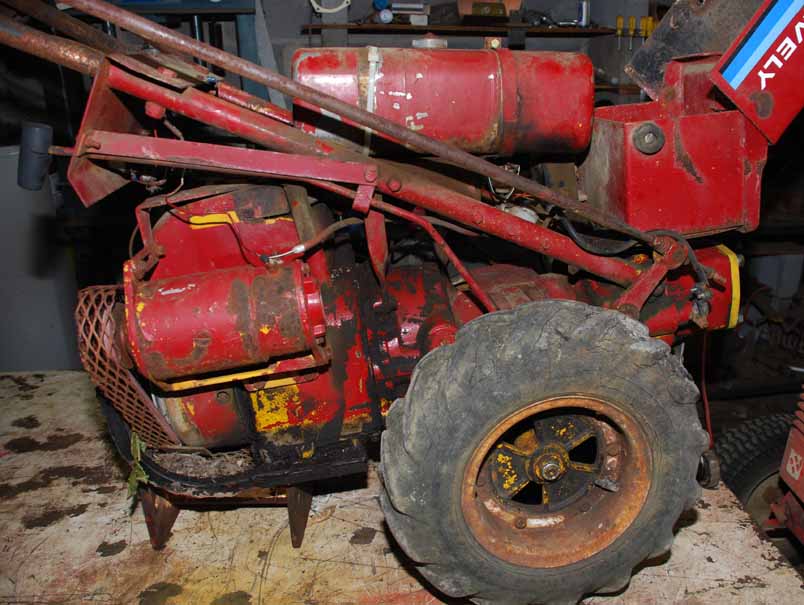

/ Engine ideas #230

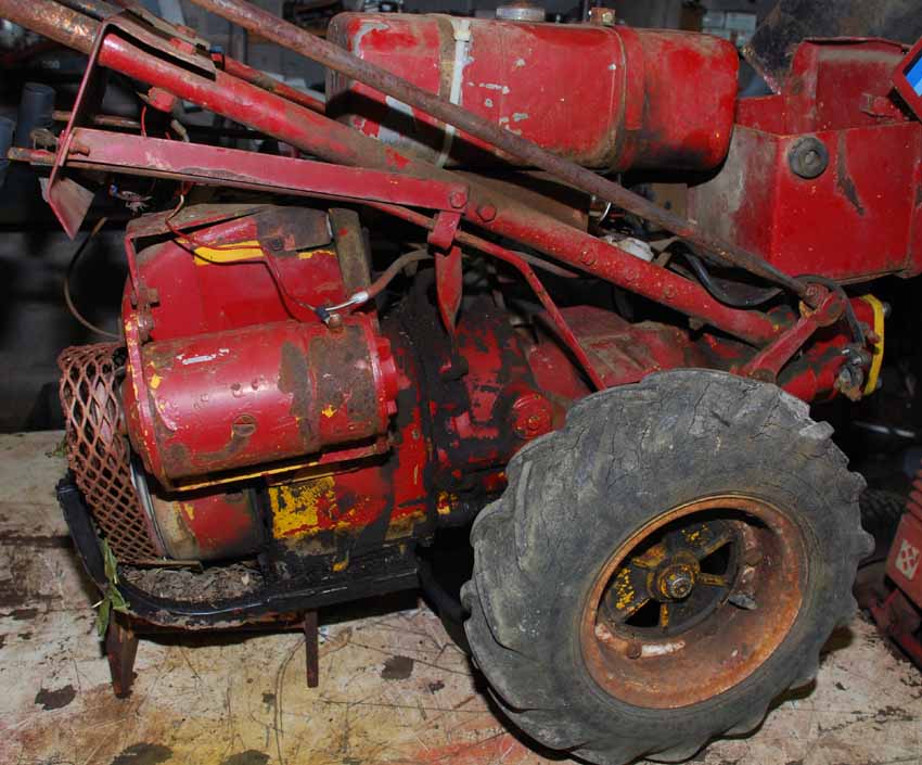

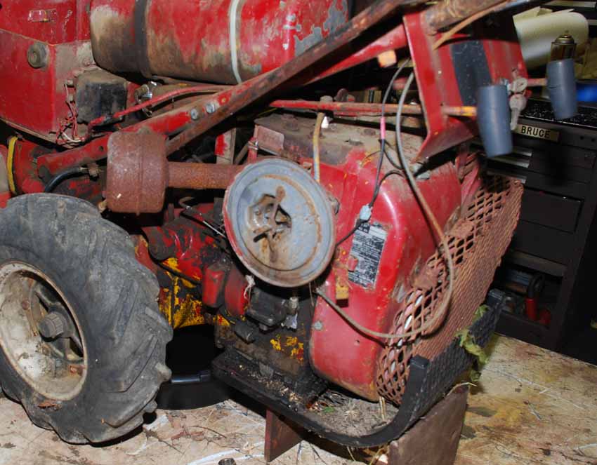

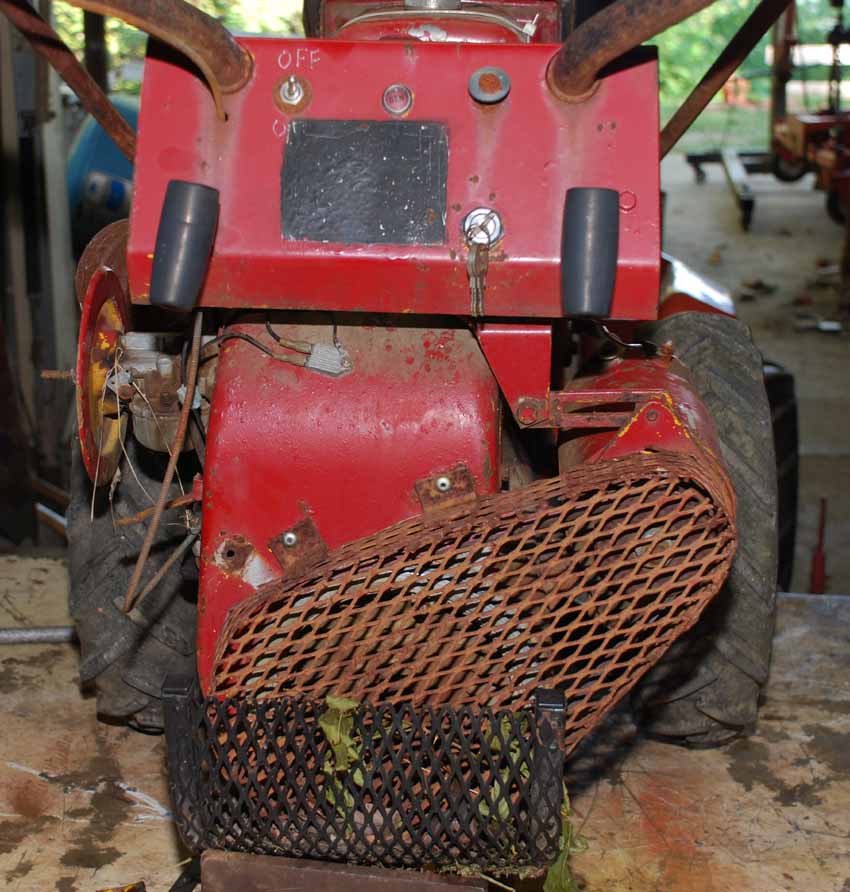

Well I plan to repower a C10 .
It is like the L except it has a Kohler engine and adapter and the crank has been turned down to fit the small gear.
I'll post pictures as soon as get them

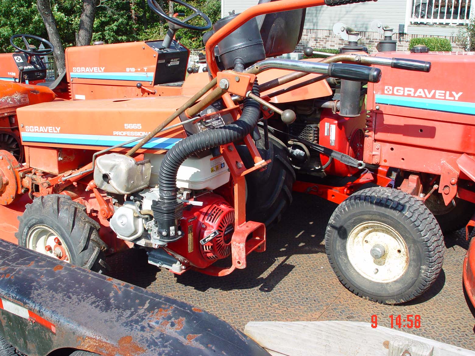

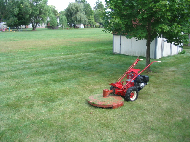

Hi folks. You may recall earlier this Summer I put a 13 HP clone on my 73 Superconvertible. It worked but the tractor ran too fast. Since then I had Bruce shave 3/32" off the 1" drive gear shaft so it wouldn't stick too far into the tranny. I also soaked the hi/lo planetary in oil for about a month. Finally I adjusted the hi/lo clutch band. Tried the tractor tody and it worked! Guess that makes me an offical member of the repower club! There is a photo below showing the tractor cutting my back yard today. The 30" mower even put some nice stripes on the lawn.
When I started this I wanted to see if I could make an adapter without doing extensive machine work. To do this I used the front half of the Gravely 7.6 engine crankcase and put a home made aluminum plate on the back. I say home made because it is a simple aluminum plate made using a circular saw and drill press. I did need some machine work done on the gear and bolt used to hold it to the crank - which Bruce did exactly the way I asked. I'm tickled this worked and appreciate all the suggestions made on this forum.
