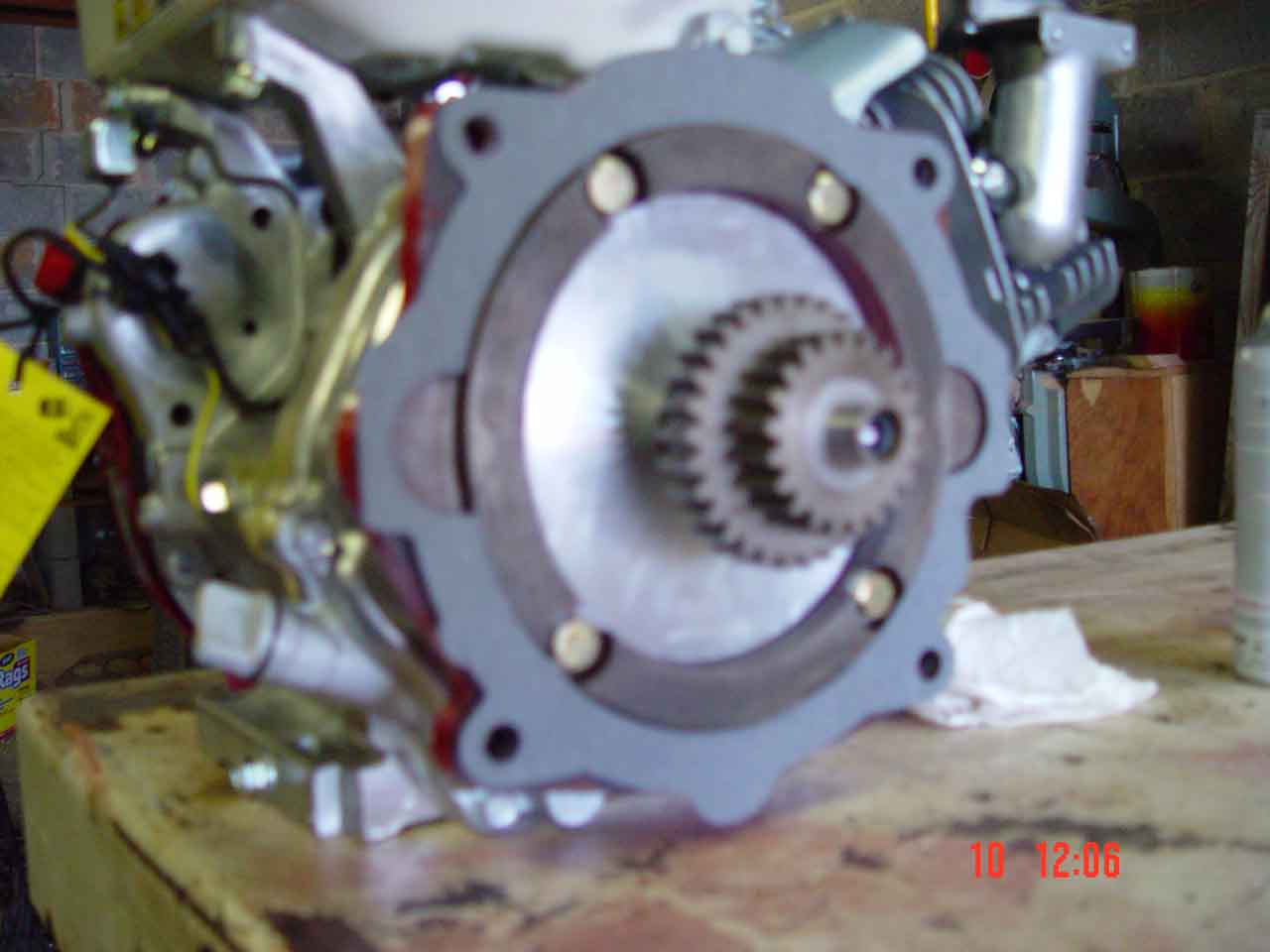

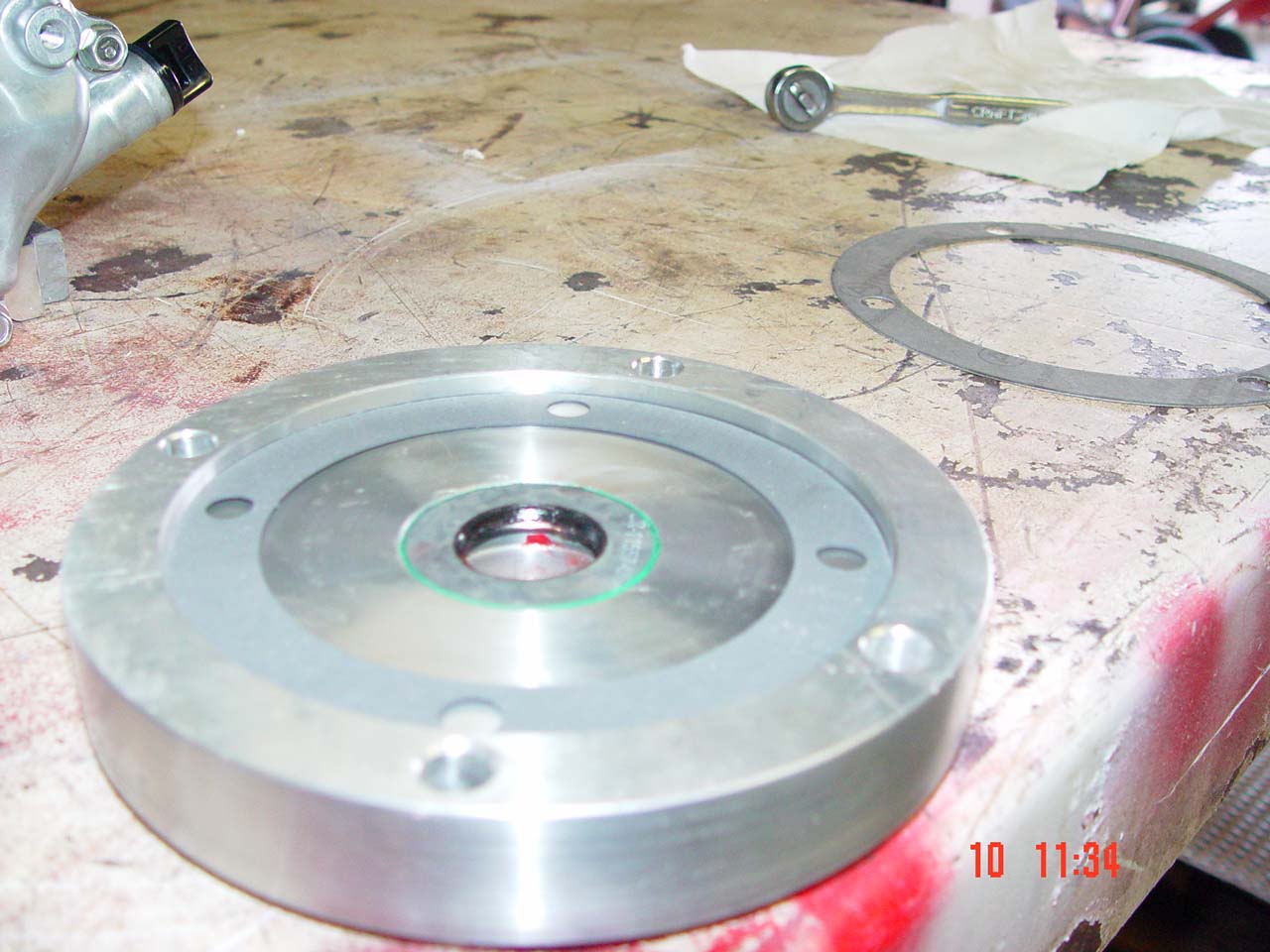

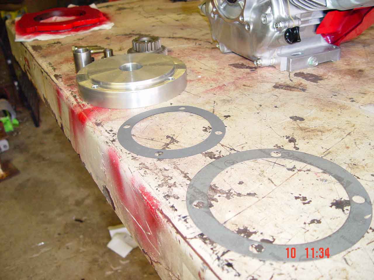

Here's an update of what I did this weekend. Removed the engine and adapters and scraped all the blue permatex off along with the gasket between the crankcase and tranny. Sealed a bolt head that goes into the universal bolt pattern so it wouldnt leak anymore. Prepared two gaskets and re-installed without permatex. Good news and bad news. Good news is that there were no leaks due to the adapters or tranny gaskets. Bad news: tractor still runs at very high speed. Will try one more time by adding a couple of more gaskets. If that doesn't work I'll assume the hi/lo planetary needs work. Due to my schedule it may be a couple of weeks before I can try it. By the way, the Chinese engine started on the first pull and ran beautifully. As usual any comments or suggestions are welcome.

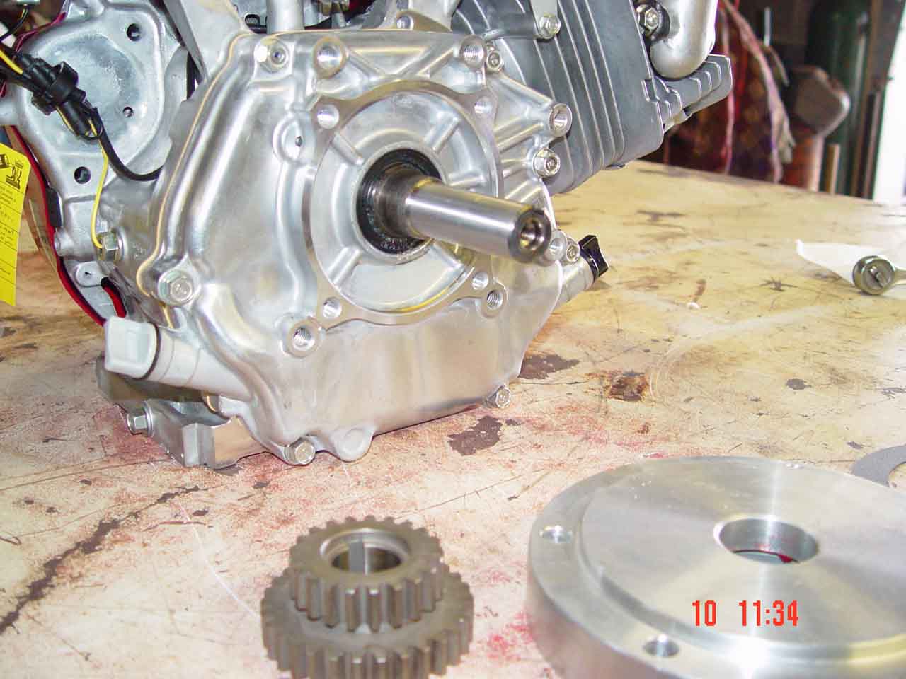

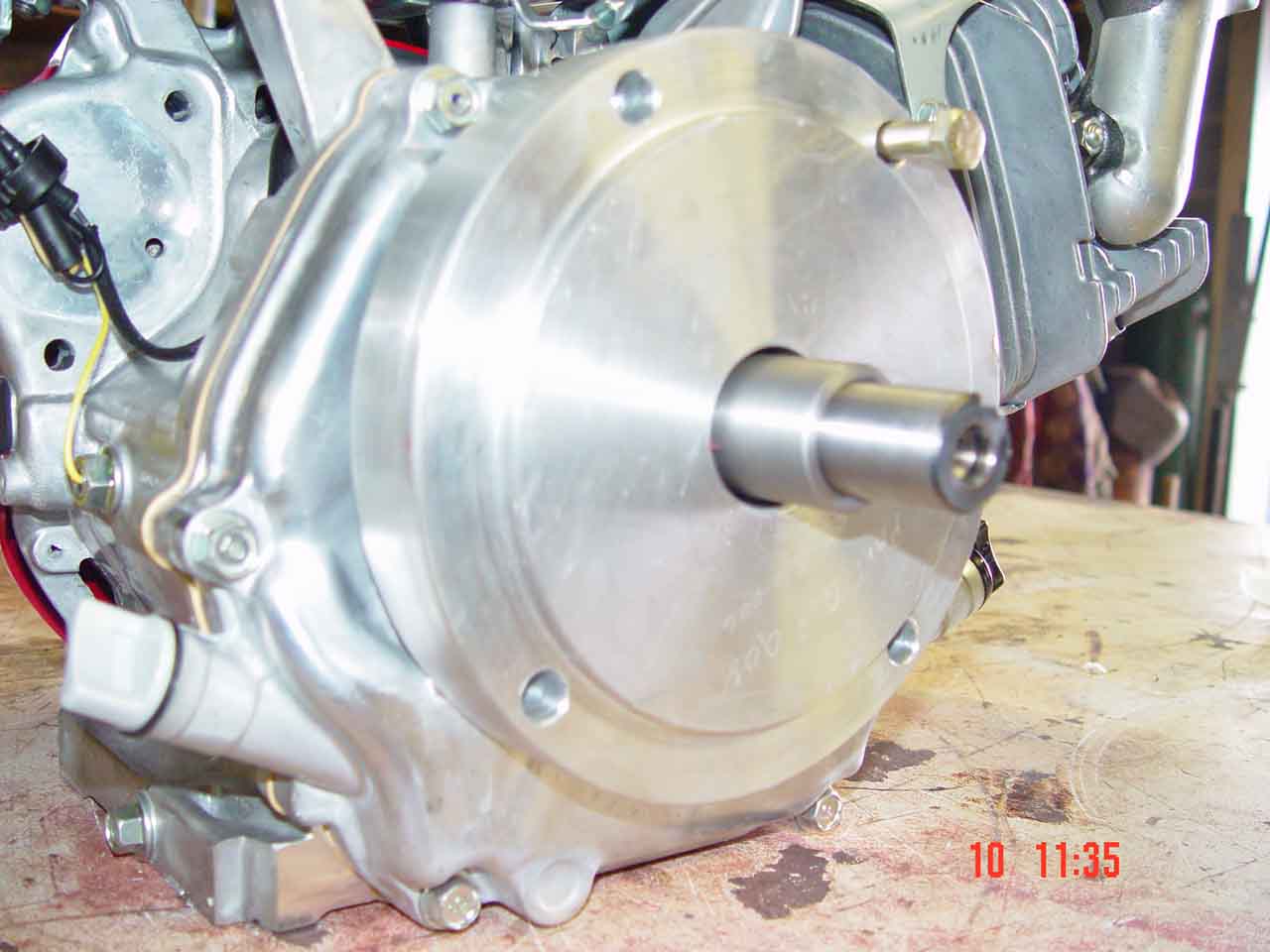

OK today I finally got the engine mounted and the tractor ran. Special thanks to Gravelymay who machined the gear I sent him perfectly. Below are some pictures to give you an idea of what it looks like. I noticed I have three small oils leaks to deal with. 2 are from the tractor axles and have nothing to do with the new engine. One small leak (a drop an hour) is coming from one of the bolts which goes into the universal bolt pattern. I think I can stop this fairly easily. By the way the 13 hp Blue Max engine started easily and ran great.
I am basing this on the picture to the far left.IF that is how it is bolted on.

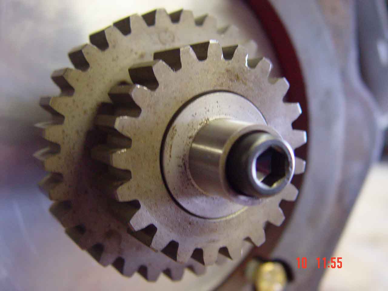

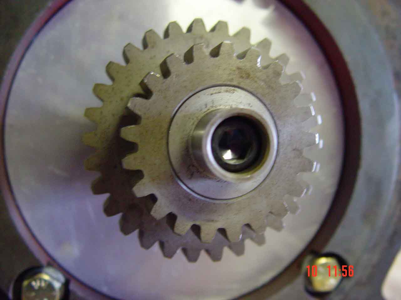

Thanks for your thoughts, Bruce. Here's how I set the gear distance. When I first removed the L engine, I took careful measurements of how far the gear protruded from aluminum crankcase. Look at the photo below. The gear is just under 3/16" from the aluminum ring (ignore the bronze bushing). This is NOT the correct distance for the gear. When I opened up the engine I found the set screw holding the bronze bushing had backed out and the gear and bushing pushed slightly into the crancase. Look at the photo again and focus on the gear blade near the base of the left red vertical line. The left 3/4 of the blade looks shiny while the right 1/4 looks dull. This happened because the left part contacted the planet gears in the hi/low but the dull part did not. In other words the gear wasn't in far enough. When I checked all this out I determined the gear should really be about 1/4" from the aluminum ring. This was also the same distance I measured when I bought a 2nd crankcase and gear from eBay, though I dont have pictures of that one. So I think the 1/4" dimension is pretty good. That's where I have it set now. But just in case I'm wrong I'm going to try to add more spacers to cut this back to 3/16". That's my thinking but I've been wrong many times before so we'll see.

The gear is indeed held in by a bolt. The 3/4" shaft stub was cut down to accomodate the bolt which is flush. The system currently behaves as you suggest with the drive gear powering the sun gear directly which causes the high speed. The question is why. Either my gear is in too far, or is not centered and rubs, or the planetary is siezed. I'll try to look at the measurements you suggest. I appreciate your ideas.

Looked at the hi/low planetary today. I have an extra gravely drive pinion gear so I put it in the tranny and turned it by hand to see what the planetary would do. In one position (not sure if hi or low) the large internal gear was stationary while the planet gear carrier rotated. In the other position the planet carrier was stationary and the large internal gear rotated. As far as I can tell this is working correctly. The springs needed adjusted on the hi/low shift rod but other than that it looks good. So now I am back to the problem being either the gear on the new engine is too far in or it is not aligned properly and rubbing severely. I got a thick piece of card stock (about 1/16") and cut a new gasket out of it to use as a spacer. Will try it out this weekend.

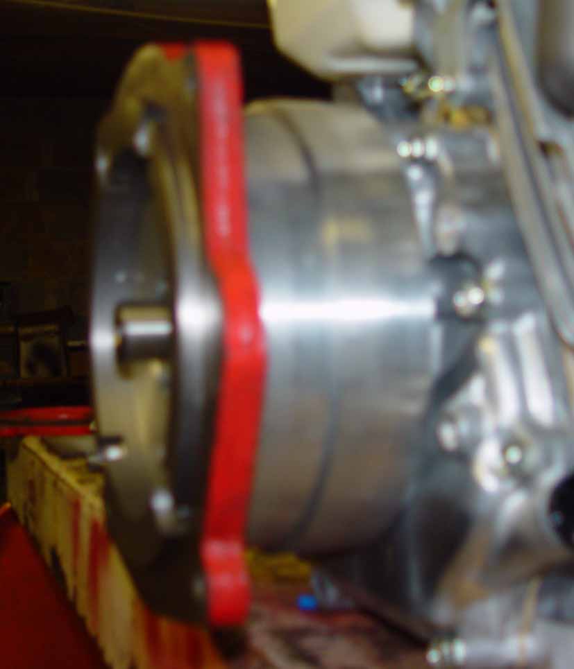

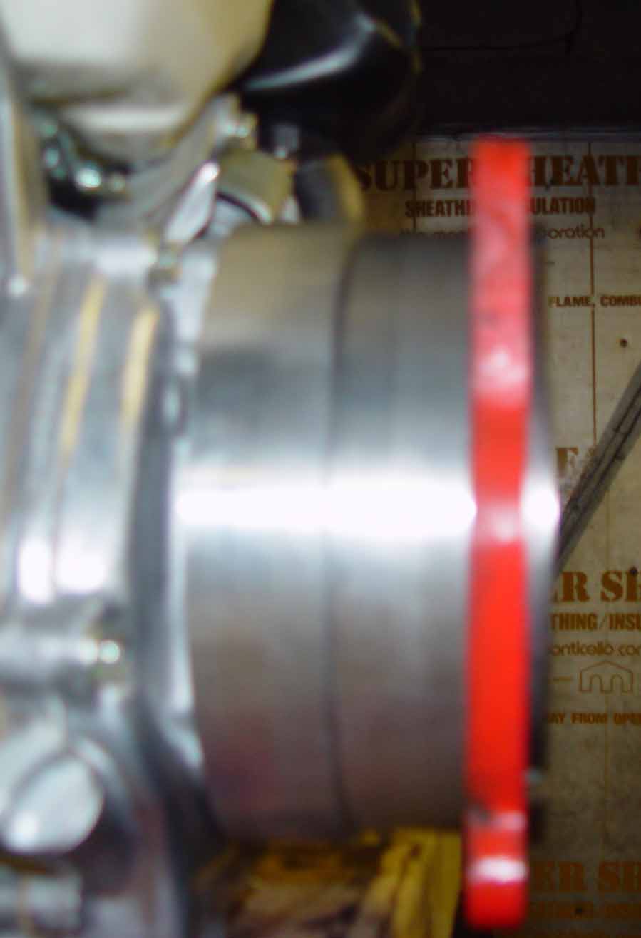

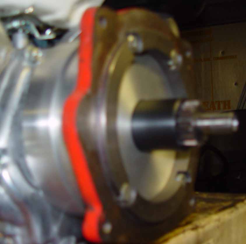

That is about all I can think of right now.
Another thing you can do is turn the gear.shaft.
off a little if you need to shorten the crank.
It maybe only a 1/16 of a inch.
Here is a couple of pic of what I had in mind but my pictures are not clear.
But my spacer need to be thicker and I need clear pictures
There is about .090 clearance on the Kohler transmissions.
Verse .063 on the model L transmission
Thanks Bruce g
