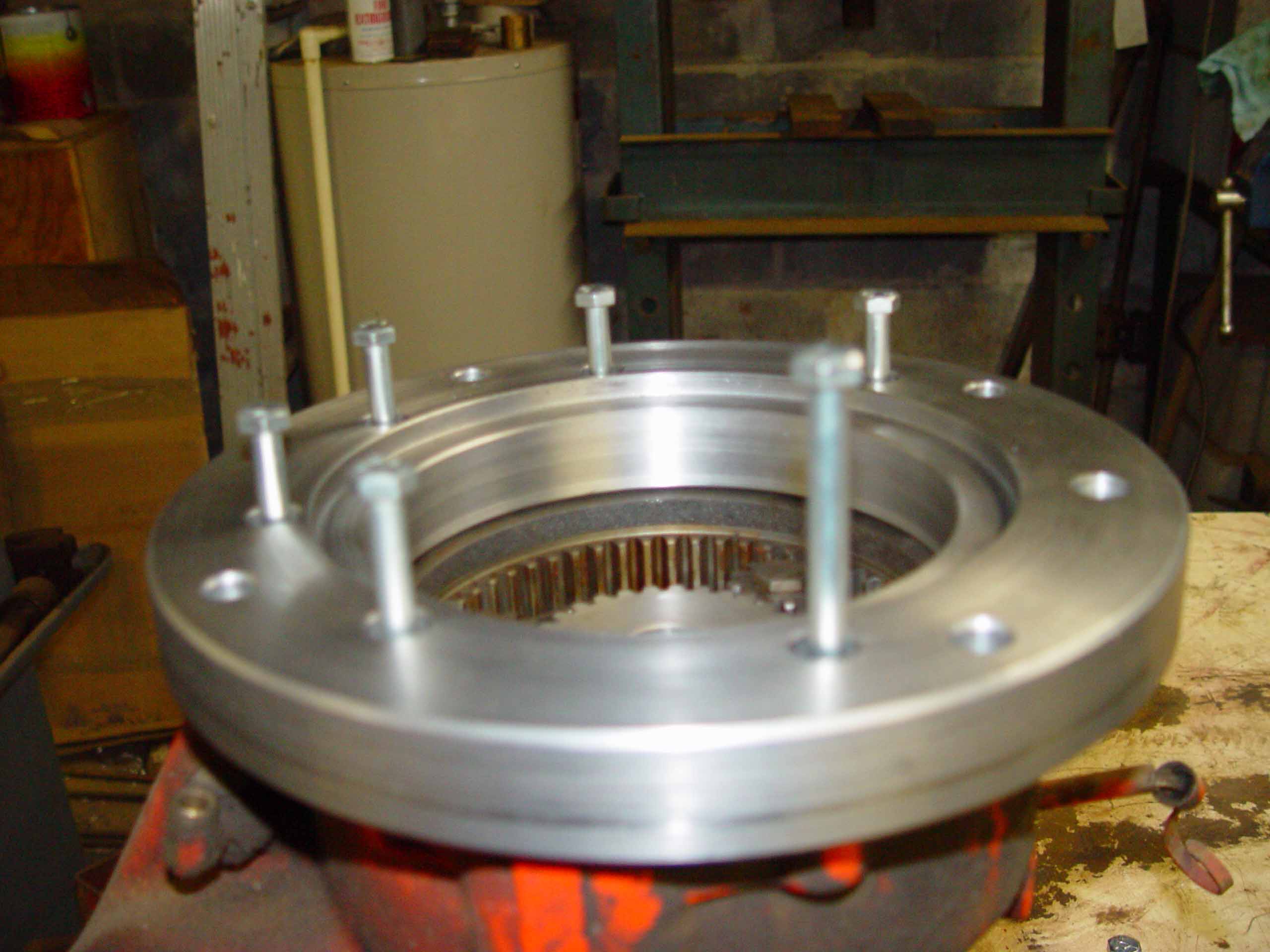

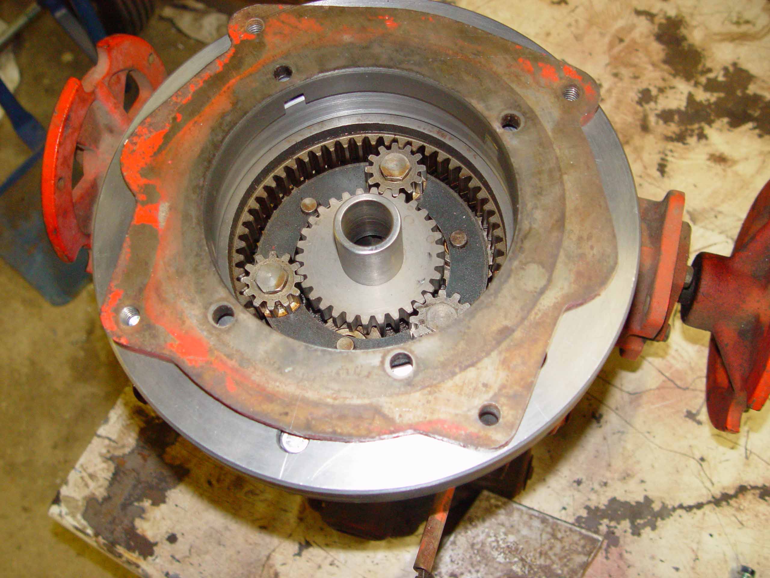

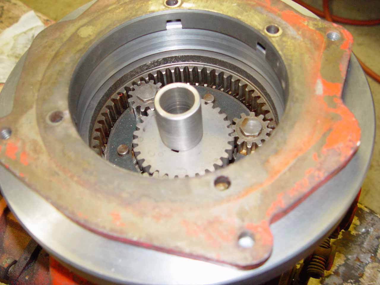

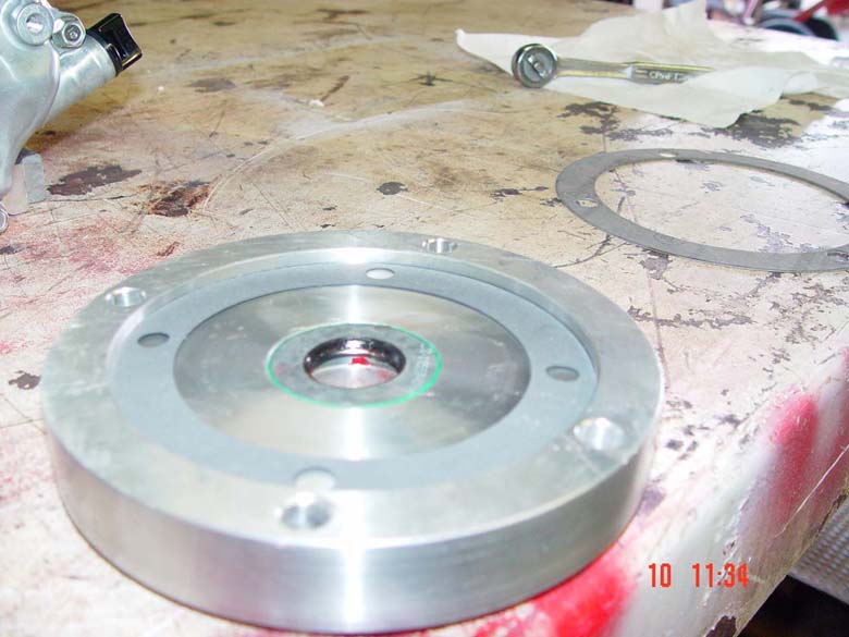

I am going to try two pictures this time.
Bruce g
I have changed my plans from this
and put the Kohler adapter next to the L transmission
then the spacer adapter with a oil seal
like I use on the C10a, 500,5000 and the 400 rider tractors
The adapter would be the same thickness as if you used the Late model Gears.
For the L model gear you will need a different thickness.
About twice as thick
