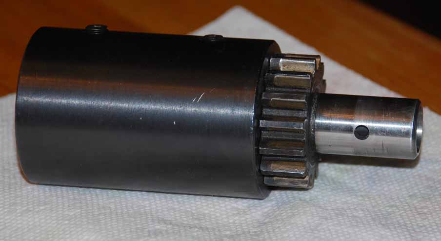

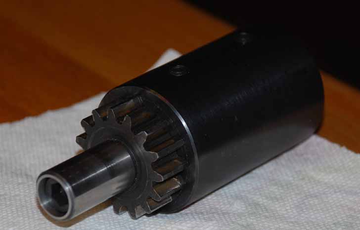

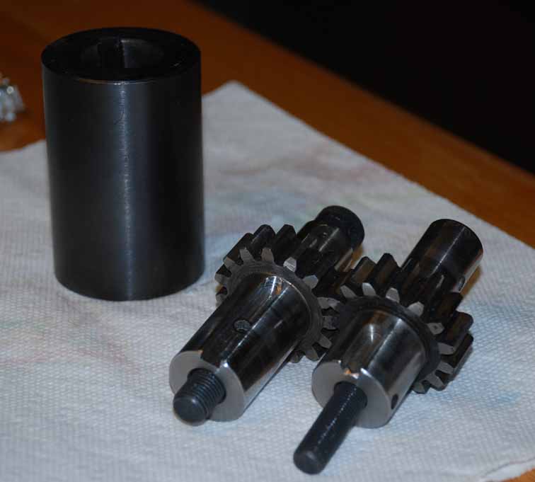

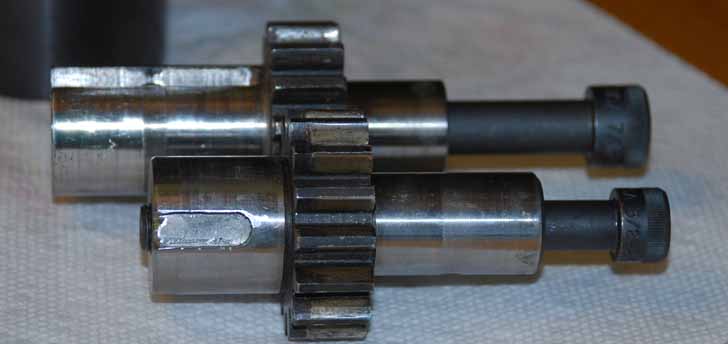

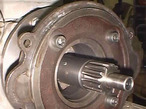

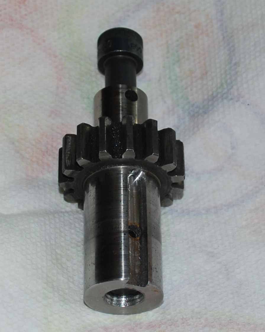

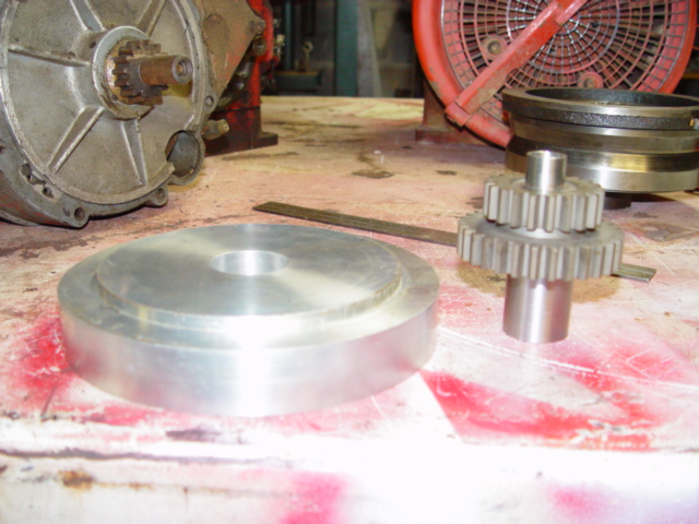

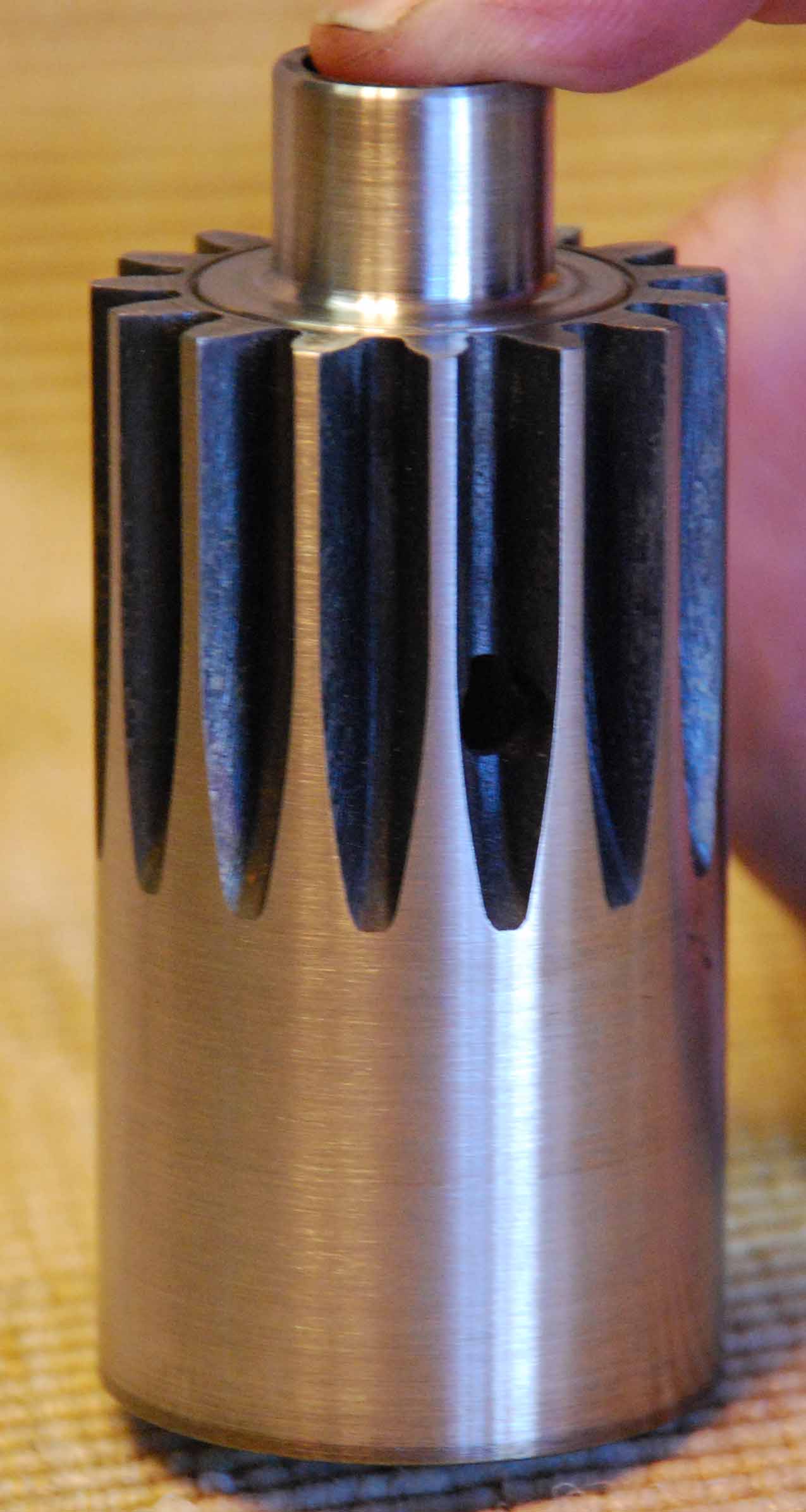

The crank has to be 1 inch Dia.
The length can be set by using the right adapter spacer.
The first pic is parts to repower
Second one is a old picture to see lay out
third is the new gear I had made to replace the Input gear from the old gravely engine and the Kohler C10 models
The 4 th picture is a adapter plate on a C10 transmission
What I am doing is redrilling a Kohler plate to fit the old C8 and the model L transmission
Then we can add the spacer plate

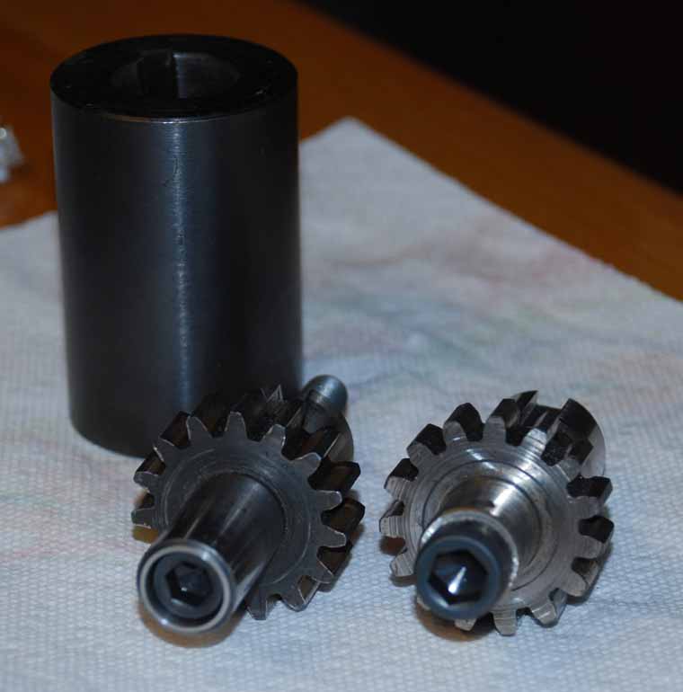

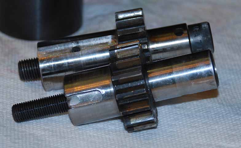

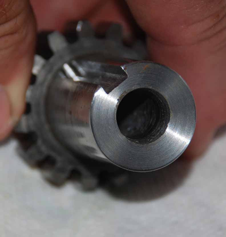

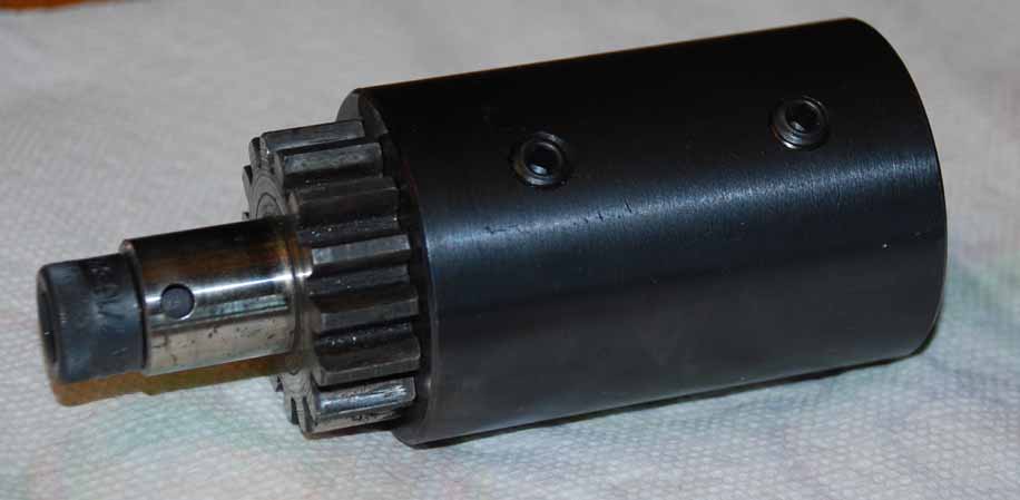

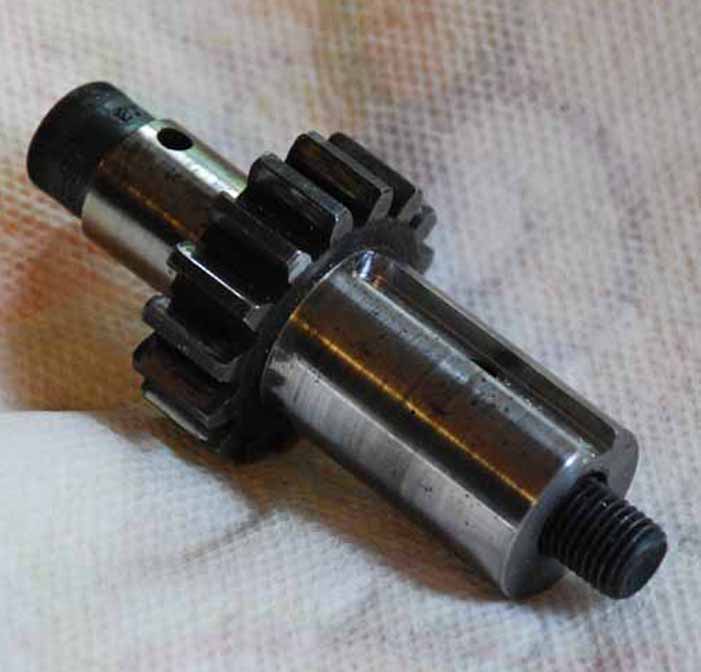

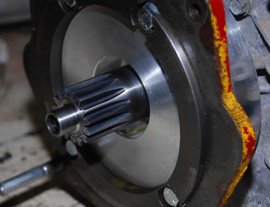

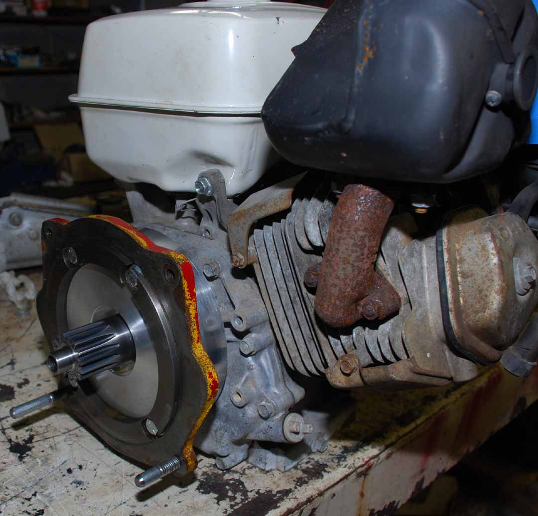

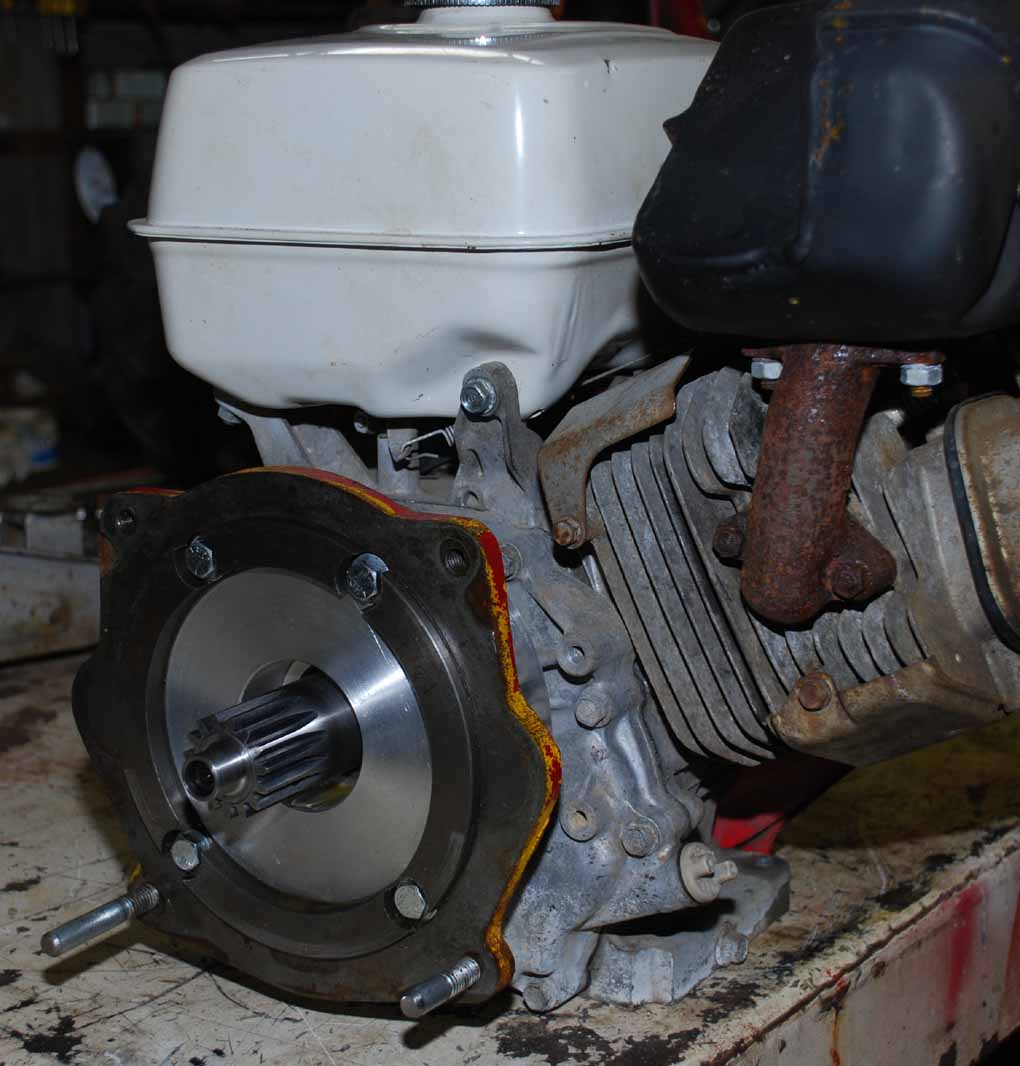

If you use the gear GR 045 It is 2 7/8 of 1 dia shaft inside the gear.
so the distance then would be from the face of the trans to the face of the engine.
You could turn some more off the back of the gear and it would still work.
If you get the crank too short then you don't have room too bolt it all together.
Because the engine would be in the way
Here is a picture of a C10 with the GR 045
