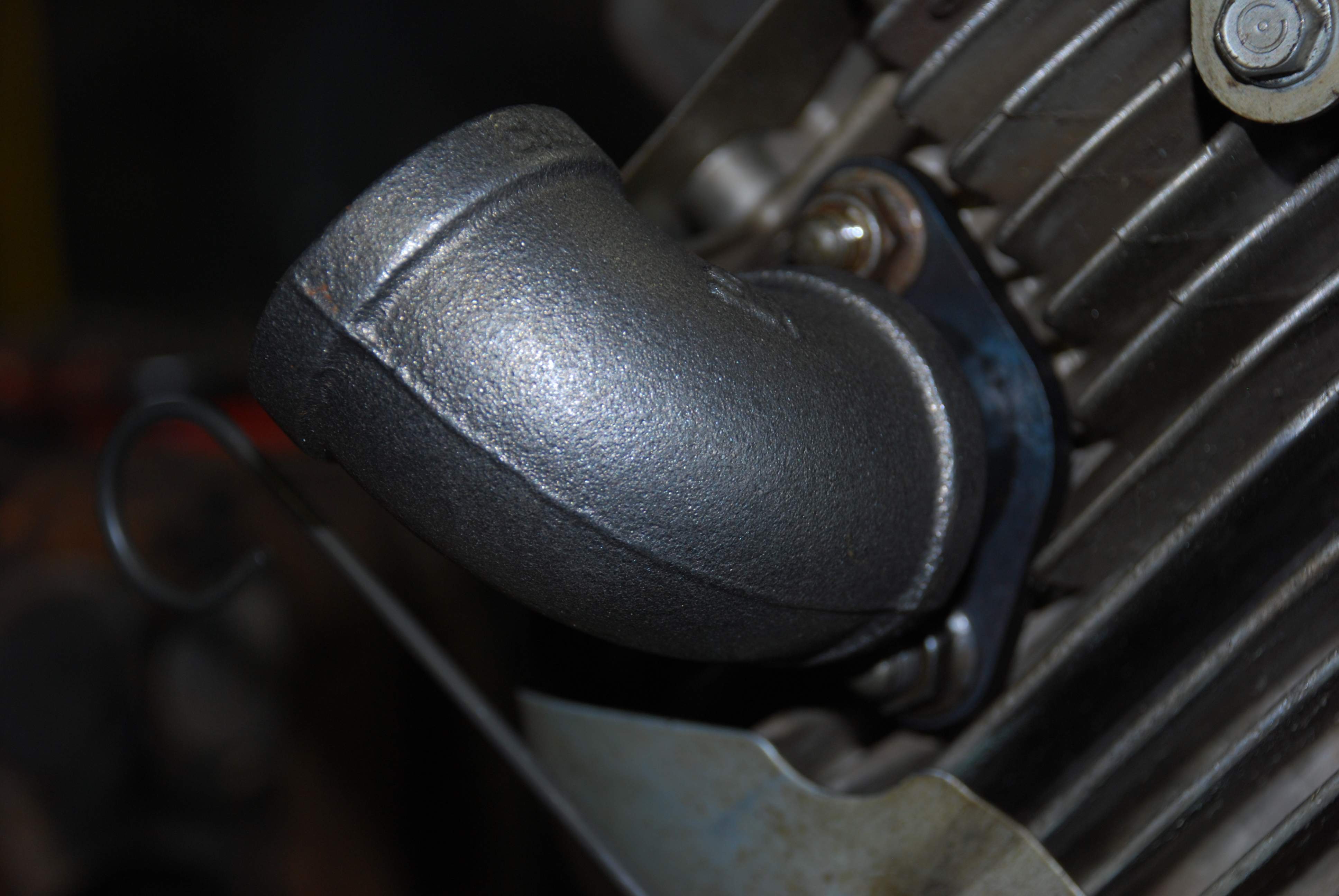

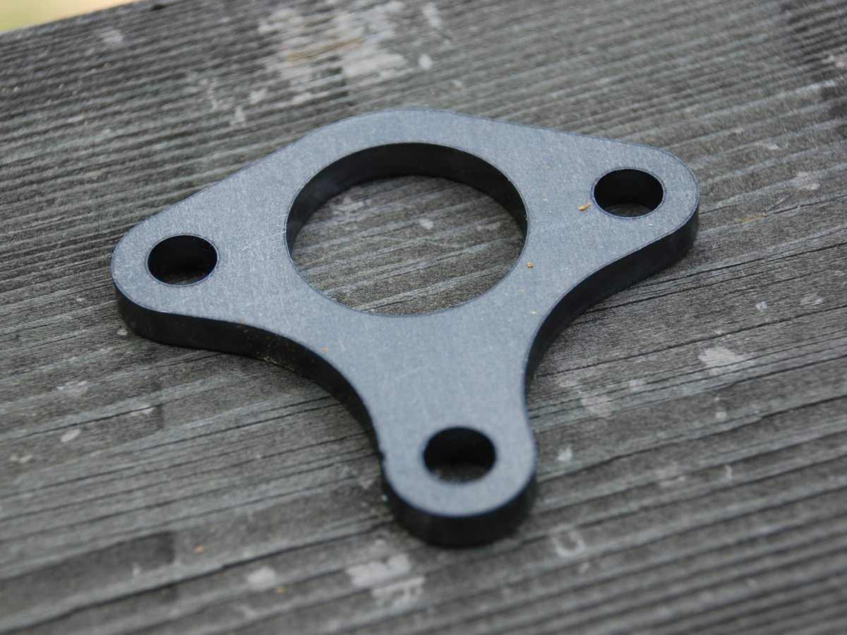

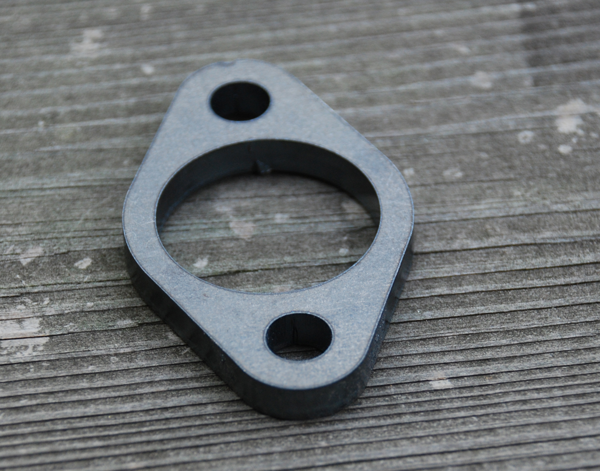

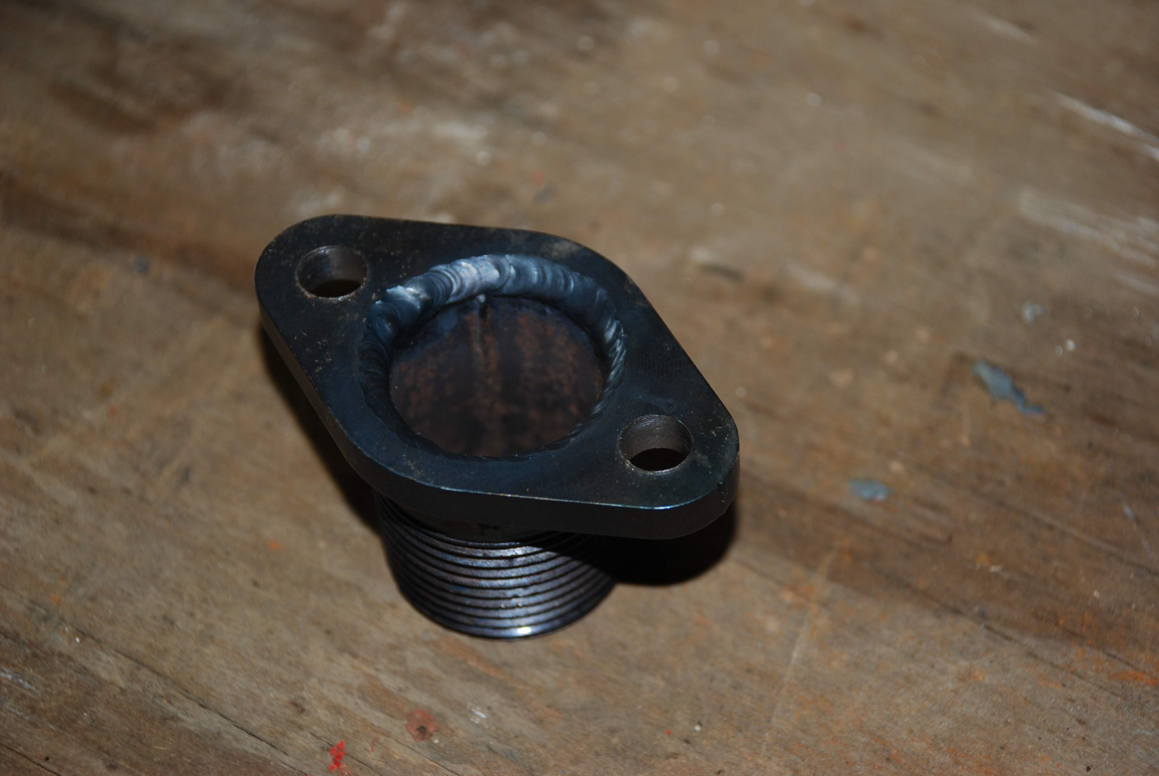

If some one needs to change locations of a Honda muffler.
Here are the pictures of the flange that fit the engine and one that fits the muffler it self.
that way you can weld a pipe between.:thumbsup:

Here is a idea for exhaust
for repower :thumbsup:

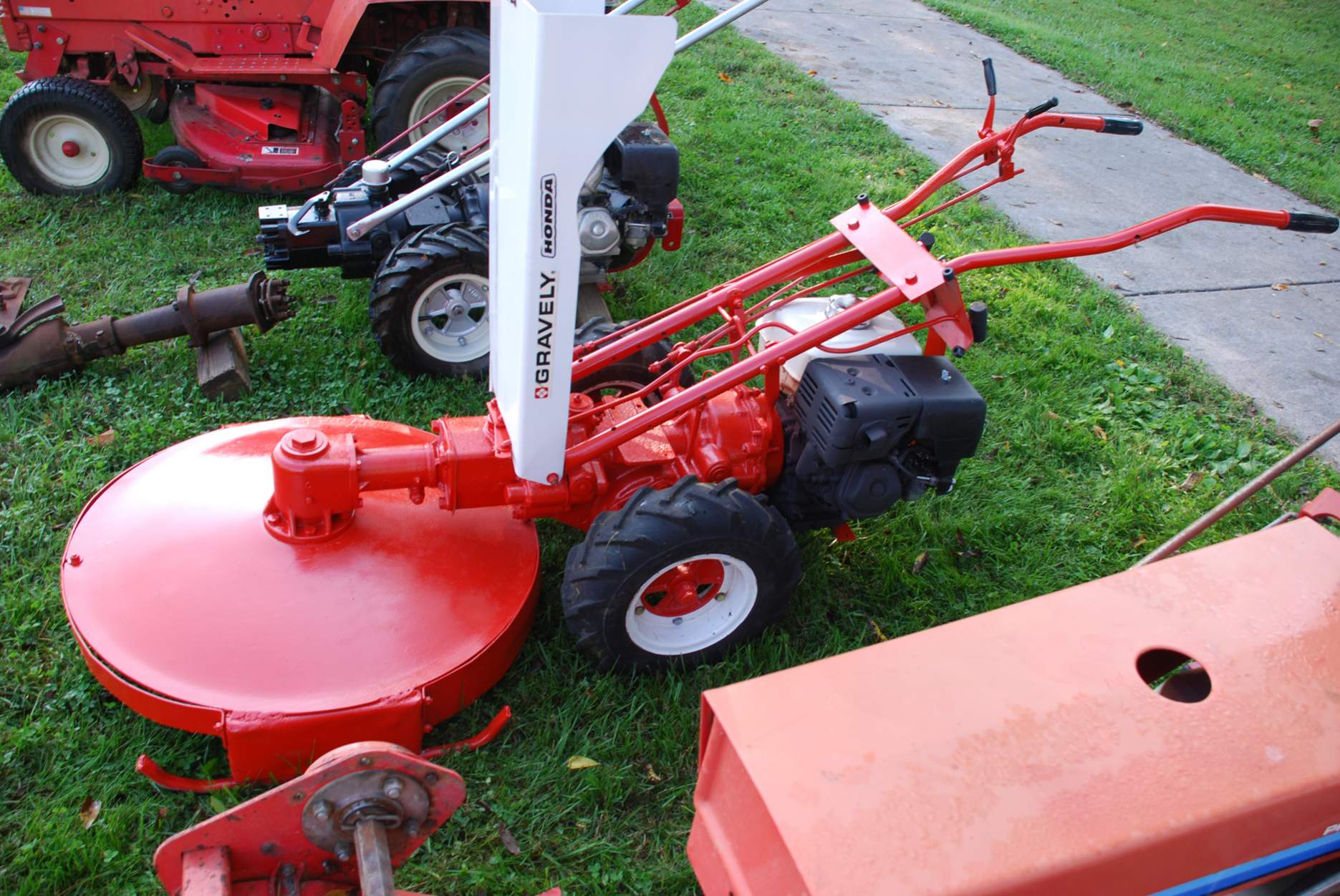

another picture of a L8 repowered with a Honda :thumbsup:

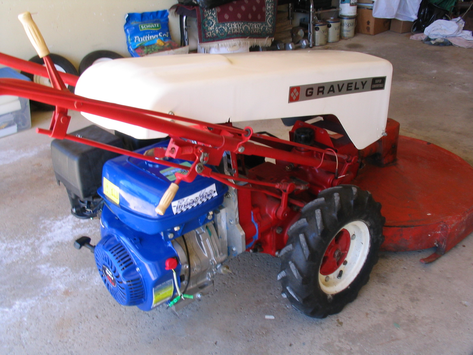

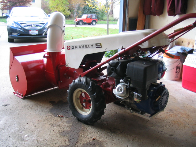

That is my L8 with a Hondas GX 270 on it, it was a junker when I got it engine was gone no front Plantary no pto setup Over a period of time I repowered it & saved it from being a parts transmission, now it is the Best tractor I own.
/ Engine ideas #389

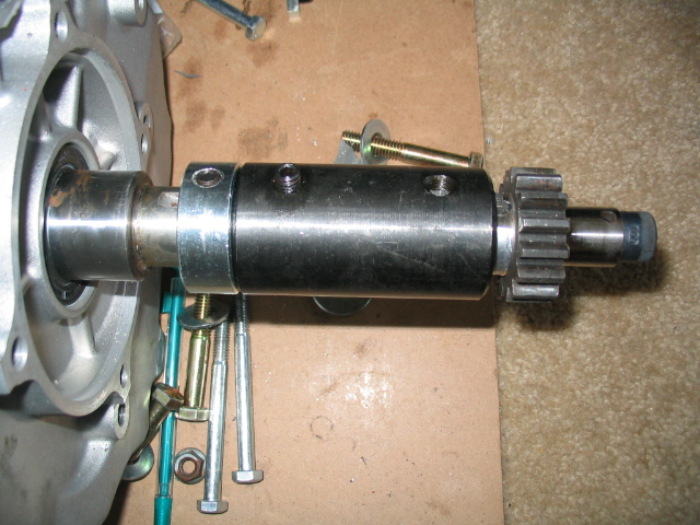

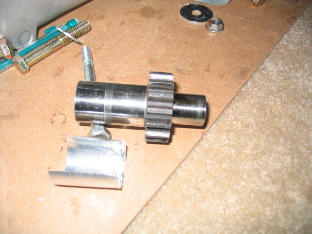

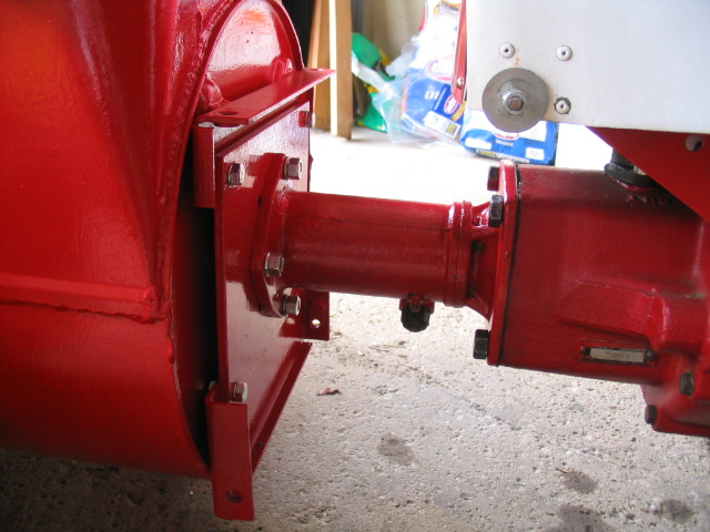

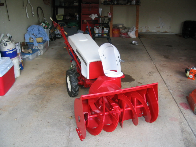

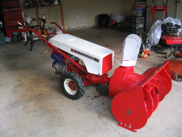

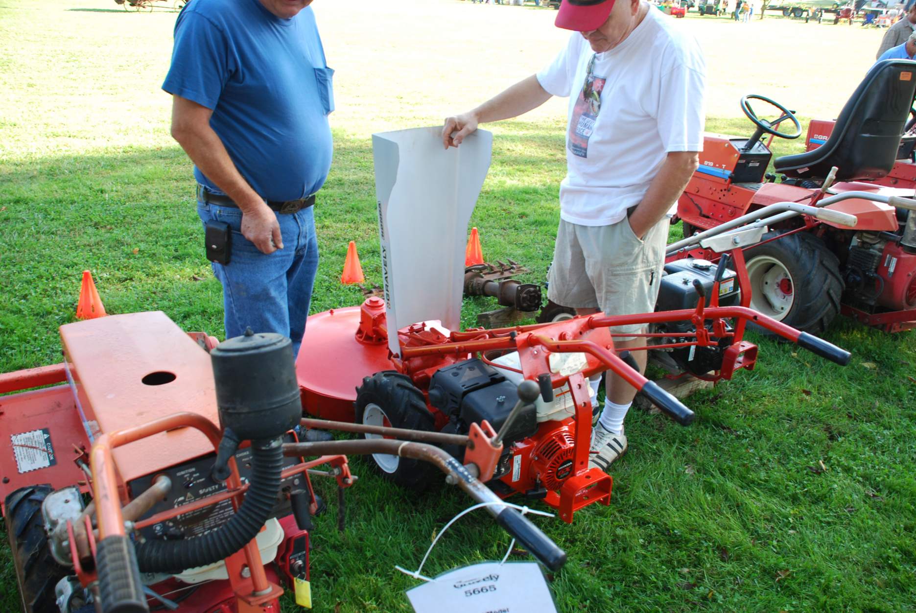

I was inspired last Winter when Oldmech showed a Toro snowblower that he fitted to work on his Grillo. With that in mind I bought a 1974 Gilson snowblower with a 32" front end. Although the 8HP engine was still good, the rest of the machine was a basket case. I decided to fit the front end to my repowered Gravely C8. The Gilson has a 3/4" shaft coming out of the blower housing. To get that to the Gravely PTO, at the Mow-In I bought a piece off a 30" mower - the piece that goes from the PTO into the mower gearbox. The shaft in that piece is 13/16" dia. so I had my local machine shop turn it down to 3/4". After that it was a simple matter of using a 3/4" sleeve to connect the two shafts. I did need to have an adapter plate made to mount on the rear of blower housing. I put several pictures below. The crank to turn the chute is not mounted in the pictures. I did start the engine and the augers and blower run perfectly. I should mention that I used a product called Rust Bullet on the snowblower before I painted it. While the paint job looks good in the pictures, up close it looks like an amateur did it - which I admit I am. Anyway this was a fun project. By the way, Gilson was known for making high-end residential snowblowers. To learn more about them Google "Gilson Snowblower Shop". I am not affiliated with guy that runs the site but he answered some questions I had and was very helpful.

That hook up looks like a excellent and clean hook up.:thumbsup:.
Looks like you may need it a lot this year.

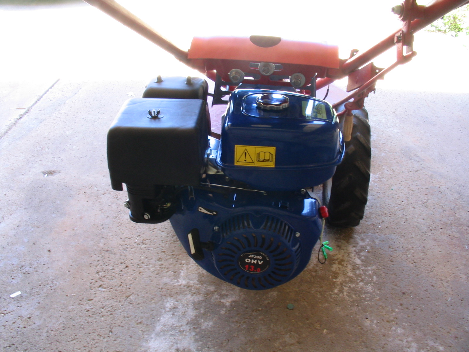

Can't advise you on the tractor, but HomeDepot.com has a 15HP Lifan Engine for $249 with free shipping. Goes to $319 with electric start. I have a 13HP Chinese clone on my C8 - it doesn't have electric start - nor does it need it. Very easy to start. Good luck!

An engine swap isn't as easy as you might think on a Gravely. I was considering putting a 16hp Briggs Vanguard on a L8 and by the time I added everything up, I could buy a Pro16. So I bought a Pro16 and got rid of the L8.

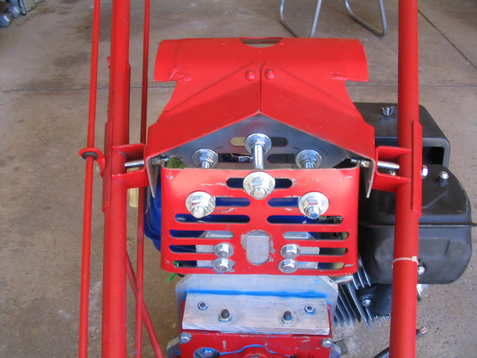

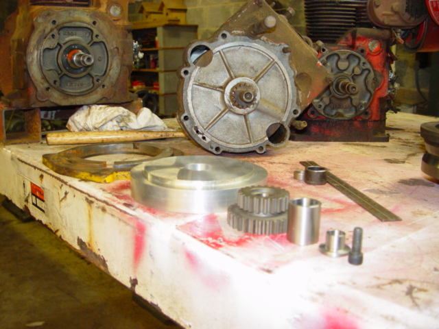

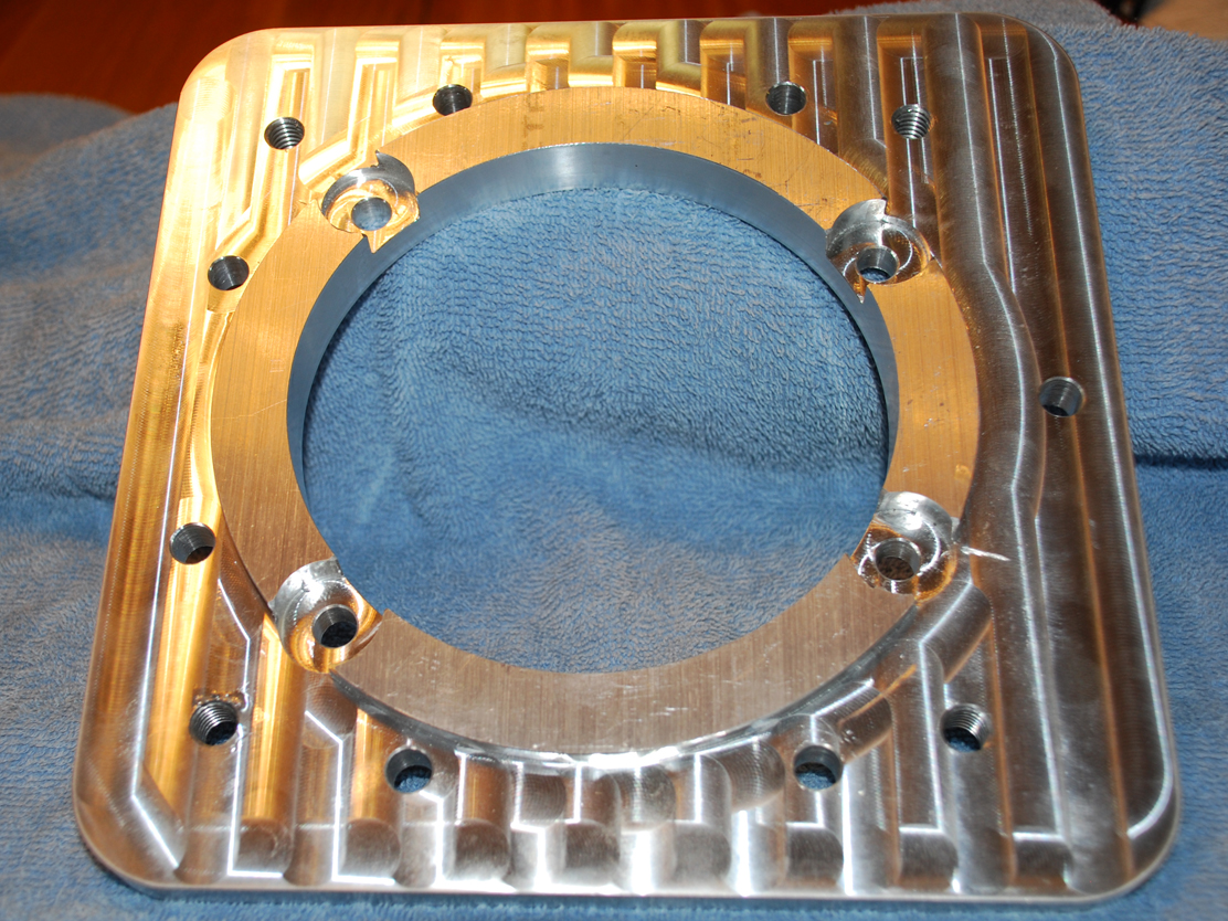

So here is a list for the Model L, C tractor Re power kit
1 ea CR11545 seal 2 X 1.75 X 1/4 $8.00
1 ea The Gear is part # GR 045 $150.00
1 ea pilot bushing is # GR 054 $20.00
1 ea. spacer plate is # GR 049 $125.00
1 ea Alum Re power Plate is # GR001 $60.00
Or Redrill your Kohler adapter for $5.00
6 ea 5/16 X 18 X 2. inch long set screws $.00
1 ea. 3/8 X 16 X 2. long hex bolt and nut $.00
1 ea 3/8 X 24 X 1 1/2 long Allen cap screw $.00
6 ea. 3/8 X 16 fiber lock nuts $.00
6 ea. 3/8 washers $.00
Shipping $15.00
Total
So ck the engine you want so I can send the right screw.
What Hp engine do you plan to use they have to have a 1 inch dia crank shaft?
This is for the Honda engines or clones with 3.3/4 long cranks.
I am making up some brackets 1 X 3/16 X about 12'' long at $10.00 ea extra
2 can be used to bolt the handle bars on to the Re power plate to trans
2 can go from the bottom axle bolt holes and back to the bottom of the engine
if you want all 4 it would be $40.00 extra
You will still need to get parts from a Gravely Dealer
15718 Engine to adapter spacer gasket
10732 adapter to Kohler adapter gasket.
12592 model L Engine chassis gasket (Kohler adapter to Transmission Gasket.)
Some people use ( RTV Blue Glue or gasket eliminator) instead of gaskets

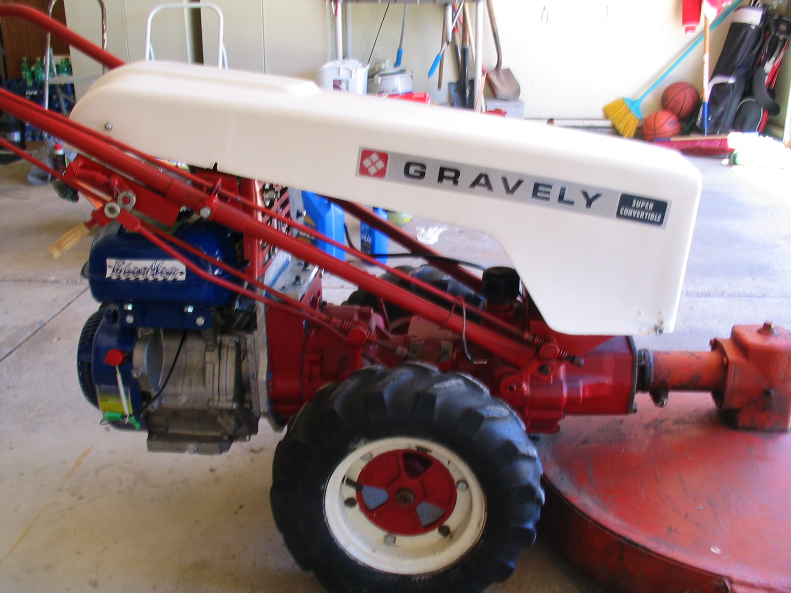

Well I was at harbor freight the other day and one of there new 420cc engines followed me home for $300 after the 20% :thumbsup:
So its going on my 5240, I like the smaller hood line of it verses the the larger hood of the L8 when I'm working with it(brush hogging) I'll keep the L8 for a bit of a restore job (ok just a paint job :laughing:)
Now now I'm cheap as ****, I'm thinking what was the shaft length of the kohler engine when mounted to the stock adapter plate? I know the shaft diameter is .75" or .875" I can take that to work and bore it to 1" and deepen the keyway.
Now if the length from the end of the stock shaft to the adapter plate isn't that short I can pull the crank from the new engine turn it down to length and mill the keyway a little longer.
So I would only need to get the pilot bushing. Cause my local gravely dealer doesn't take any prisoners. $66 for a shipper shaft :confused2:

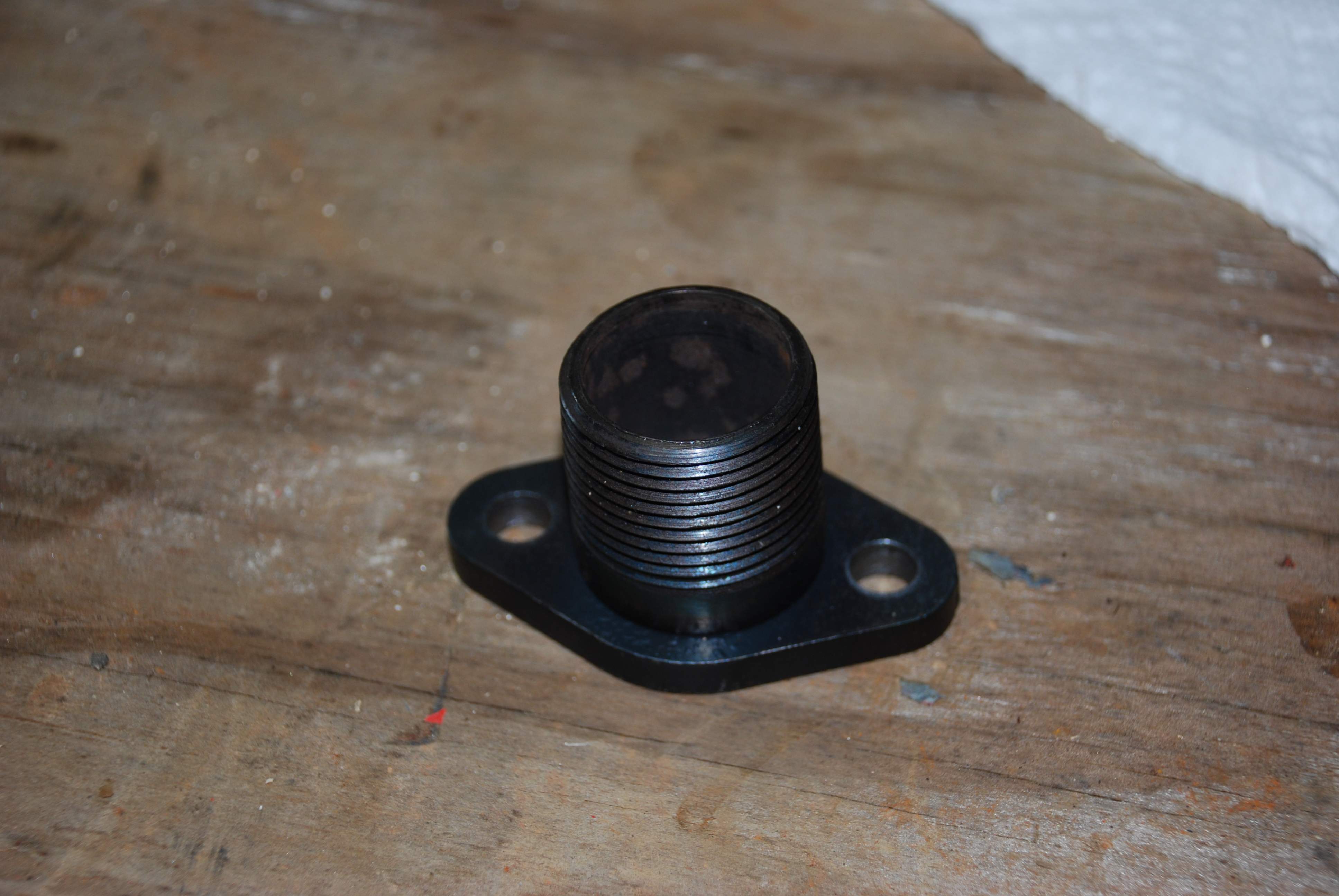

Here is a print of the pilot bushing
Before you cut the crank you may
need to drill it deeper and tap it deeper.
With the tools you have you can do it all.
Here is also a print for the aluminum spacer.
so you won't have to cut the crank.
