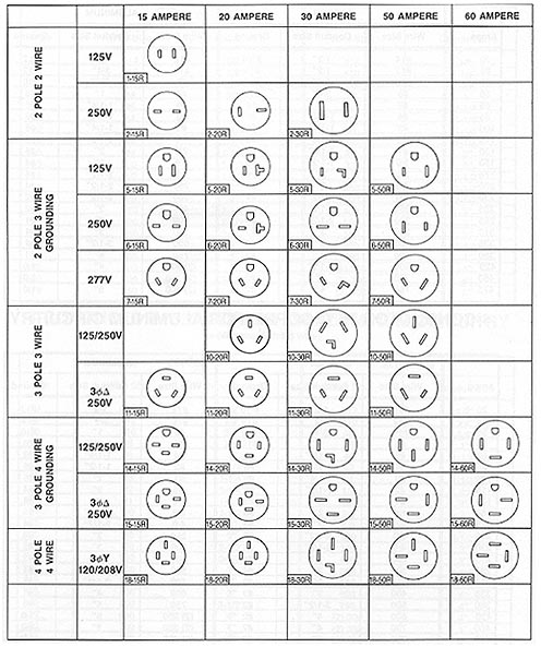

We could try this another way. A male plug on a cord to plug into a 120v 15 amp receptacle has one configuration. A male plug to plug a cord into a 120v receptacle 20 amp receptacle has another configuration. A male plug to plug into a240v 40 amp receptacle has another configuration. A male plug to plug into a 240v 50 amp has another configuration.
Go to graingers.com and download the receptacle and plug chart, do a bing search and see that every ampacity and voltage has receptacle and plug. More if you consider twist lock which also has ratings to the configurations. receptacles.jpg

Hopefully some of you electricians that are well versed in code and all can help me out.
In the midst of selling my home and under contract. Home inspection was done, then I get the request for remedy sheet.
One of the things listed was "overfused condition".
Not sure what this meant. So no idea how to correct. So I called the inspector that did the inspection to get some clarification. He stated it was the range wiring.
There is a thing on the back of the range that reads just like this
Problem is, it is being fed with a 60a breaker and 6 ga wire. He said I need to change to a 40a or 50a breaker. Is that correct? I thought you size the breaker to the wire, and not the device?

The plan is to just put a 40 or 50 on there. Have no idea what it actually draws, never put the clamp on it.
More so, just curious if the way it is now is wrong according to current code requirements. (all though codes from 1995 would have to apply as that is when it was built.) OR, if the inspector is just wrong in his assessment.
Clothes dryer is a 30 amp breaker with a 14-30R receptacle. The stove will either be a 50amp with a 15-50R or a 60 with a 15-60R .
I am sure when an electrician is wiring a new build house, he has no idea what the range is going to be? How does he know if its a 40, 50, or 60??
Same goes for dryers and water heaters.

I think what they are telling you is the actual outlet box is rated at 50 amps. It should be stamped right on the outlet what it is rated for. So if the outlet is rated at 50A you cant use a 60A breaker, simple enough.
Better not be plugging a stove or dryer into that plug. In fact that plug is long obsolete. The only thing now that would be close is a 277V or 347V single phase receptacle .
