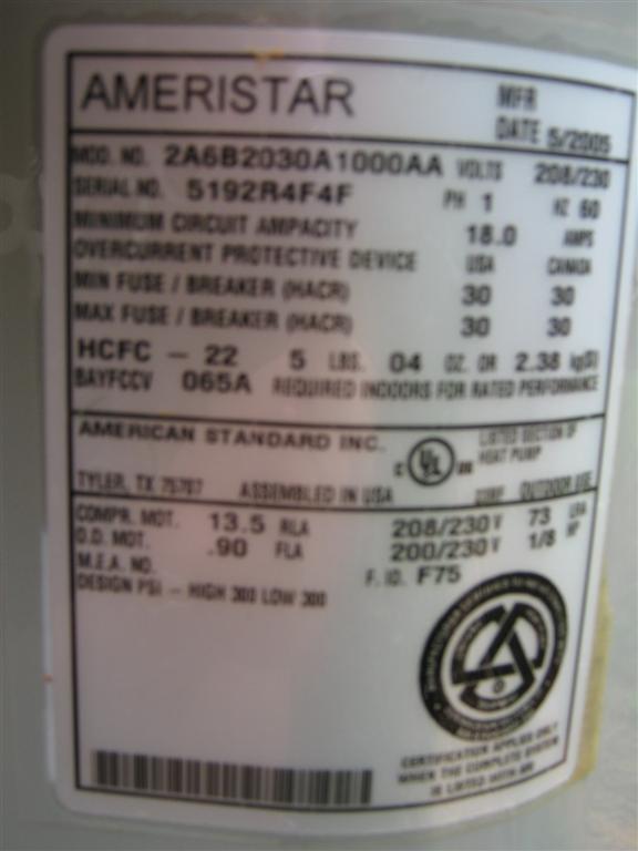

The way that I describe the difference in amperage that a compressor draws may be oversimplified but some can understand it easily when explained like this:
A compressor in an air conditioner is similar to an air compressor. If you put an ammeter on an empty air compressor and then turn it on you will see that it pulls low amps at first as the air pressure is low and there is no strain on the compressor motor. As the air pressure builds up there is more and more strain on the motor so it pulls more amps, and pulls the maximum amps just before it gets to the high pressure cut-off.
An air conditioner uses refrigerant instead of air. Refrigerants (freon) are designed so that they have much higher pressures when heated or compressed and much lower temperatures when cooled. If you put a pressure gauge on a can of freon and sit it in the sun you will notice a much greater pressure rise than in a can of compressed air. It may have 300 psi of pressure in the sun and 5 psi pressure when put in a freezer.
When the refrigerant pressure is high, just like in the air compressor, the compressor motor strains more to compress it thus pulling higher amperage. So if your condenser coil that cools the compressed refrigerant is dirty, the refrigerant stays hotter and has higher pressure and it makes the unit pull higher amps. Also, on a very hot day the refrigerant will be at much higher pressure than on a warm day, again making the unit use higher amperage.
So the exact same air conditioner that you are using in Michigan on a 80 degree day will pull lower amperage and use less electricity than the same one in Texas on a 90 degree day.

I'm really unsure what I'm paying for. They used to have a demand charge, but now it's a dozen other charges that add up to the same thing. There is the amount of electricity that I use, and then all the service fees for getting it there.
What I'm really wondering is how much of a difference my usage will be with the fan unplugged in the AC unit. We've noticed a huge difference in how much more air comes out of the vents.

Centrifugal fans pull more amps the more air they pump.
Thus, the partially blocked fan would pull less amps since it was restricted. Restricted it would probably run longer to try to cool the area. Now, with more air flow it should run a shorter time to cool the area, but pull more amps. I wonder if that will balance out the same or if the run time is short enough to give you a savings.:confused:

Doubtful that this would make much difference because a 2.5 ton AC/Heatpump will probably have a 1/3 HP motor and a FLA of 2.7A and if the coil is clean/unblocked it would run much time.
