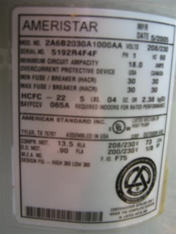

Not sure if I got the right information, so please let me know if I missed something.
The picture is a big fuzzy, but I'm hoping that it's clear enough to those who know what they are looking at to see what I have.
Here is what I wrote down. It's not everything, but what I think is pertinent.
Ameristar
mfr date 5/2005
Mod No 2A6B2030A1000AA
Minimum Circut Ampacity 18.0 Amps
Compra Mot 13.5 RLA
O.D. Mot .90 FLA
208/230 V 73 LRA
200/230 V 1/8 HP
f ID F75

Compra Mot RLA - Running Load Amps (pretty sure of this) for your compressor. Your meter will probably read a little less than this at the temperatures that you mentioned.
LRA - Locked Rotor Amps - If the motor is held from turning over this is what you would measure. This is like start up current.
Not sure what O.D. Mot is but it sounds like the fan. So the .90 is the Full Load Amps of the fan.
Do you clean the evaporator and condensers coils (inside and outside coils) every six months. This can be a big factor in power consumption. I think you should have a pro check you AC out.

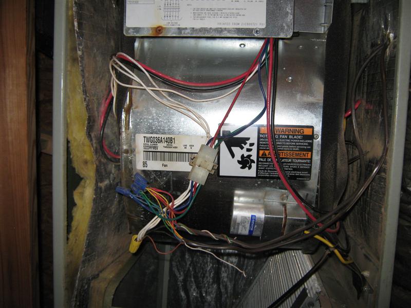

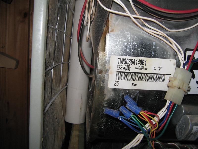

Tally got me to wondering what the coils and terminals look like in the compressor. I had a really busy day today, so I asked my dad to take a look. I also printed out some of your comments and suggestions. With that, he looked at the coils and determined them to be nice and clean. He looked at the terminals and also said they were good. He set the AC to 65 degrees and while it was running, he felt the wires, which were cool.
He then went to do the same on the inside, blower unit. I'm drawing a blank on what it's called. The filter was clean. I change it the first of every month. I've never opened it up, but Dad did. The heating coil is spotless.
But he did find a big suprise.
The insulation that lines the sides of the unit was sucked into the fan or blower. It's a wonder tha any air got through the insulation since it was sucked in there so badly.
He had already pulled it out when I got home, but he didn't know what to do in order to stop it from happening. The first picture shows it starting to get sucked back into the fan/blower again. Just in the picture, it's amazing how much air the insulation blocked.
I found a metal screen/grill type of thing in my scrap pile that fit after cutting it down to size. Then I wedged in a length of scrap 2 inch PVC pipe to hold the grill in place. There is now a large gap between the insulation and the fan.
I'm hopeful that this will allow the air to flow freely, which should require allot less power and electrical usage.

Yep, Eddie you got it! With a lack of airflow over the evaporator, the coil would likely ice up, further restricting airflow.... it's a vicious cycle that will:
a) cause your house thermostat to say, "Hey- we need more cooling! Keep running!" (and not get any...)
b) Do bad things for the compressor (eventually), as the liquid will NOT evaporate in an iced-up evap coil (no source of heat), and potentially --likely, after a bit-- send liquid back to the compressor...:eek::eek:
That insulation "plug" alone would make your compressor run a lot more than it should. If it sounds OK (no loud rapping noises like loose valve-lash on rocker arms in a gas engine), it's probably OK- compressors are pretty tough, actually. If it did pump liquid, the valves-- spring-loaded flapper type, most likely-- are usually the first to go. You might wish to check it's efficiency: you should get about a 15 degree drop over the evaporator, between incoming air and discharge air, assuming humidity isn't extremely high. (I keep thermometers on my heat pump all the time for that purpose- one at the filter and one in the discharge duct.)
Your wire mesh-over-the-insulation solution should be perfect.
