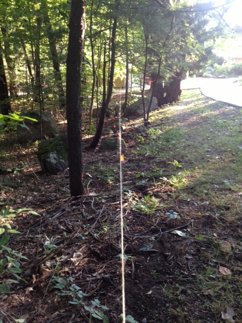

I've been working on trenching 265' for an electrical service run to be used for a gate and lights. I thought I'd post some pictures. This is a very time consuming job due to my soil - glacial till. It's heavy clay filled with boulders everywhere, which range in size from basketball size up to as big as a car. The trench has to be at least 30" deep to allow for bedding the service per code. I'm trenching with my B2920 and BH65 with a 16" bucket. The conditions make using a typical trencher impossible due to the large rocks. Quotes for excavation ranged from a few thousand all the way up to $12,500!!!!!
The project is taking a long time, but I am probably done with close to 200 feet now, though it took 7.5 hours of work today to go ~150' due to several large boulders that had to be dealt with.
The trench line, it's going in between a bunch of trees and some surface boulders have to be moved just to start work. Length will be over 265' when done. I used a string and utility flags to mark the path to attempt to keep it as straight as possible.

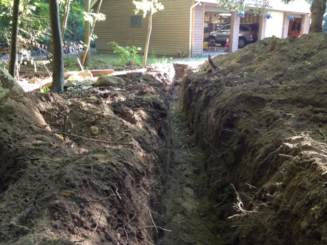

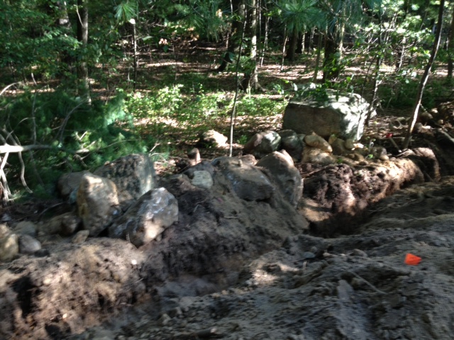

Partially done section. Soil and small rocks are on the right for easy backfill, larger rocks and boulders are on the left for use later in other projects.

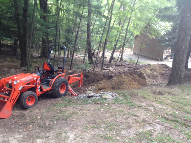

Tractor in one of the easy access sections.

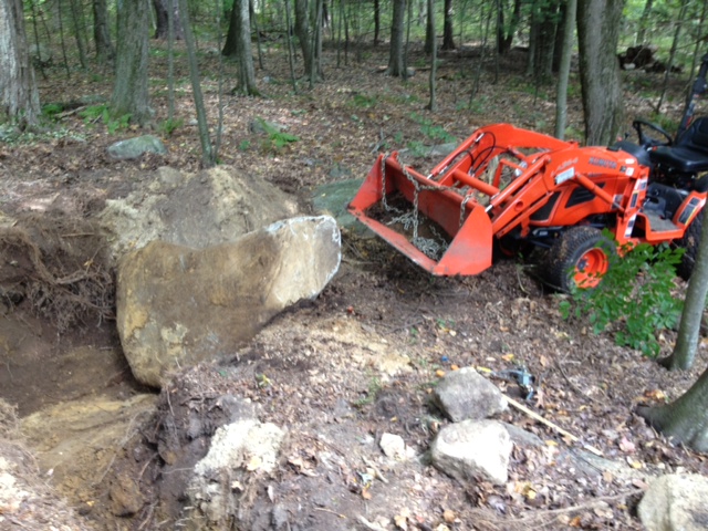

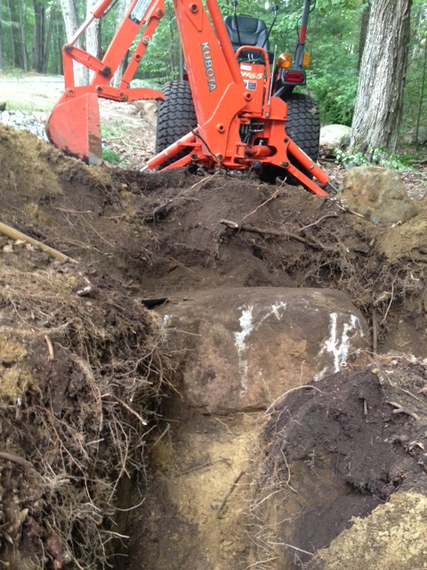

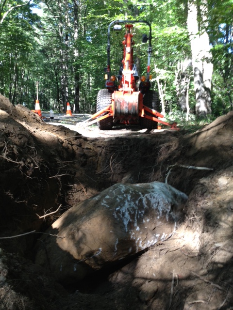

A Problem. A rock that is directly across the trench and is close to 30" deep, 6' long and 30+" wide. The trench is right at it's center and initially it didn't move at all when pulled. Feather and wedges failed on this rock, partially due to it's thickness, but also due to the top breaking off and ruining the drill holes before splitting. Drilling was taking far to long (granite), so I decided to try to move it out of the way into a hole I dug next to it.

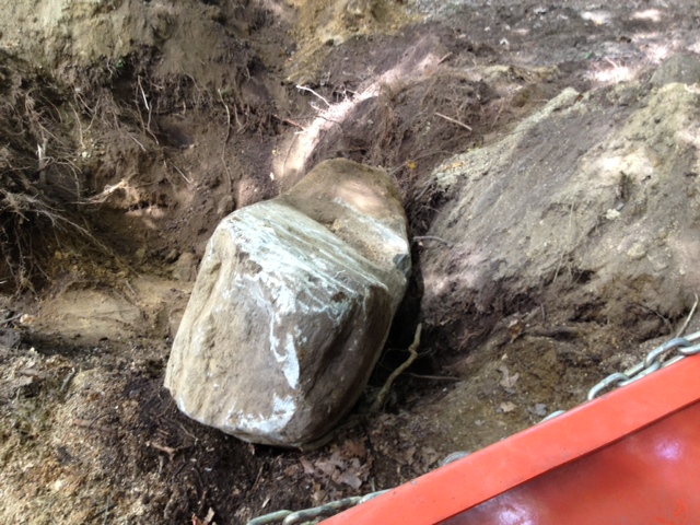

I was able to get the rock up on end and then with a lot of chain and effort use the tractor to tip it into the deeper hole. Now 2' stick above the surface, but it's out of the path of the trench.
Rock in it's final resting place. I broke a 4,000 lb come-along trying to get it here and ended up using the bucket to lift and pull to get it to tip into the deeper hole.
A view of more of the trench

The section I dug today, notice the rocks on the side of the trench. To give some perspective the big boulder in the background is the size of a small car (I didn't move that one), the other ones are in general 2' cubes or bigger. All granite and all piled on top of each other.

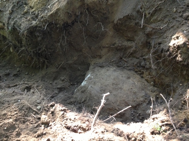

Stopped after I hit this one, so far I can tell it is at least 3' x 3', depth is unknown, but when pried with the BH it does not wiggle. I'll have to dig around it and see what I can do.

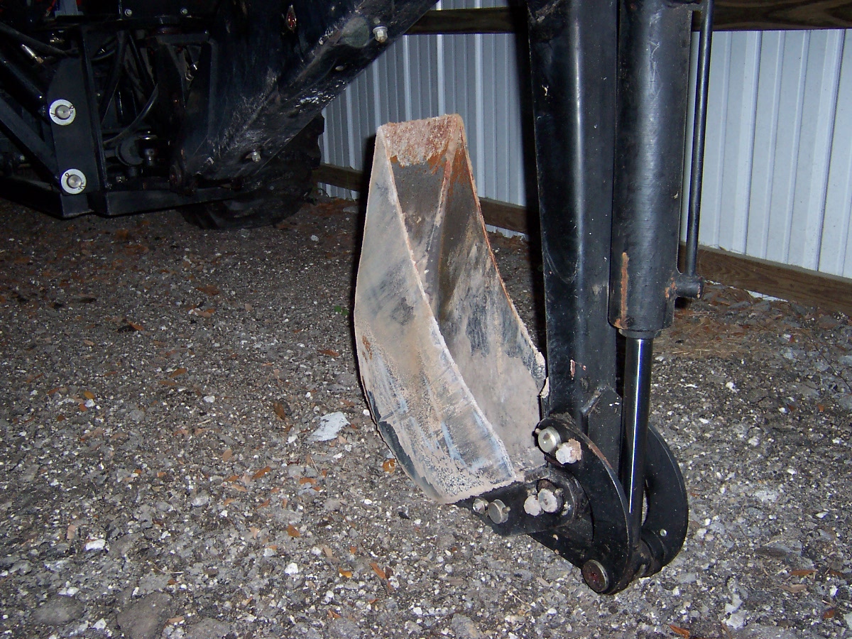

I had some trenching to do and I made a 6" bucket for my Hoe.
Having a Welding/Fabrication Shop really helps. :)
I just made a pattern of the 18" bucket side and then cut it out with my Plasma Cutter. Then some other fabrication for the rest of it.
The narrow bucket digs better because it doesn't require as much power to dig.
It really works great for things like stump removal.

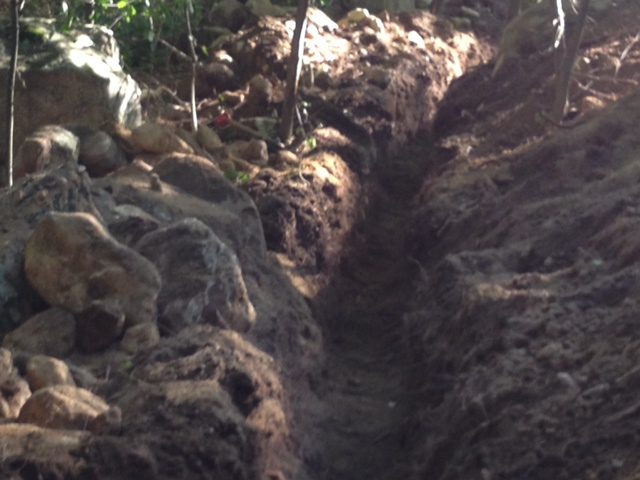

Well I managed to get the latest boulder exposed today after work.
I'm now officially wishing I had a MUCH larger machine and hydraulic thumb! Anyone have any ideas on how to get this one out?
I normally would dig to the side of it and push it in, but this one is right between a paved driveway and a tree, so I have to drag it somewhat. I tried to build a ramp and pull it out, but couldn't even budge it (not enough traction). I can stand it on end with the BH and thumb, but cannot get it out of the hole. I've got a new diamond hole saw coming later this week so may try the feather and wedge method again, though it has yet to work on these rocks.... Progress is at a stand still until I can get past this one.

Good news! I just managed to get it out of the way. I used something similar to the crib method, I dug an area out next to it and then was able tolift sides and slide other rocks etc under it until I could tip it on edge. I was barely able to move it around with the BH and with a lot of flipping about finally got it positioned off to the side out of the path of the trench wedge among a couple of other rocks in the same hole. I'll post some pics tomorrow. Thanks for the support and encouragement, only 100' to go!
By the way - talked to the electrical inspector today. My contractor gave me some bad info, the regulation for this run is that it needs to be down 12" since it's in conduit, 120v and GFCI!!! I think I'll do the final 100' at 18" so I can bed it and still have clearance to meet code, that'll make it MUCH easier.
