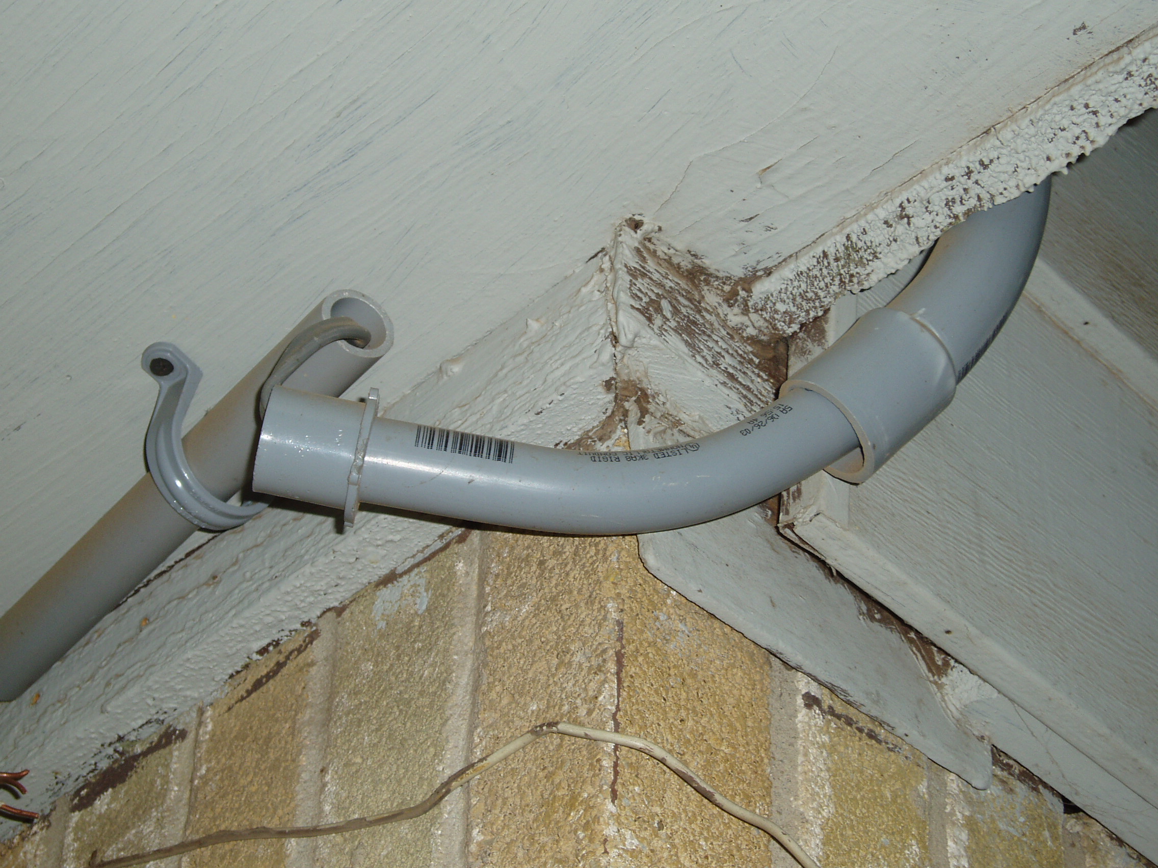

Eddie, Article 352(Rigid Nonmetallic Conduit:Type RNC) of the NEC is the dedicated article for PVC. 352.2 describes the PVC it does not metion color.
352.3 does say that it has to be listed. I'm willing to bet that your purple stuff isn't listed for electrical use. Honestly I could care less. Just thought I would share the part of the code that you are not complying with. I firmly believe that a man should be able to do what he wants on his own land. It is your dime and your land do with it as you will. I think Sparkkky is trying to say that if you are planning on making your property open to the public, it would be is in your best intrest to follow the standards. One accident, electrical or not could turn in to big problems.
