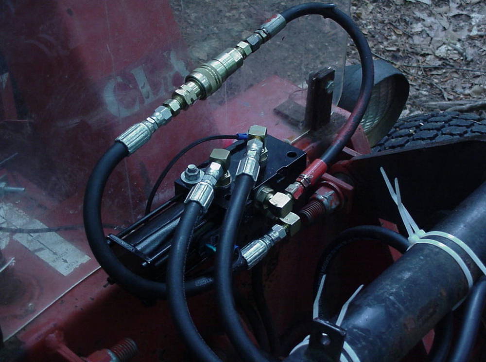

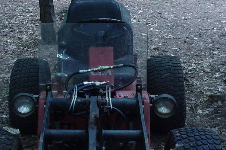

Here's some pics...front view of the selector valve. The two hoses on the front are the diverted ports. These hoses curl up and are hooked together with quick-connects (just in case I hit the button accidentally or something causes a short at some point in time). I've got hoses and quick-connects on the 2x8 cylinder that will operate the grapple jaw, so it's just a matter of plugging it in.

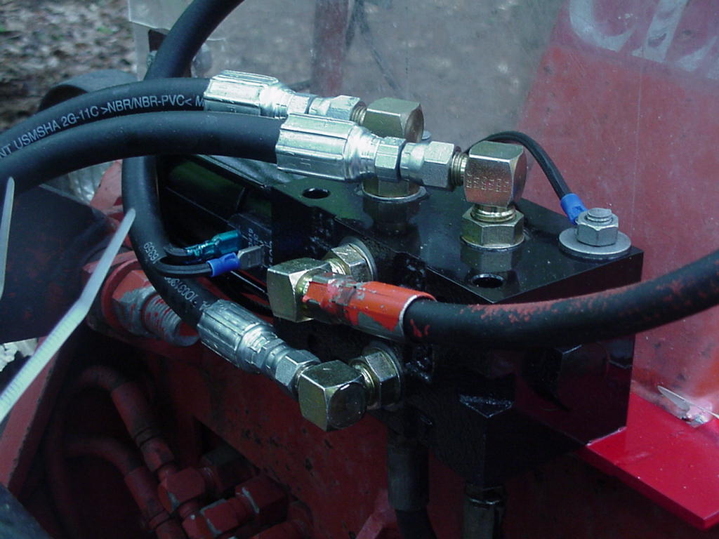

Here's slightly closer view....as you can see, the hoses I used to hook all this up are a bit too long...but like I said before, you can curl a hose that's too long, but you can't stretch one that's too short, so I decided to err on the side of too long to avoid another 3 hour trip back to Carquest... /forums/images/graemlins/shocked.gif

Here's a closeup of the selector valve itself. You can see that there are 6 hoses and 2 wires going to this contraption. The two hoses on the bottom come from the ports on the joystick valve that went to the curl cylinder. The hoses on top now go to the curl cylinder. This is the default path through the circuit when the button is not pressed...pushing the joystick to the left curls the bucket (or whatever attachment), and pushing it to the right uncurls the bucket. The two hoses on the front are the ones that curl up and have the quick-connects. These two are connected to the ports that flow is diverted to when the button on the joystick is pressed and the joystick is moved left or right. I've connected the hoses and quick-connects such that when you press the button and push the joystick left, the cylinder extends (which would close the grapple jaw), and when you press the button and push the joystick right, the cylinder retracts (which would open the grapple jaw). (I wonder if this setup makes sense for a hoe arm? If not, I could always switch it at the hoses on the hoe arm...yes, that's another addition I plan to build since I've already got an 8" bucket /forums/images/graemlins/wink.gif)
Although I ended up with 6 straight fittings and 6 elbow fittings, what seems to have turned out best is 2 straight fittings on the bottom, and elbows on the front and top.
You can see where the two wires connect to the front of the valve (where the round part starts, just a little left of center). The farthest left wire connects to the button mounted to the joystick, and the right wire goes to ground, which is the bolt on the top right that bolts the selector valve onto the mounting plate that I made.

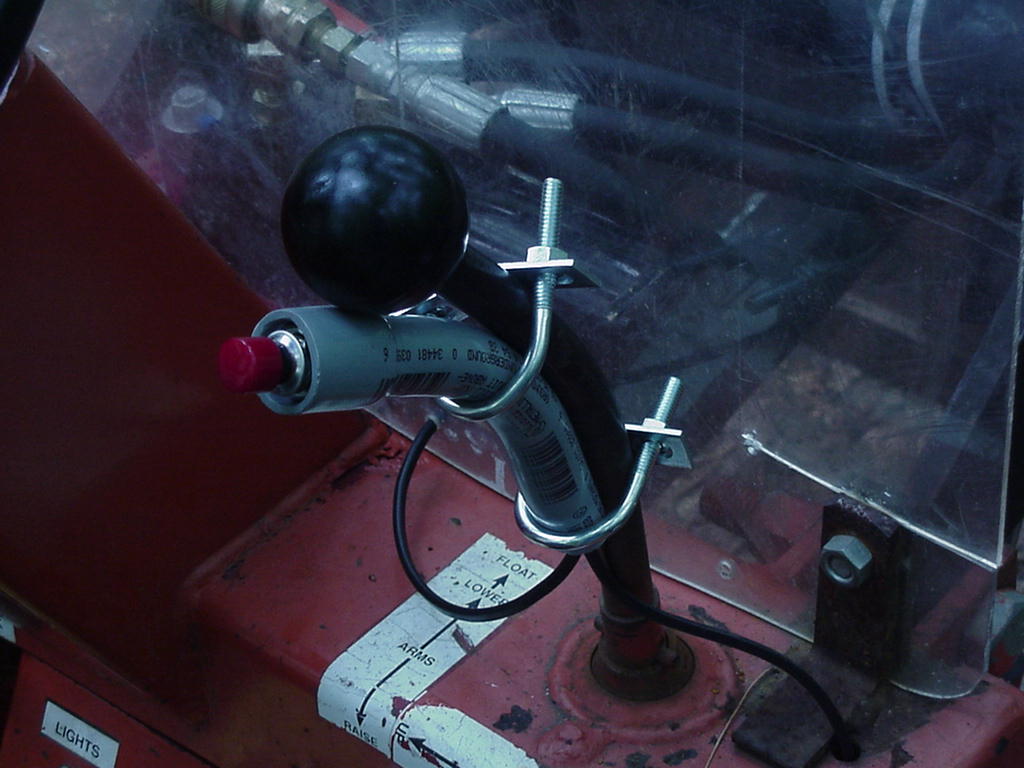

Here's the joystick button...I wedged two 1/2" nuts into the flared end, and screwed the plastic pushbutton into the nut (threads don't match, but it still works). The button is double-pole single-throw, so it takes two wires. One comes from the white wire going to the ignition switch (this has a voltage when the ignition switch is on) and the other goes to the pole on the selector valve. With the ignition on but the engine not cranked, you can hear the valve click when you press the button.
I positioned the button so you press it with the heel of your thumb. The piece of PVC pipe wanted to gravite to that position since it's curved, and when I thought about it, it seemed to make sense anyway, since you can get a good grip on the round knob to push it right without accidentally pushing the button.
I see that I'll need a little practice to not let go of the button before returning the joystick to center detent. If I don't get good enough at it, I might actually consider replacing the pushbutton with a toggle switch that's within reach of my thumb...we'll see.

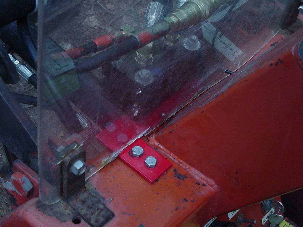

#36
Finally, here's a shot where you can see the L-shaped plate that I made to mount the valve to the tractor. I welded two pieces of 1/4" x 2" wide flat stock into an "L", drilled 4 holes, then painted it red (doesn't quite match the tractor, but the purpose was to minimize rust. I also painted the selector valve itself black to minimize rust.) The plate mounts just left of the steering column with two 5/16" bolts, and the selector valve mounts onto the plate with two 5/16" bolts that go through the side. The valve has 6 holes: two 1/4" holes on the front that go all the way through, and four 5/16" holes on the top that go all the way through. I had to mount the valve just a little above and forward of the "dash" to have sufficient clearances (from the lift arms, and lift and curl cylinders) to be able to attach the hoses. It's still a somewhat tight fit, but at least I can get a wrench on it... /forums/images/graemlins/tongue.gif

Very nice pictures, Dave. Looks good. So all you have to do is pop those quick connects and stick on an attachment? Pretty cool. /forums/images/graemlins/cool.gif /forums/images/graemlins/cool.gif /forums/images/graemlins/cool.gif
So, a grapple, power angle snow plow, etc... would work very well. Nice job.

Yes, now I have the equivalent of what the newer machines have in an auxillary PTO, but it's operated by the button and joystick rather than a seperate lever.
Concerning a parts list, the only part that was in any way "specialized" was the selector valve itself. It's a Gresen solenoid-operated selector valve (although I notice it has "Parker" stamped into it...go figure), rated for up to 8 gpm at up to 3000 PSI. The best price was at http://www.surpluscenter.com , $139.50, part# 9-1782. A local hydraulic supply place would have loved to order it for me, but the price was $350 or so.
The fittings that go into the selector valve were male SAE 6 (3/8" o-ring type, the valve side) to 1/4" male JIC-37 (size 4, the hose side). Of course, I don't know for sure if the newer 400 series use hoses with 1/4" female JIC swivel fittings, but they probably do. I wouldn't even try to make a guess on the 1400 or 2400 series, might be bigger. The pushbutton was a simple SPDT button rated for 10 amps from Radio Shack. The piece of PVC and u-bolts came from Lowes/Home Depot. The wiring I just happened to have lying around. The hoses obviously were made up at Carquest... /forums/images/graemlins/smirk.gif I had to get fittings for the cylinder as well, plus I made all this more complicated by trying to roll-in my plan of custom-making my own hoses at the same time. Again, I'd be reluctant to suggest all the hose and fittings sizes because those might very well be different between old/new/small/large/non-PT machines. Unfortunately, that was really the part that took the most time. Take Charlie's advice and just go to a hydraulic's supply house with the selector valve and one hose off your machine! Do what I did (order just about all of it mail-order) only if you're very experienced with hydraulic fittings and can figure out sizes and types by eye-balling them! /forums/images/graemlins/tongue.gif If you don't try to get too complicated (like I apparently did with the hose deal), then the install is really simple.
