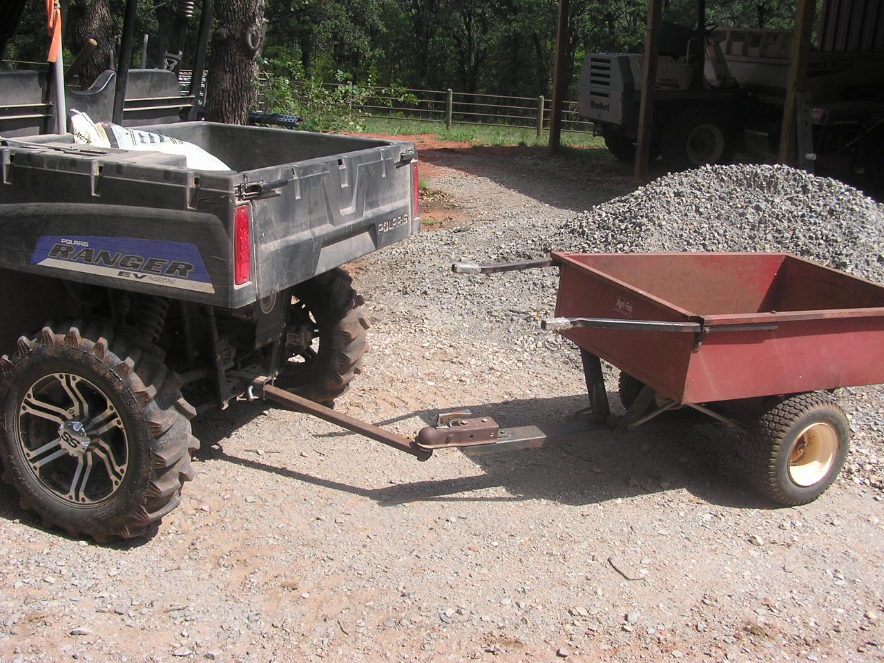

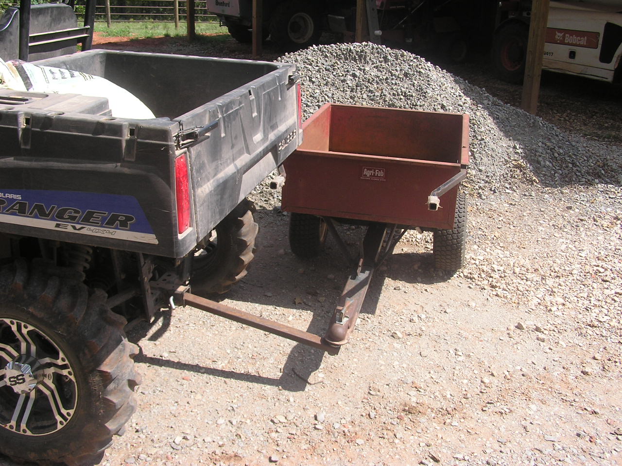

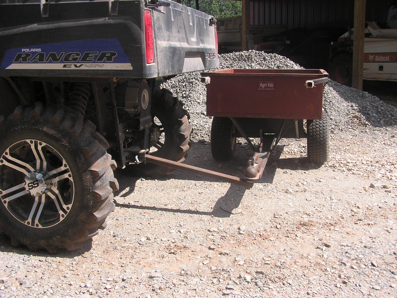

The long ball mount (to clear the handles) for my dump cart.

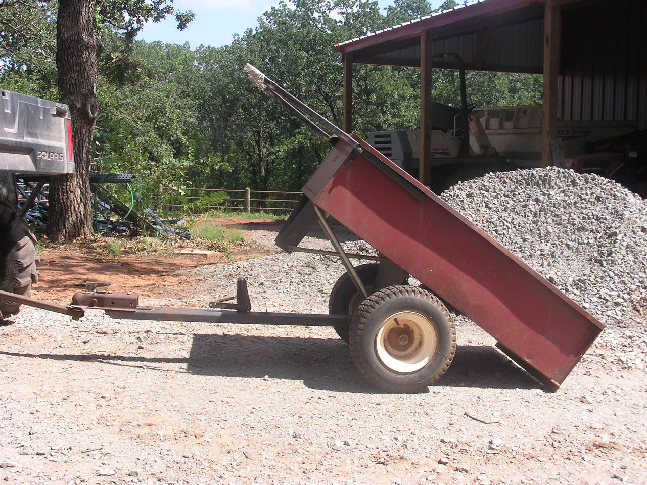

It pivots on the pin for off road use.

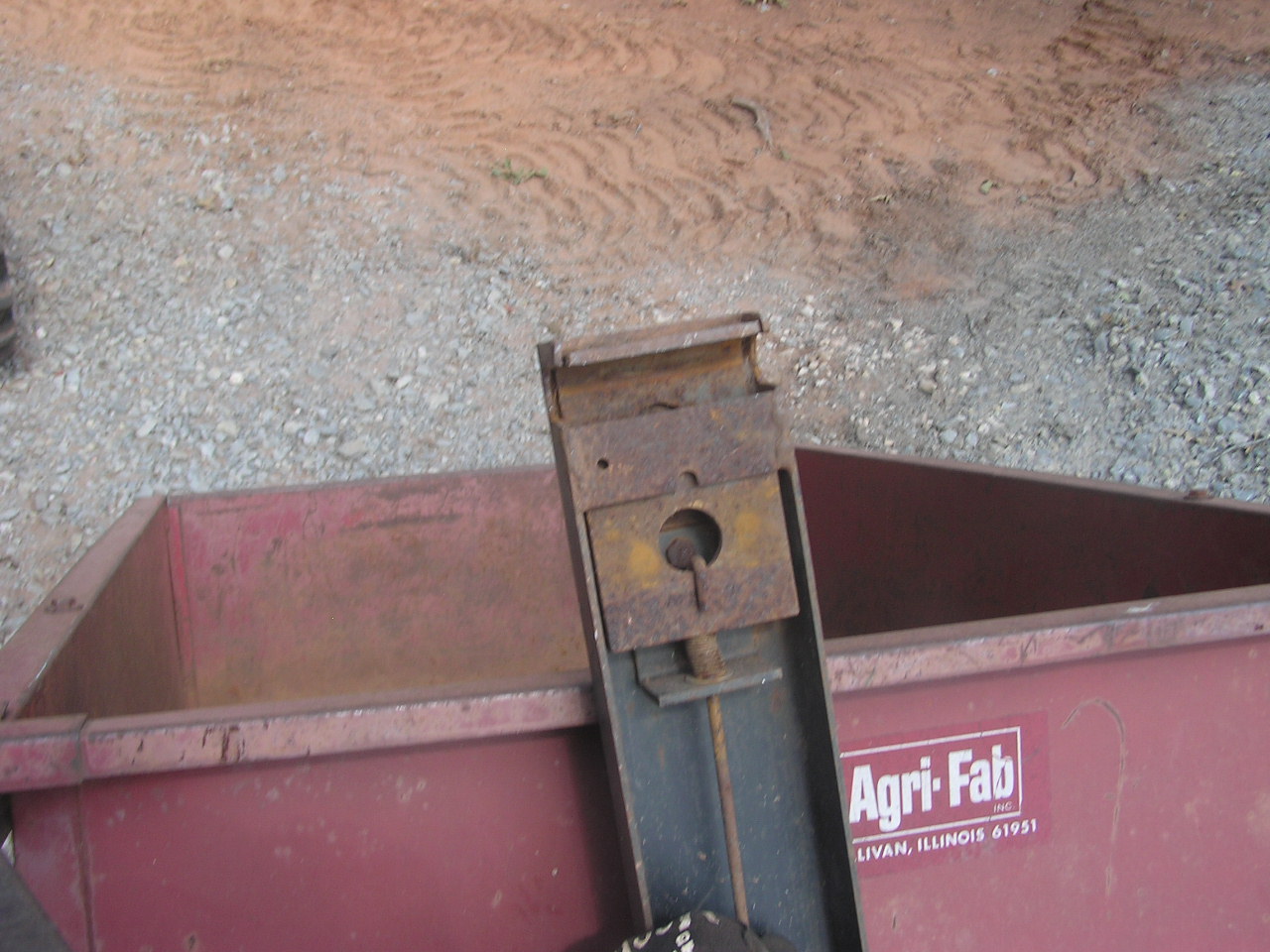

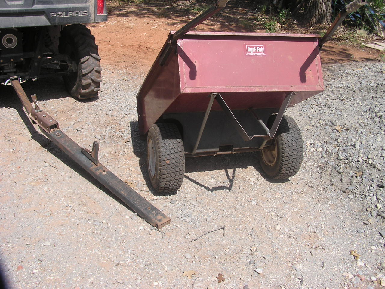

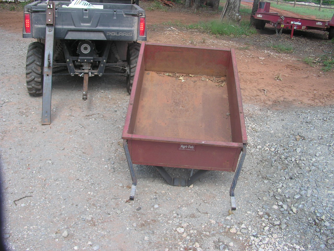

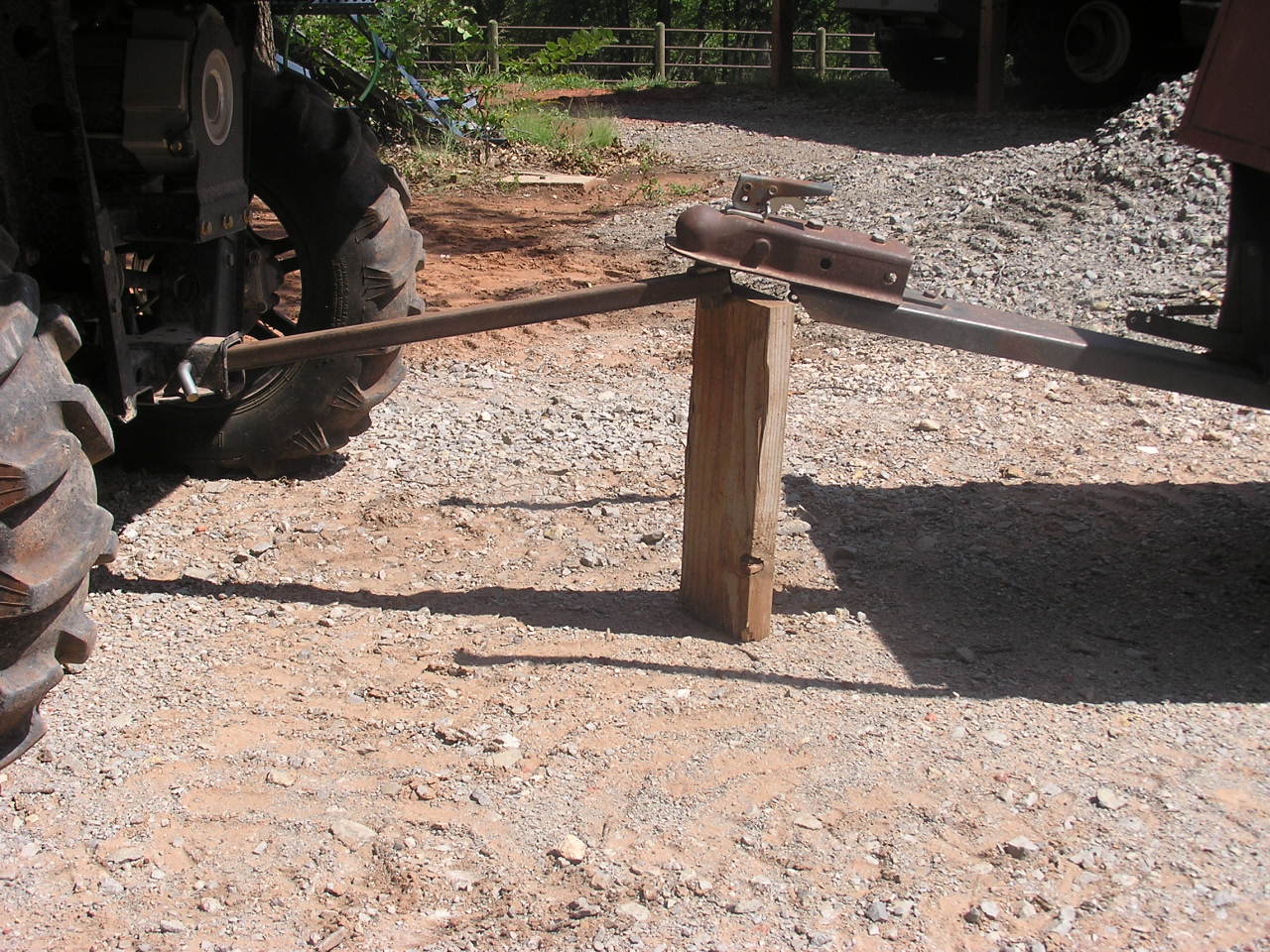

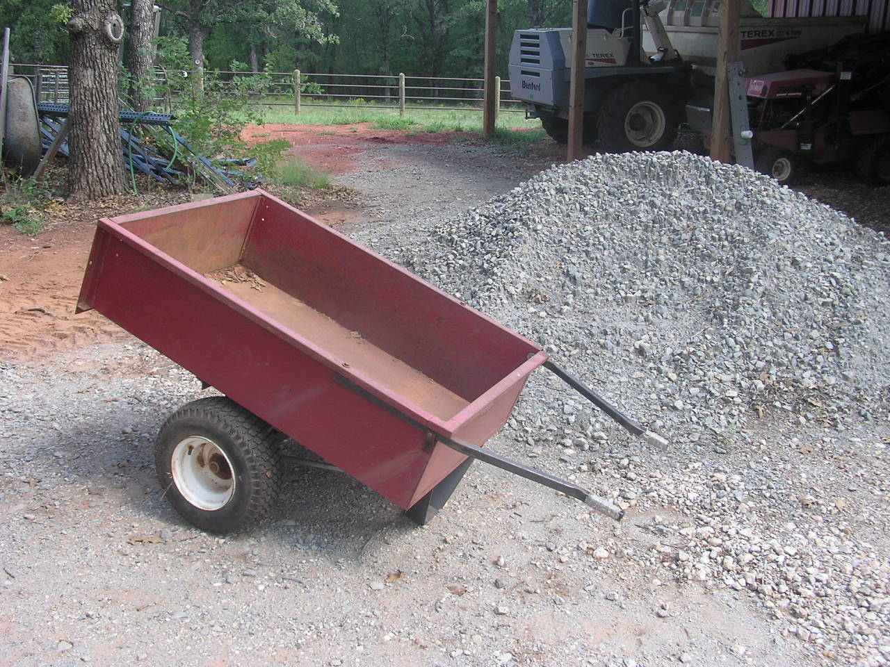

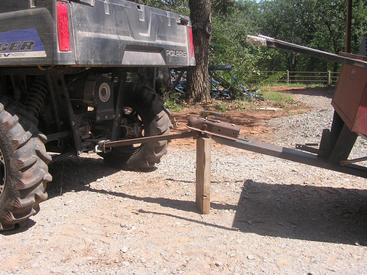

About thirty years ago I modified the tongue to make removable by pulling on the rod at the coupler and lifting the tongue up off of the axle.
Now you use it like a wheelbarrow.

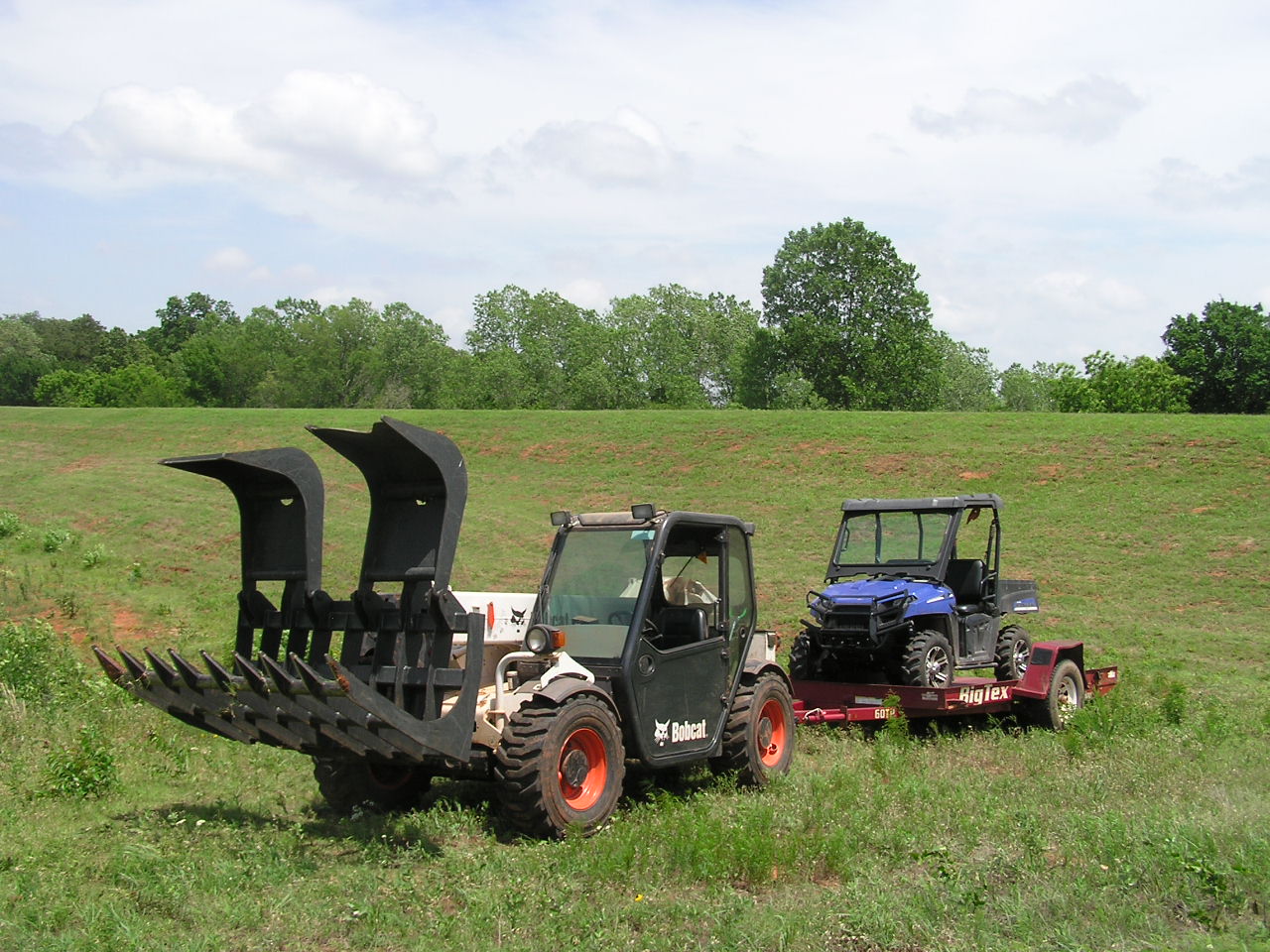

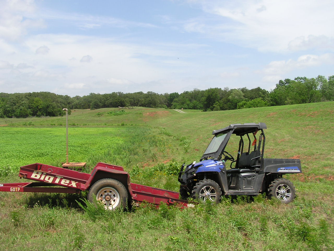

99 hours, in a year and three months. Yep the range is not even close to 50 miles, but it is good enough for what we use it for. With no odometer it is hard to tell how far it is driven doing work around our 80 acres.
Sometimes it gets to ride to the worksite so I can drive it back to the shed and get the dumper.
