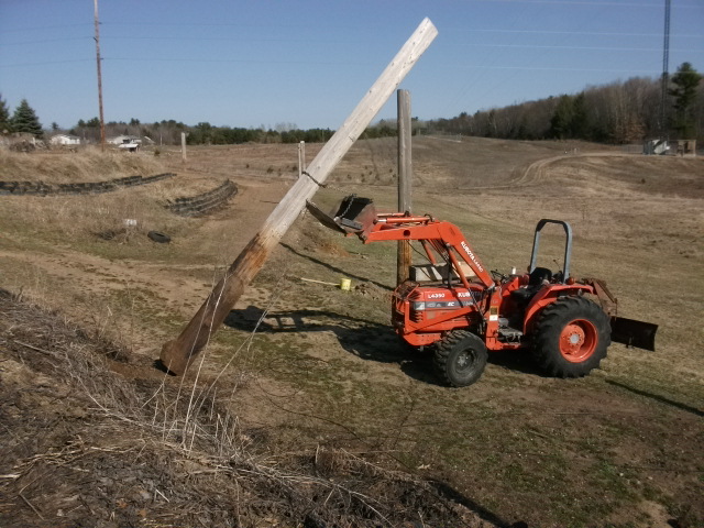

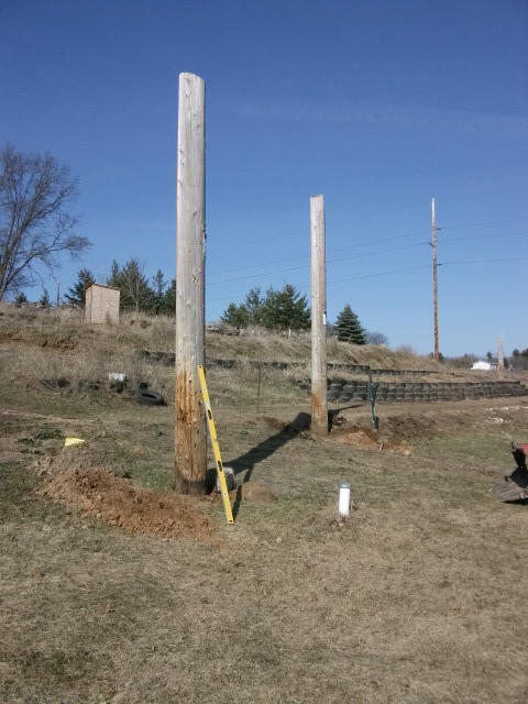

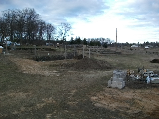

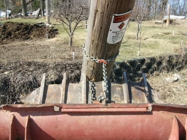

I use 16'-18' telephone poles spaced 30'-40', and just tension electric fence wire with the tractor. Poles are down 5' and only go up 6' with the wire. The birds love to sit and hunt bugs from the tops and have a few bluebird houses out too. My place looks like "post-henge" but the poles were free and everything is happy except for the deer. I have my orchard and garden fenced. I use my Loader Buddy to set the poles. I am in the process of expanding the garden area to more than double and may add more fruit trees as well. I have terraced with tires and plant with comfrey for a no maintence wall. There are many materials to build a fence with, I just used what I had at the time and ended up really liking it. Having the birds use the poles so much is a really nice bonus.
