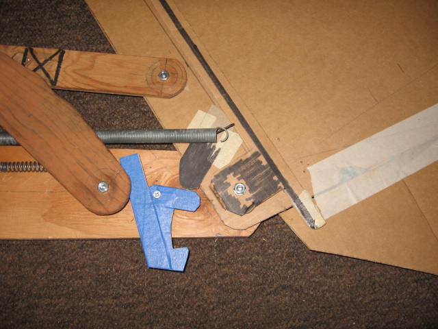

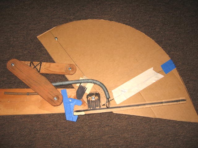

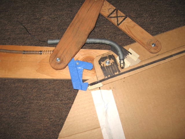

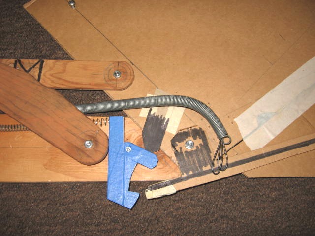

Thanks for the photos Ottawa. Be sure to let us know when you get the video uploaded.
I am curious about the cam follower in the first picture (side view) Is the slot a continuous elongated "S"? It appears to continue down towards the bucket flap.
Maybe next time you are with your hoe and have a camera you could send us a couple more pics showing the cam follower and flap in various stages of motion, ie. with the pivot at various places on the follower and the relation of the flap when in that position.
Thanks again, this looks like a very viable design. The fact you are still using it after so many years is a testimony in itself.

I will get some more pictures of the bucket in various positions as soon as possible (probably Friday). So be looking for them on Friday evening. I will most likely have the video posted by that time as well.
Jason
