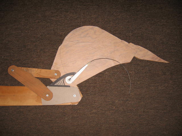

I guess I AM compulsive. Now its way past my bedtime but I couldn't let this subject die without some workable conclusion. I think the following would work. I don't know if I will build it or just do as stated above.
I went back to my original design. But instead of the ejector flap being stationary I made it pivot this time and devised a catch and release lever. This is pretty straightforward and I like it for simplicity.
Bucket in dig attitude

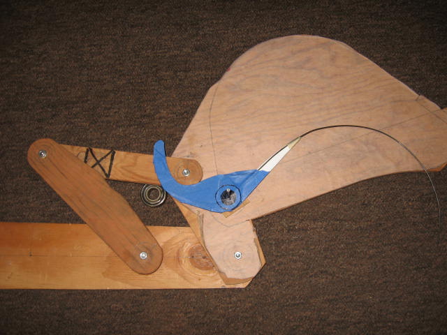

Detail of catch & release latch. Flap and release catch are spring tensioned. The flap rests against the back of the bucket. If there is a recalcitrant load in the buck do a full curl to capture the ejector flap. The flap is retained in this position while the bucket is opened and the material is dumped. This occurs just before full open bucket. Then proceed to full open bucket, the release latch is activated and the flap spring returns to rest against the bucket back.

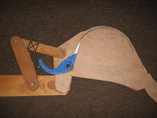

Ejector flap engaging catch

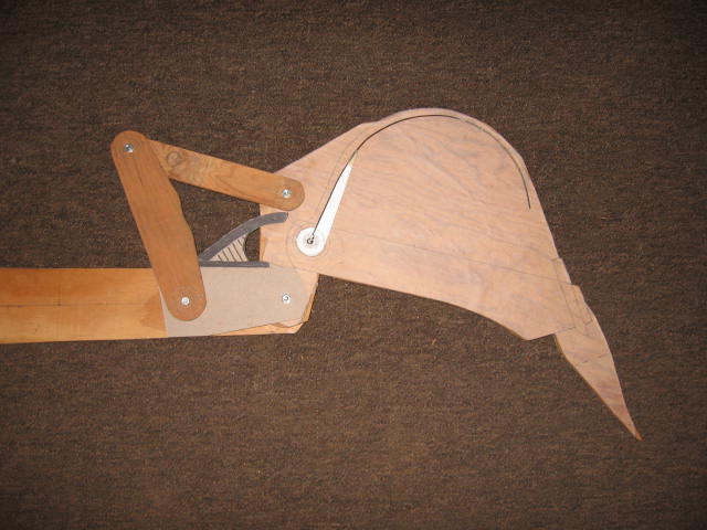

Open bucket and dump

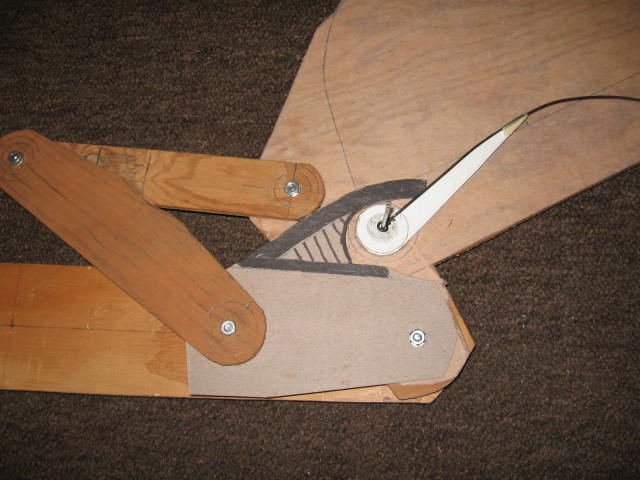

Open bucket fully to activate flap release

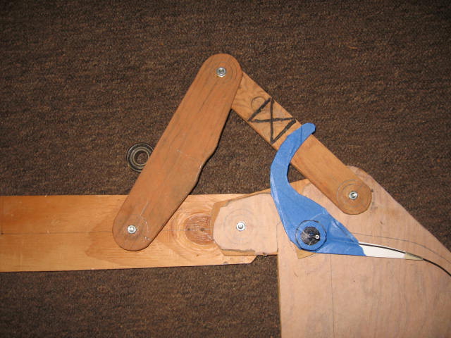

Flap spring returning to rest position
So there we go. A fairly simple design that should work without too much fussing. This bucket is a custom design that is almost true radius except for a straight section the last 30 degrees or so to help out the angle of attack when digging. Maybe the design principle is adaptable to existing buckets, I'm not sure.
It is doubtful I'll build this bucket but if anyone does please post your construction and digging results so we can see.

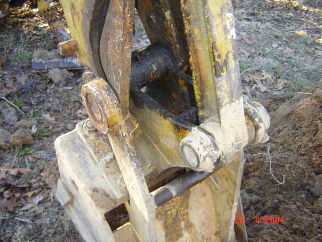

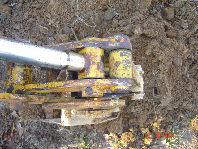

My 1957 Industrial Minneapolis Moline 445 tractor has a Ottawa Backhoe that was designed and patented with an ejector plate built into the bucket. It is a really good design. If you go to the US Patent Office website, just do a quick search for patent number 2,764,306. It is a really unique design. The plate never gets in the way whatsoever. It only actuates when you fully extend the bucket. This is a very rare backhoe. Even though it is 50 years old, it is conceptually way ahead of its time. Now if I could only find a operator and service manual for it.:D

That is a neat old hoe, everything about it is unique. The ejector bucket, boom linkage/ hydraulics and the outrigger design. Very innovative, especially considering the era.......that's a keeper!
