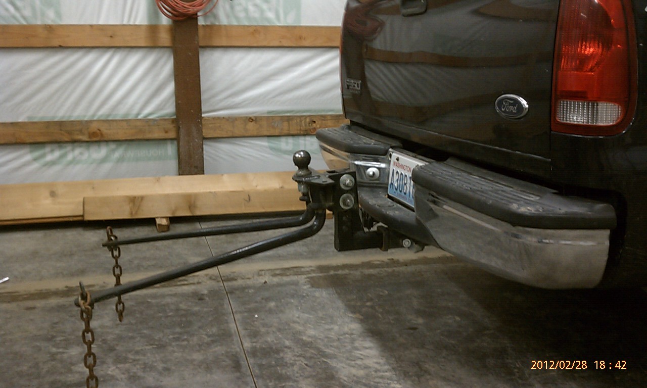

Don't think of it as a few degrees off, think of it as 5" off. Depending on the truck, it may squat down a good bit when loaded but not 5" so you need to buy the proper shank.
Try to always tow with a level trailer. Obviously it is more important to have a level trailer when it is loaded vs. unloaded so being a little nose high with the empty trailer is going to happen.
I recently set up my new 8000 lb RV trailer to be towed by my F350. When putting the tongue on the ball the ball dropped 3". After snapping up the WDH spring bars it was only a 2" drop.
I had the opposite problem though, my new trailer coupler was really really tall. I had to buy the 100$ drop shank and make it a rise shank and it still barely worked.
So yes, buy the right shank. You and I will both have an extra standard shank in the barn.

Depends entirely on the truck. 1000 lbs of tongue weight has a profoundly different impact on an F350 than it does on a VW pickup. My 8000 lb trailer will put 800-900 lbs of tongue weight onto my ball and gave 3" drop without WDH and 2" with WDH. I provide these data points as reference so that you can see what you should be aiming for and what to expect.
The shank I bought was from an RV store. I don't even know if it has a brand name or rating stamp on it butneither did the original and like the original, the new drop shank is indeed a solid heavy shank. Not much choice for me with this but I will keep an eye on it.
Can't imgaine why it would matter which way you flip the "grave digger" drop shank. Actually, on edit, yes I can. In my setup the ball is farther from the centerline of the receiver than it would be if the shank was flipped. So yes, the grave digger is weaker when set up as I have it vs. the down way.
I got my information from shopping around on etrailer.com. In their filter options, they had some shanks that were rated for drop only, and explicitly said that they couldn't be used in the "raise" position--at least, that's how I interpreted it.
I'm not a fabricator, but I can see how the stress on the joint would be different in the raise position than the drop position. In the raise position, the joint is trying to "open" and is "pulling" on the welds holding the reinforcement brace in. In the drop position, the joint is trying to "close" and is "pushing" on the welds. Or maybe that's just totally off-base. Like I said, I'm not a fabricator. I just do what the instructions on the box say. (Most of the time.)
