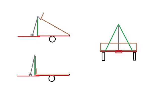

/ Converting small utility trailer into dump trailer? #50
I did this with one of the HF 40x48 trailers to move dirt around the yard before I got the loader. Brown is a box built on top of the trailer. Green is an A frame I made out of scrap wood. You could do it out of steel tubing or thick pipe. Grey is a winch cable.
Mine didn't cost me anything since I had it all on hand. No idea what it would cost to build a version strong enough for what you need to haul and lift.
I have access to a lot of 3" angle iron for free. Your plan might work with a few alterations. I could use the angle to go around the perimeter of the box to reinforce it. I could also fab up the 'bridge' across the top for the winch cable to go over (I would have to make it removeable, yet very strong. Probably like an upside down "Y" ). I just happen to have a 9000# winch that may now have a job to do..... mmmmm....interesting concept. Thanks
