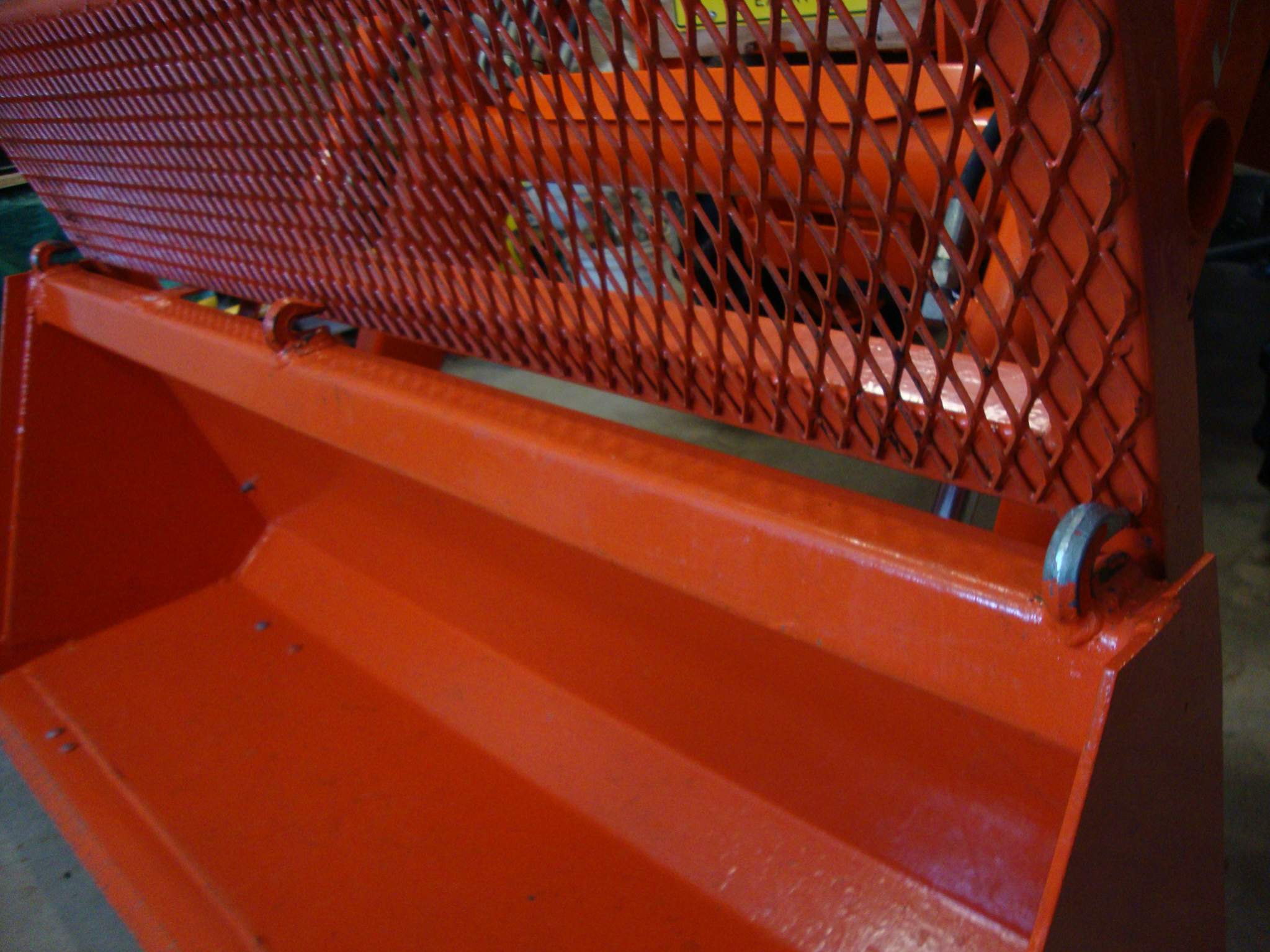

I would put the angle on the front of the bucket. Reason being, when the chain, or wire rope choker wraps over the heel of the angle less chance on bending it. If the toe of the angle iron is out front it will bend in time. I think I'd run the angle iron out all the way to the edge of the bucket.
OK, that makes sense. I started thinking about the D ring too. If I put the angle on the front, I could weld the D ring to the front vertical section of the angle in the center of the bucket so I could use that for rope or S hook straps.

Putting angle on the front, like in the second picture, won't give you much additional strength. Even if you completely face welded them together. You put it on the back side to make a tube. The idea is to put the width in line with the direction of pull, and then put something at a 90 degree angle to keep it from twisting. Think I-beam or angle iron.
Don't poo poo the bolt on hooks just because you have a welder. They are used because they don't weaken the area they are mounted to. If you are worried about them loosening, spot weld the nut.
Thats what I would do as well and was my first thought when I saw the pictures. I would overhang the angle too past your hooks a decent distance if you dont plan on going all the way to spread out the weight/ twisting forces. The angle on the front of the lip could still tear and peel up the rounded bend, at least if the angle is on the backside its helping out the front lip by spreading the stress out.
Ps- the bucket looks pretty stout, if it were me I would think you could just gusset the top lip to the bucket top in the area of the hook placement, but that my opinion.
You two have a really good point. I wonder about using two pieces of angle iron one front and back. But the back one would have to be structural angle where one leg is longer than the other. That way he could get a weld down on the back of the bucket. Or weld a piece of flatbar to the toe of the angle iron so the flatbar could be welded to the back of the bucket. Make your own C-channel with one long leg.

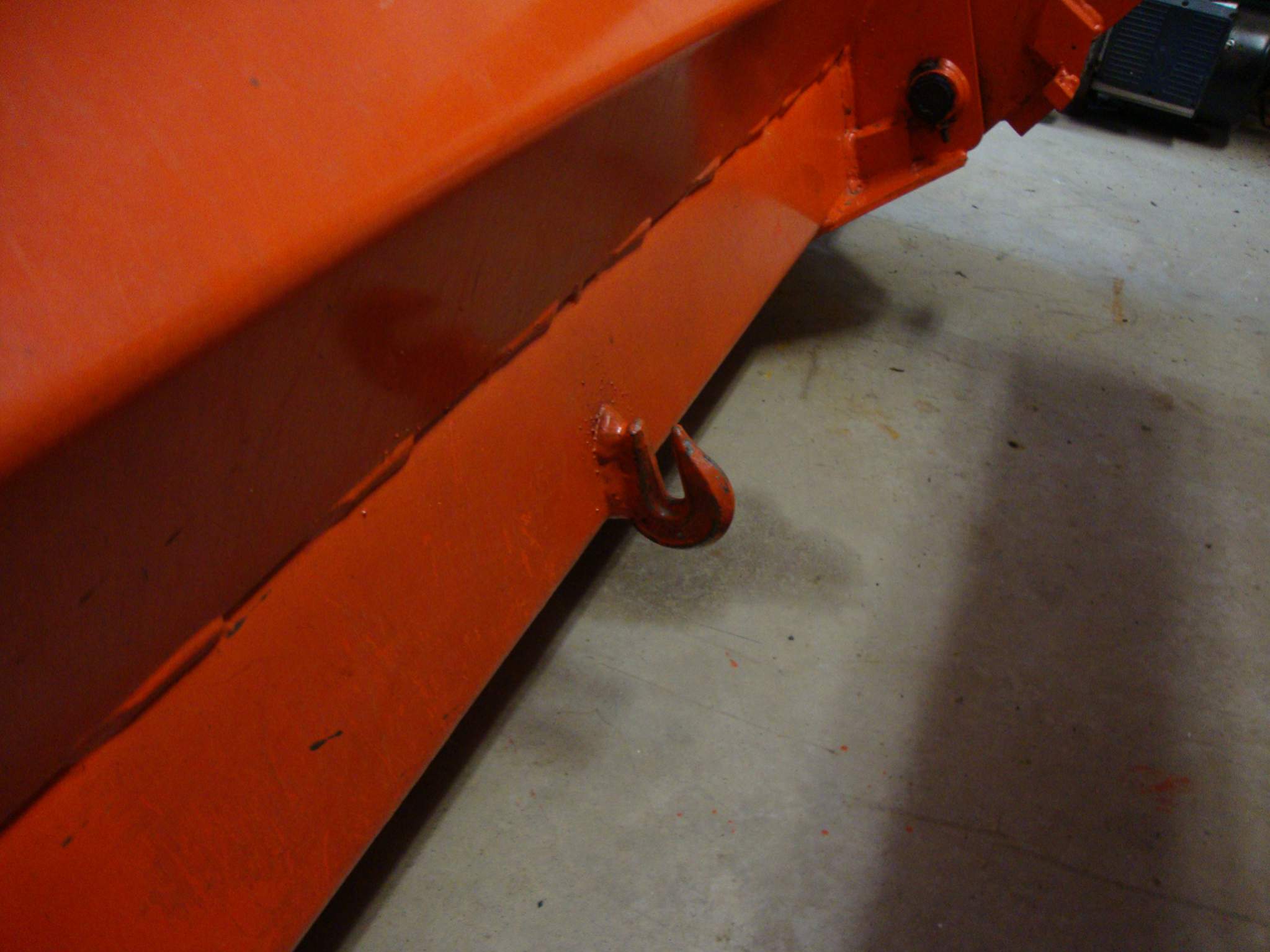

I welded some 3/8 stock on top and underside lip of my bucket, then welded on the hooks and a 2-5/16 ball.
That's exactly what I did, except I welded on a 2" receiver tube instead of a ball. With the ball on top of the bucket, I couldn't get it under the coupler of my trailer. I use a ball mount with 6" or so of drop. Also, the 2" receiver tube leaves the mounting location open for other uses, should they arise.
I considered using angle iron, but the profile of my bucket didn't leave an obvious place to put it, except across the front, and I kind of liked the curved profile of the top lip better than the sharp profile of angle iron. If my little tractor can bend a piece of 3/8" flat stock (plus 1/8" of bucket metal), I'll eat my hat.

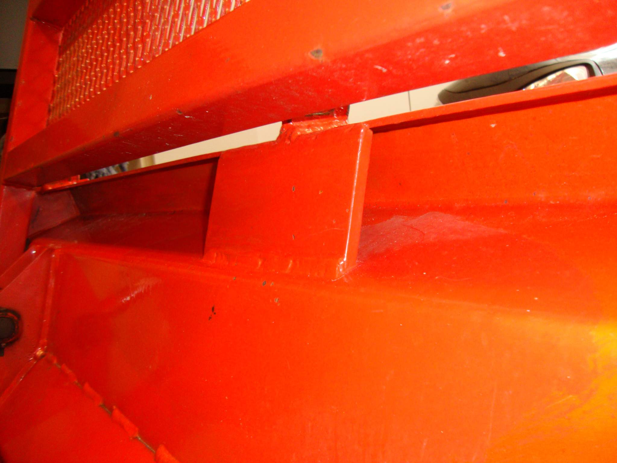

That's my problem, I always tend to overbuild everything. Based on what everyone has suggested I'm going with a 3X3 piece of angle mounted on the back of the lip like this. (this is a piece of 2X2 that I put there just to show what I'm talking about)
I just went out and measured again. The top flat portion of the 3X3 will stop about 1/4 inch or so before the radius of the bucket lip downturn starts so I'll have enough space to run some beads. The back/lower leg of the 3X3 will hit the back of the bucket about half way between the lower radius and the back edge of the top lip. A bunch of weld beads along there will hold that together and make a box. The flat top of the 3X3 will give me a good surface to weld the hooks on to.

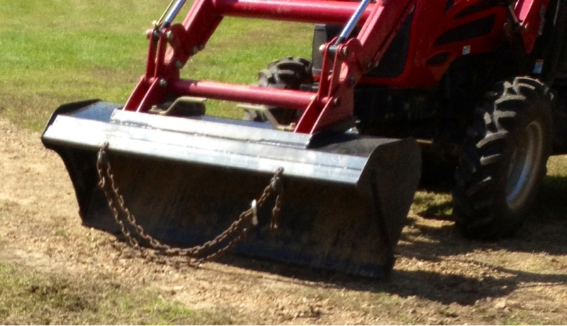

Here's a pic of the "hooks" I've used on two tractors. This is the bucket of the B7500 I had. The L3200 sports very similar angles. They work nice because all you need to do is drape the chain into the slots and they hold it at any link. If using a longer than needed chain, it's simple to drop the excess into the slots to keep ut out of the way
Great Idea. Wish I had thought about that before I welded hooks on.
