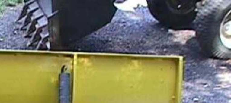

Okay, I'm about to pull the trigger on one of these tooth bars from Ebay. Seller has 100% feedback and the price is decent $264 + $75 shipping = $339 and looks like it is pretty good quality.
Ebay Toothbar
Has anyone here bought one of these? Any pros or cons to their design that anyone can think of?

I would ask what thickness the flat stock is that runs across the bucket. If it is not 1/2 or better I would pass. I made of out of 1/4 steel and destroyed it in no time popping boulders.
/ Ebay tootbar #4
I looked at the one you have pictured, ended up ordering one from Markham Welding. I was concerned about the thickness of the shank, I belive the yellow one and Markham both have 1.5 inch thickness shanks. I was told a three week waiting time after ordering from Markham.

I went to the local steel yard, purchased a 24' section of 5/8 "grader flat" bar that was beveled on one side and was 1055 steel ($130), and then went to the local equipment supplier, purchased the seven shanks necessary for my 6' bucket and the six shanks necessary for my 5' foot skid steer bucket (@ $26 each), and used my Hobart MIG 175 welder to weld it all up. The steel yard chopped my 24' bar into the lengths I needed for $5. Five foot toothbar investment:

I emailed them and they replied that they use 1/2" X 4" stock for all of their toothbars. They also make bolt on pallet forks and said they would give me a $30 shipping discount if I bought a toothbar and the pallet forks. They have really good feedback on ebay.

Purchased my shanks and teeth from FABCO and 1/2" X 3" flat locally. My bucket is 48".
6 shanks pn 16st-8-23 @ $6.90 ea=$41.40
6 teeth pn 8023 @2.09 ea= $12.54
1/2 x 3" flat $10.00
1/2 x 2" x 5" 'ears' scrap bin $1.50
add UPS for Fabco order
2 ea 1/2" X 1 1/2" 'ear bolts' $1.00
Total project incl misc in the $75-$100 range.
(I ordered spares at the same time)
Did not bother to paint as I knew the life would be about 30 mins.
Have pried stumps and rocks resistant enough to actually lift my rear end off the ground without any signs of twisting or letting go.
Used a stick welder with good penetration and 3 passes to assure strong welds.
Project time was one lazy AM.
Only regrets are that I should have beveled bucket side of the flat bar as it tends to retain a small amount of loaded material, but really not a major problem all told.
One challenge faced was installation as my cutting edge was somewhat worn and bucket had a few 'minor work curves'.
A sledge and clamps soon persuaded the bar to fit.
To this day I am unsure which gave way, the tooth bar or the bucket cutting edge.
Were I to do it over I'd probably use 3/8" flat bar for easier installation fit with the appropriate shanks.

Okay, they didn't accept my offer but told me thier lowest price and it looks like it will end up being $305 including shipping for the regular toothbar with 9" spacing.
The landscape bar looks like it will be about $50 more, how much better will it be than the standard one? I really just want it for digging in some caliche mainly. Will I regret not springing the extra $50 for the landscape one over the regular one? I don't know what the twin tiger points will really do for me either.
Thanks, Nathan
/ Ebay tootbar #16
The fewer the teeth, the easier the penetration will be
One example would be imbedded rocks.
Were a tooth to line up with a tooth, penetration will be restricted so the less teeth the more likely to fit between rocks and therefore easier to loosen/dig full loads.
Many teeth would work in a 'landscaping' situation whereby you are essentially foreward rakeing roots and that sort of debris.
For basic excavation/loading operations I think you are better off with, say, 8"-10" spacing.
My 48" bucket has 6 teeth and I find it awsome digging in a clay type hardpan.
