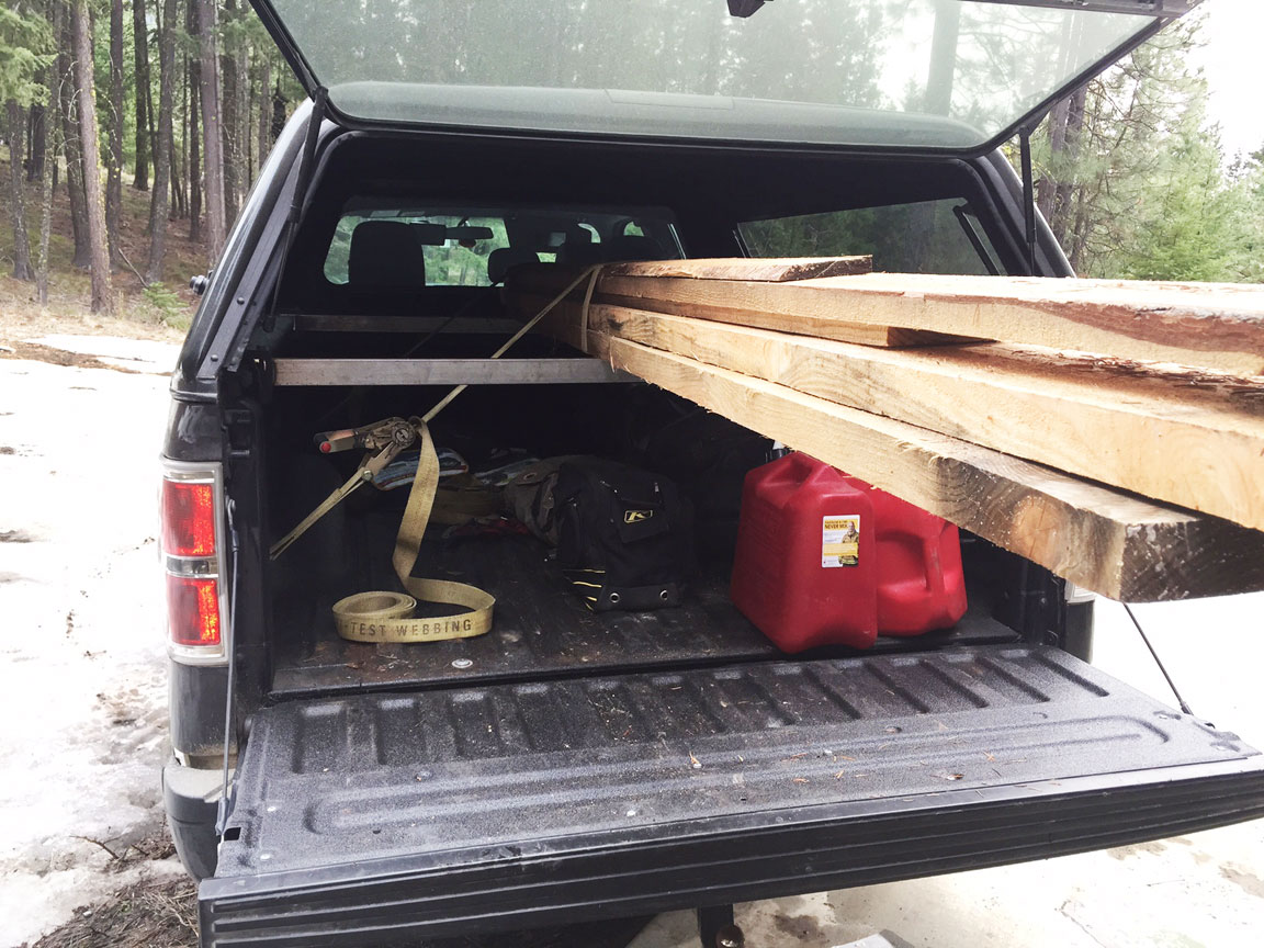

what's that white stuff on the ground in your pics? :D
Thats the 2 feet of snow we used to get in the old days (back in 2014). And those are the boards that were inaccessible (by pickup) until mid-April.

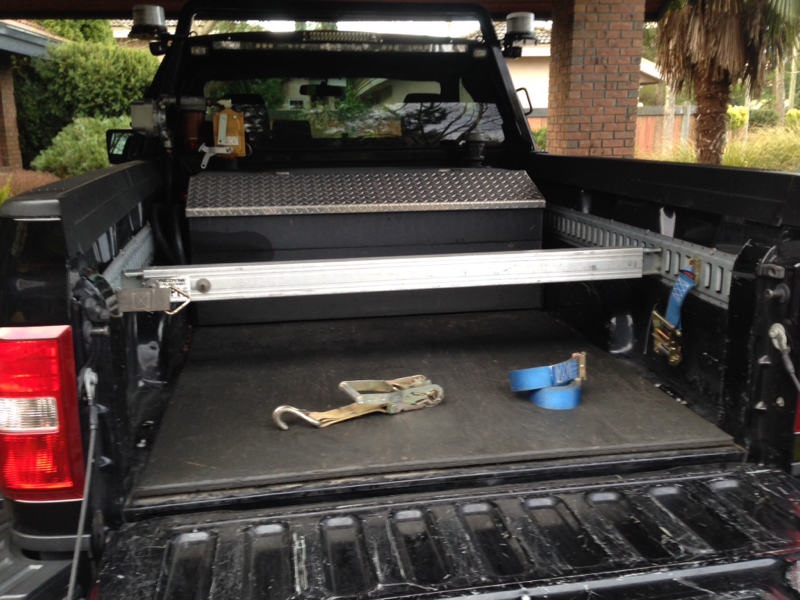

I agree that would be a good modification. Sodo, what's that white stuff on the ground in your pics? :D
Terry
/ Easy welding project - pickup bed load bars #23
Don't know what's up with these double posts. :(Stupid ipad(user). Sodo that e track would be nice floor mounted for tying down your bikes.

Nice simple addition, Sodo... I have a F150 and will likely do something similar. You got me thinking. :thumbsup:

#25
Heres the next problem that needs to be solved. I have lightweight stuff, and heavier stuff, that doesn't fit in the canopy. These are 20 footers, lightweight rect. tube 1x2 x .120 & .065. You may notice they're 'bowed' over the cab by the tension. I didn't much like driving with stuff attached this way. Any one problem, and it's gone. The straps were fine, minimal tension, and nothing to cut them, but I'm doing something better next time. I prefer situations where there are two (or 3) points of fixture and each one can do the job on its own. I made it to my destination, but should have used 2 straps at the front, at least.
416550d1426351822-easy-welding-project-pickup-bed-20foot_overtop16-jpg
There are over-the-canopy racks but these don't work on an F150 because the canopy overlaps the bed a couple inches down. So to get structure out the side, you have to cut about 2 inch notch in the canopy lower edge. Also my canopy windows swing out (up).
There are racks that bolt to the canopy top, using the canopy structure. The "A.R.E." canopy is fairly strong - I think there's a 3/4" sheet of plywood molded into the top. Not sure what can be done over the cab.
Still gathering ideas,,,, My current thought is to make an internal steel skeleton and bolt stuff to the top that bears out thru the internal structure. I'm trying to avoid permanent-mounted stuff on top because I'm a cheap bugger wrt to gas mileage. My V8 only gets 14.5mpg (not be using the special calculators that other fellas have :D ).
Plus once you start bolting stuff on the outside its a slippery slope and there's no end. Been there before and trying to avoid it with the new truck. I only have 6,000 miles, is there some odometer number where you say "aw what the heck" and open the floodgates?

It ain't the odometer, it's that first "aw crap" ding/scratch/dent :confused:
Two things - one, when I still had my 3/4 ton 4x4 (already "aw crapped" when I got it) I had dual front receivers welded to the frame members - IIRC, they came out just below the bumper guards. Handiest thing for moving trailers in tight quarters you'll ever do. With a rear vertical T bar in the rear receiver and an "H" support in two front receivers, all you'd be missing is a middle support - maybe something that'd pin onto the running boards, with a pad about window height and a top crossbar - if placed just BEHIND the main two doors, you could actually get in the cab AFTER you loaded the steel/lumber :D
Two - my local steel supplier will deliver anything over $100 FREE, I offload it with the Case and they drive away. Doesn't take much NEW steel to make $100 these days :(
Just some random brainfarts... Steve (and no, you can't order the steel already shiny :D) (mild steel, anyway)
I have roof racks on my truck which is what you need.
To transport long delicate stock (I've done 18 ft W Red Cedar strips on the highway) you put a ladder on the rack and tie it to your bumpers. I have 4 SS rings installed for this. Then you place the delicate stock on the ladder and tie it off to the ladder.
#29
Ladder on top, thats a great way to support long stuff!! Problem is By murphy's law my ladder will be a hundred miles away whenever I need it for this. Still have to get my basic Rack figured out though,,,,
I'll do a front receiver hitch too maybe can do a front support.
