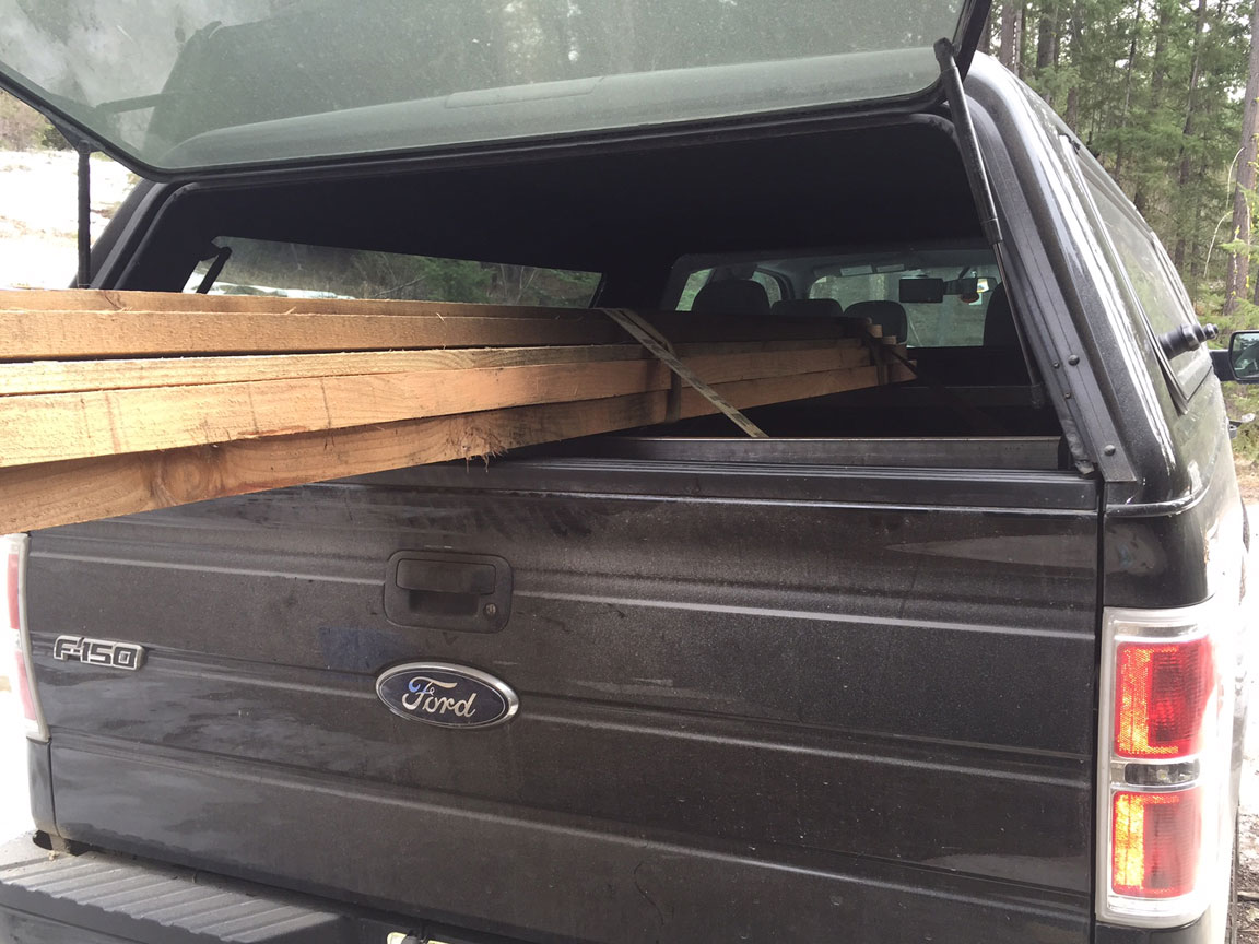

Here's an easy and useful project. A load bar that extends all the way across the pickup bed allows you to securely strap down boards that are longer than your pickup bed. It's a 1 x 2 x .065" rectangular steel tube. It's about 50 inches long, with 2 x 2 x 1/4" angle iron welded on the ends.
attachment.php
I've carried a lot more wood than is in this pic.

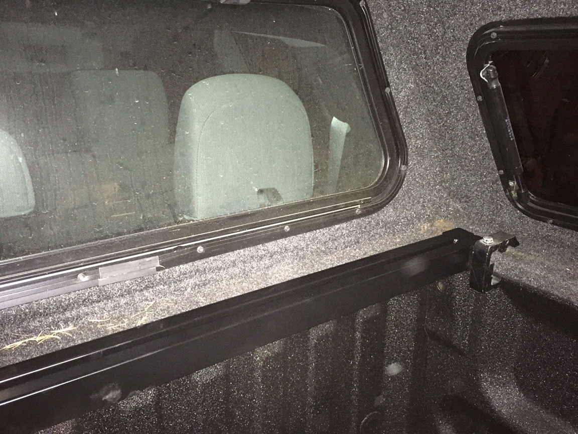

attachment.php
The bars simply rest on the canopy windowsills.

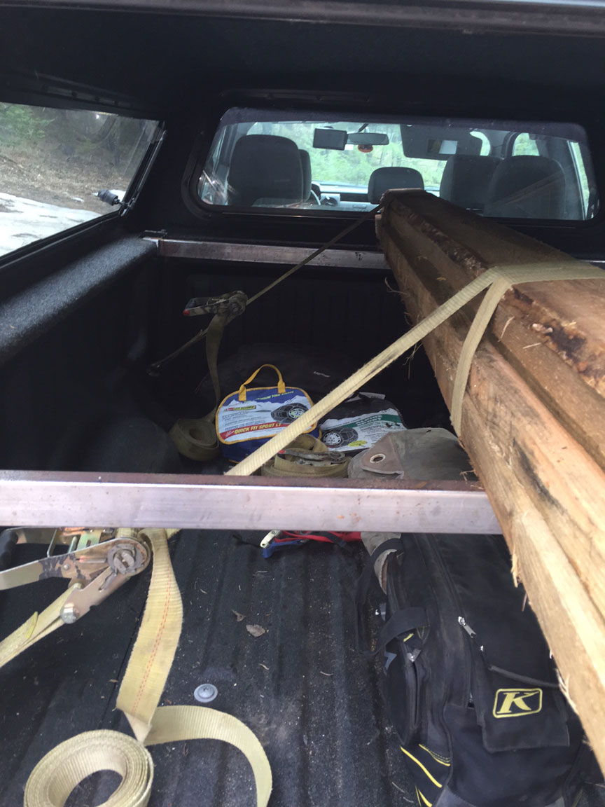

attachment.php
A really nice feature to using load bars is the tailgate can be opened and closed anytime. If you have a lot of weight resting on the tailgate it is un-usable. Plus the new tailgates are so lightweight I can't believe they can carry much weight.

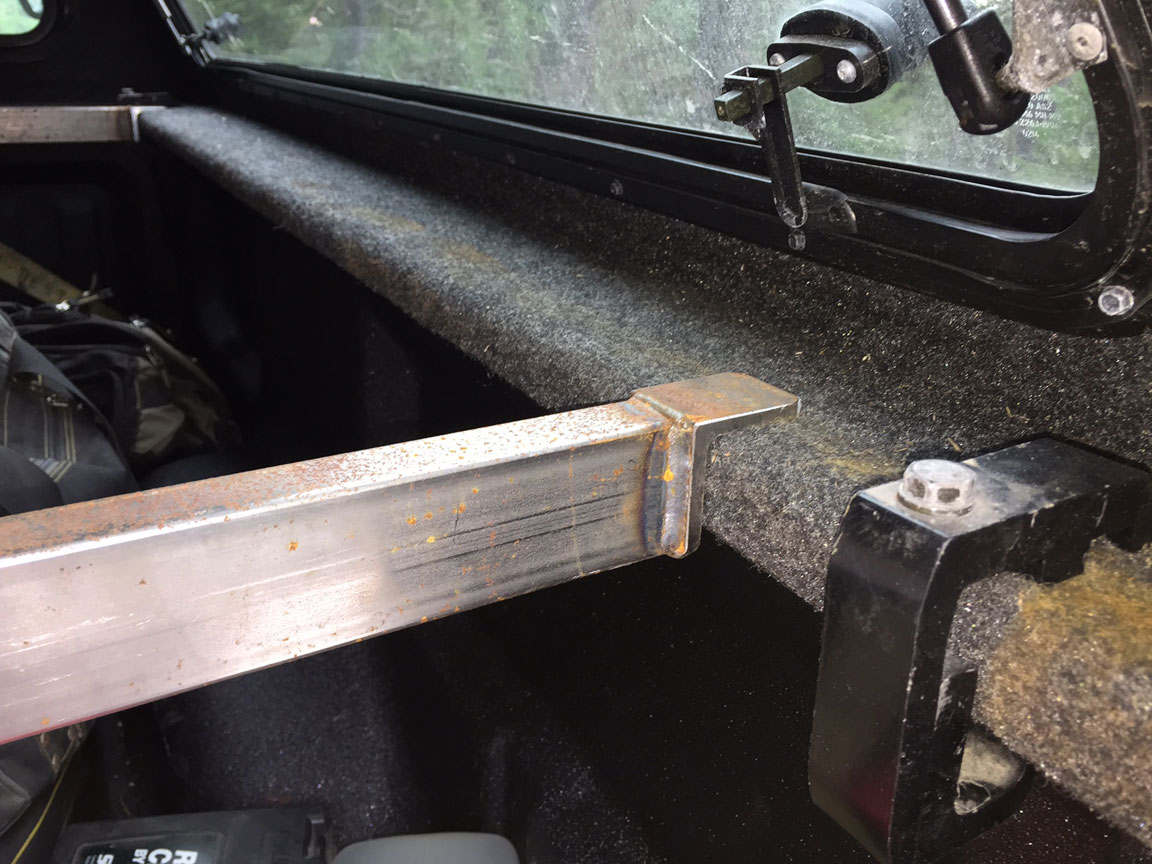

attachment.php
The bars stow away at the front of the pickup bed, captured by the canopy clamps. They have been painted in this pic.

Yes, very cool. However...I realize you have a canopy installed, but kinda scary without a cab protector. A sudden impact could prove disastrous with those boards coming through the rear window.

nice project. I like the way you secured your canopy to the truck bed without drilling any holes, nice.

Thanks Terry, I don't do it often enough to worry about, but that's a good thing to take into account when placing the boards!

Calman those clamps is how it came "installed" when I bought the canopy from the ARE dealer.

There are a few times when carrying pieces longer than my pickup's bed that I could have used something like this but I think if I ever made such a setup it would be just one bar at the back to keep the load off the tailgate. That would let whatever I was transporting rest against the bottom of the headboard with no worry about it coming through the back window in case anything big rear ended me.
/ Easy welding project - pickup bed load bars
#16

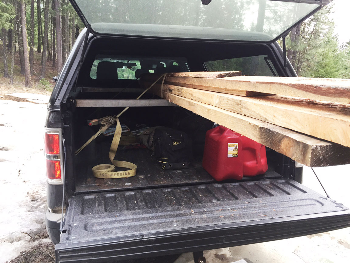

For those times you have "stuff" in the bed that you don't want to move, you can make that judgement call. Or making just one takes half as much steel and saves about 10% of the build time. :D
Here's pics with tailgate Down & Up.
416103d1426086914-easy-welding-project-pickup-bed-canopyloadbars5-jpg
415609d1425788005-easy-welding-project-pickup-bed-canopyloadbars3-jpg
I second that idea or maybe lowering the bar that is closest the window so that load would be close to the floor of the bed but not all the way down. But all and all a cool idea and you did a fine job with the welds and fab work.

Fluid that's a great enhancement and an easy modification too. The bar is about 61 inches long sill-to-sill, there's plenty of room to dog-leg down. I'd go about 6 inches down I think. It would still carry a good stack of 4x8 sheets. Thanks!
