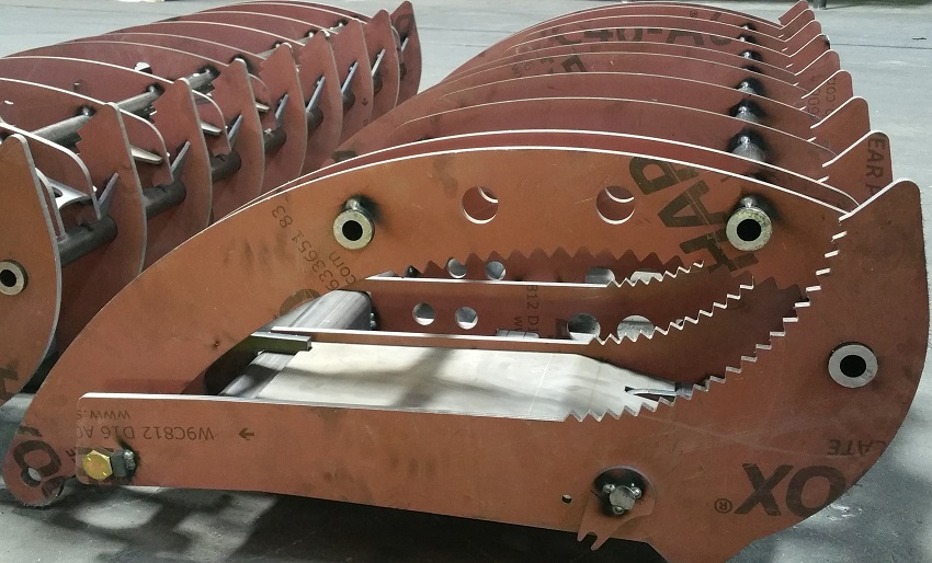

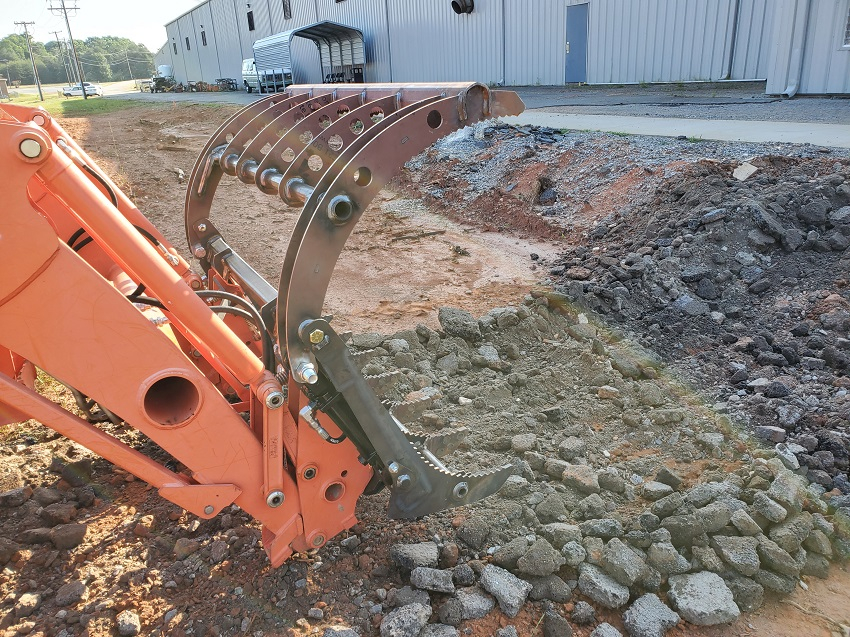

I'm going to throw this out there because I am really curious. What is the differences that would make one better than the other? For example how does the the EA Wicked 60 measure up against the HI Root Grapple Pinnacle series?
EA Wicked 60
Homestead Root Grapple Pinnacle Series
The differences I see are:
Weight - HI is lighter
Price - Homestead is cheaper by about $1000
Durability - Not sure here. Hardox teeth on both. Cylinders looks the same from a spec perspective. Maybe the tubing/piping is the difference?
Utility - Openings are about the same.
Build/lead time - 16 weeks for EA and 7-8 for Homestead (this is kind of a big deal)
Shipping - HI ships to home for free (also kind of a big deal)
Is EA, at $1000 more plus double the lead/build time, plus no free home delivery a better purchase in any way?
Not for compacts, but HI's Utility version uses 1/2" Hardox (though not doubled/laminated at digging point, which, I believe, combines for 3/4" for EA, but only at engagement points). HI also has gusseted teeth (which might make up for the non-lam), four hinge points, and larger cylinders (3" x 10"). HI also has mechanical stops to protect cylinders from being over-extended or compacted.

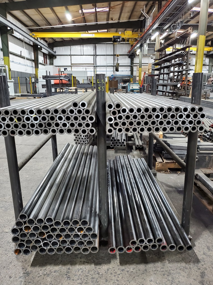

Again, I'm describing their Utility unit. Even so, I'm trying to decide if EA's 1-7/8" thick-walled DOM tubing (on their Wicked 66) is superior to HI's 2" Schedule 80 piping. The Sch 80 is harder, but EA's DOM has 3x the wall thickness. Does this difference overcome the other differences? -- i.e., contemplating forces applied to framing rigidity vs. the strength of the teeth. EA's 3/4" (2 x 3/8") Hardox teeth bearing on that thick-walled tubing seems awfully tough. But HI's 1/2" Hardox throughout ain't no joke (although not doubled at dig points), and neither is Sch. 80.
I hope the info above is accurate -- it's what I gleaned from their respective web sites. I would welcome any corrections or feedback, including from EA and HI reps.
