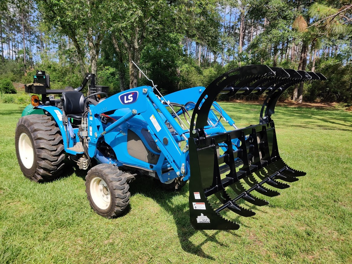

I have the HI 60 grapple, I went with it over the EA for 3 reasons.
  • It is 60" vs 55" so I can see more of it outside my front tires.
  • The AR450 steel is slightly thicker.
  • Lead time.
I got mine about a year and a half ago, and there were some issues, HI actually had it picked it up, shipped it back, fixed them, and sent it back to me again. Good customer service, though on things that should have not been an issue.
I've had no issues with it whatsoever once I received it back the 2nd time, it is very strong and works well.
