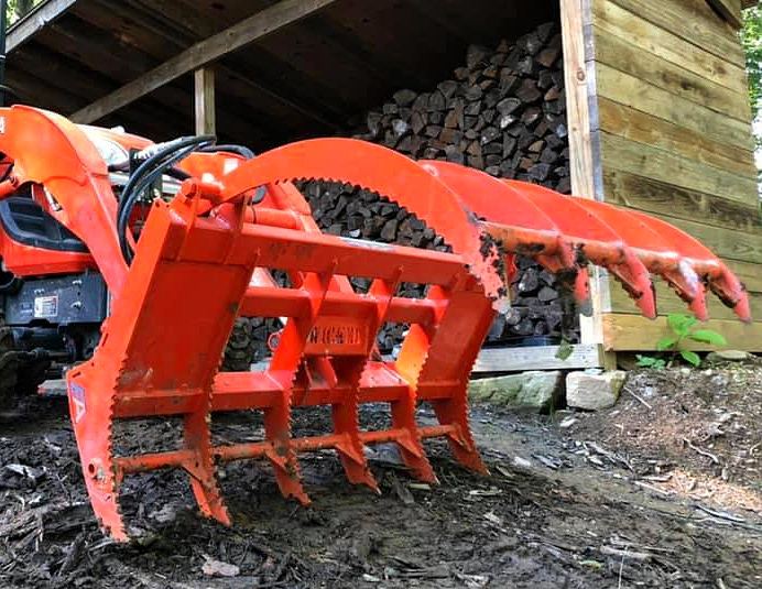

In all the threads on grapples I've not seen anyone mention having direct experience with both EA and Homestead, so I think the best anyone can offer is "I have XXX and I've been happy with it".
Personally I have a 55" HI Pinnacle. Chose it over the EA due to price and lead times - figured "it might not be the 'best', but should be pretty damn good". So far I've had no cause to doubt my decision - been happy with it moving logs, brush, and rocks. I like that the 55" has the same construction as the 60", just closer tine spacing.
That said, Torvy's perspective is an interesting one. I'd rather send my money to NC over NY as well, if that were the only difference.
Edited to add: The Homestead also stands upright on its own. That may or may not be a factor for you

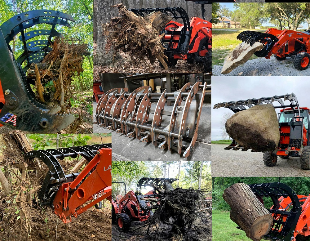

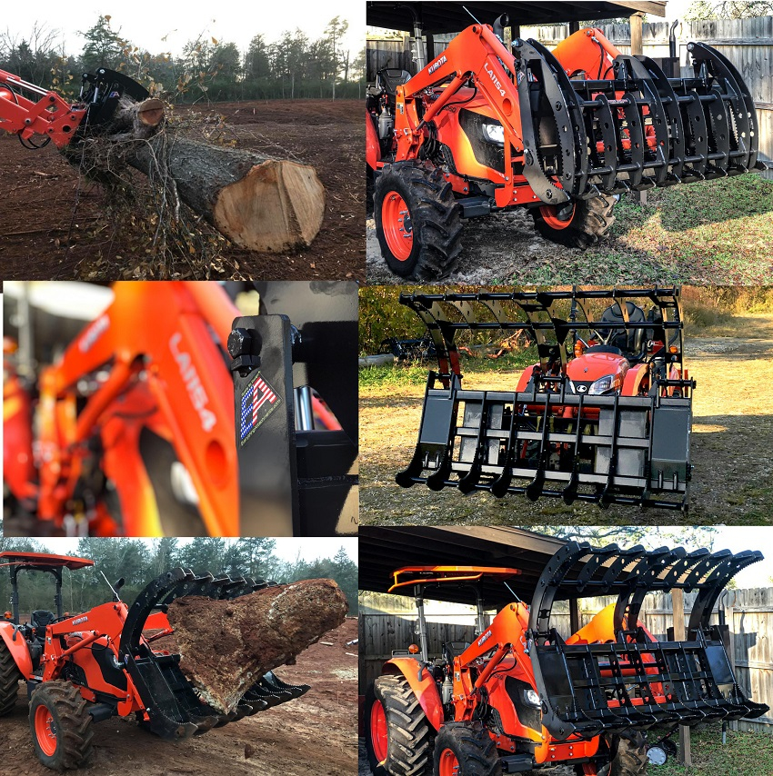

Here's a quick overview of our lineup, so the intended machines are clear. We are all about IDEALLY matching a Wicked grapple to your tractor, and do not like settling for anything less.
EA Wicked 48 for Kubota BX Link 150 pound range, 3 pin configuration for Kubota BX tractors.
EA Wicked 55 Link 250 pound range, for use on the smallest of tractors with JD or universal quick attach, up to around 40ish horsepower. Select Kubota B Series pin on mounts available.
EA Wicked 60 Link 400 pound range, for 40ish horsepower tractors up to the largest of compact tractors, such as Kubota MX, JD 4 Series, Kioti NX with JD or universal quick attach.
EA Wicked 66 Link 660 pound range, for utility tractors and skid steer loaders. This one LIVES on our Kubota M6-141(141hp tractor) and has been very roughly tested on it, as well as fitting it to many customer's tracked skid steers.

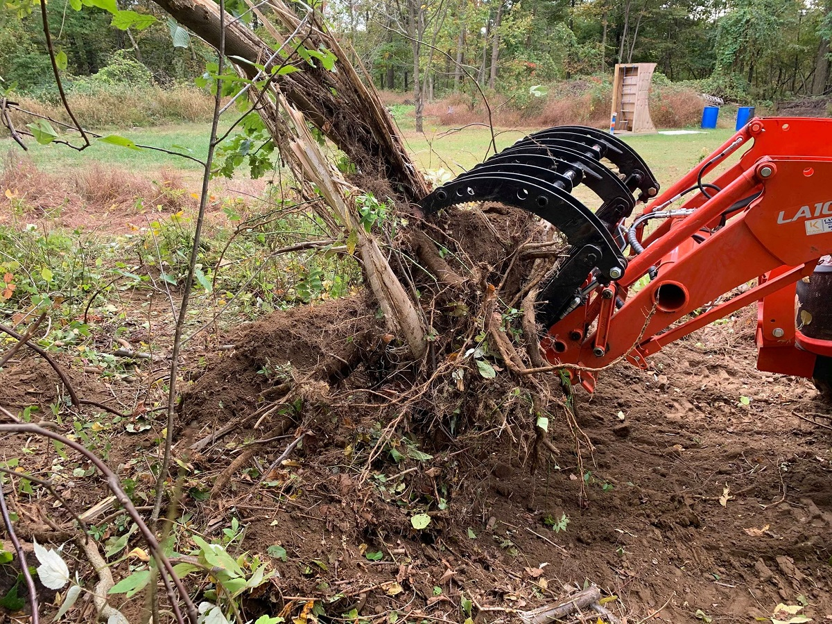

Since it was mentioned, you'll see that our root rake style grapples do not stand up when disconnected. This is because we use grapples, rather than develop gimmicky selling points to attract those who know no better. A big dogleg tine on the bottom will prohibit aggressive grubbing/digging, which may be a plus for grapples which can't handle it. Wicked actually likes it, and to store, just put it face down, like you're gonna chomp at the Earth(be careful, because it will).
Here's an example of not being held back by dogleg lower tines. Ground penetration is achieved at the preferred angle, and grubbing ability is maximized.
Using the lid to rake backwards is frowned against with pretty much every manufacturer I can think of, and warranty will be quickly DENIED if something were to happen. With EA Wicked, not so much..
I hope my posts help to clear some things up. I've studied these things for many years, and was here when the first Legendary Wicked Grapple was introduced, and the industry is still shaking from its presence. I'm here to chat grapples anytime, and do enjoy it, so feel free to give me a call if you want to match up an ideal grapple for your tractor and application(s). 828-464-1200

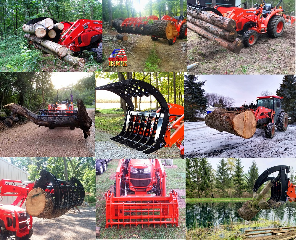

Example 1
Example 2 Crazy? yes. Proven? Most definitely.
