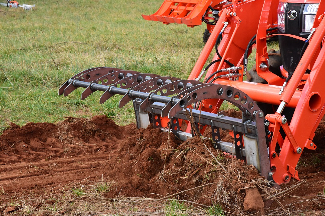

It's all about the angle of approach. Longer tines, or more forward aimed short tines, are rougher on the loader and loader cylinders because in order to dig/pry/grub at the best angle, it requires you to dump it down, which extends your loader cylinders. Extended loader cylinders are most vulnerable to damage.
Notice how our Wicked grapple rake tines are angled. Not much dumping at all is required to achieve an optimal pushing, asphalt ripping angle of attack!
Despite many changes/enhancements over the years, we kept the same lower tine angle. #DemandTheBest

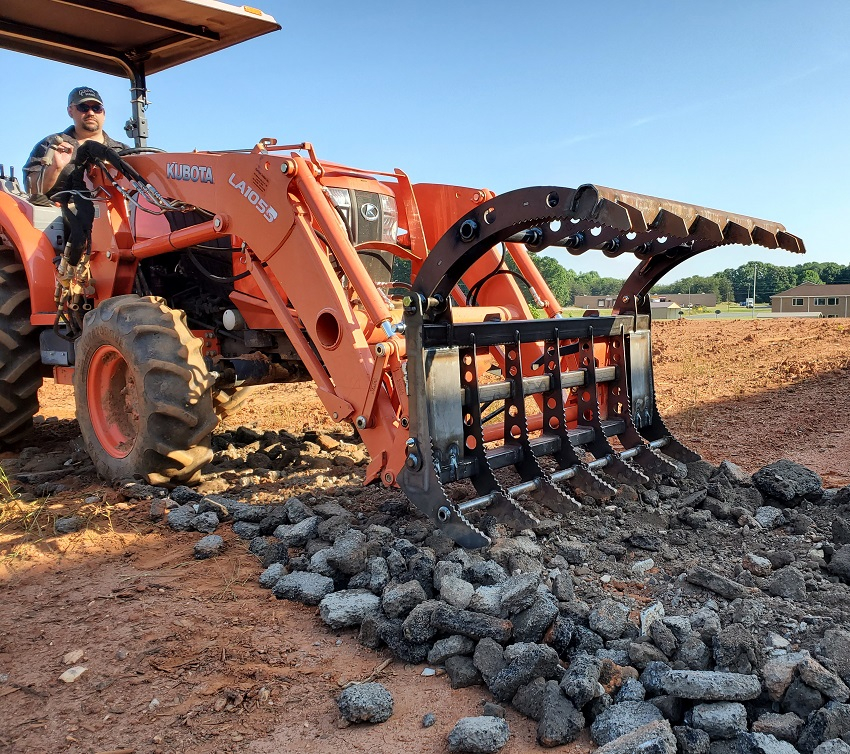

Well, if that first picture isn't staged I don't know what is. Somebody dumped a pile of asphalt in an open field and snapped a shot thinking no one would notice.

Nah, not staged, dude! I'll look for the video footage. lol

I dunno. Those are awfully neat rows of asphalt. Grapples can do that? I don't see the angles on the grapple to do that. Just sayin. The picture just strikes me as odd at first sight. Something just isn't right.

Not staged, but it was a pile of already broken asphalt, and he was dozing through and raking with all of the tractor's weight on the lid.
Just a quick test of the brand new(at the time) Wickeder lid.
Here's another still. I have the vid on my computer, but I can't find it in the facebook group!!! #StillLookin
