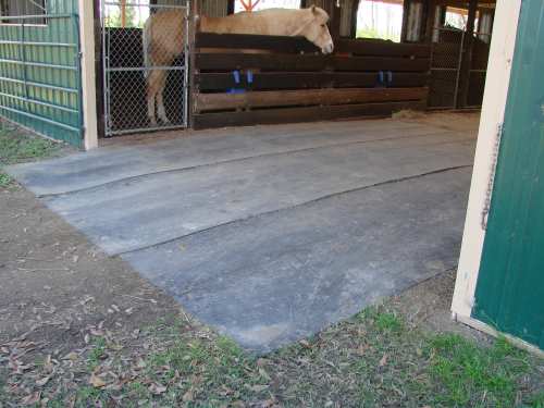

Are there any grain elevators nere you? I get old conveyor belts from the grain elevators and they work perfect for floors in barns and sheds.
