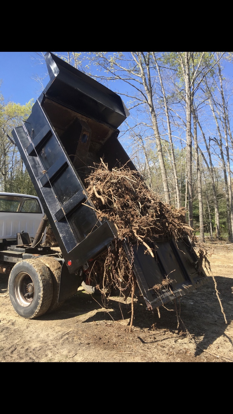

Anyone else have problems with the rear D rings on a dump trailer.
My last two loads with the dump bed all the way up refused to dump because the load was hung up on the two rear D rings.
I couldn't move the obstruction as it was too wedged in and even if I did I would be under an avanlach of debris if I did break it loose.
I had to lower the load clear the jammed piece being stopped by the D- rings and re dump the load.
The line of other people behind me were not happy.
Any solutions besides cutting them out? I do like them there when I move equipment in the dump trailer.
Putting in recessed D-rings would be a pain but if that's all there is?
I'm thinking of fabricating some sort of a metal ramp so when the loads hits the D-ring it might defelct over the ring?
Any ideas would help.

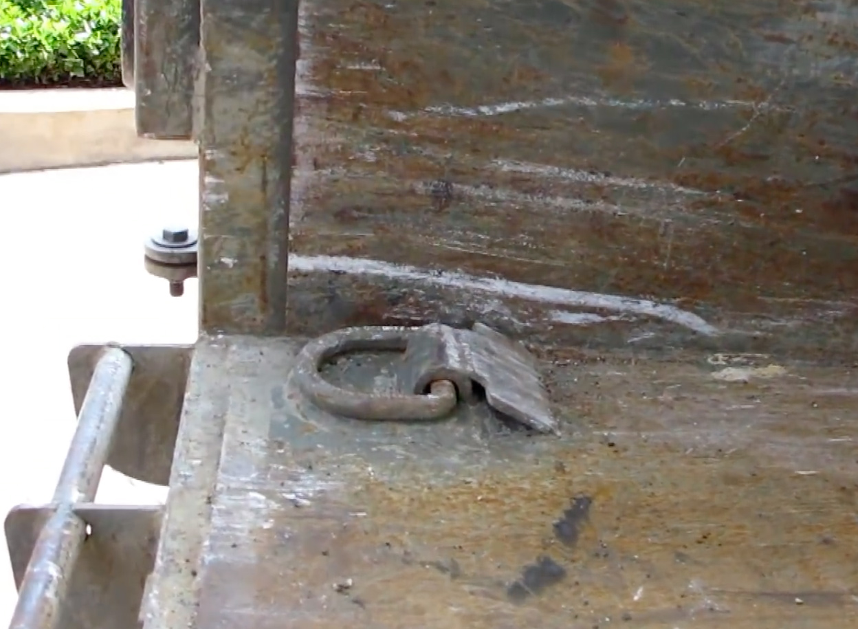

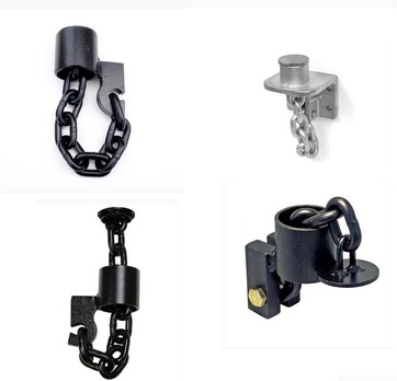

Replace them with this style.

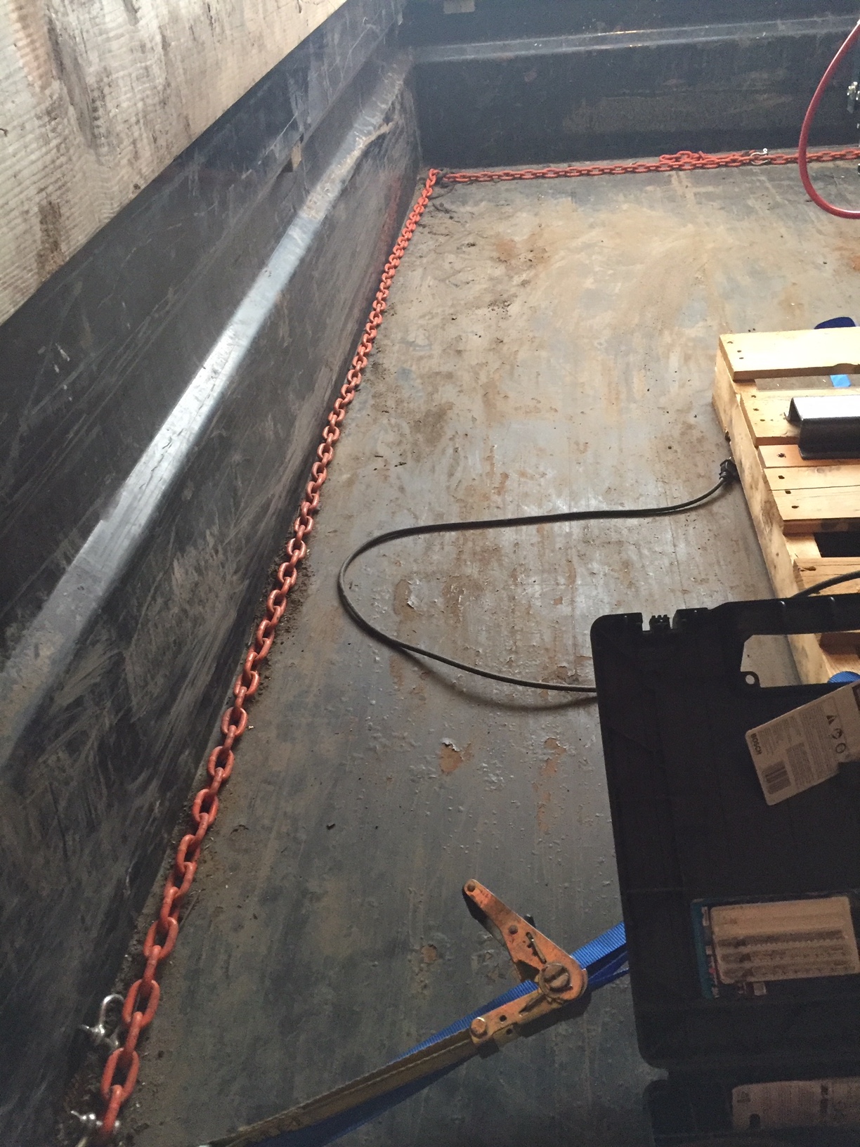

I used to have that problem. But not since I ran chain around three sides of the dump trailer. I put the chain in place so I could easily tie stuff down anywhere. But as a side benefit the chain guides the crud up and over the D ring.

I'm going to see If I can get a machine shop to duplicate what the you tube guy did, might make mine a longer smoother angle just in case.

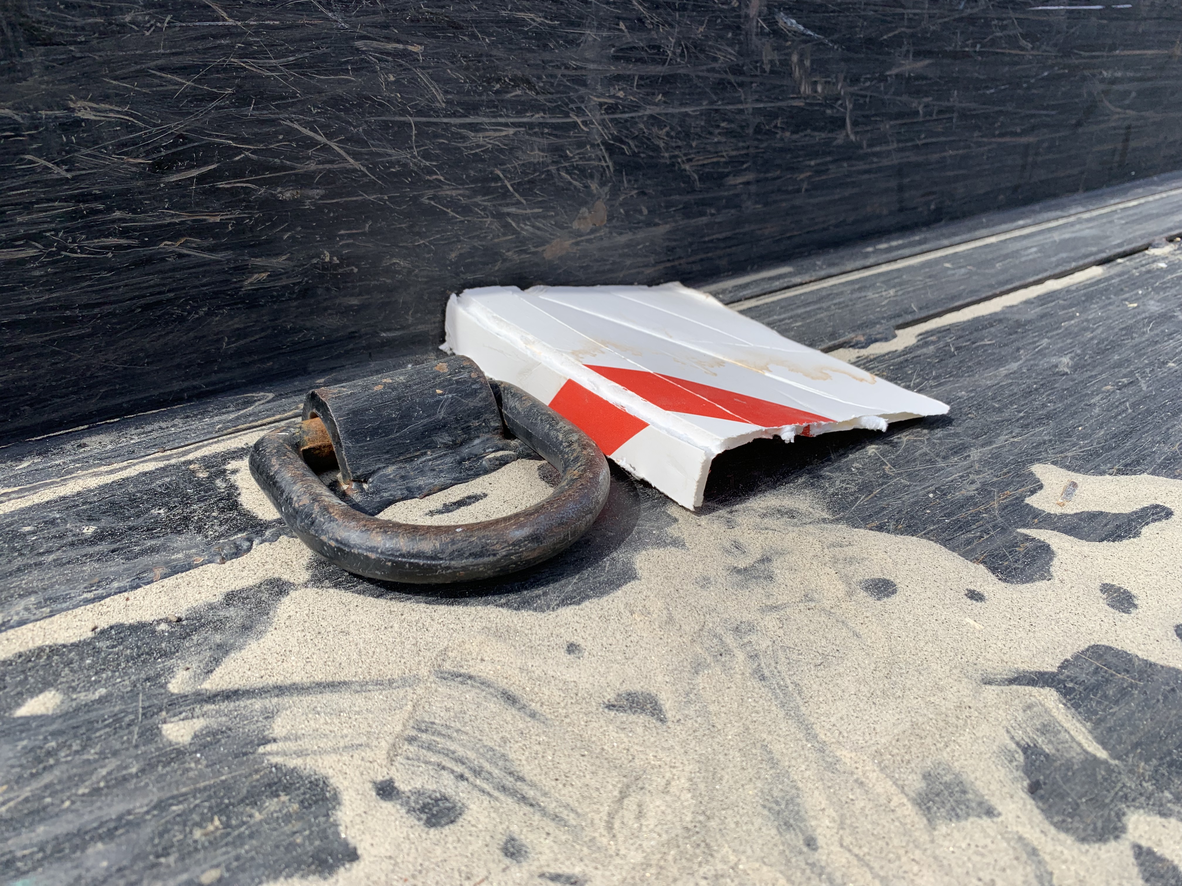

OK here's my mock up. Am I on the right track or do you see any problems. Going for a "ramp" so the debris fly's OVER the D-rings. My D-rings are East to West not North to South or side to side not front to back
5.5" x 6" x 1"
/ Dump trailer D-rings #20
Depend's on how thick the ramp material is AND greatest force ever expected to be put on D-ring. In pic,ring is pushed toward rear and ramp is against front of ring. Tiedowns will pull ring foward against ramp and enough pressure will damage ramp. No big deal but you strick me as not wanting another problem.
