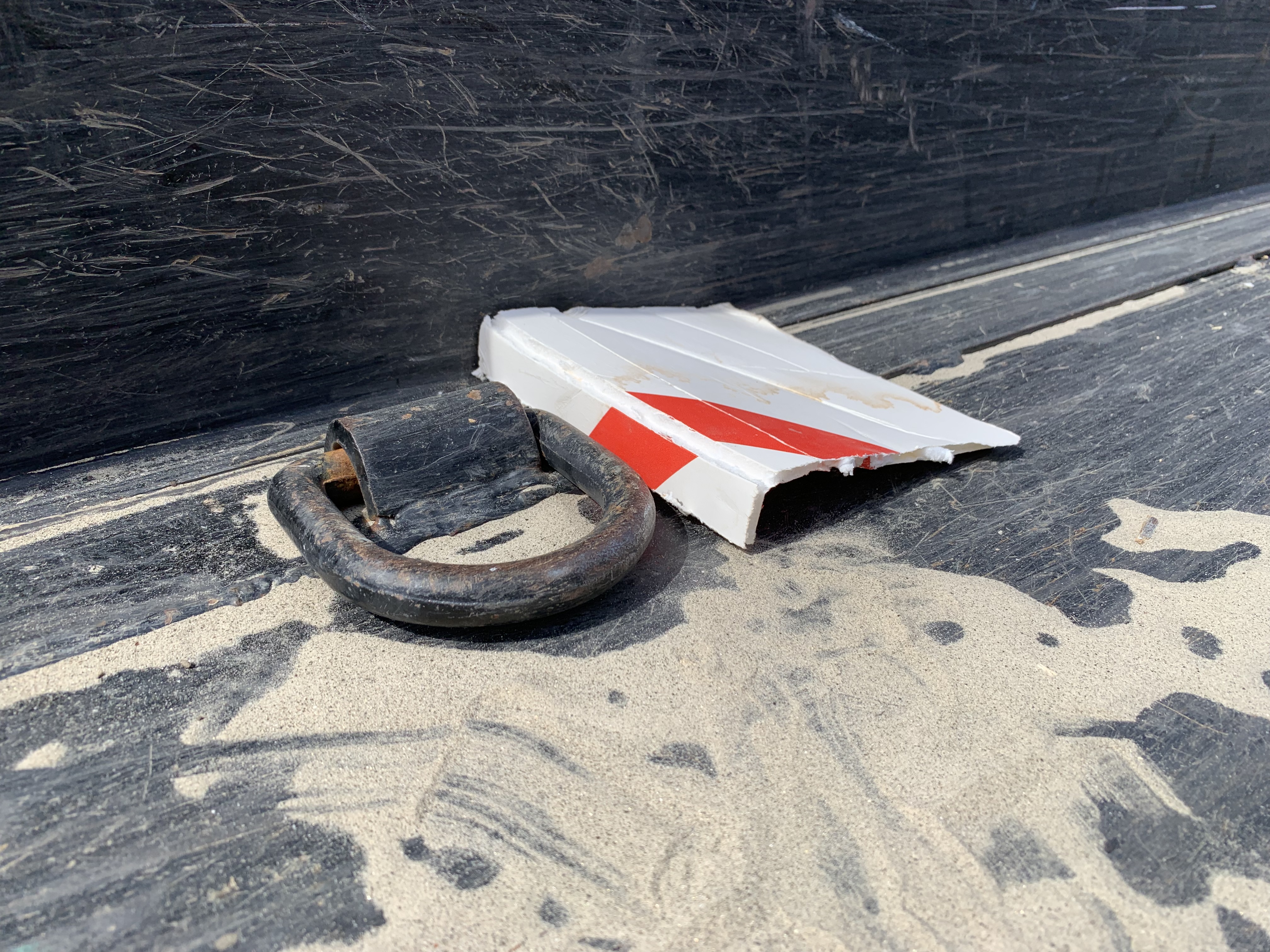

Depend's on how thick the ramp material is AND greatest force ever expected to be put on D-ring. In pic,ring is pushed toward rear and ramp is against front of ring. Tiedowns will pull ring foward against ramp and enough pressure will damage ramp. No big deal but you strick me as not wanting another problem.
It doesn’t seem like any manufacturer knows how to put on a D ring. They’re rated for an enormous load straight pull but only a small fraction of that sideways. They should be 45 degrease to make a tie down pull as straight as possible.

OK here's my mock up. Am I on the right track or do you see any problems. Going for a "ramp" so the debris fly's OVER the D-rings.
Looks like the simplest solution to try before you really start re inventing the tie down.
If your mainly hauling const. junk, I was thinking about a smooth floor (but with a 1 1/4" hole) and tying down with chains without a hook on one end by cutting off the d rings and recessing in some "banjo eye's" in place. Looks like you have a structural member there to at least have one side of the eye to weld to .

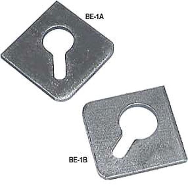

I was also thinking maybe cutting off the D rings making the floor smooth then cutting a 3" hole on the side of the dump
big enough to put a chain hook through. Then istall the D-rings on the outside of the dump trailer. Maybe a door to bolt shut when the D ring is not used.
Another option, but they still have lips but I could grind them down smooth. Only problem these have low ratings 1,600 pounds compared to 6-15K on the other.
