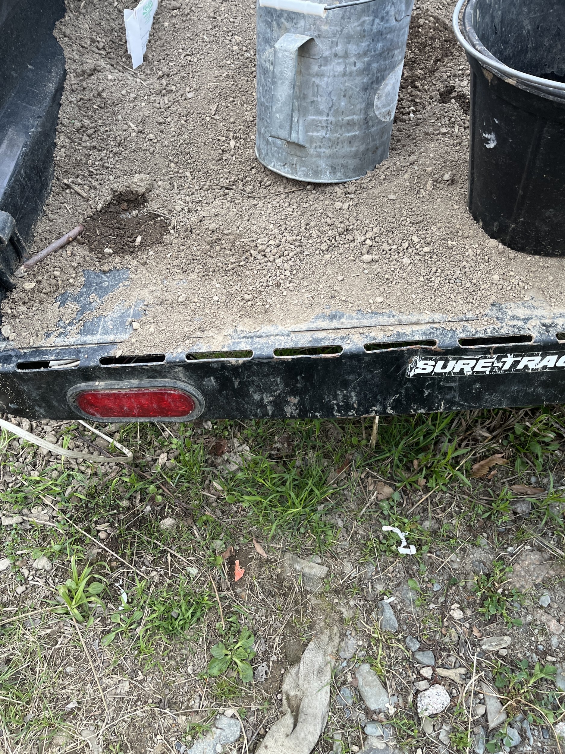

Well I bought it, after 2 out of the 3 didn't work, they left the beds up which I wasn't happy about, a bit of corrosion to deal with, has a kti pump which i guess is one of the better brands.
I will take a photo if anyone cares, pulled ok, still wish it had hydro brakes or something. Wiring is also pretty crappy and needs to be redone

after cleaning this thing up, the wiring on this is so bad, IDK wtf they were smoking at least 15 places its rubbing, a foot of extra wire and some tubing would have been so easy.
I'm becoming less impressed with this thing by the minute.
