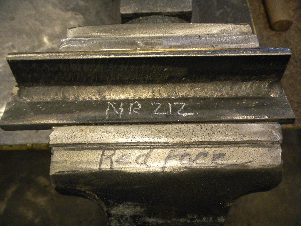

Try some Lincoln NR-212, or Hobart 21-B. Before the Northridge earthquake in California we ran a lot of the Hobart 21-B. It also runs really good on galvanized steel. I've taken numerous 1-inch thick V-butt tests, 3-G, and 4-G with 21-B. Never failed one.

Oh I forgot to mention. Both those welds were made with a CC only 50-year old engine drive welder, and LN-25 wire feeder. Innershield will run better on a CV welder.

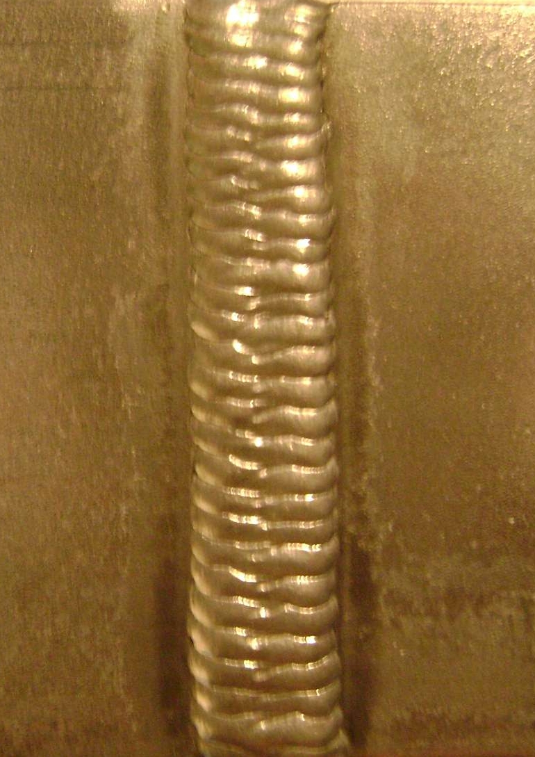

I've run the 71m, like it but started getting a lot of worm tracks, never did figure out the problem. Good clean material prep. Structurally good but didn't like it for cosmetics.
This was .045 on a MM 251.
Will say one thing, you better have a good gun or else it'll meltdown pretty quick!
/ Dual Shield.
#39
Here is what Lincoln has to say about worm tracks.
