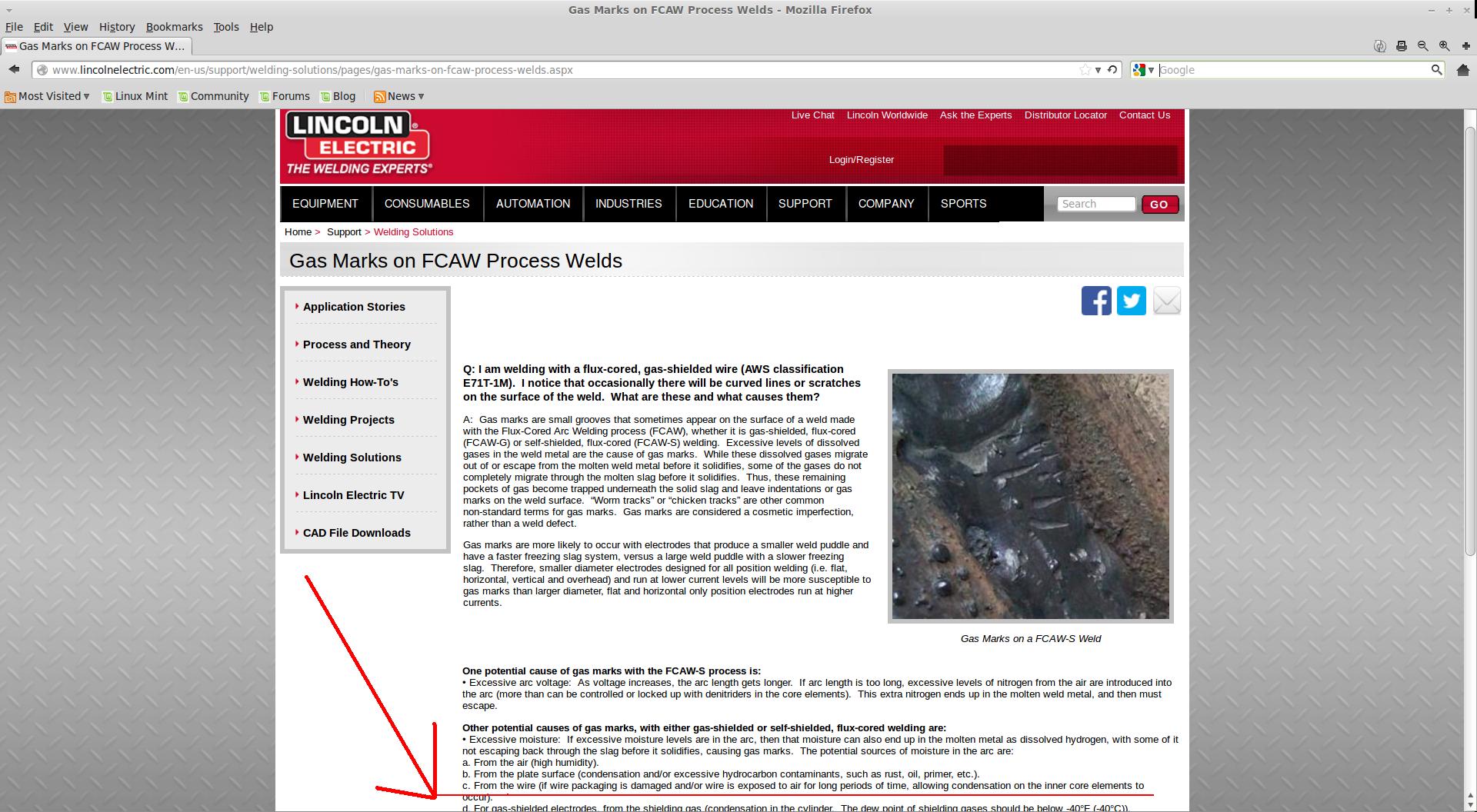

Keep the roll of wire in a sealed plastic bag, and in a warm area!
/ Dual Shield. #42
I thought about moisture in the flux but it was a new spool with intact packaging and a recent mfg date at the time, the guy that turned me onto dual shielded wire ran some in my machine without a problem. I'm wondering if my power source is varying a bit since it's on a sub panel.

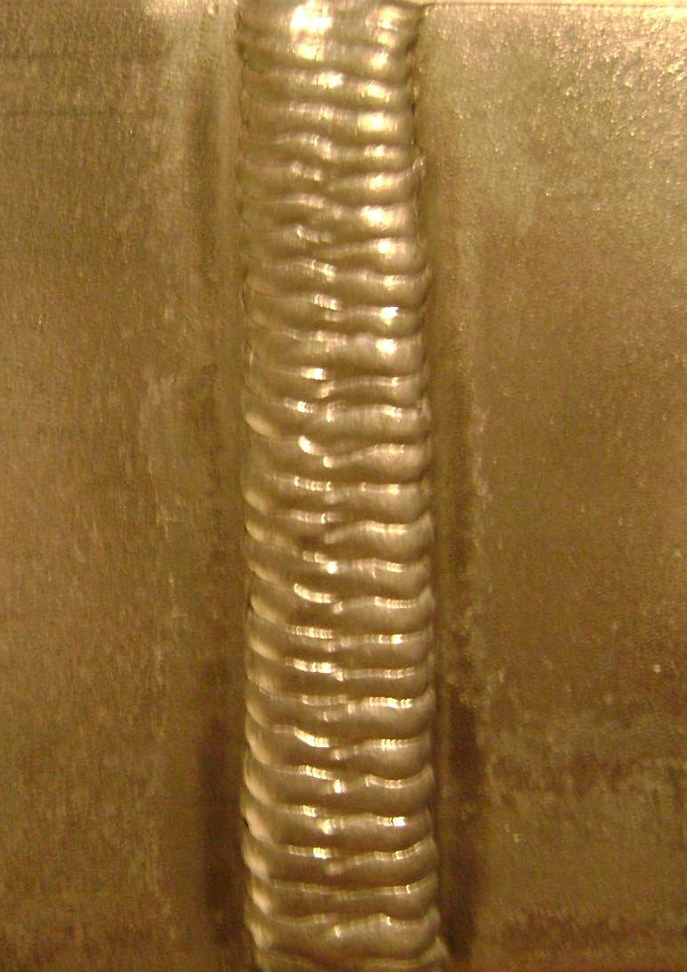

I've run the 71m, like it but started getting a lot of worm tracks, never did figure out the problem. Good clean material prep. Structurally good but didn't like it for cosmetics.
This was .045 on a MM 251.
Will say one thing, you better have a good gun or else it'll meltdown pretty quick!

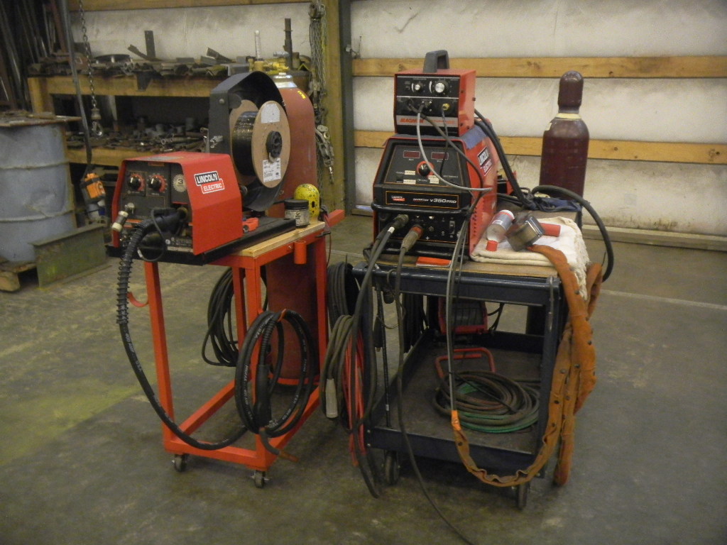

Dual shield is my new go to process. It welds awesome and in any position. Penetration is way better than short circuit mig. I welded on some 1" plate today with 0.45 Frontiarc 711. It burned in really well and I did some flat, overhead and vertical up welds. It is a hot process. My gun was so hot I could barely hold it and it is an aftermarket 250 amp HTP gun.
It welds like 7018 on a spool to me and the flux is super easy to get off. I know you are supposed to use knurled drive rolls for it but I didn't have any and tried the solid wire ones and was going to order the knurled but it has working just fine.
I have a stick welder, a MM252 loaded with .045 solid wire and my LN-25 setup with the dual shield. I haven't even used the other welders in some time because I like the dual shield so much.
/ Dual Shield. #55
The 252 should run dual shield. What are you running the LN-25 off of, CC or CV? If CC the 252 would burn it even nicer on CV.
/ Dual Shield. #56
CV - it is hooked up to an invertec V-350. I am pretty sure the 252 would run the dual shield but probably not at the higher amps and duty cycle of the V-350/LN-25. I have kicked around the idea of selling the 252 but I keep it around to have it loaded with hard wire for when I need that so I don't have to switch things which hasn't been much.
