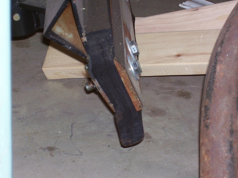

/ driveway protection from blade? #10
Here is what I use. It came off a county highways plow.
