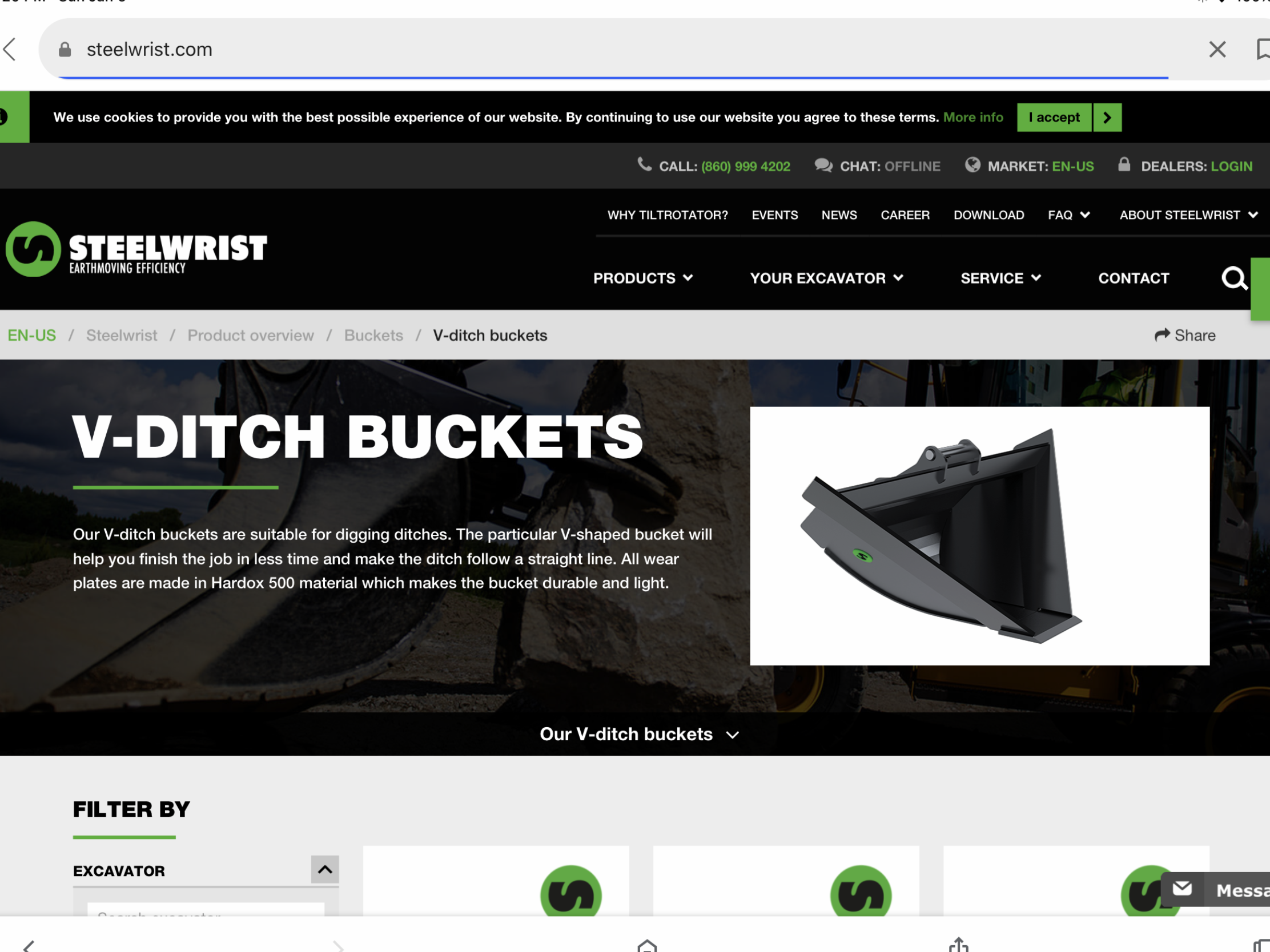

This is what I would use next to a bank down to road to get a ditch in.
