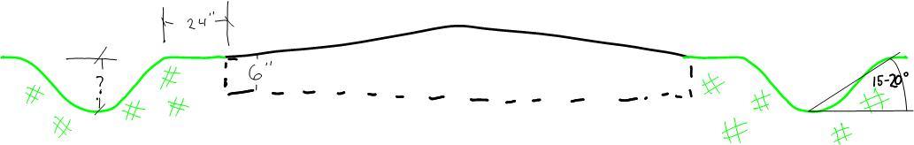

So, the key word I always hear is "drainage". Keeping the roadway as dry as possible with proper run off. I believe this comment because all of the areas of my drive that have more water retained are the areas of issue for me. I have a gradual hill that directs water toward the drive in some areas. I'm looking at building in a ditch on both and/or one side of the drive to direct water off and away. I've attached a sketch to illustrate a cross section. What is the optimal distance vertically between bottom of ditch to road surface and angle of deg. of ditch? What is the proper fall within the ditch for proper run off (i.e. 1" per 8'?). Does it vary by soil type or is there a general rule?

We grade roads at 1/4" per foot (2%) and the shoulder area we try to get at 3/4" per foot (6%)
This way the road drains well and then once the water hits the shoulder it runs faster. This helps prevent soft edges of the road.
As for the ditch we never cut any shallower than 2' and use 3' of side slope for every 1' of depth.

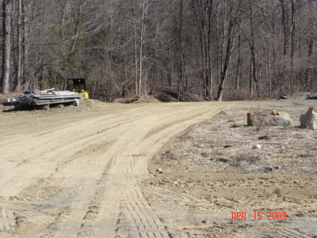

I just finished grading for proper runoff. Immediate runoff will be sheet flow across a (future) grassed area, and then to the ditching adjacent to my main farm road (an abandoned town road). The moisture of the clay is perfect - just enough to pack nicely without that powdery texture. Tomorrow morning I'm getting 2+ stone. I have decided to not put fabric down, for as long as the water doesn't sit on it, the stone will hold up nicely. Some areas of the farm roads have had stone w/o fabric doing its job for over 20 years. Not to mention that I'm getting about 660 tons of stone for stockpiling, so I'll have extra to add as needed. The material price was good. I also have miles of farm and woods roads to maintain, so having a stockpile is key to keep farm operations seamless.
I'll take some pics in the morning of the program.

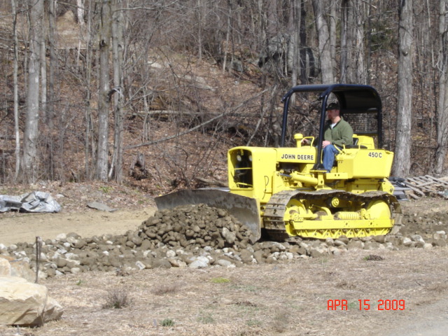

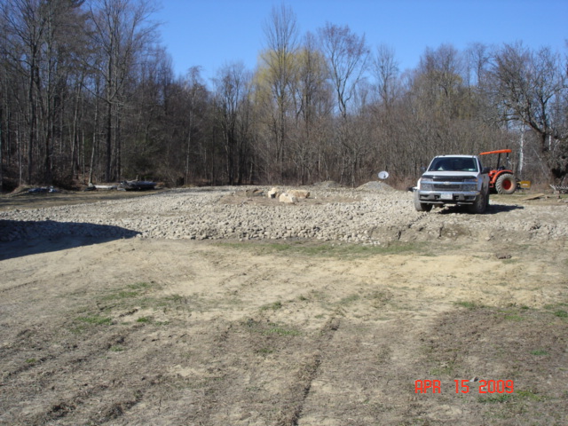

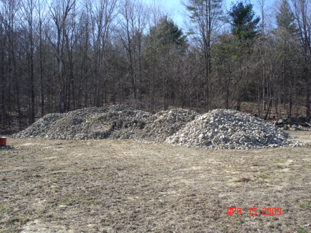

Well...the job is done. Here are some pics. We put about six to eight inches down. My buddy really worked his JD 450 hard. This large stuff is a bear on equipment. I did do some fluff work with the Kioti.:D It's going to take a while for the cobbles to settle in, and I may have to top-dress it with some crusher run before my wife breaks a heel. :eek: The truckers ran over the freshly cobbled surface to get to the stockpile area, so it packed down pretty well. They were running about 78k pounds loaded, one guy said.
The stockpile is one half of the total piled up. There are 5 or 6 loads by one of my tractor roads.
