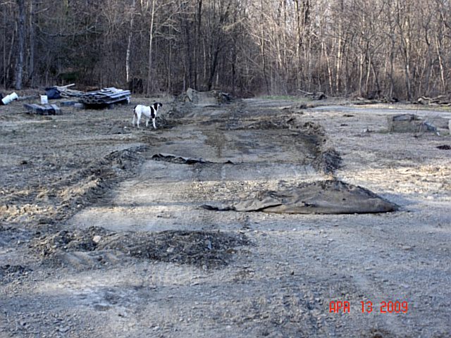

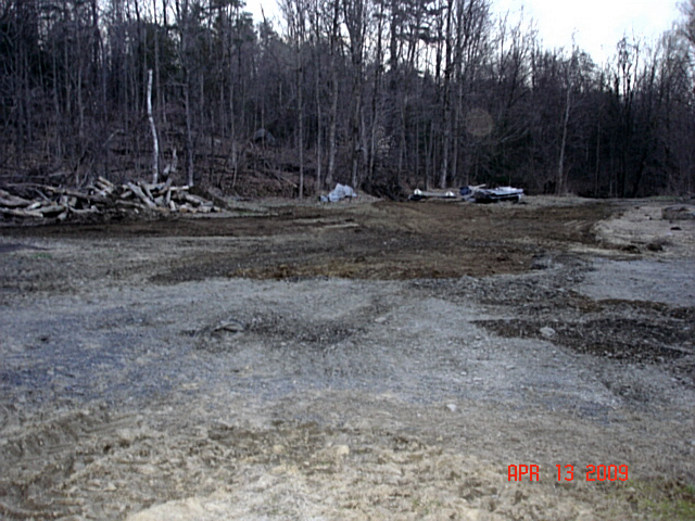

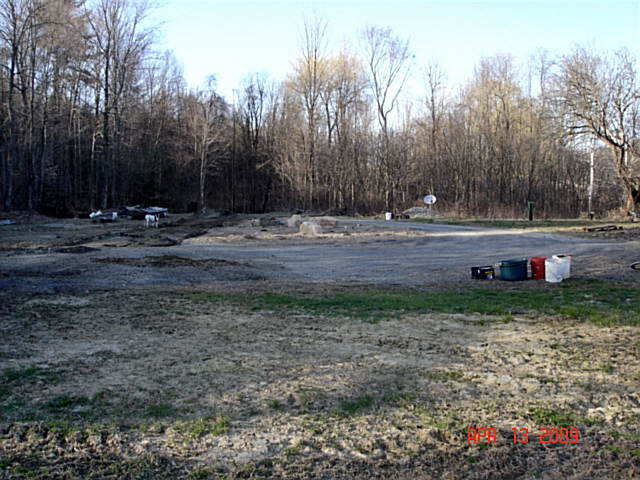

I had the same issue Dahammer - we could be neighbors. Heavy clay, no perc to it.
I solved it (somewhat) by putting down construction fabric and putting 6" of shale on it. It worked fine for a couple of years. The problem was that my grading was done by my loggers. They're great loggers, but really suck on a dozer. I had remnant low spots that held water for...oh....about a week after a rain. The shale started to geologically revert back to clay....and you know the rest. Proper grading is the key. You cant let water sit on clay if you intend to drive on it.
My farm roads are constant maintenance, with grading, water turnouts and detention basins.
The solution for my driveway is going to be 2"+ cobbles that I am buying from a local pit across the valley (sure....they have gravel over there!). First things first. Tonight I started the job of ripping up the shale and fabric on the problem side of my loop. It's really a job for a dozer, but I went after it with the box blade. I did admirably, but before I go further, I need my buddy to help me shoot elevations and......bring is JD450 dozer.:D After proper grading, I'll lay down some more fabric and then 8" of cobble, tracked in with the dozer.
Here's some pics. That's solid ash tray clay under there boys! My pointer is providing technical assistance, of course. I think he whizzed on it to help soften it....:eek:

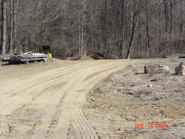

I just finished grading for proper runoff. Immediate runoff will be sheet flow across a (future) grassed area, and then to the ditching adjacent to my main farm road (an abandoned town road). The moisture of the clay is perfect - just enough to pack nicely without that powdery texture. Tomorrow morning I'm getting 2+ stone. I have decided to not put fabric down, for as long as the water doesn't sit on it, the stone will hold up nicely. Some areas of the farm roads have had stone w/o fabric doing its job for over 20 years. Not to mention that I'm getting about 660 tons of stone for stockpiling, so I'll have extra to add as needed. The material price was good. I also have miles of farm and woods roads to maintain, so having a stockpile is key to keep farm operations seamless.
I'll take some pics in the morning of the program.

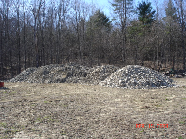

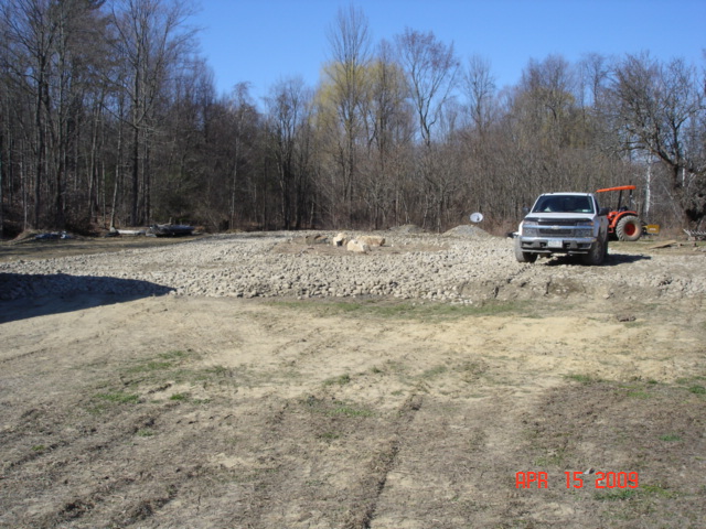

Well...the job is done. Here are some pics. We put about six to eight inches down. My buddy really worked his JD 450 hard. This large stuff is a bear on equipment. I did do some fluff work with the Kioti.:D It's going to take a while for the cobbles to settle in, and I may have to top-dress it with some crusher run before my wife breaks a heel. :eek: The truckers ran over the freshly cobbled surface to get to the stockpile area, so it packed down pretty well. They were running about 78k pounds loaded, one guy said.
The stockpile is one half of the total piled up. There are 5 or 6 loads by one of my tractor roads.
