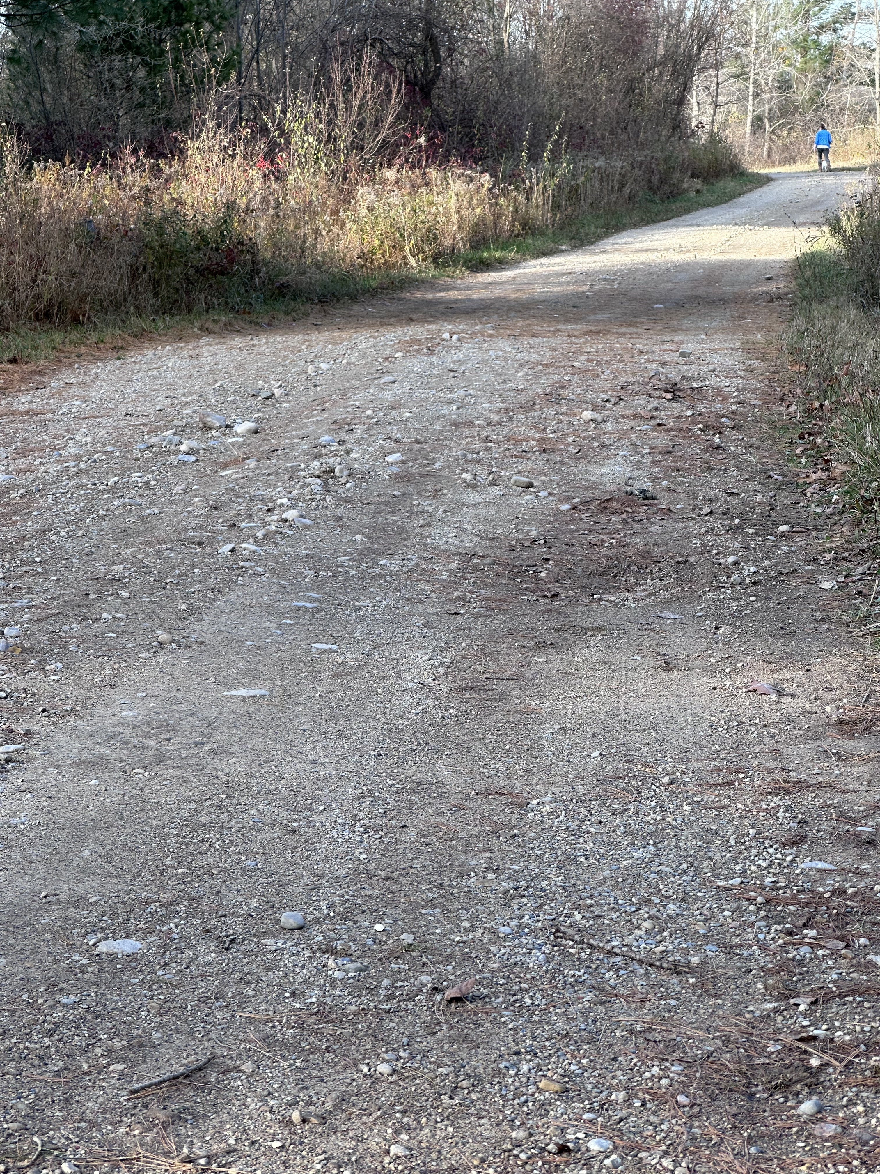

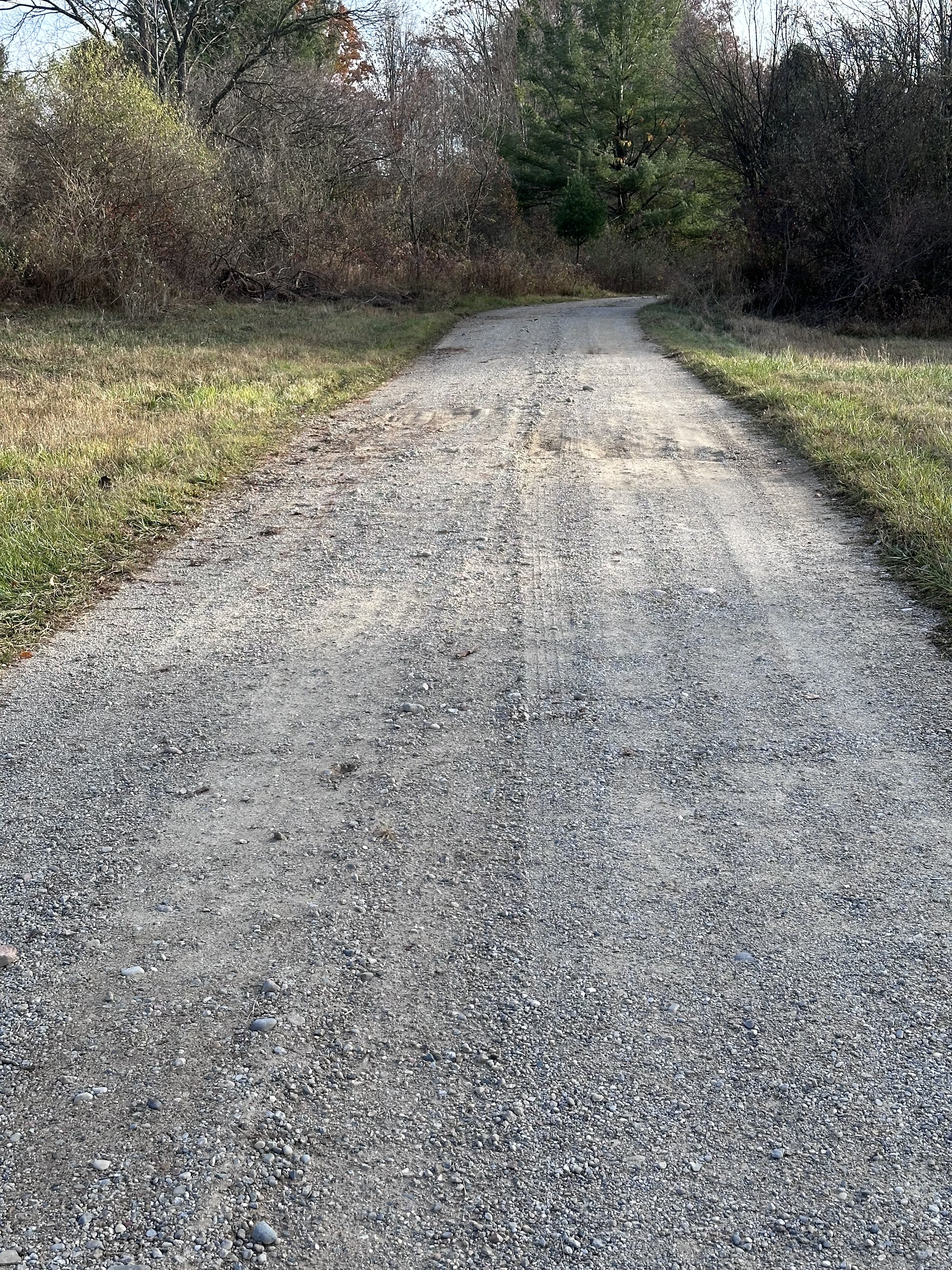

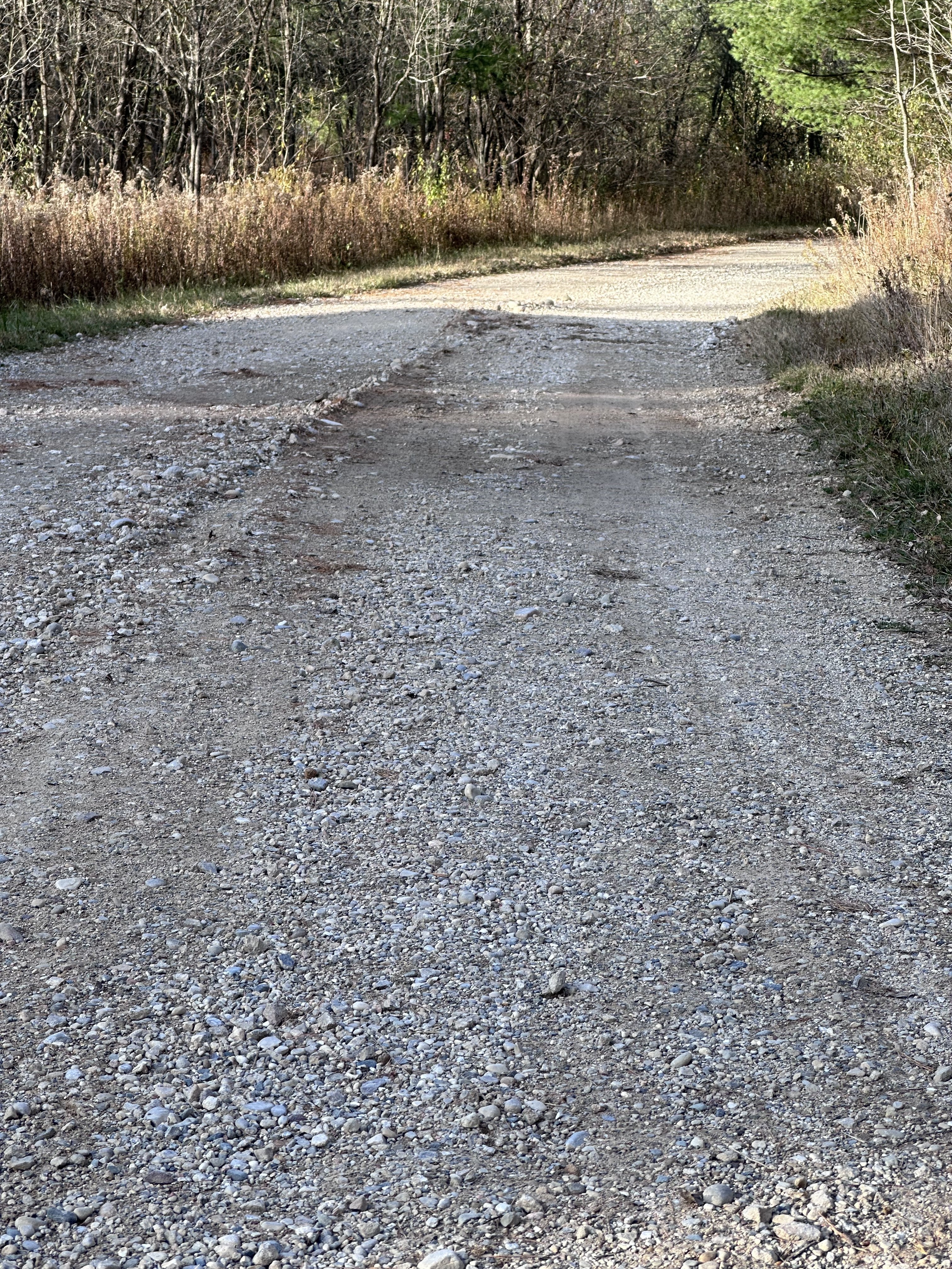

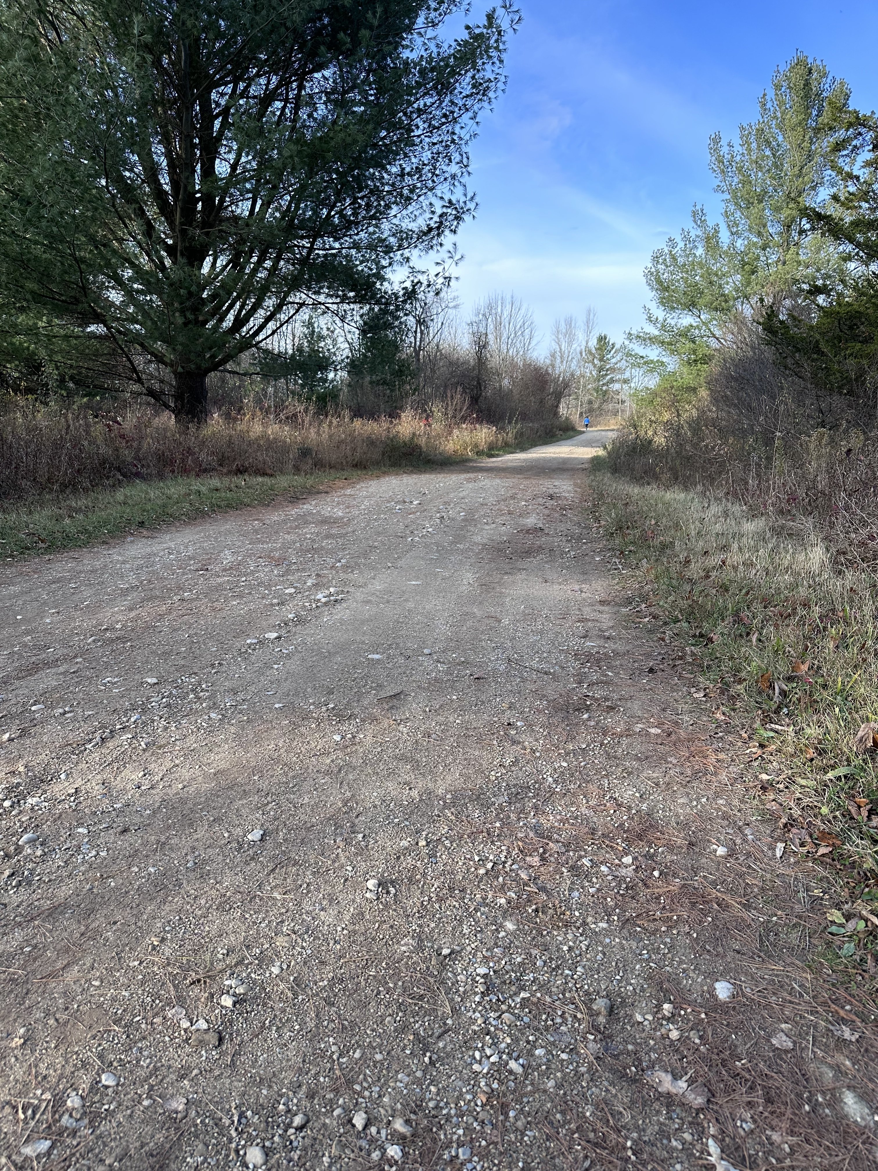

#27
Photos of the driveway

Pictures help a lot. Those appear to areas that hold water. I would cut the grass shoulder down, to create "weep holes" and then scarify the low area, and add some material to it. I dont think the dips you are showing are the result of a short wheel base problem.
You mentioned that the subgrade may be organic or expansive; water sitting on it will certainly make the problem worse.
/ Driveway help #30
It appears that the road bed is lower than the surrounding ground. This will be difficult or impossible to keep shaped up because all of the drainage is into the road. The only real solution is to bring in more gravel to elevate and crown the road bed.

Picture 1 and 3, both appear to me, that you could cut a weep hole to the outside, and add material. It's always hard to get perspective though pictures though.
