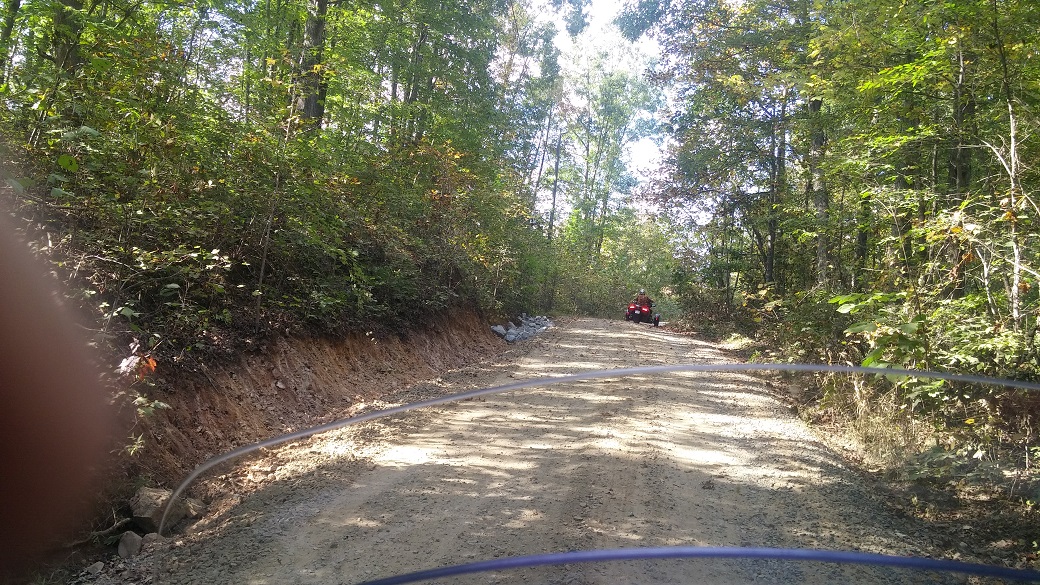

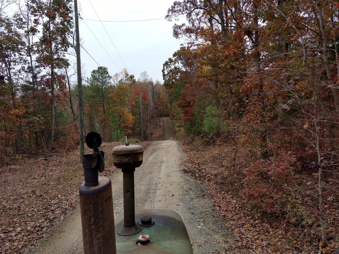

Tell me more about recycled asphalt .... I am currently (helping) maintaining a mile and a half 1 lane gravel road.
The previous guy kept it narrow with a high crown, We have been flattening and widening the road along with reworking the ditches on either side. I have been adding about 150 tons of road gravel (ABC modified) each year while getting the road in decent shape.
How well would the asphalt work for a private road with 10 houses and a fair bit of traffic. It's mostly flat but has a few steep grades here and there. 2/3 of the neighbors kick in for a 20 tom load of gravel each year so I'm limited on funds .....

The local lawn tractor dealer used recycled asphalt for his parking lot. If you get it when it's hot and have it rolled, it's a pretty nice surface. I got a load or recycled concrete for in front of my garage, and it also sets up nice.
I'm curious how your 10 neighbors are with kicking in $$ for the gravel. I do the same for 10 neighbors on e a 1/2 mile private road. I ask them for $25 /year for gravel - I maintain it for free. At first it took a couple of passes to get it. Then I l got busy and it got a little rough, and after that, they all pay up promptly (except one who never pays). Some people figure out right away they are lucky someone takes care of the road. Some come to that conclusion a little later.
