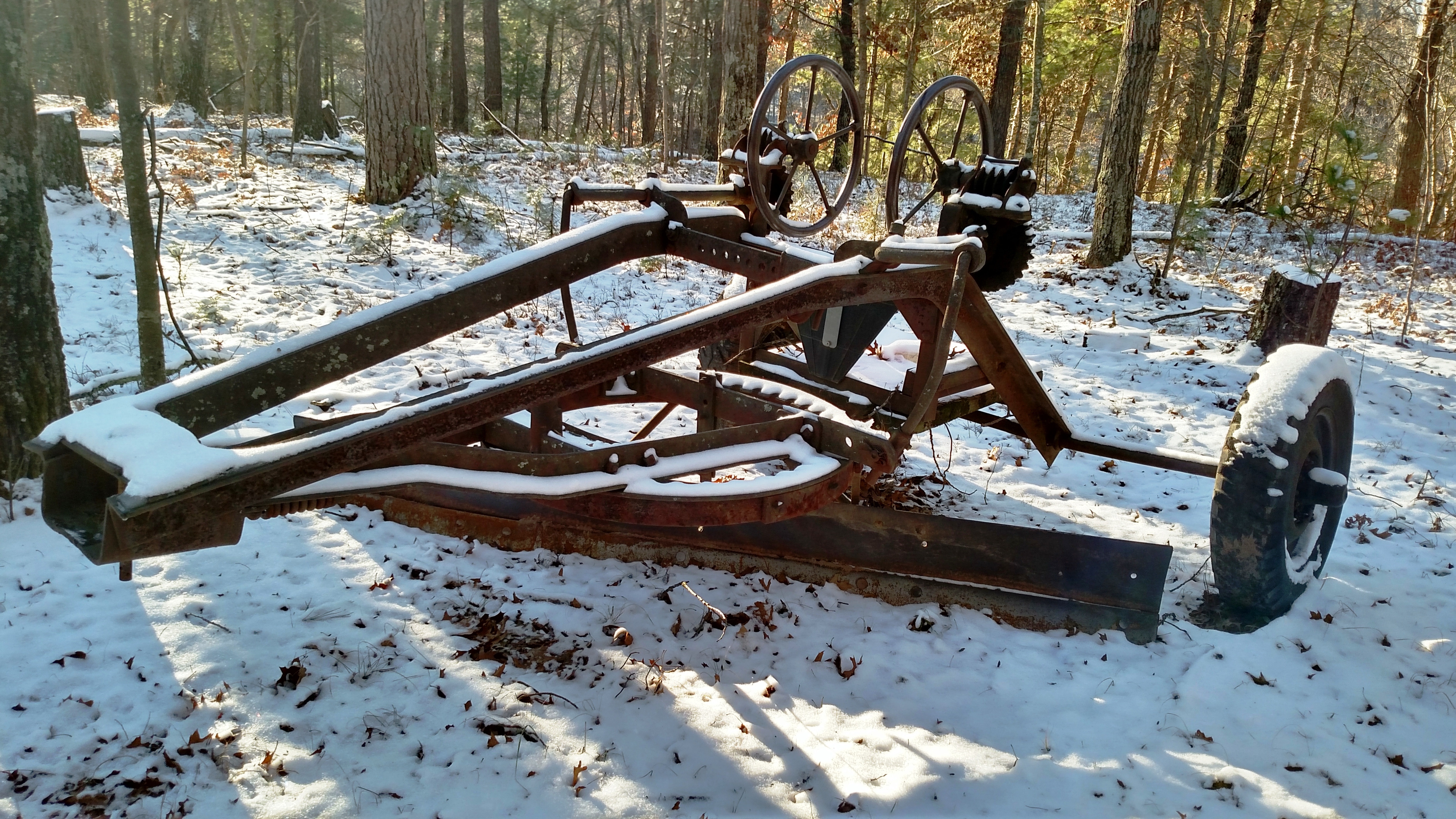

It's good to see what you've been up to. I remember when you were looking for a tractor. Are you finding that having a tractor is both fun and therapeutic?
Doing good work with a back blade takes finesse and practice. It helps if you have guide wheels, or if you are lucky, you can go old school ...
