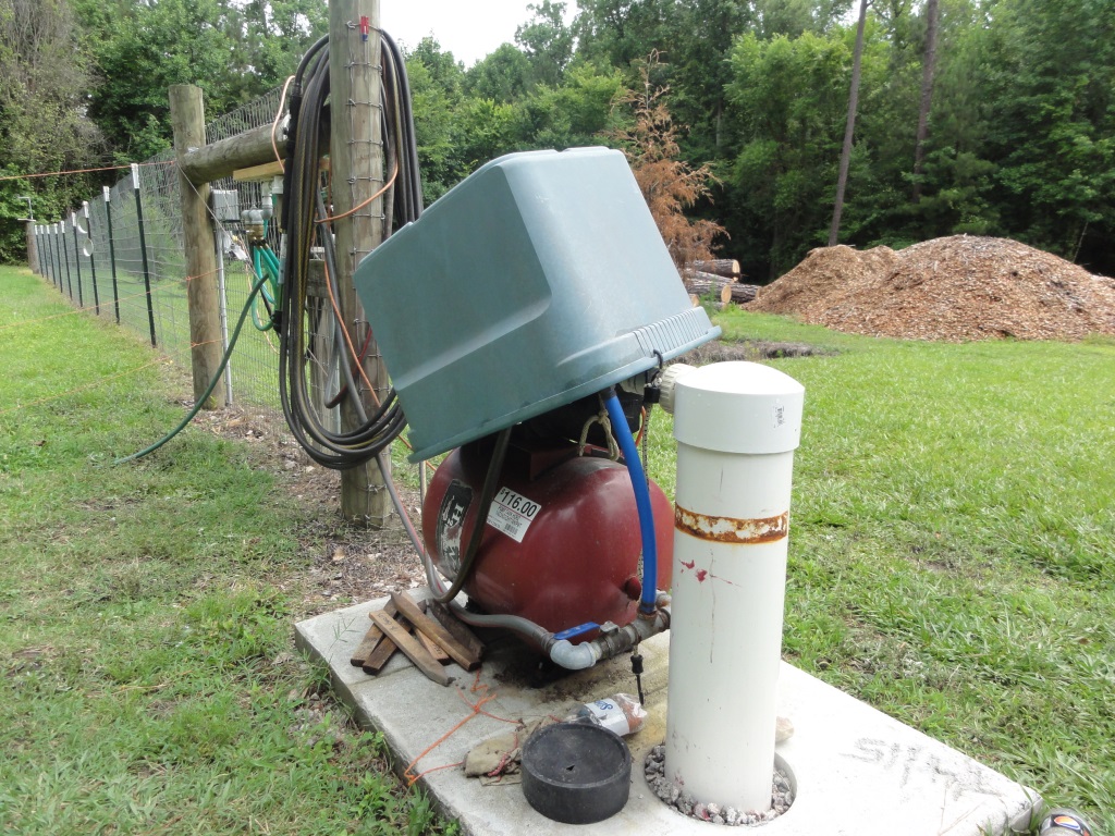

I ran across your post while searching for "using a pressure washer to jet a water well". I have a garden irrigation well I dug a few years ago using a 6 inch post hole auger; adding sections of 3/4" pipe as I went down. I got to 21 feet, then reamed the bore using a 8 inch auger and inserted a 6 inch pvc well casing. It was clay most of the way with a narrow band of sand at about 18 feet which is where my water comes from. This source fills the 6 inch casing to within about 8 ft from the surface, but obviously does not maintain that level when running the sprinklers. I run a 3/4 hp above ground pump with pipe and foot valve going down the well. I would like to get it a little deeper, but could do not more with the auger method. That is why I was thinking about using a pressure washer strapped to a piece of pvc big enough to support it. Before I tried I was hoping to find out you had tried and learn from your experience. Like one of the other posters suggested, I bought a semi trash pump and it easily pulled up muck from the bottom of my 21 foot bore. Of course I have a foot valve on the bottom of my trash pump suction hose and prime the whole pump and suction hose first. When it "catches" it sucks the well and muck dry in short order. I do realize that method will not continue to work past a certain depth of around 30 feet maximum due to something about an atmosphere. While augering, I pulled up lots of stone half the size of my hand. I once removed the foot valve strainer from the trash pump suction hose and was getting excited about how it was removing muck from the bottom of the bore until my pump stopped working. It had sucked up rocks and busted the cast iron pump impeller. The trash pump I am using is a Predator and can be purchased at Northern Tool weekend sales sometimes for under $200. I dream of finding a way to go around 10 feet deeper, but have not been able to do so yet. Like you I don't want to pay thousands for a truck to do it and don't want the county permit process to dictate a garden irrigation well either though I completely understand the need to seal the casing and protect the underground water source form contamination. Let me know if you have had any success using the pressure washer method. Thanks
